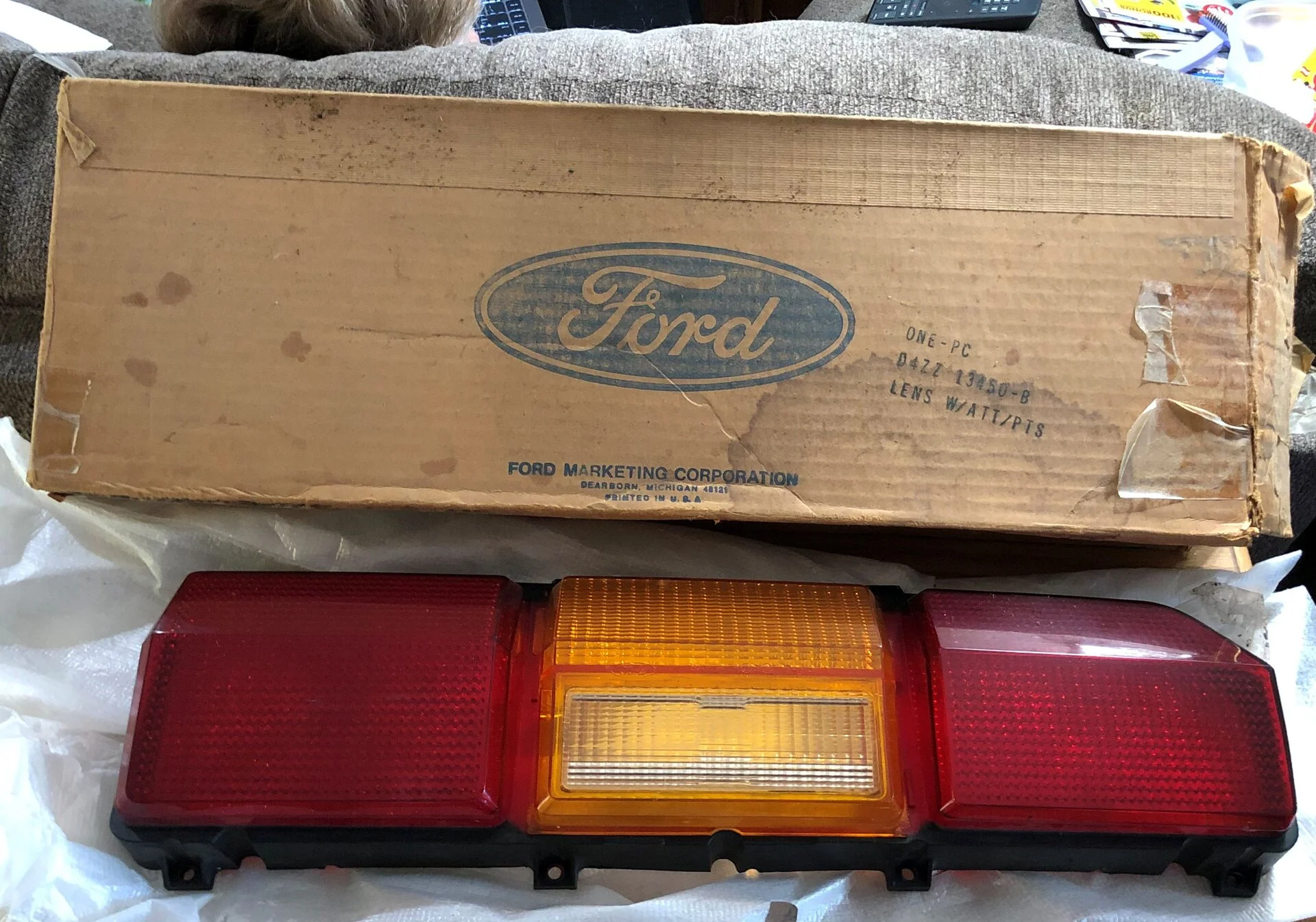

Okay, so I had to go up into the attic looking for stuff. Have not been up there since the last time I went up, which was a couple of years ago. There, I found some Mustang ii stuff I stashed there hoping to get another II. Well there in a box was a new complete brake line kit; even had the receipt. Prices have gone up in the last 15 years :confused:. AND, wait for it. A set of OEM never installed brake light lens.........in box and not even dusty.... Didn't know I had these. Can't wait till tomorrow to find other stuff. Oh , found a new set of flight boots from my Air Force days. Wonder if the still fit....will keep you posted

Need ideas about the lens. Sorry did something wrong Can't move the photo. Later.

As for the tail lens.... you have a pair of them? Or just the right side? I'd say if it were a pair I'd use them. If it's only the one, you could either sell it and recoup some funds from the build OR try to find the other side to match, install them, and if your other ones are any good sell them to recoup some money. :nice:
Well it seems the box of one lens marked LH is really a right hand lens. So, I have two right hand lenses. Sorry. Ideas? I can not use them because I am going to cut mine to make all red lenses for my sequential lights. ??
I guess I'd try to sell them to someone if I'm not going to use them. FB Marketplace seems to be the place online now if you're on there. And I'm sure Phil Schmidt would buy them from you to resell - maybe he could work with you to do something of a consignment? :shrug:
