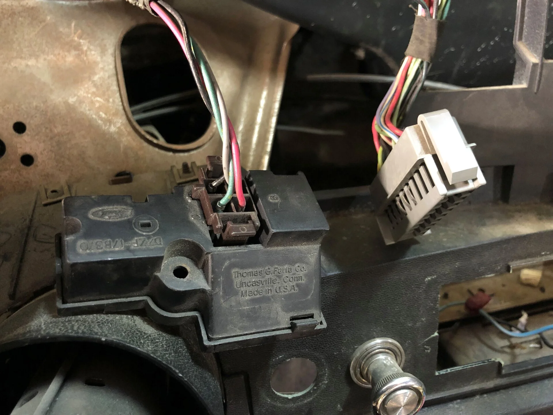

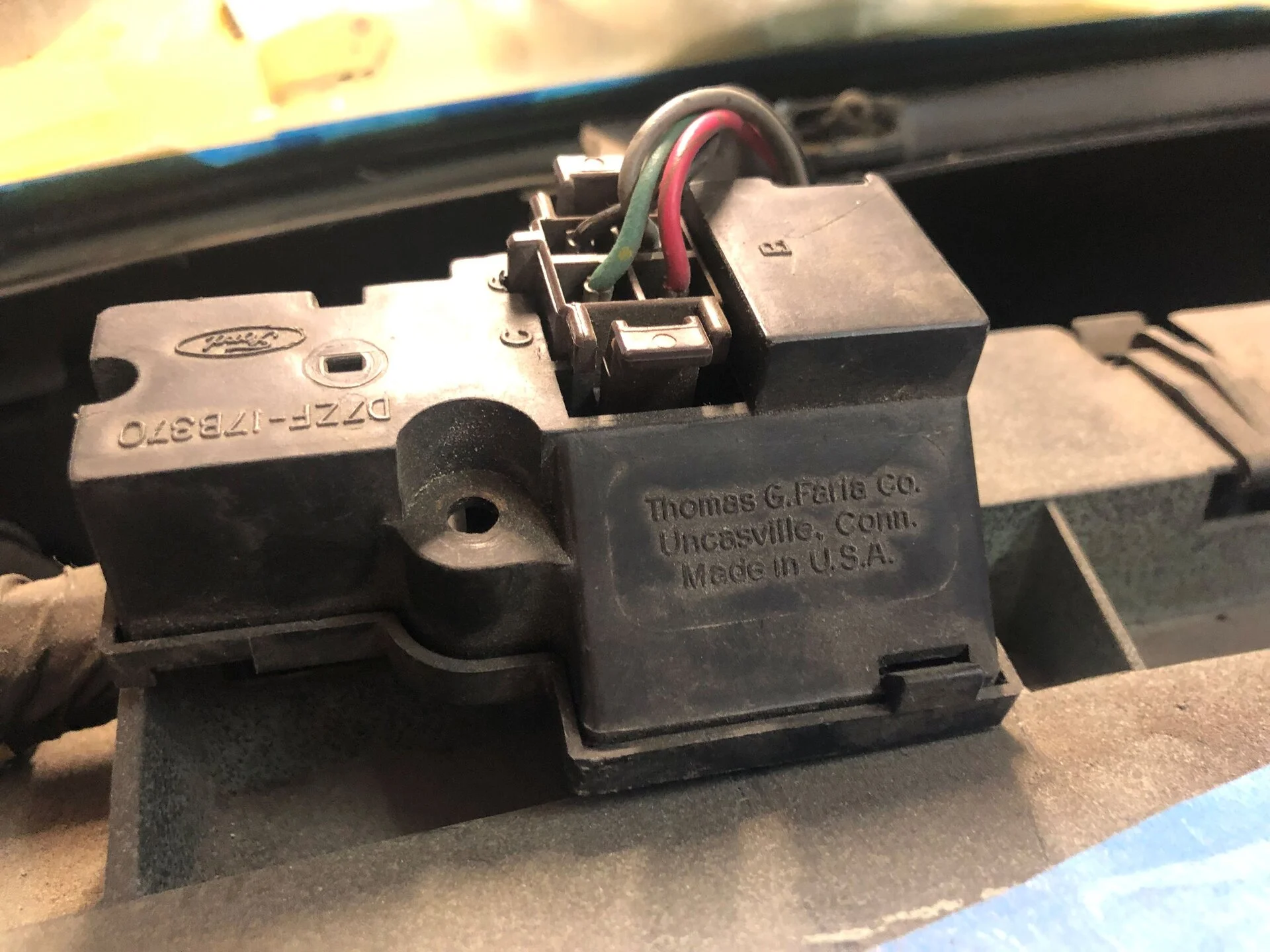

Started to repair wiring in the dash area getting ready to install my dash and 8 track. I found this behind the dash. Can't find my wire diagram so I need a bit of help figuring out what this is. I was going to cut it open looking for cash or a treasure map but figure I should ask. Any ideas?

if this is on the back of the instrument cluster beside the speedometer cable it is the RPM adapter for V8s. As you know Mustang II was never intended to be used with a V8 so they needed an extra thingy to make the RPM gauge work with the V8. This is a treasure, you old pirate! ;)

Was it on the cluster itself, behind the tach? If so, that's exactly what it is, and if that's what it is I'd be interested! It surely looks like that piece going from memory.... :)
If LILCBRA is in need of the tach converter thingy, I'm fine with that. I know that it will not fit my 74 instrument cluster.
You spoke up first, so if it fits it ships. I'm assuming it will but in case it doesn't, I'd take it! I believe I'm missing it in my car for whatever reason which is why my tach hasn't worked every time I try. It's the reason I went with an aftermarket tach installed on the steering column. I'd like to get rid of it as it clutters the space IMO, but it's not a dire need or anything - so my request is #2 in line. Thanks for the offer to hold off @extra_stout , but it's yours if it'll work! :)

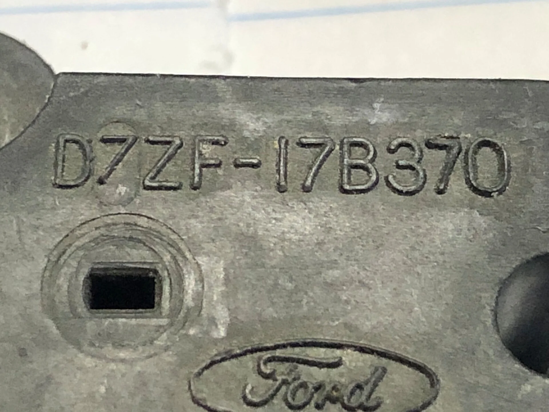

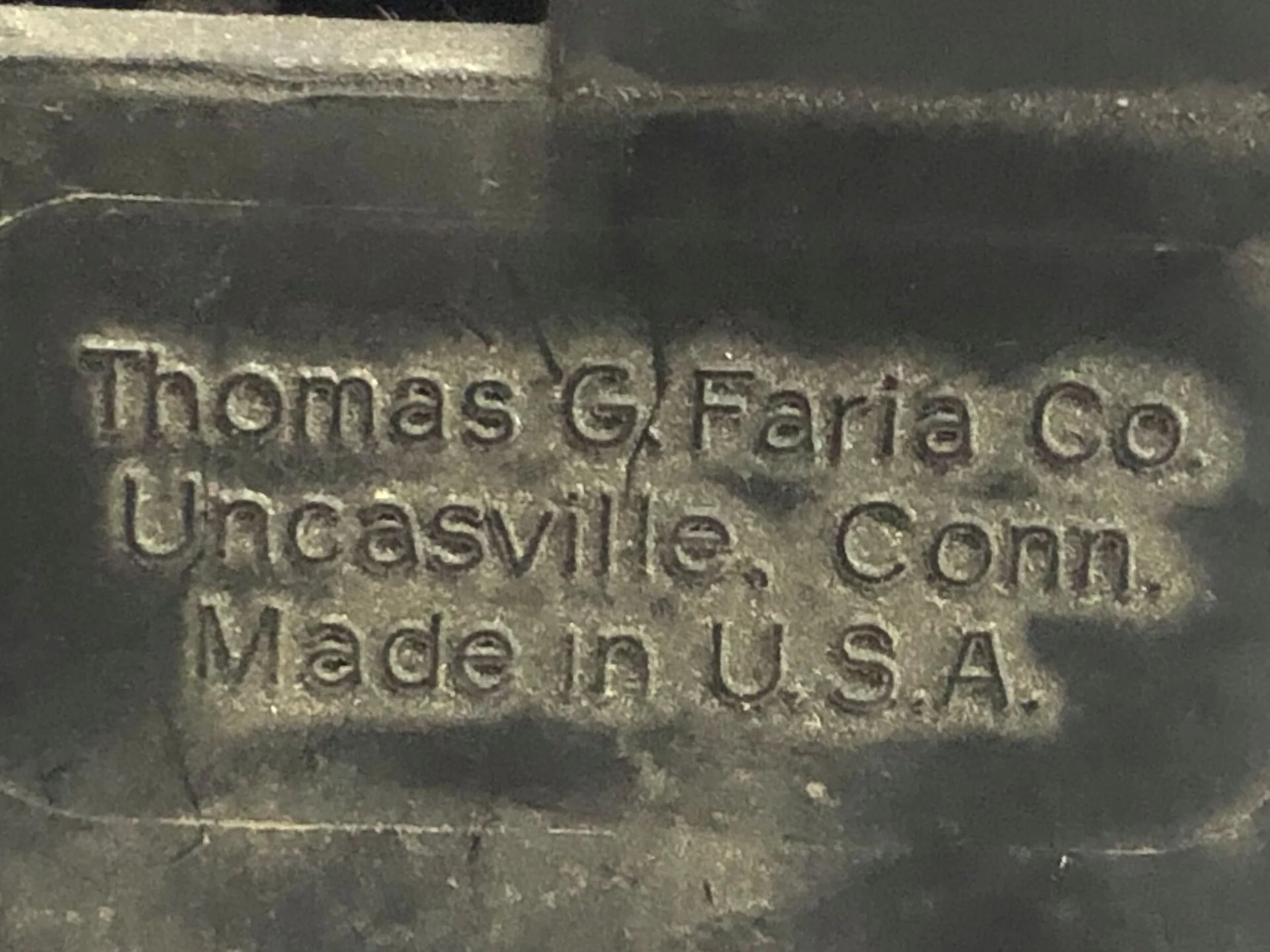

Oh, didn't know this was popular item. Attached,find photos as requested. I did a continuity check between the box and the plug going into the dash. They do attach to each other. At least the three wires go to the dash plug. I am pretty sure the tach worked when I drove the car. 99% sure. Photos show the plugs, Ford part number and company name. I have no idea what this is worth or how to proceed with this. If your looking to install in your mustang to make yours work, the price drops....to buy and resell ???

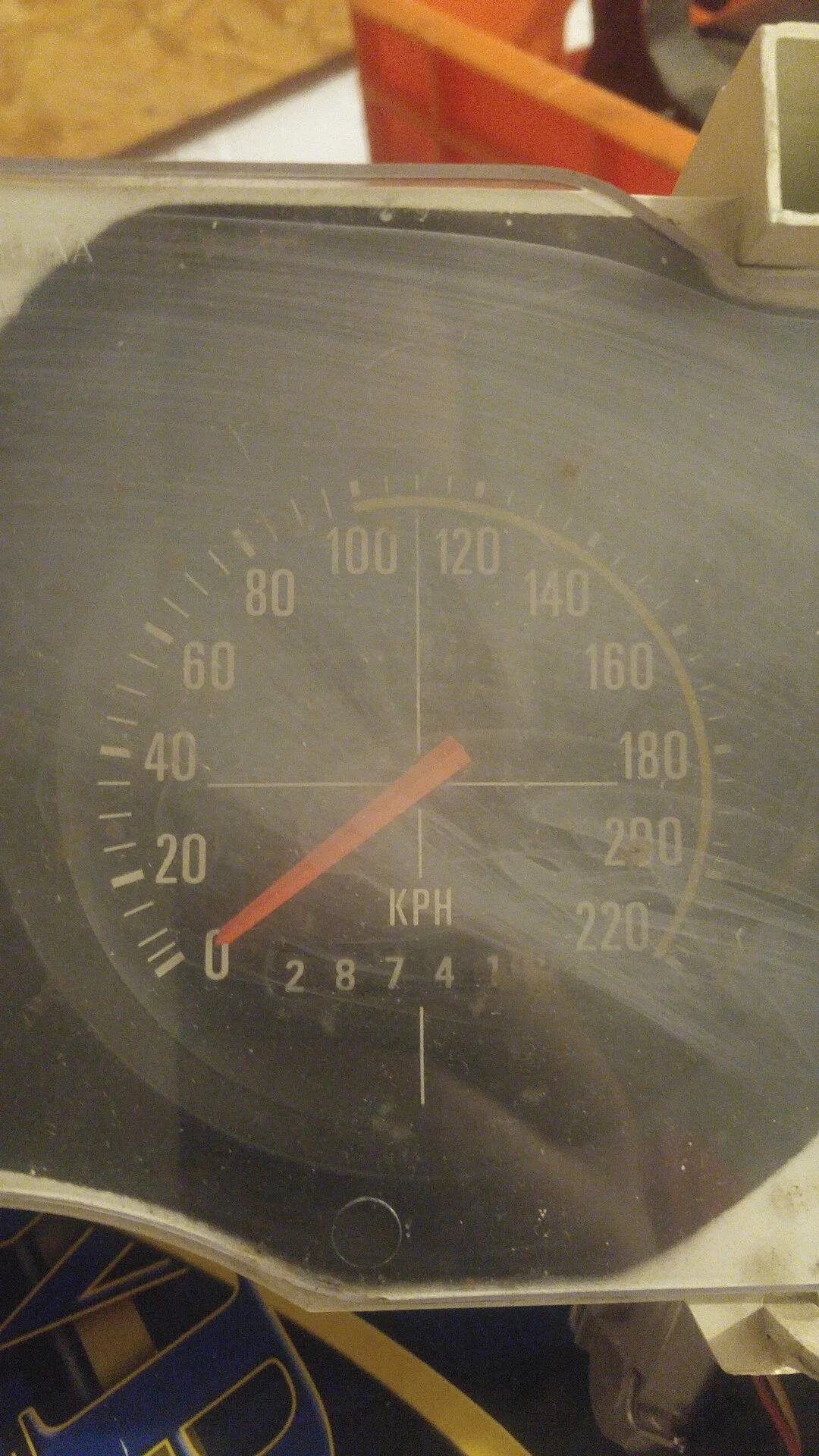

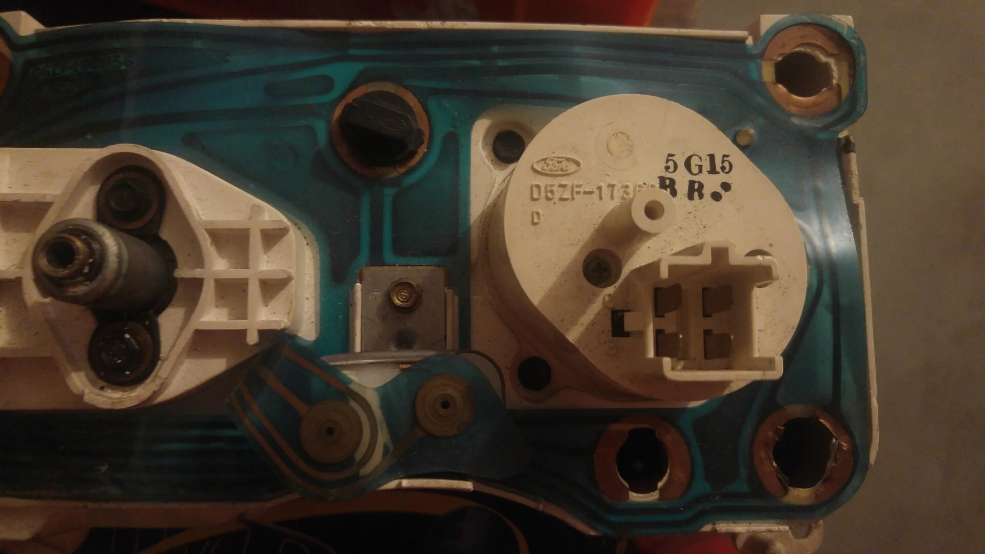

It will fit my spare instrument cluster, but the spare one is 75+ (D5ZF-.... tag on the back of the tacho).
I'm not sure it will fit my 74 wiring harness... and don't have time to check it in the next time. If I remember right, I have read somewhere that it doesn't fit.
I bought this spare instrument cluster for the KPH speedometer, which will be - very likely - interchangeable with my 74 cluster:
I think it is very likely that it will work with @LILCBRA car because it is 77 and your converter thingy has a D7ZF tag. Seems 75-76 could be different. Could some one ask the jedi squirrels about that?!
If @LILCBRA can use it, give/sell it to him.
I don't remember details but iirc the tach adapter is different due to wiring harness changes. My crappy memory tells me the 75/76 then the 77/78 were the same. I think it was just wiring pin changes or a different connector at the tach adapter though I think you can repin them or change the harness connector. Take that with a grain of salt as I never tried so I do not know for sure.

The Tach driver is a desirable MII part as is the clock with its correct trim. Only Phill Schmidt knows the going price.

Called Phil: Confirmed what this is and said they sell for about $40 if you can find one. Seems LLCBRA gets a lot of votes as he helps folks, to include myself. So LLILCBRA is you need this, I will trade for a couple of fruit cakes as mentioned before. The 3 1lb package is a good one. This will cover postage on this end. If you want the dash aslo, the 5 1lb package will cover postage from here. don' know how to do this. Don't know if I should cut the plug off and include. Need to look at the wire diagram to make sure this does not cause problems.
