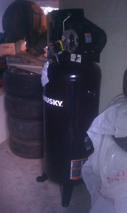

Good function and quality is not that cheap. I purchased a Husky 60 gln 4hp single stage 240v electric compressor. Works awesome. There is one other guy on here that bought the same exact compressor as I did, I think it's @Chuckman . I can run a grinder or cut off wheel all I want with my compressor. I ran black iron pipe with a lot of rise/drops which allows the water to settle at the bottom of the risers with a ball valve to drain to water. After nearly 50' of pipe I have a final trap with a regulator. I have zero moisture in my paint gun or any other air tools. A desiccant filter is highly recommended too which I plan on adding in the future.

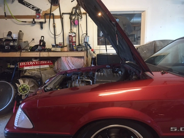

I have a HF 60 gal/two-stage 5hp compressor. I use a flex line to 1/2" copper pipe that runs into my attic, crosses the garage, comes out of the ceiling, then angles down about 30' at a slight angle. I have two drops, one with my two-stage filter/dryer and the other just goes to a ball valve. I have ball valve at each drop, coming out of the compressor and one at a drop below the compressor outlet.. The copper pipe gives the air a chance to cool, condensing the moisture out of it. Since the copper pipe is sloping away from the compressor, it lets the moisture run to the two drops. Seems to work okay, but it takes about 50' of copper pipe to get the moisture out of the air. Hope this helps

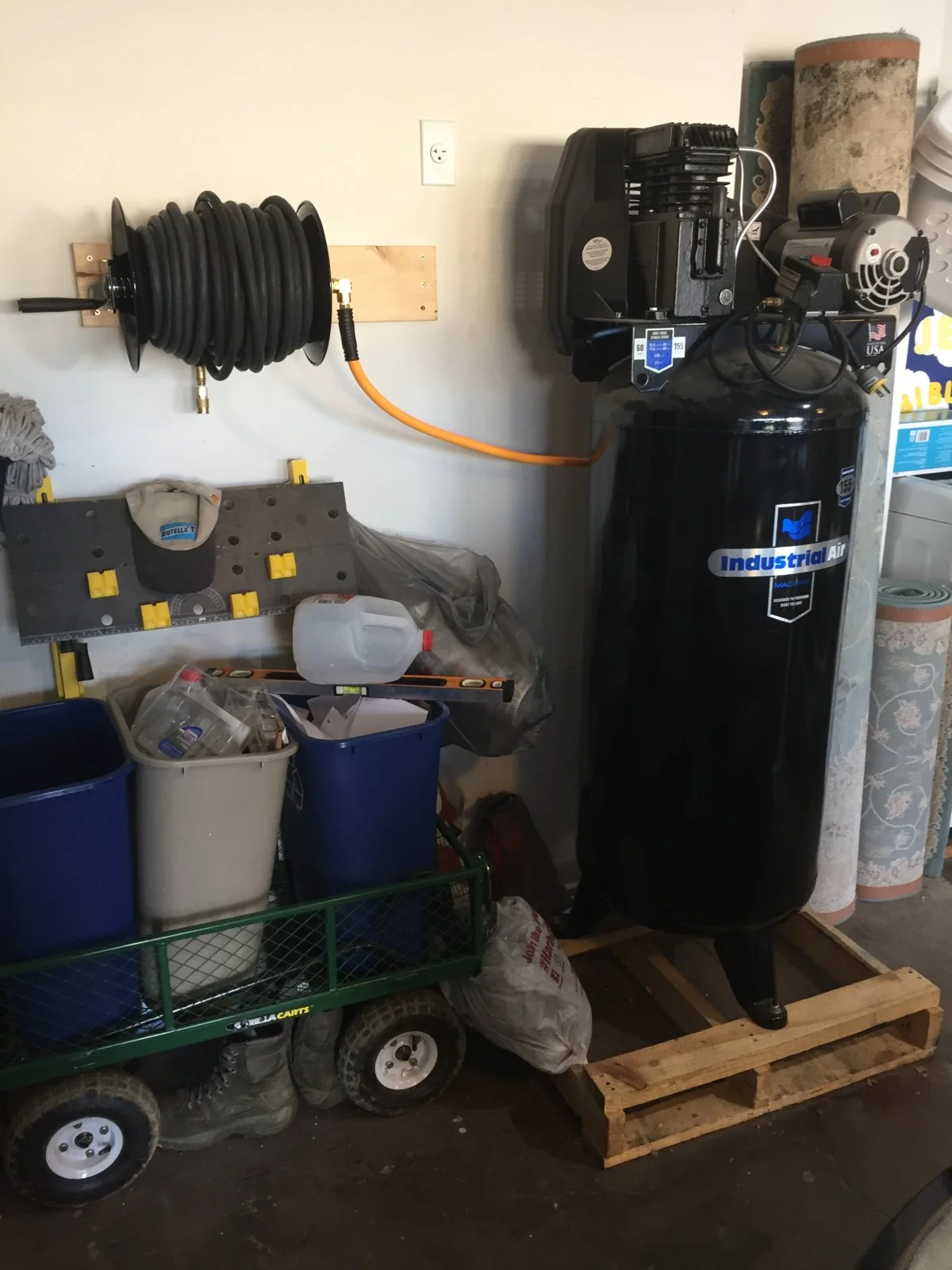

I want to revive this because I need an opinion or two. I'm planning to use the 3/4" ID RapidAir kit that Hoytster posted above. I'm planning to use this filter/drier/regulator from PneumaticPlus. I'm planning to use the RapidAir kit to plumb a series of water traps using these automatic draining water collectors also from PneumaticPlus (unless someone can recommend a cheaper one with a manual drain). I'd like to plumb in at least three water traps.
I'm going with the larger tubing so I can get the maximum amount of CFM to the gun whenever I get around to actually using my setup to prime my '66 coupe.
My questions are:
1. Should I do more than three water traps since I plan to use this setup for primer and (possibly) paint?
2. Should I put the water traps before or after the filter/drier/regulator?
My current setup is pictured below. I am planning to mount the tubing to the wall behind everything, working around the hose reel as necessary. The filter/drier/regulator will be mounted to the 2x4 on which the reel is mounted. The traps will be to the left and/or right of the reel as space dictates. Other than the reel, I only plan one other outlet that I will route to exit near my workbench. Thoughts?

Does anyone have a suggestion on the number of water traps?
It's good to have about 35-50' of pipe between your compressor and your quick disconnect. Somewhere in that 35-50' run you should have a few vertical jogs with ball valves at the bottom of each. I think I have 4 total jogs with a valve at the bottom of each. After my up/down runs it goes to a water catch can/regulator, then you should have a desiccant filter , then to your quick disconnect fitting.
