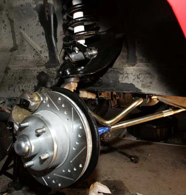

More progress w/ lots of help from HACK. The conversion is not as easy as I imagined. MANY trips to the auto and hardware stores this weekend.
Got the front suspension together and mounted the front brakes.
HAVE QUESTION ON A NEW THREAD FOR HELP on brake lines.
New A-arms, 1” anti-roll bar, TCP Strut Rods, 68,69 discs conversion w/ slotted rotors, stainless flex hose and semi-metallic pads. Coils are 620 that I had in it. More to come.

Well, we were able to get it back on the ground.
It took many trips to the auto parts store and buying up brake fittings at all the stores in town. They all only seem to carry one of each when you need 4.
If you are going to do a Drum to Disc swap in your 67 to a 68/69 style you will need 1/4 to 3/8 brake fittings as pictured. They are used to fit the stock hard lines to the Russel Stainless Flex hoses that connect to the calipers. I will have to sit down at one point and make a parts list to hopefully save someone all the headaches I had in this “Direct” swap.
The Maier leafs dropped the rear a bit more than what it was and the 57-59 9” brought the wheels in a bit. I am going to have to cut the front 620’s to get it level.

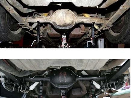

Some before and after shots of the rear end
Before-
I had a 67-70 9” with 3.22 open and drum brakes that I had on my previous 8” –
-Monroe AIR Shocks. any one want them? PM me
After
– 57-59 9” (1” shorter on each side)
– 3.25 Trac Lok - Maybe an equaloc? Out of a 66 Cyclone. The 57-59 rear does NOT have an oil Fill hole. The 66 3rd member does also NOT have a Fill hole.
I found this out after it was assembled and mounted in the car.
I thought I was out of luck but I just used a long hose on the gear oil pump and went in through the short axle side of the housing. I was able to add the traction modifier and gear oil that way. I was panicking for a while until a I figured out how to get oil in there. If you do the swap and get a new 3rd member check it first. It might be a good idea to put in a fill hole in the housing when you have it out.
– Ron Morris reinforced spring plates. I had to open them up a bit. They are for 7/16 Bolts. The threads on the U-bolts I bought were a bit bigger than that.
– Maier Racing 165 Race Leaf Springs – Poly Bushings and Heavy Duty Shackles
– KYB Shocks
– SSBC rear discs - Like the rest of this project I have encountered some bugs. The rear of the rotors are rubbing the calipers
:bang:
