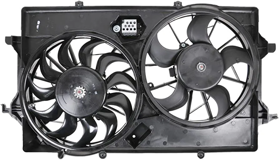

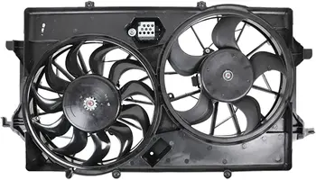

You can actually swap the focus fans into the contour shroud. Came up in a thread over on corral.net
The focus motors seem to be stronger, especially the 11-blade setup here. No idea how well the focus shroud fits the fox radiator, but it was shown that swapping in two of the 11-blade focus fans did bump the cfm up a bit.
So now I have my eye open for some focus fans to rob the 11-blade motor/fan from

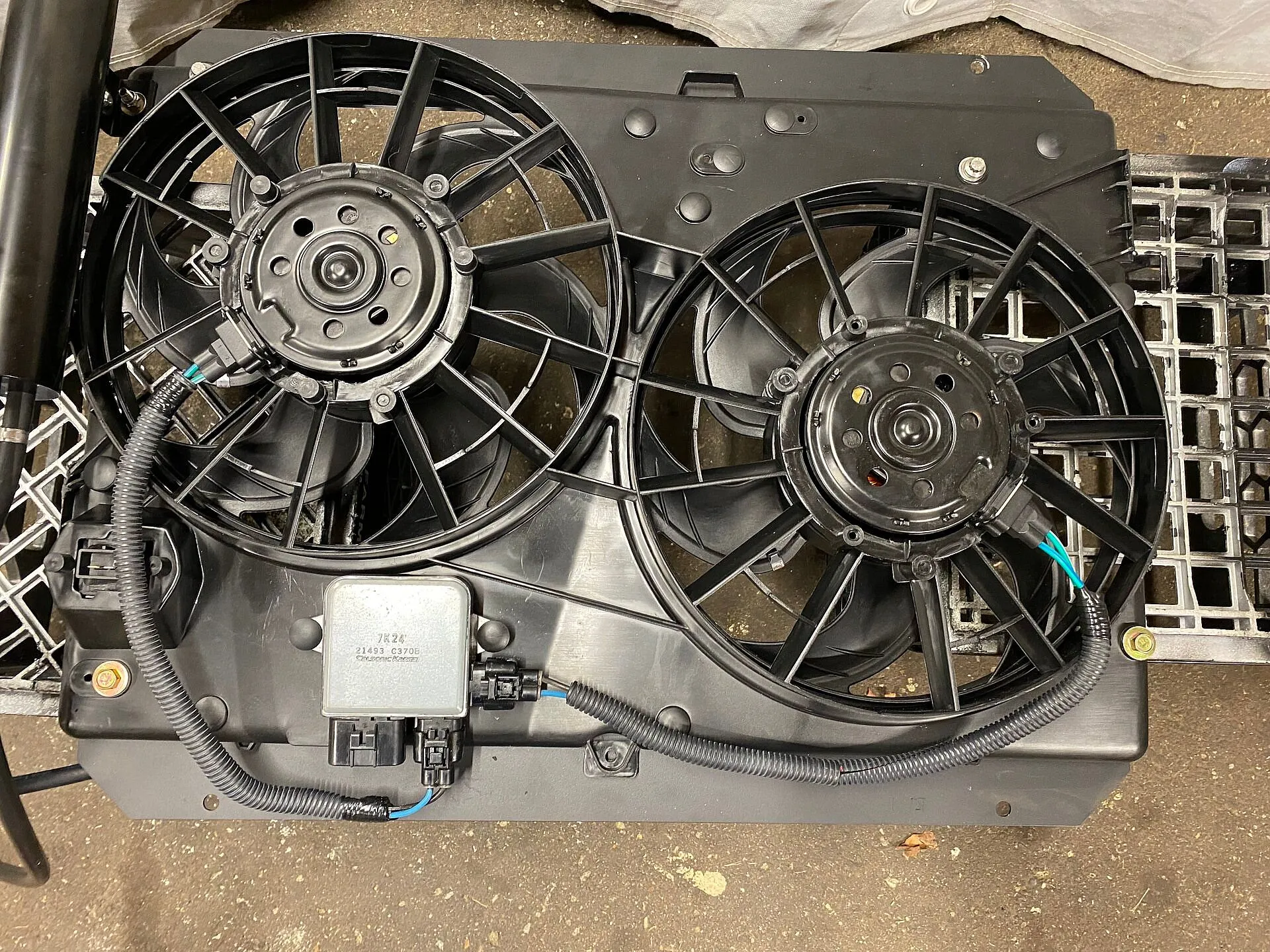

I used an Infiniti pwm controller to control the fans. I have some videos on this out on the YouTube
As Mike mentioned I did a few videos and tests of Contour and Focus fans for a thread over on corral.net and will share them here.

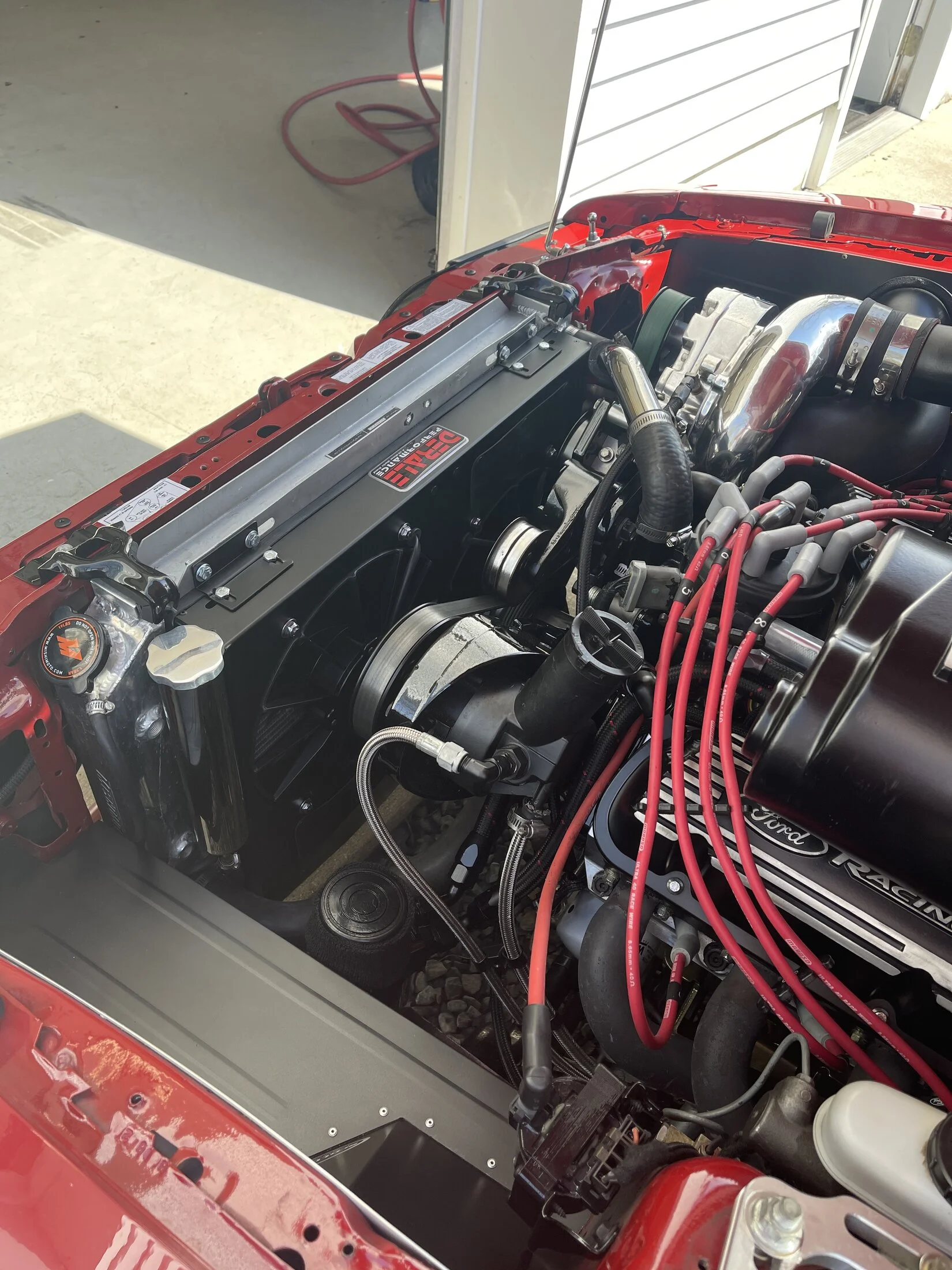

I had to trim the box down because of my crank pulley slightly - I also powder coated it

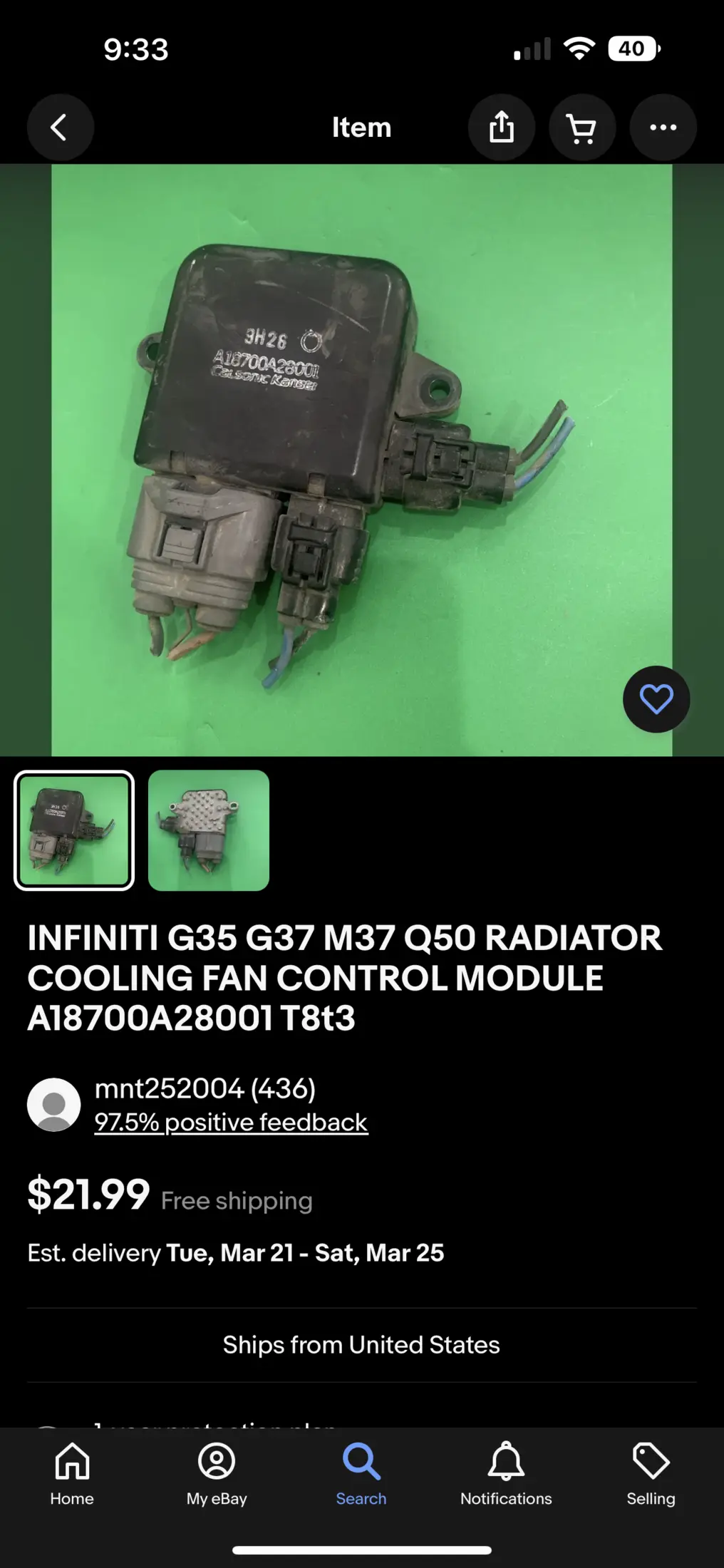

But most, if not all of the aftermarket ECU's have the ability to output a PWM signal, so they can control these controllers. I think I paid $15 for my Infiniti fan controller. It's a 3-wire hookup, and can control 2 fans. (main power and a single PWM input wire) and i can ramp it up based on coolant temps with no amperage spike.

If I remember right, in one of my tests I found that when using the factory thermoresistor it dropped the voltage to 8V to run low speed on the Contour fans. That would be about 75% of full power.
If I was building an electric fan system today I would use a simple single temp sensor to trigger low speed fans (fans on at 200) through the thermoresistor and add a toggle for high speed for if I needed it (so far in 6 years have NEVER needed high speed). It would be basic and standalone and cheaper than any PWM controller out there. I would run it through one of the Infiniti fan controllers (not using PWM wire) to get the soft start to keep amps in check.
The bosch Mercedes and Volvo stand-alone controller will take 60 amps I believe. I think the Infiniti one is 50 amps. These are plentiful on eBay for fairly cheap. Fusion/corvette is another popular one.
