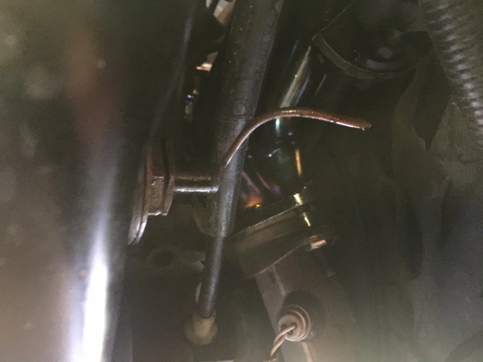

I’m finding some more problems. I was under the car trying to tighten up the header to h-pipe flange when I noticed a drop of oil on the bottom of the transmission where it meets the back of the engine, so it seems I have a very slow rear main seal leak.
I also found out after I washed the car that the passenger’s side weatherstripping is leaking. I have a new set, I’m going to replace both sides.
I also have created a fun little game that I call: “What is This Wire, and What is it Supposed to be Connected to?” because I keep finding loose wires hanging out around the car, like this one from the oil pan:
it looks like some sort of low oil level sensor? In any case, it’s been cut and it’s not affecting anything so I’m trying not to worry about it. The rear main seal leak is now my primary concern.
it is the low oil level sensor. If I remember correctly, that wire runs into the o2 sensor harness, and then up to where it belongs.
You may find the other end inside that loom?
I’ll take a look, does it automatically shut off the engine when it triggers, or does it just light up something on the dash? Because if it’s just an indicator, then I’m not too worried but if it’ll save my engine from catastrophic failure, then I’m all for it.
As for the rear main seal leak, I suppose now is as good a time as any to get a new clutch as well, right? I don’t know what condition the one that’s installed is in, but my learning to drive stick probably hasn’t done it any favors.
As Rdub6 said, it's the connector to the low oil level sensor. The one on my '86 looked just like that. As part of my rebuild, I replaced the sensor and soldered the wire back together. The other end is in the harness for the O2 sensor.
