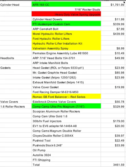

I'll probably blog about the build here. Anyway, here's my full shopping list. Where the lines are blank is where I'm evaluating other things. not ready to buy everything yet, not in any real hurry other than I want Ed to kick off the cam grind before he gets too backlogged.
  1. PLEASE sell the C&:L and get a Pro M or PMAS MAF
  2. the 65MM TB is too small for your build IMO , I would go 70
  3. for HG I would either get Felpro 9333Pt1 or MLS gaskets
  4. for intake get the S3 version with the steel gore not the print O seal
  5. Not a fan of scorpion RR . I would get crane or Pro Comp
  6. You'll want and Adjustable FPR- I like the Kirban
  7. You wont know the pushrod length unti you check. dont get stock ones- get hardemed one piece
  8. get a standard oil pump- mellings
1. There's no discernible benefit to my particular street build to sell a hand-polished piece that has run perfectly for 10 years to go a Pro-M. I'm not trying to wring out every ounce of power. :) I acknowledge that Pro-M is a superior model, but this piece has served me well for a long time.
2. Probably. But the accufab piece was expensive, and it's pretty polished, and works fine. For a street-only car, I'm looking to maximize torque, not top-end HP. Ed is aware of these parts and are taking them into consideration for the grind. If it was a +20HP change across the band, but it's really only going to choke me from 6000+ RPM, an area I will spend little to no time on the street. My request to him was to maximize the power band from 1500 to 6000 RPM.
3. haven't researched 'em much, but both of those are on my list.
4. Any particular reason?
5. Agreed, I since yanked them from my list. I'm going with Steel Ultra Pro Magnum 1632 SBF ones. I read too many horror stories about aluminum stress points, although the odds are good I would have been fine either way. Steels only a bit more money, and felt like a safe bet.
6. Good to know. The 24# injectors are too small for the duty cycle that I *think* I'll be act, and 30# is a tad bit large. Might need to back the FP off, but I'll likely take it to my local shop for the dyno tuning runs when I'm done.
7. Of course. It wasn't called out on the list, but I'm going to wait until the heads are on, buy the tool to measure, and then buy the hardened push rods.
8. I will at some point, as I explained to Ed I'm doing the oil pump later. I found this great install guide online:
