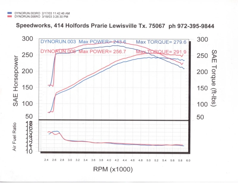

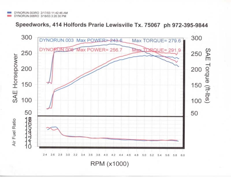

Here's proof
This should solve the problem. Here is my dyno sheet of before and after headers. NO OTHER CHANGES WERE MADE. Everything on the car is the same as before. Only change is headers. I went from high-flow to high-flow. All on the stock computer. Both sets of numbers are SAE. Remember, you are not looking at the final number as much as the difference between the two ALL THE WAY ACROSS THE BOARD.
I agree with this guy to a certain extent. LT's are an expensive mod. But they are NOT a waste of money on a NA engine.
