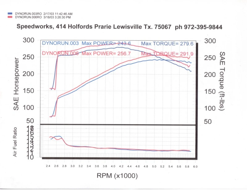

5111 said:
This should solve the problem. Here is my dyno sheet of before and after headers. NO OTHER CHANGES WERE MADE. Everything on the car is the same as before. Only change is headers. I went from high-flow to high-flow. All on the stock computer. Both sets of numbers are SAE. Remember, you are not looking at the final number as much as the difference between the two ALL THE WAY ACROSS THE BOARD.
I agree with this guy to a certain extent. LT's are an expensive mod. But they are NOT a waste of money on a NA engine.
And I could bolt on a TB/plenum to my set up and match or exceed your curve and peaks. It would be cheaper and tons easier to install a TB/plenum. I realize LT's provide gains, but they are minor for the work and cost involved. The most SAE hp. our stangs are going to produce with bolt-ons is between 250-260 N/A. The quickest and least expensive way to get there is:

Are your hp numbers corrected or uncorrected? The just seem really high given your mods. What mph are you running in the 1/4 mi? I would expect if you are making over 250 you must regularly be 101-ish.
FWIW, I think that one dyno graph does tell the story. Check out the gains after the peak. They are not super-huge, but they seem pretty impressive to me. I don't doubt that even if the peak numbers aren't all that great, the post-peak will certainly help out in the 1/4 mile. Then again, how many n/a bolt-on mods give you over 10+ hp peak and better gains post-peak??? :shrug: Not to many.
