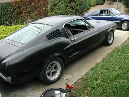

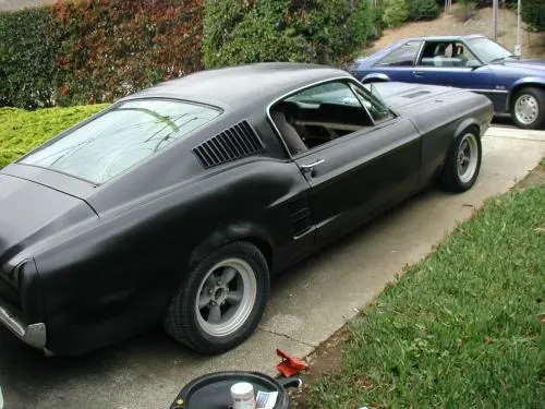

vobraman I cut a coil off the 620s, did the wedge kit and got mid-eye 4 leafs in back and here is the result. I'll have 17s as soon as the 5.0 is sold so we'll see how that turns out. I had pics of my ground clearance but I can't find them.

Negative wedge, with 1/2 cut progressive springs and mid-eye 5 leafs...it needs to be lower
