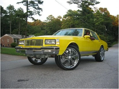

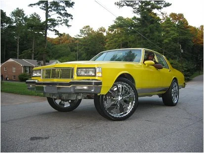

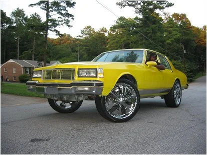

In the meantime, I'll be doing this to my Mustang soon because, you know, I want to "stand out". :p

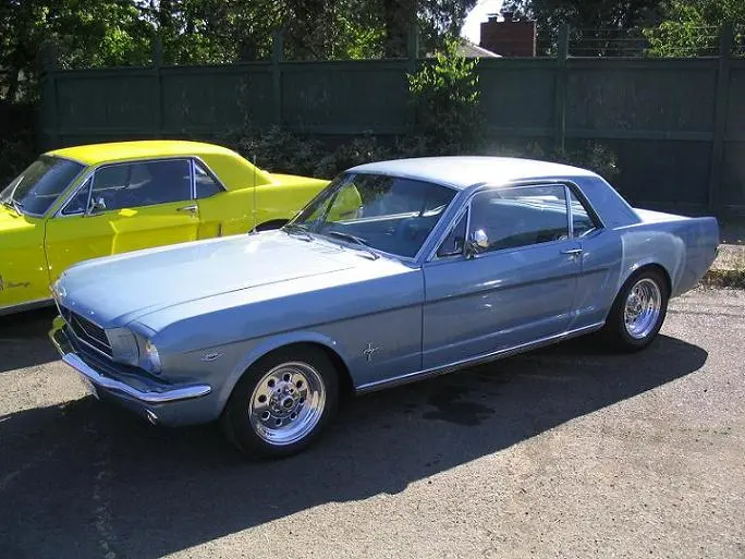

12sec67 said:
HERES MINE! :banana:
front: 720'S cut
rear: stock with 2" blocks :rlaugh:
i plan on getting the reverse eye 5 leafs in the future :D
taking to the paint shop at the end of the month :banana: :banana:
