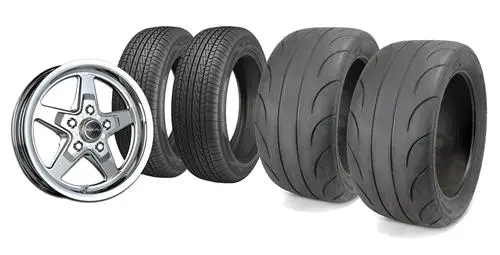

Now, Late Model Restoration has a sweet wheel/tire package with Race Star wheels fats and skinnies with M/T drag radials. My plan is to put blizzaks on my stock rims for winter and run the drag radials in the summer. Anyone ever run these tires on a D/D? My only concern would be heavy rain, but since my current tires have the same or less tread than the drag radials, I don't think it would be bad. Of course I realize that the D/Rs are wider, and will hydroplane easier......thoughts?

They actually have 4 different packages depending on which wheel/tire size you want. They range in price from $1249 to $1599. But they include EVERYTHING needed to install INCLUDING sway bar relocation brackets. And they qualify for $14.99 shipping.
The packages are at the bottom of THIS PAGE
