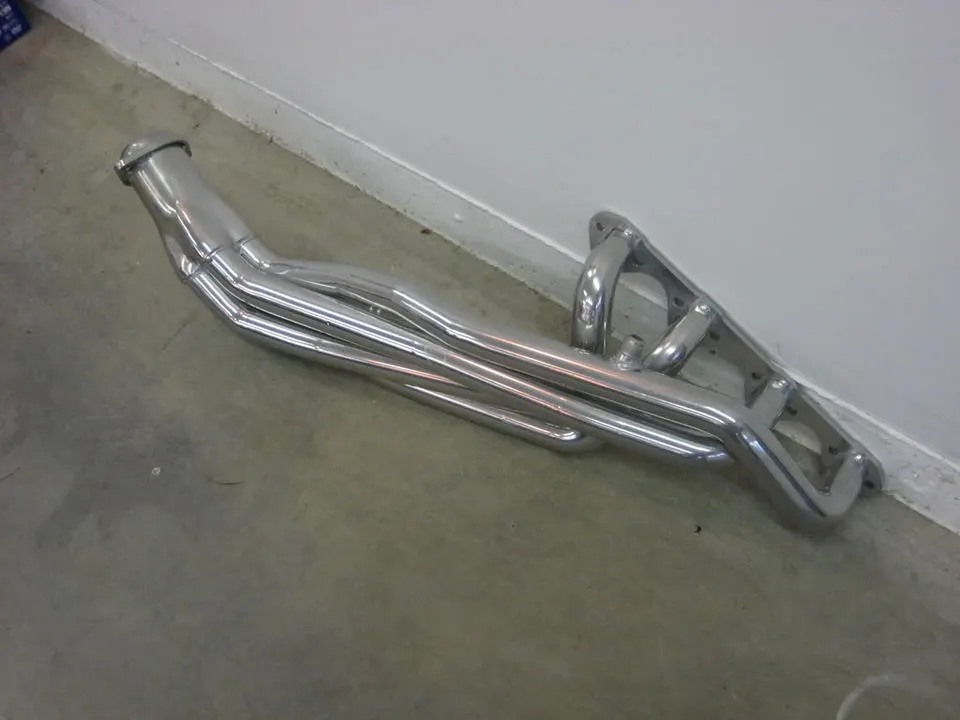

I have a set of BBK shorties on my Cobra now and they are very nice and built WAY better than the Mac ones I have seen.

Thats the best picture I have of my bbk's at teh moment..
