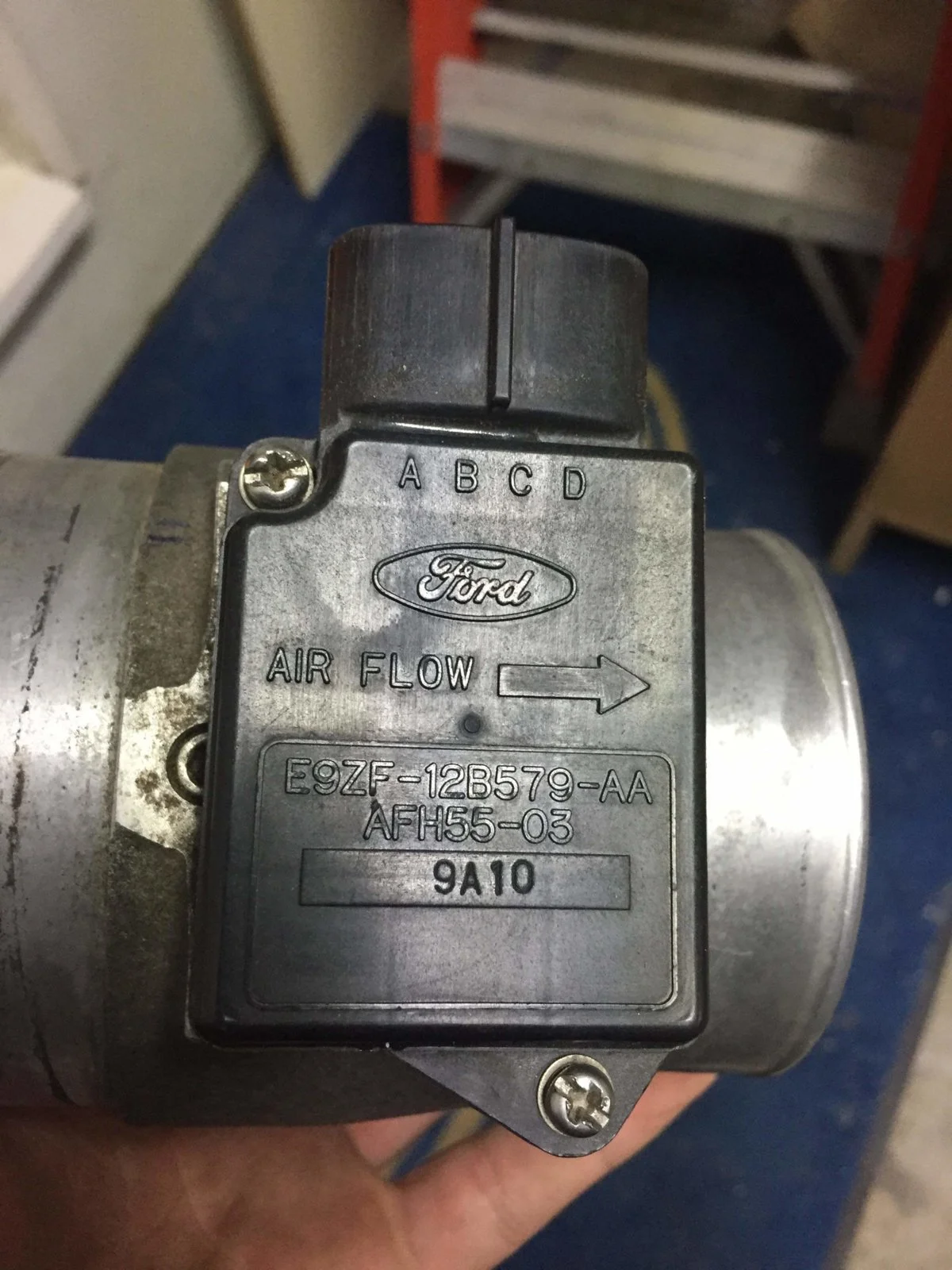

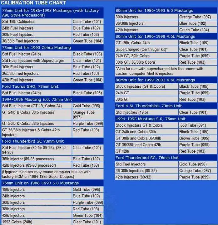

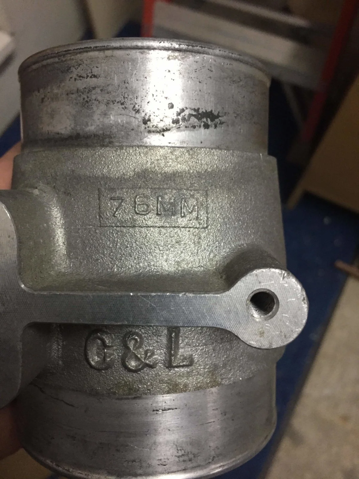

I have a 76mm cl mass air flow sensor I'm planning to run with 30lb injectors.. my question is about capability and correct tube size.. there are multiple 76mm units in this chart I posted aswell and different years and sizes
.. should.i be using 73mm I'm not sure what the 76mm came from it was used but I know it was on a 5.0 with 19s any help would.be greatly appriciated I was planning to get the purple tube with the 76mm and 30lb injectors

With C&L you use your factory maf sensor installed in the housing with the correct size sampling tube for your injectors.
The 76mm should be ok with the correct tube size.
Just fyi there are a lot better maf choices out there, I always liked ProM, never had good luck with c&l.
