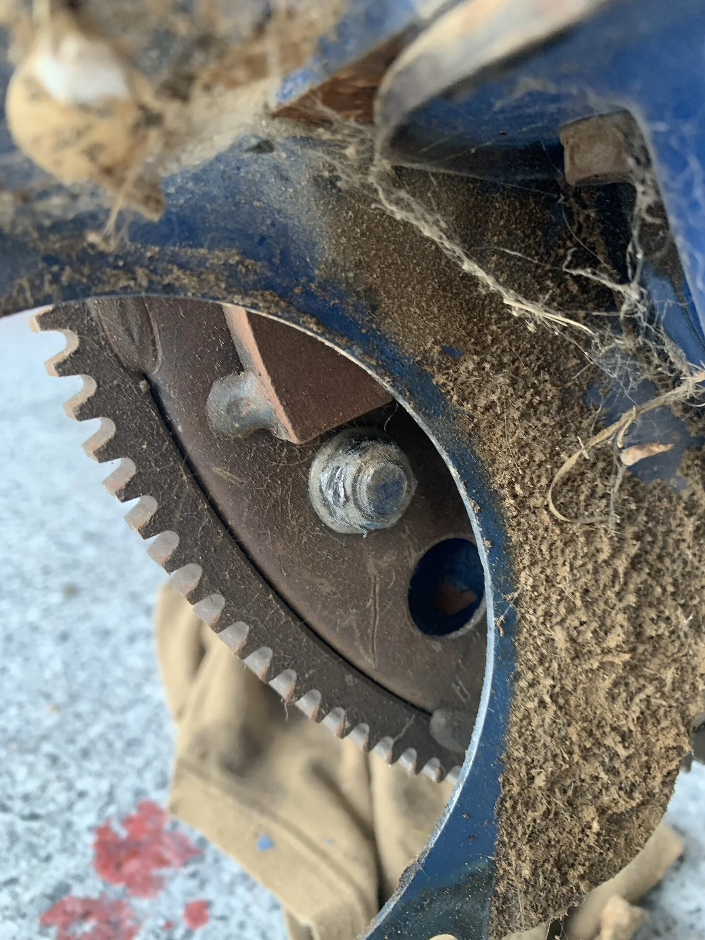

What tool do I need to buy to remove a nut that I rounded off?

I would use a cut off wheel and trim the nut damaging the threads. I would then decide the damaged threads looked good from the drivers seat and call it a day!
The proper way would be a nut splitter.
Can you use a grinder or cutoff wheel to make it one size smaller?

hacksaw blade? tape the hand end up so you don't cut the crap out of your hand.
If you have a welder: weld a bigger nut or just a rod to it. Also the heat of the welding process helps to get it loose...
But I hope you already did get ride of this nut… ohhm… deformed piece of metal.
