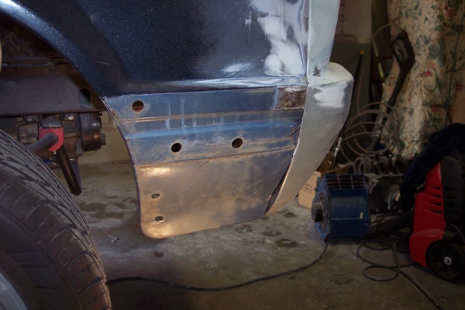

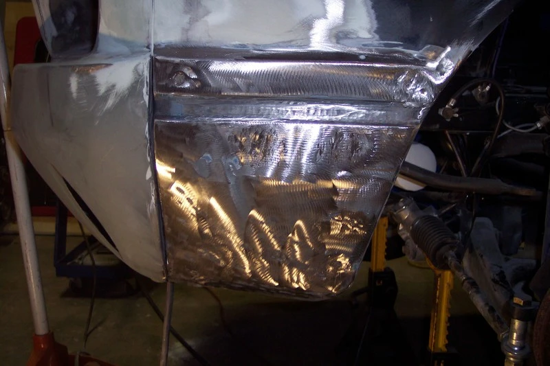

I had one last hurdle to cross before I could consider putting it in primer, and that was to marry the 68 Front valance to the lower front fenders of the fox. Although close, the difference would definitely take some more fabrication before I could fill it over.
It started like this:
As you can see, a bunch of holes and an obvious contour difference, plus the sharp edge at the bottom of the fender all forcing me to break out the cutoff wheel and the grinder.
we're gonna jump to the other side, I forgot to take the "before" pics there
This is what it looked like after cutting, persuading, and welding.
Finished!

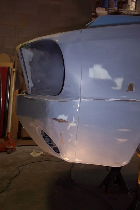

So I moved to priming the rest of the car.
I told the dog to sit down and get himself a beer, this was gonna take awhile.
He prefers the "one butt cheek" position so his package stays cool.
Anyway, back to the primer.
I used 2 part epoxy primer. It'll be the last time I use 2 part epoxy primer.
It dries like concrete, It plugs up every piece of sandpaper I used on it, and it went on like crap.
It took over two hours just to get it smooth enough to even consider taking pictures. Tomorrow I'll be investing in some 2k urethane primer and using the other junk on the wheel barrow, or the kids wagon. Nahh, I'm throwing it away.

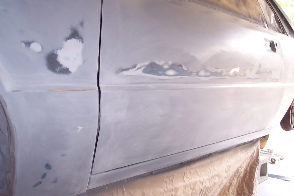

Those of you unfamiliar w/ the fox body, there is a pesky body side molding w/ a channel running right down the middle of the door.
I want to put a mach1 stripe there, so I filled it.
Looking at the above, you might have to look twice to be sure you weren't looking at a 68.

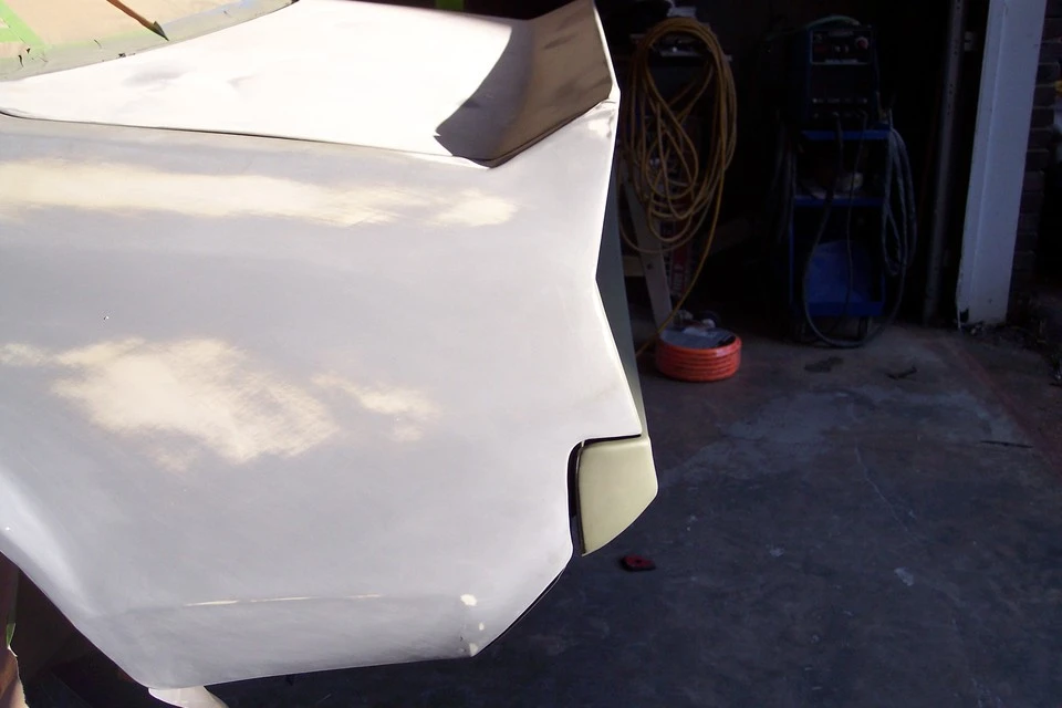

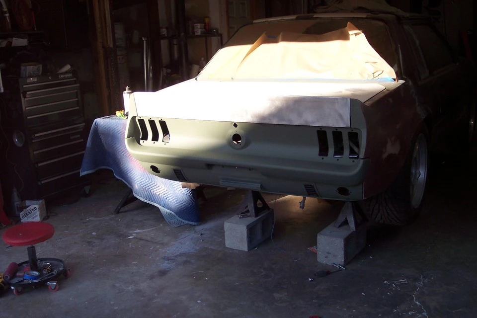

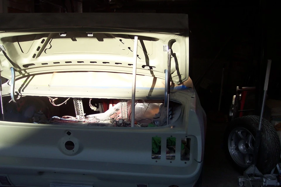

I decided to focus on the trunk, and rear end. It has been close for months now, but far from primer-ready, and miles from paint-able.
The trunk was first. Previous dude decided to change the color from factory, and while he was thorough enough to paint that color everywhere, he neglected to prep under the trunk and the paint was poorly applied.

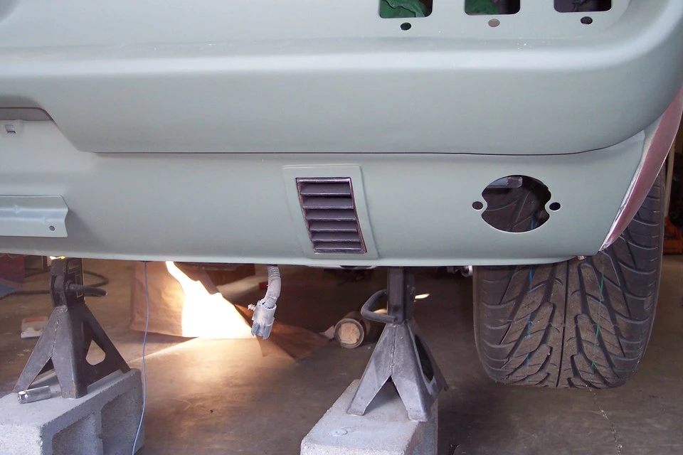

So I stripped it to bare metal, filled the gap where I welded the spoiler on and created a smoother radius. I finished the tail light panel where I cut and sectioned it. I finished the rear bumper where I cut and sectioned it.

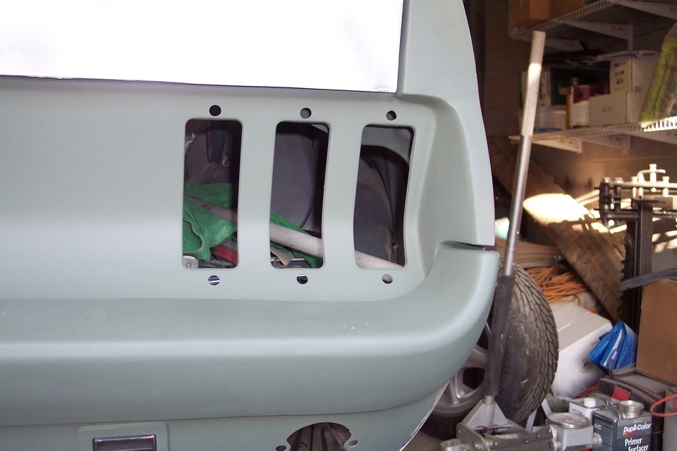

I made some trim rings to finish out the exhaust tips and put all of that in etching primer.

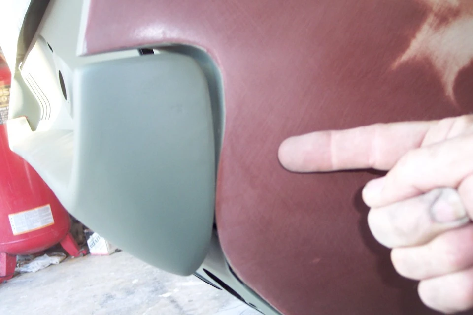

Here is where I get discusted w/ myself. All of the sheet metal is hand fabbed. The bumper was on and off the car 3-4 times so I could get this gap to resemble the gap that you'd associate w/ factory. The sun is setting here, so the shadow makes it look huge,....it's not.
I don't know,...blame this on sleep deprivation, Blame this on my damaged eye, Blame this on my crack addiction, BLAME THIS ON MY STUPIDITY!
Again, the bumper was on and off several times while I made this side "fit". However it clearly does not "fit." I'll have to check tomorrow and see if there is enough bondo on the rear edge to sand off so I can get the gap even'd up. If there is'nt enough excess to sand off, ...I'm screwed.
I didn't like the exhaust tips just poking through the sheet metal, so I made these trim rings out of .080 x 1/2" mild steel. I rosette welded them on from behind.
W/ the 16 ga. spoiler welded on the trunk, it ended up weighing about 30 lbs at the edge. I cut the torsion bars out a long time ago due to interference w/ the 6 x 9's that are mounted in the package tray. I built the lift shock option today so that It will self open after the trunk is released.
So, aside from hopefully having to sand that gap to a more consistent spacing, I'll move on to the passenger side and start all over again
