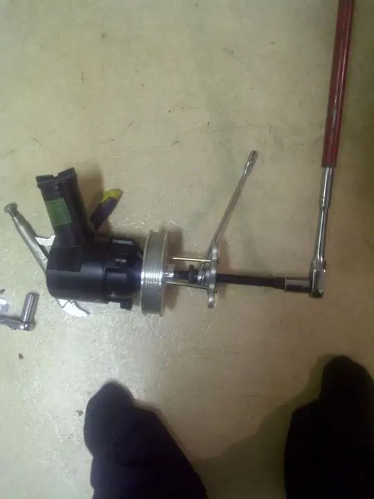

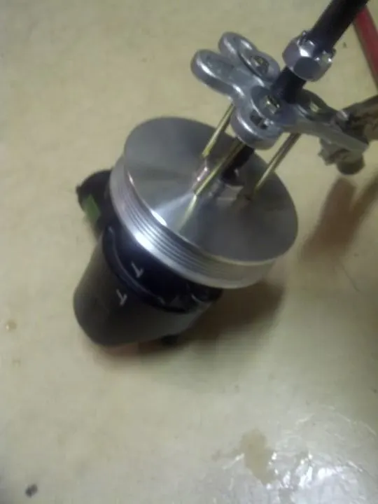

Well my dumb**s went and stuck a new March Performance pulley on to a new power steering pump without thinking about getting the mounting bracket on first. No big deal right? Just take the pulley off. Oh no, no no no no... I wish it were that easy. While it wasn't hard to remove the old pulley with a power steering pulley remover, these March jobbies use a three hole system like a harmonic balancer. I tried using a harmonic balancer puller with some grade 8 bolts and I've just managed to bend the bolts : D I gotta tell ya the engineering on this pulley is amazing. All that force and won't budge a friggin mm. Any ideas on how I can get this thing off? Impact wrench maybe?
Pully is now off, I poured that sucker a tall glass of physics.
Ladies and Gentlemen, I give you 'The Infernal Machine!" One part home-made breaker bar, one part harmonic balancer pulley puller, one part power steering pump pully puller (the nut that the wrench is hooked up to) And finally, One saucy wrench.

Doomstein I owe you a beer. I was ready to throw the pump and pulley away and start over fresh till I read your post. March screwed the pooch big time here with this horrible design. Using your hybrid tool method works like a champ. I tried to muscle this thing off for two days. Broke two different tools and my ego. Thanks buddy!
Unfortunately my 1/2" impact wouldn't do the job. Without the hold down nut from the power steering pulley all it does is twist the long bolts or crush the washer. The second i put the hold down nut behind the balancer it came right off with my 1/2" ratchet and a little elbow grease. My problem was I put the pulley too far down on the shaft and had to back it out a RCH. Personally I quit taking my car to the shop, tired of dealing with them. No shop round here would charge $5 for anything anyway. Minimum half hr labor if not full hr. Plus I get the gratification of accomplishing it myself. Threads like this make my life easier and glad someone took the time to post how they solved the problem.
