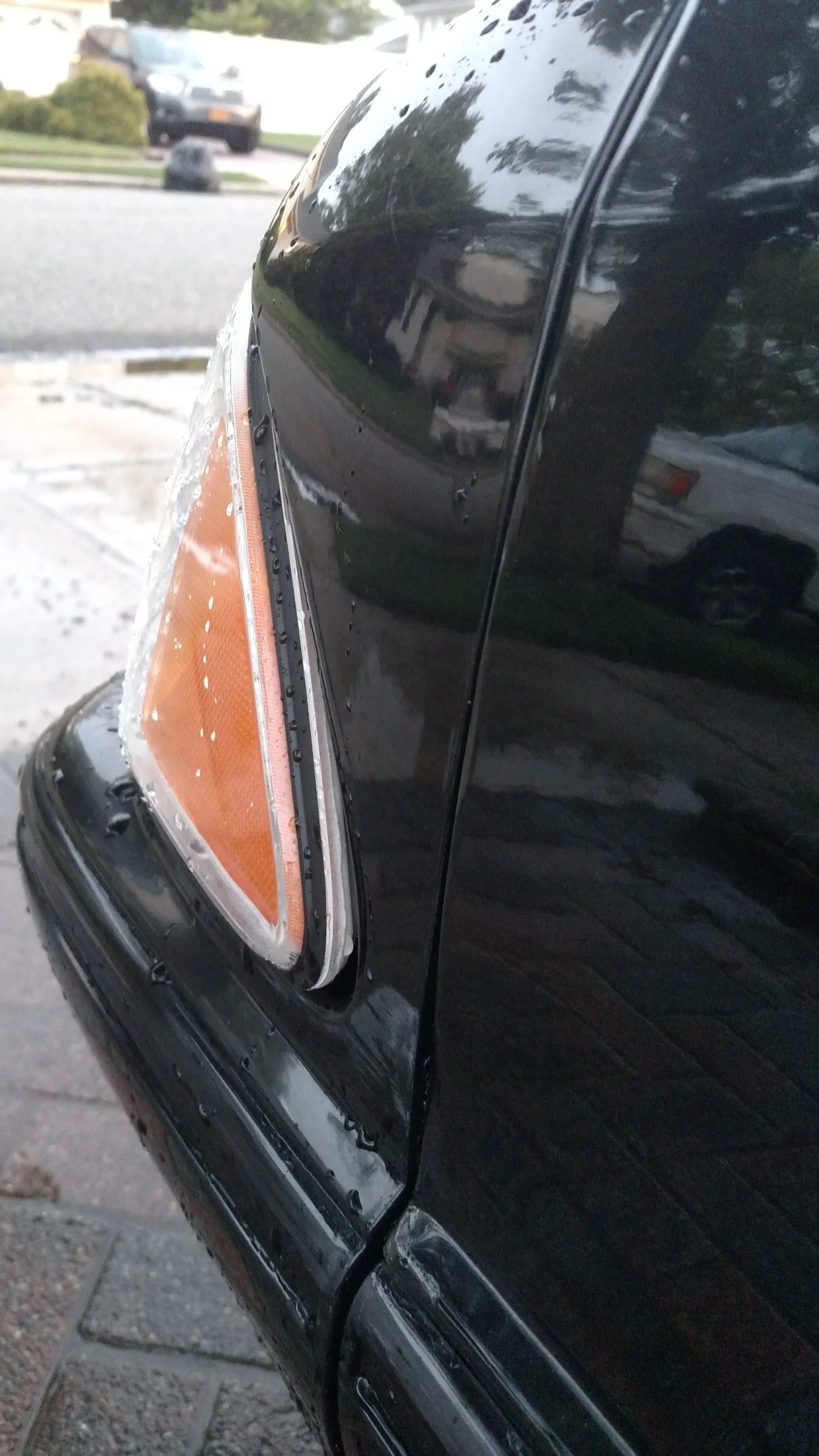

Fresh headlights! I can finally see at night! They still need to be adjusted up, though. Check out the drivers corner light. I don't know what the deal is. The old one fit nice and flush and there isn't really an adjustment. I might contact LMR and see what they say.
My aftermarket headlights which came with the car also sit that way. Not sure if there is any out there thats flush. Let us know what LMR says.
LMR sent out a replacement right away. That was back in May...it's still sitting in my garage. I guess if it's still an issue i'll just to shim it or something. Maybe I'll tackle that this weekend.

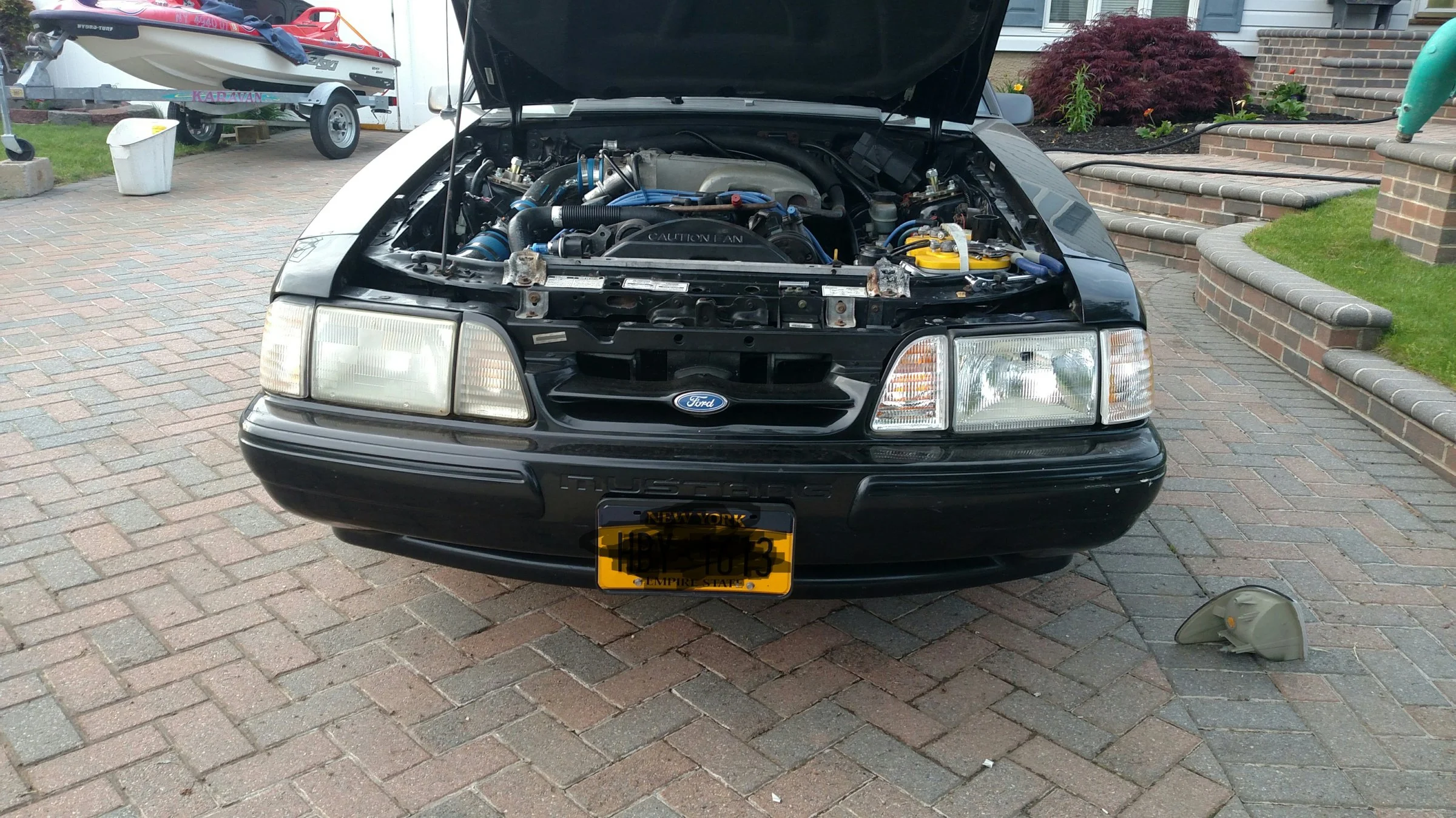

Ok small update, to keep the thread alive. I've been driving the car a lot and it's running great. 150 miles around town just this weekend. I got new headlight adjusters from LMR so I can finally see pretty well at night. I also popped in the replacement corner light and it's better, but not as good as the OEM was. This second one did not require any trimming like the first one did though.
So winter plans for the car - the motor will most likely be yanked out in order to gain some access to the strut towers. They aren't in bad shape but could definitely use some cleaning up and rust proof coating put on. My buddy is looking for an explorer that he can steal the 8.8 from for his Cherokee, so I told him to look out for a 96/97 that I can take the heads and intake from. There's a few around for ~$400. Split that in half, then junk the explorer after and then the heads and intake are dirt cheap. Send out the lower to TMoss and get some alex valve springs and a cam (TFS1/lunati/comp) to round off a very budget HCI. Thoughts? I still have that pile of parts from earlier that need to be installed. Upper and lower control arms, rear shocks, subframe connectors, 3.73s, and a full rear end rebuild kit.
In case anyone didn't see it on the other thread, here's a pic:
