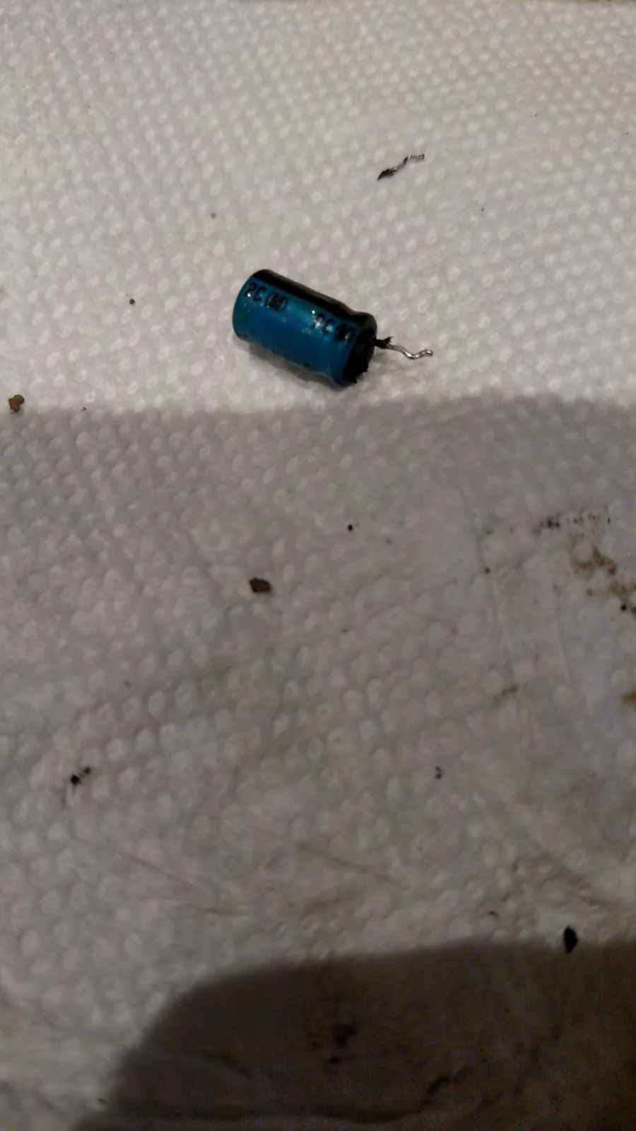

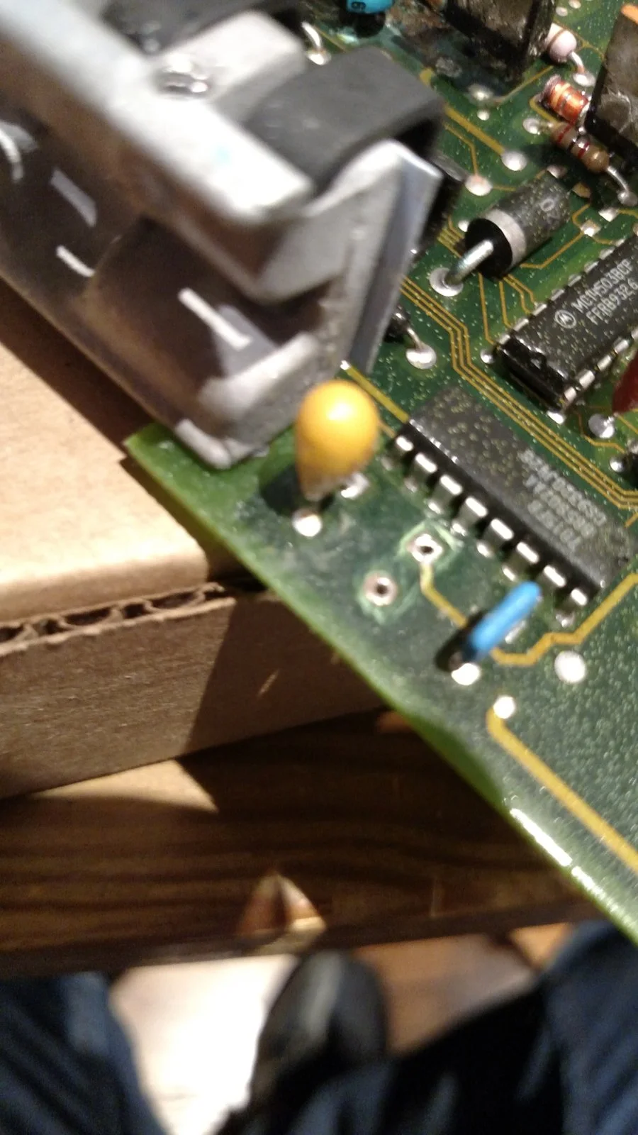

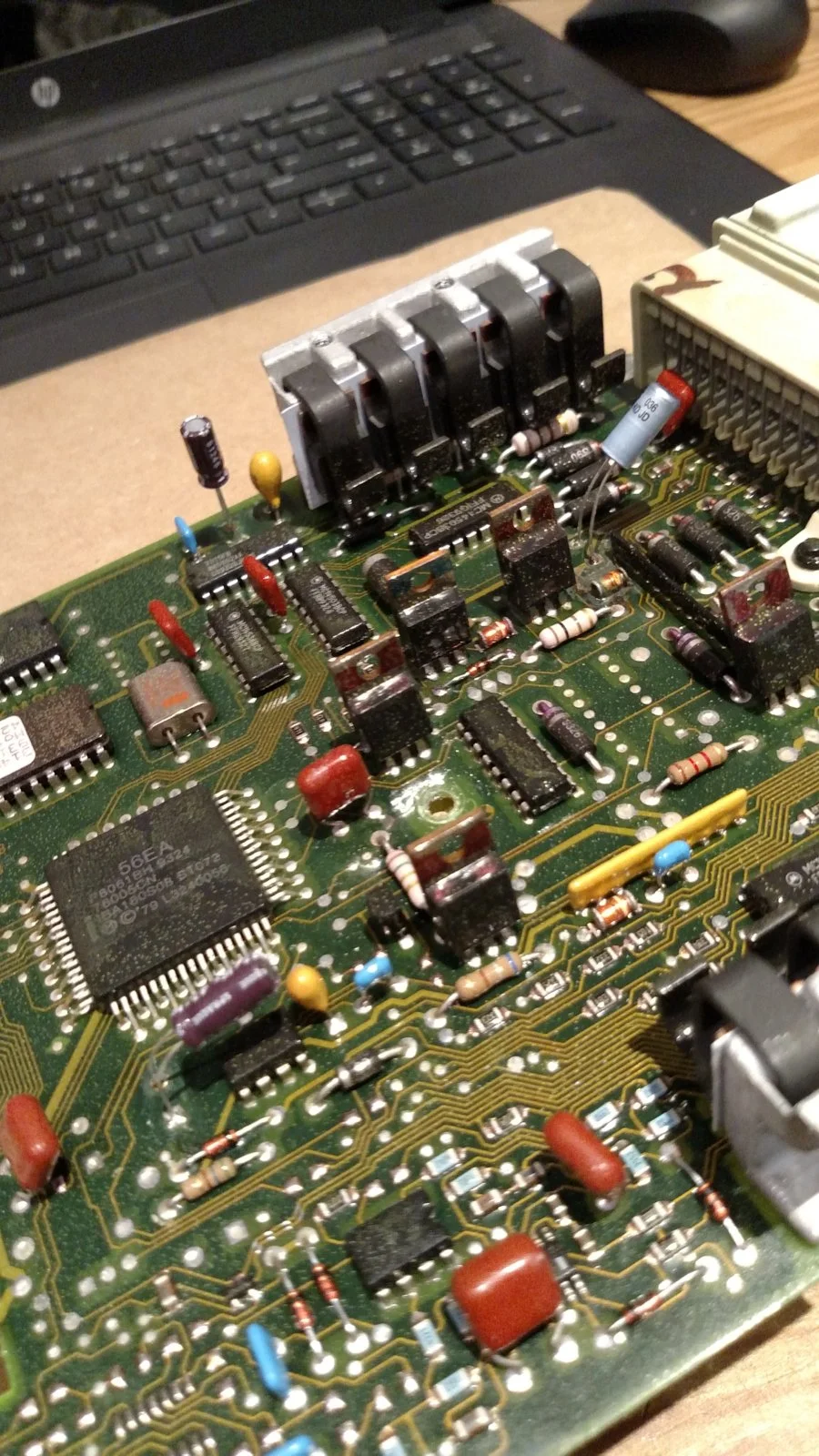

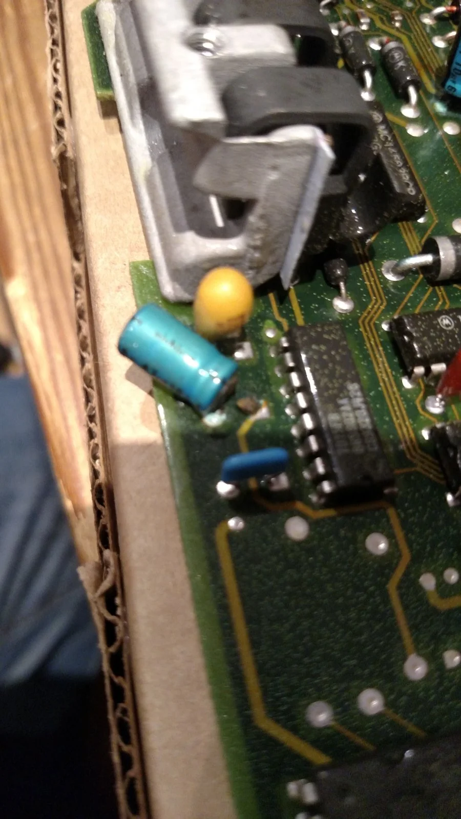

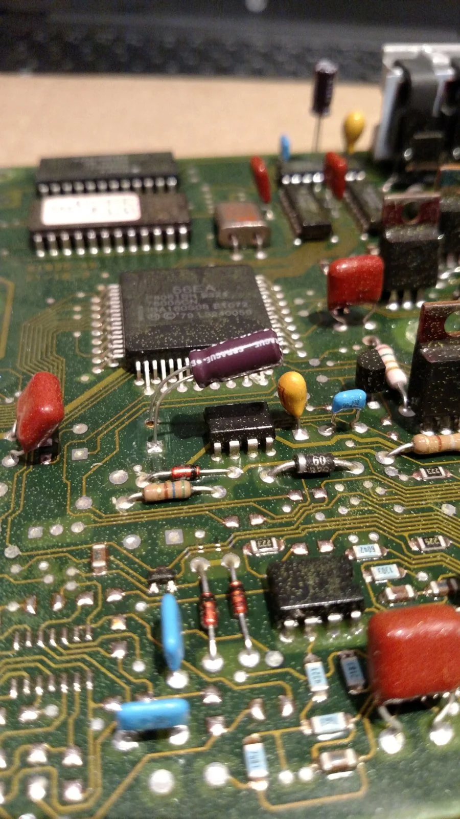

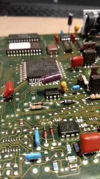

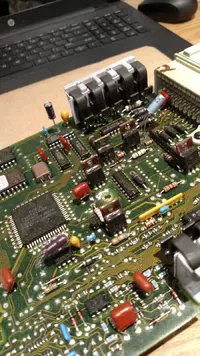

After tracing a bunch of wires from ecm to coil, spout, etc, I checked the ECM and I have one burnt cap and another leaking one. I ordered some caps to attempt the repair. If it doesn't work out I'll have to get a reman. I'm really hoping this fixes the code 18 though

Post some pics of the repair process.... I'm sure itll help folks in the future.

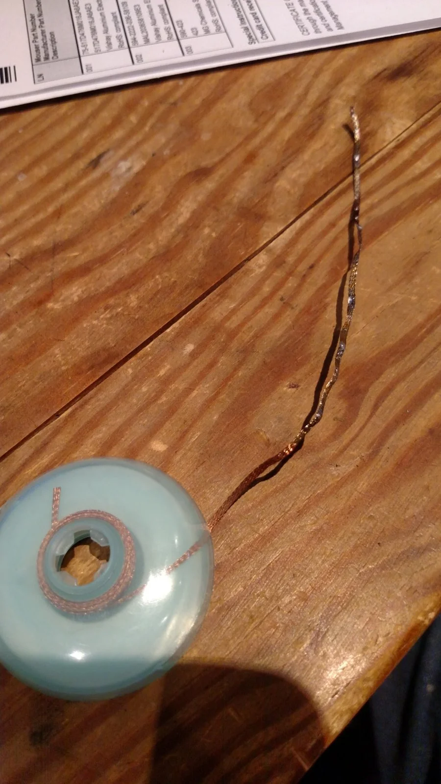

I had to replace 2 caps in my old computer that went bad. It wasn't that bad of a process. A recommendation is to use a straw for desoldering the old caps. Put the soldering iron on the old solder tonremelt it and blow through the straw to force the olds solderout.

ok so it sort of worked! For the solder removal I picked up some solder braid, which was very helpful. Just lay it over the hole once the cap was out and touch the iron into it and it sucked the solder right out. One of the caps was completely detached, the second was barely hanging on, and the third was mint. Replaced all three. Car definitely runs better in the mid (it was lean before) but I'm still getting that stupid KOER code 18 and it likes to almost die when returning to idle. Along with new code 8 (???) and code 12. I'll try a new IAC for code 12, but it idles up when it's cold and when the KOER test is going on so I'm not sure if that will do anything. There was one more code that I can't remember but I had to shut the car down for the night since I could feel my neighbors hating me.

Some pics of the process.
