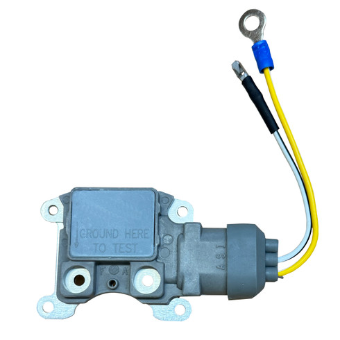

As far as alternator charging what are your guys opinions and thoughts on this product? I did the 3g conversion years ago.
Why not just install a resistor in the harness, like the one off the back of the OEM cluster? Thats all I did on my SN.

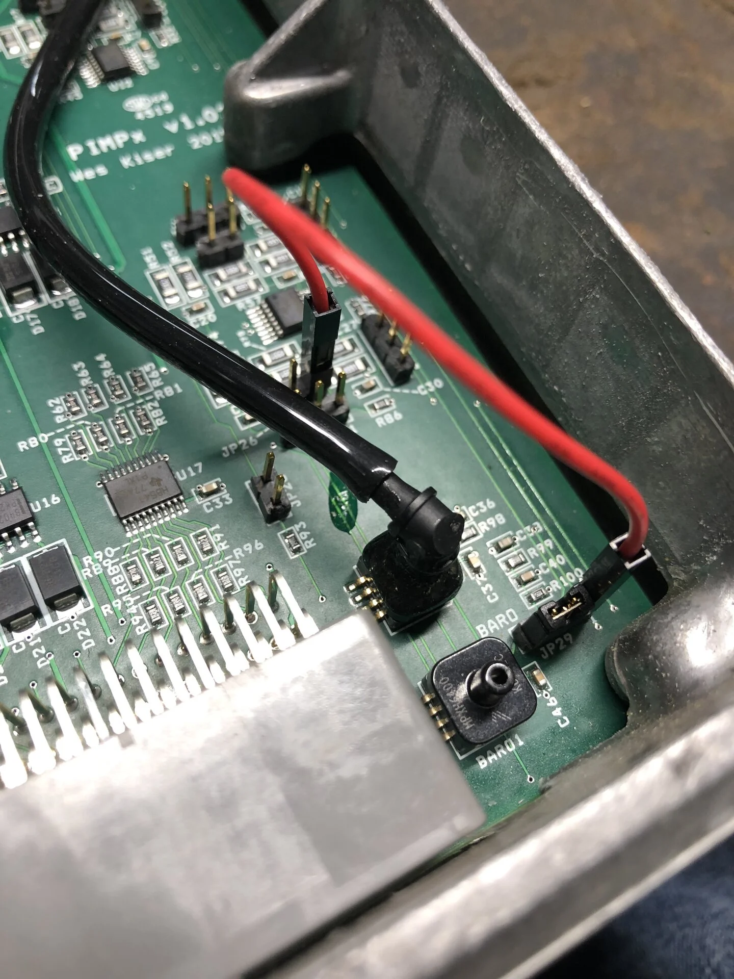

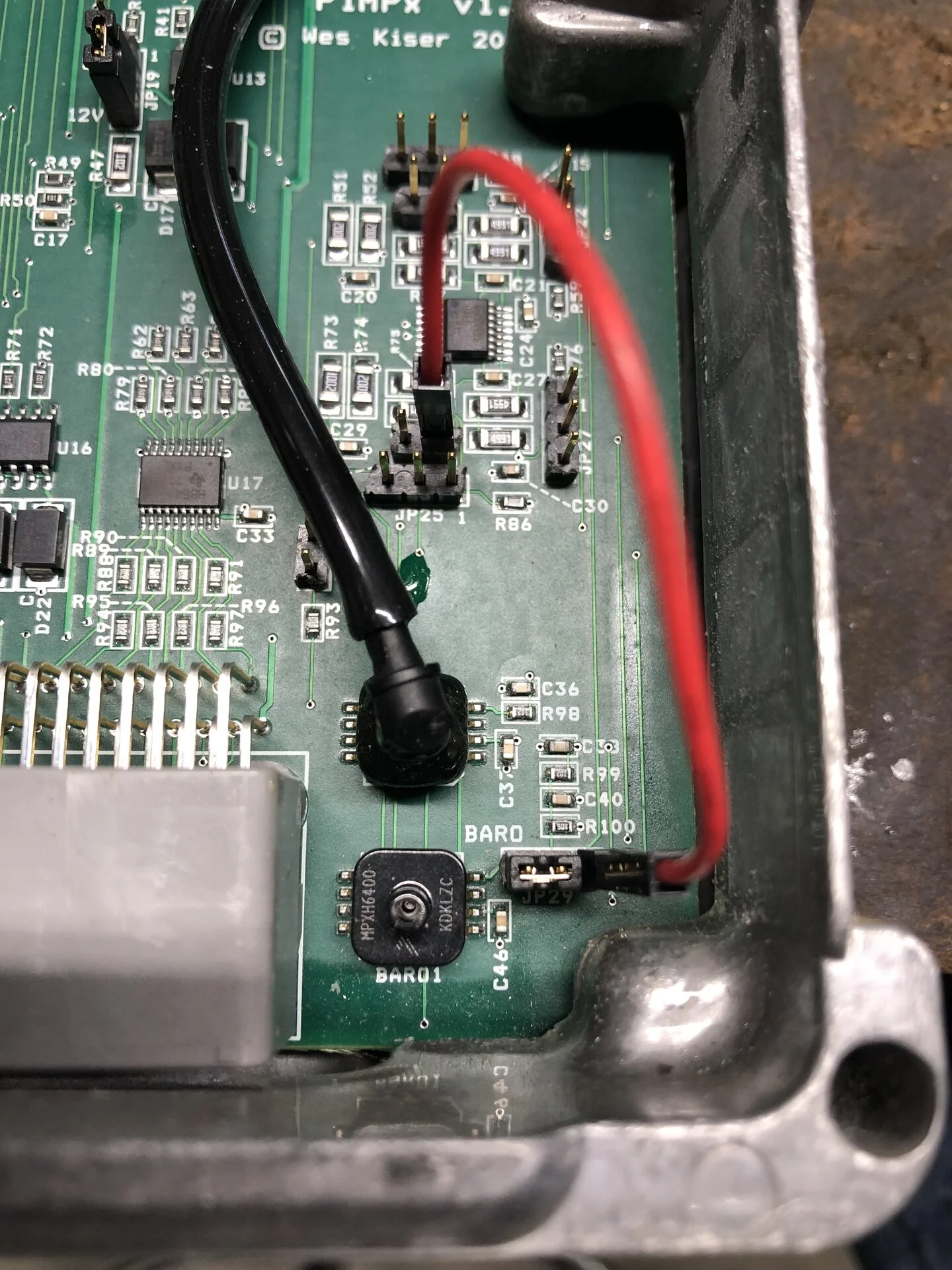

Have a few questions, if I may?
Running a Pimpxs with what I assume is the 2v of the DDefi dash. And love it
1Q. In the pictures I show the jump wire going from JP29 to JP26, but I’m unsure on what side( left or right) of JP26 do I put the jumper wire?
2Q. I’m using the internal baro of the Pimpxs so the jumper is on 2-3 leaving 1 open, with this affect the outcome?
3Q. I am running a spartan wideband on each bank. JP12 is my driver side wideband, what would you recommend to do?
Thank you in advance

I am going to need some more context for these questions.
