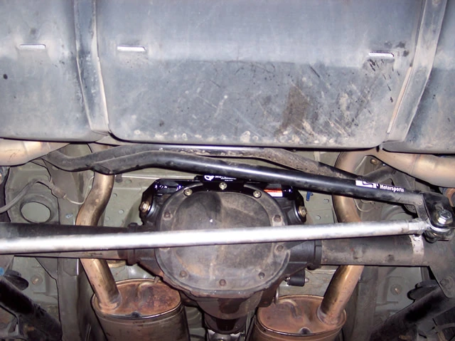

san~man said:
I haven't read of many people actually using it, even on CC.com.
Also, you better plan ahead and have the correct spring rates. The front requires either 750-850 or 850-1000 :eek:
At least the MM T/A is proven, the tri-link isn't.
I use to have a link to a guy that installed one on CC, i think he had 350/lb (coil-over)
http://corner-carvers.com/forums/showthread.php?t=20791
