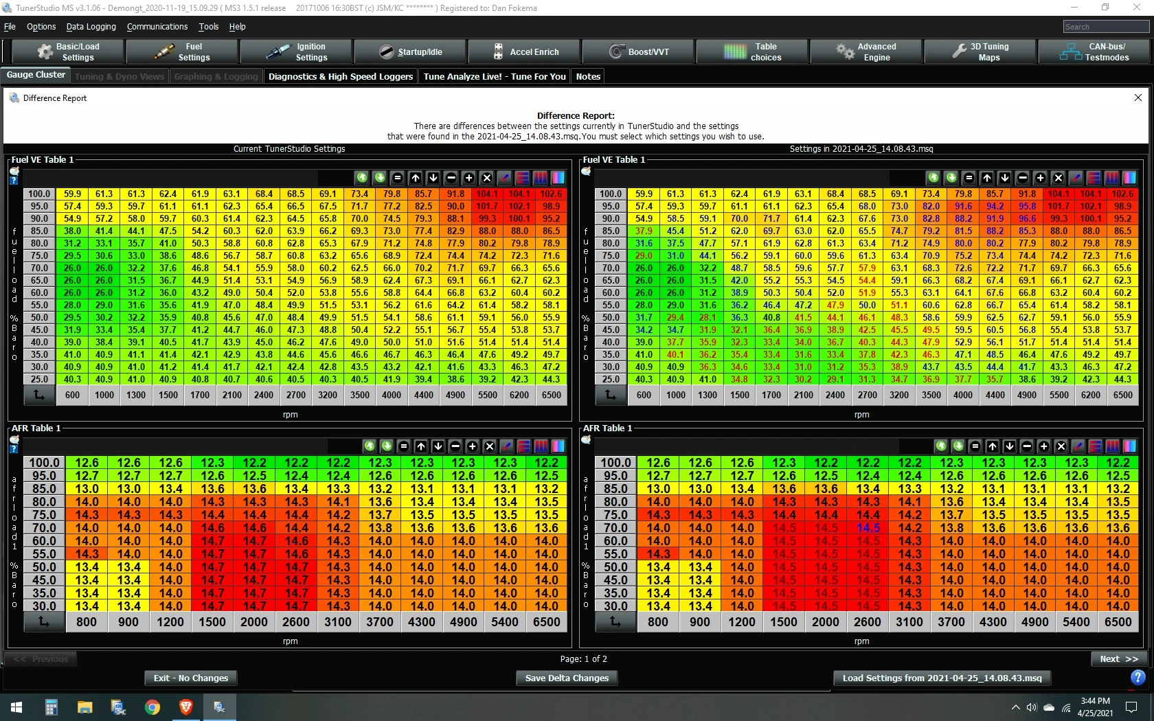

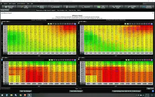

I messed up and completely forgot to datalog it, here is a screen shot comparing my fuel table before and after the first auto tune.
i have it set to very easy, when should that be changed and is it ok to have it making the changes on the fly or should it be done after the drive?

Fuel looks good, work on adjusting the idle advance correction curve. looks like it gets into a small swing, you could try to disable it first if that is worse then work on adjusting the values. You may be able to tighten the values next to zero and fix the problem

I see the AE settings need work but the MAP sensor is responding exactly like it should with throttle input [an immediate response] I see nothing wrong in this log file, you are almost hitting targets the fuel needs some love but the EGO correction needs work.
I see no reason to remove the ecu from the kick panel, if you like I can make some changes to the tune file to help you move in the right direction and give a brief explanation of the changes.
