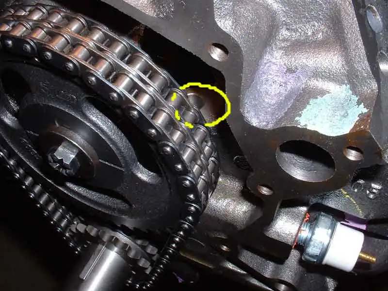

Let me know how it goes....my motor in the car, so I cant visualize the problem??? can you snap a pic for us???

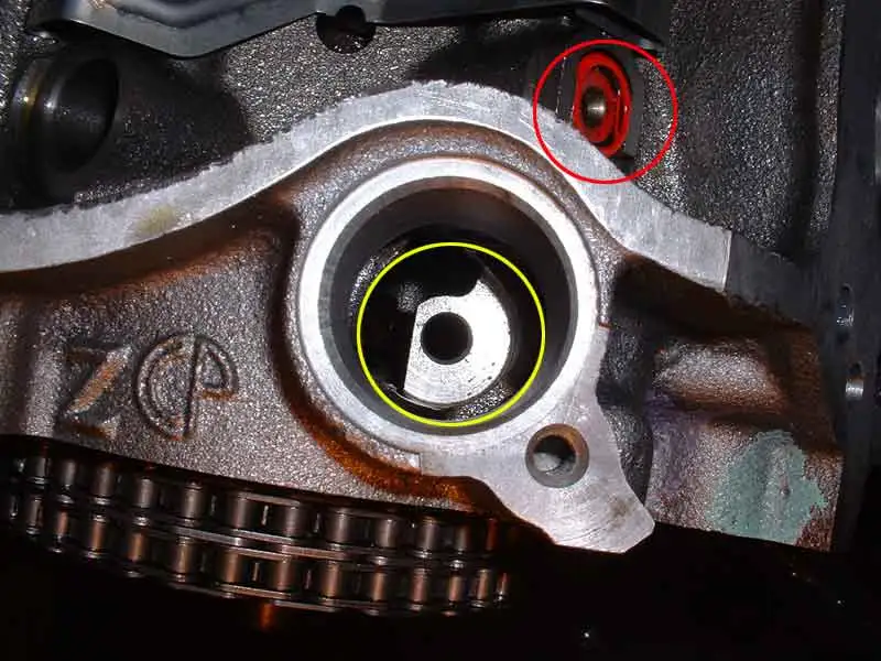

It's where the bottom of the gear rides on the yellow circled surface.
Rick
(Red circle - thanks again, Andy :D )

I had the cam out, pump out, shaft out. It was a bare short block assy. Dropped the distro in and bolted it down. No clearance. You have to have the cam out to be able to get a feeler gauge in there. The book that I have (Mustang Performance Handbook - Mathais) that says .040" clearance is perhaps considering a brass or iron gear and not the steel one that's on it????
