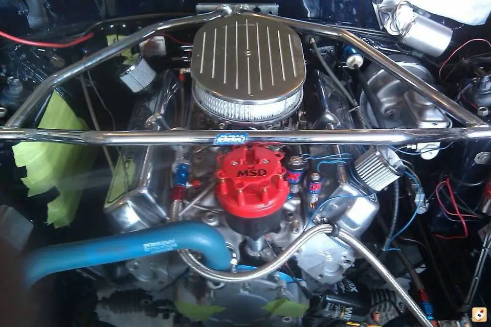

I have an MSD Pro Billet Distributor, although I had to change the p.o.s. MSD TFI modual a month after I installed the distributor with a Motorcraft TFI I have been problem free with it (so far).
