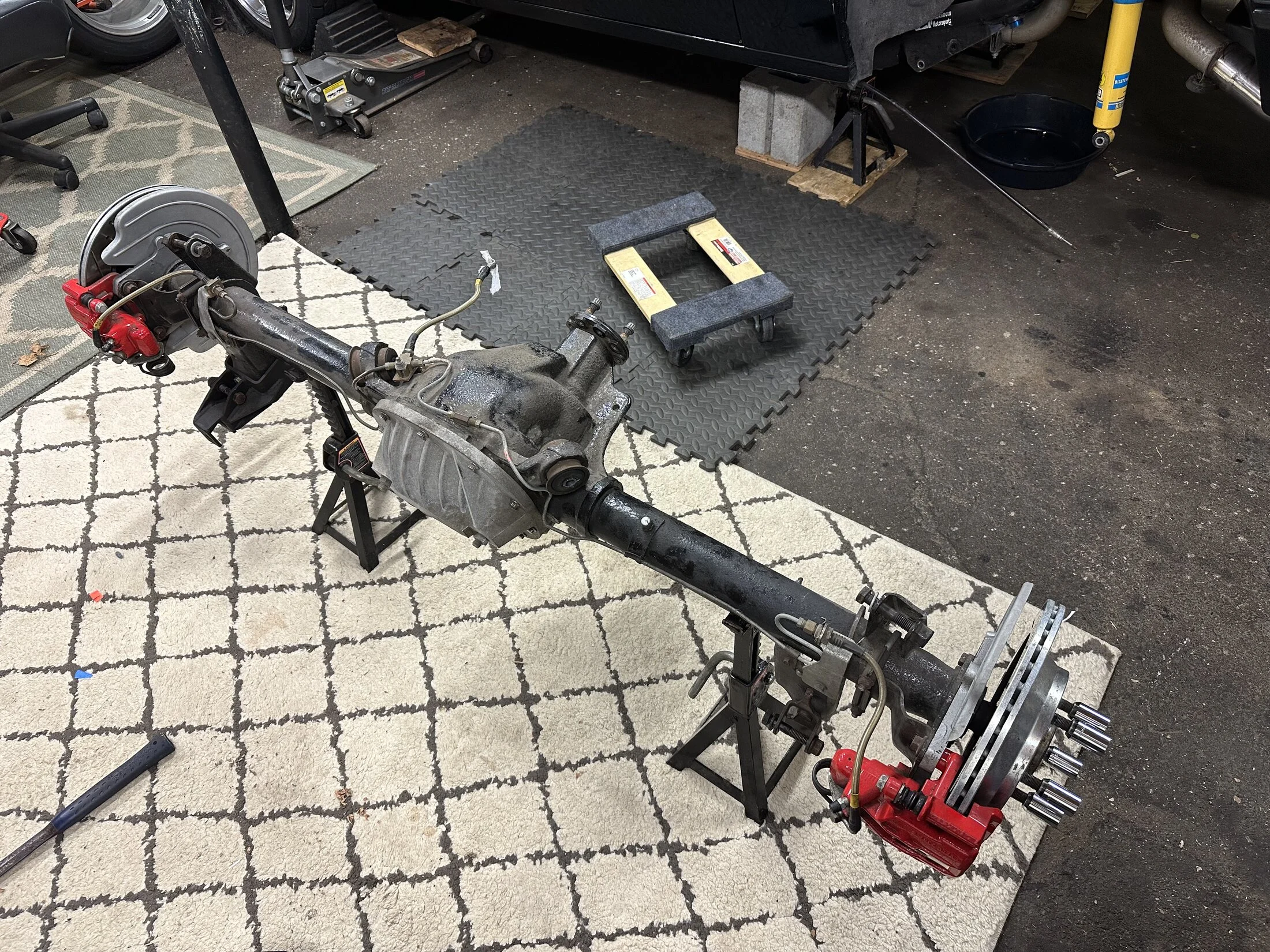

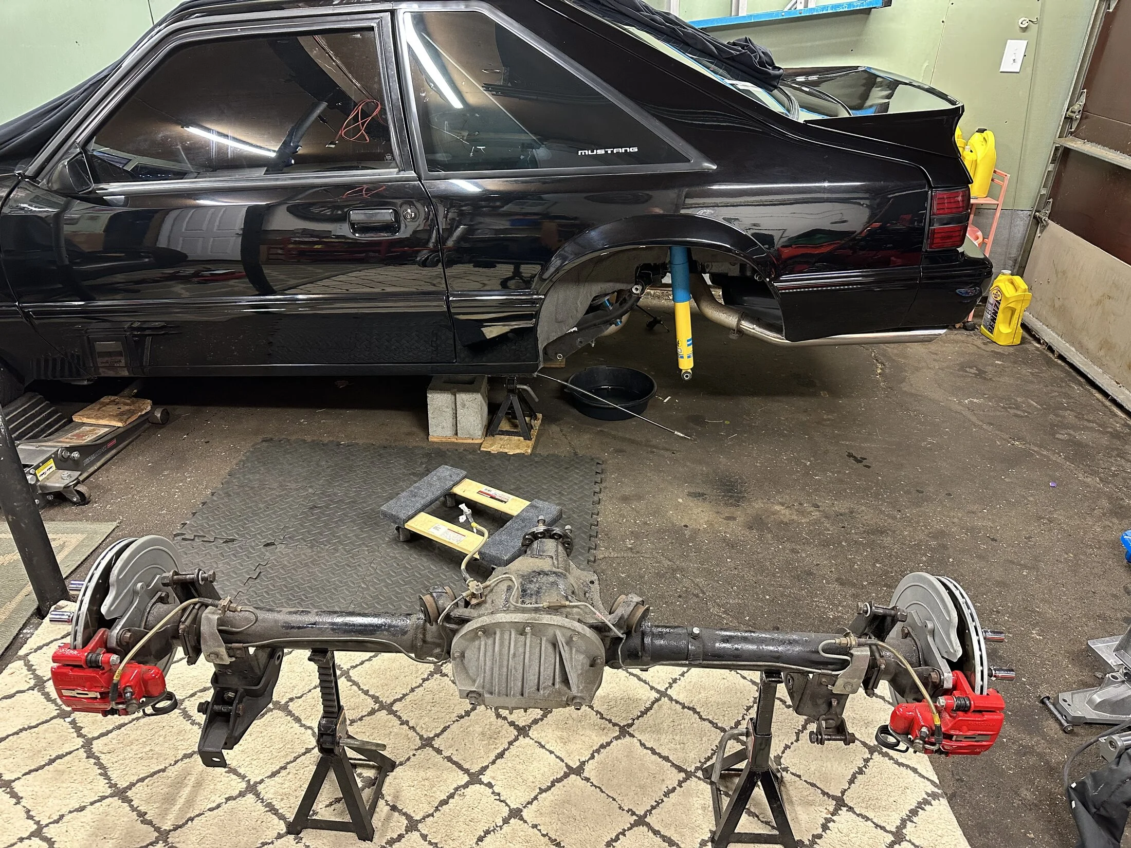

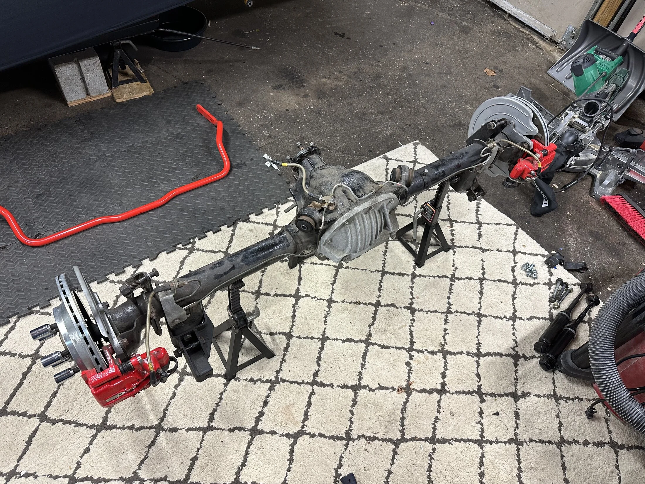

Damn, you beat me to it!I’ll clean the axle up a bit and possible refresh a few things here. It’s just dirty.
I will be removing the SN95 brackets to install offset caliper brackets and fox lenght 5-lug axles so I can run my new wheels. I figure I can pick up a 1/2” spacer from MM to run these wheels for now and still have it look ok.

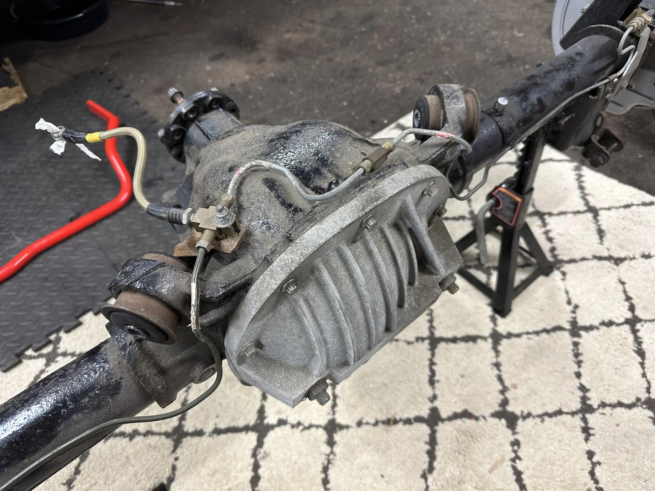

I cannot decide if I want to swap the 3.73s out for 3.27s now, and rebuilt the t-lok. The t-lok has never been touched and is original, and it still spins both wheels. I am not a fan of the short 1st with the 3.73s at all. Since I won’t be swapping trans anytime soon, I figure this might make my gears a bit longer for me. I’ve never liked the 3.73s with the 5-spd at all.
I was encouraged to put 3.73s in my ‘86, but I decided to go with 3.55s. If I were to do it today, I’d go 3.27s.I’ll clean the axle up a bit and possible refresh a few things here. It’s just dirty.
