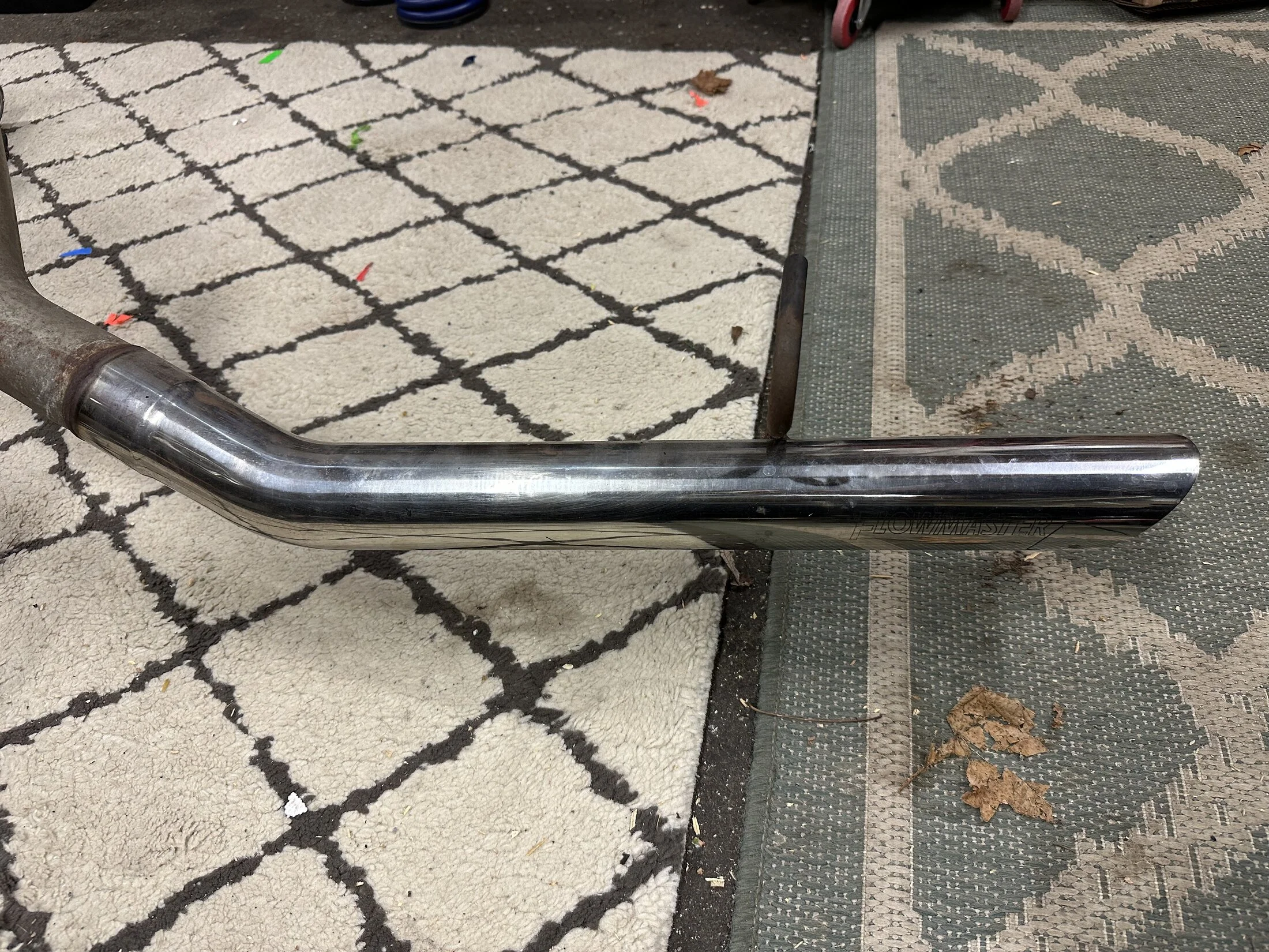

Pulled one side of the exhaust off. Easy as pie to do with no rear axle. Only did one side because I’m going to use the other side to help mock up my new exhaust so I want one on the car.
I also left the upper control arms bolted in place to help with understanding clearances and routing
Was going to try to reuse these tips, but now that I see them I don’t think I’ll get them out. I should just get the SS flowmaster tips.
That’s a 20 year old Flowmaster American Thunder cat-back with I believe the older super 40s.

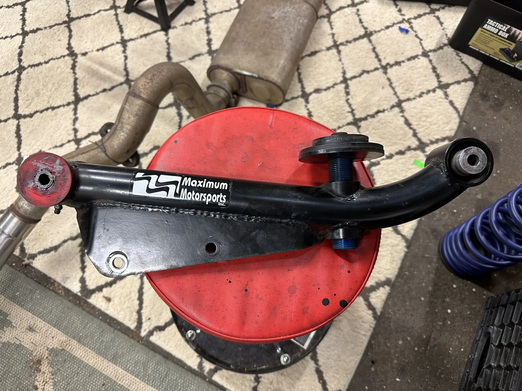

Pulled my lower control arms up to clean up and regrease.

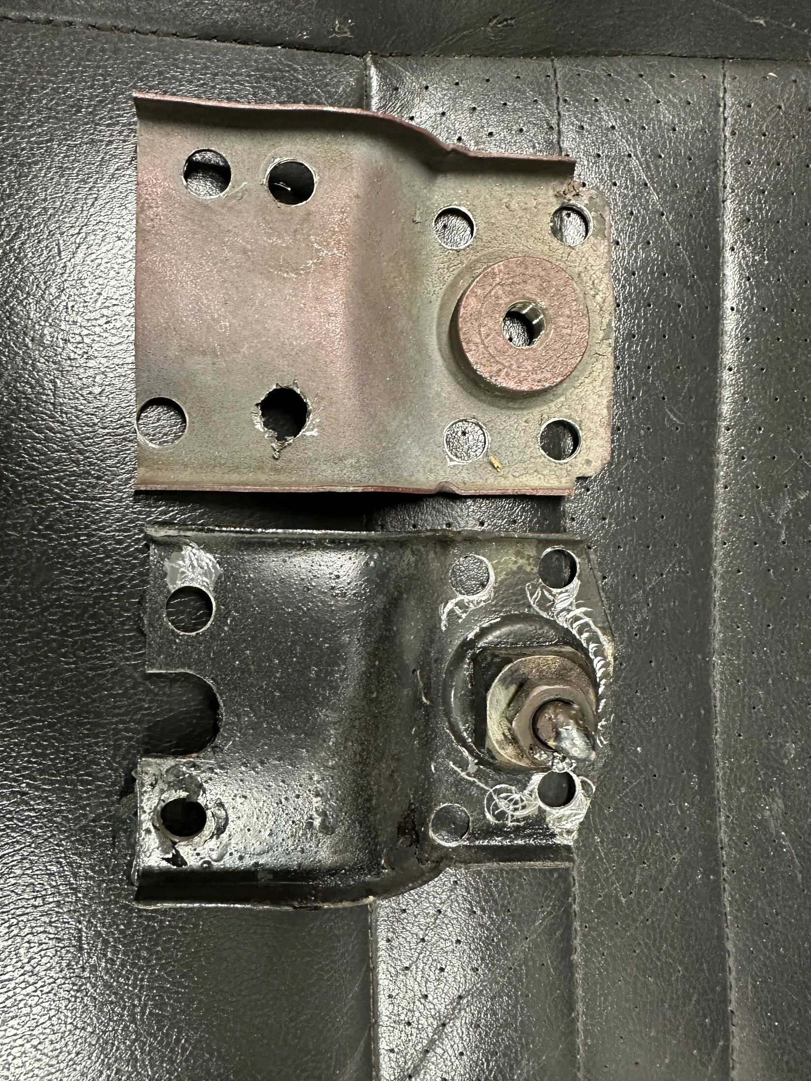

Now the bad news. With the exhaust and control arms out of the way, I discovered my inner subframe connector welds weren’t all that good and cracked. In my defense it was just hard to get in there. Fortunately the outer welds held fine. Now I know why I read in some places to drop the catback to get in there to weld the SFCs.
No big deal. I inspected all the other welds and they are fine. Now that I have access, I’ll fire up the welder and weld them properly now.

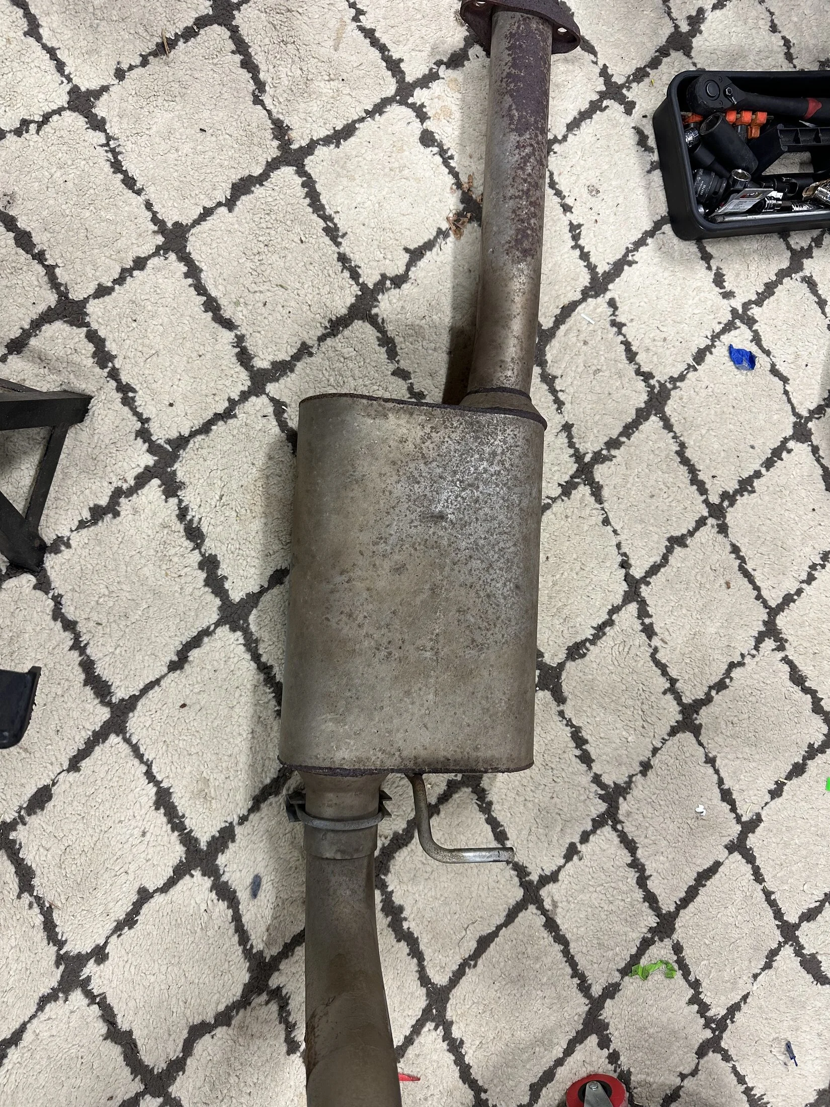

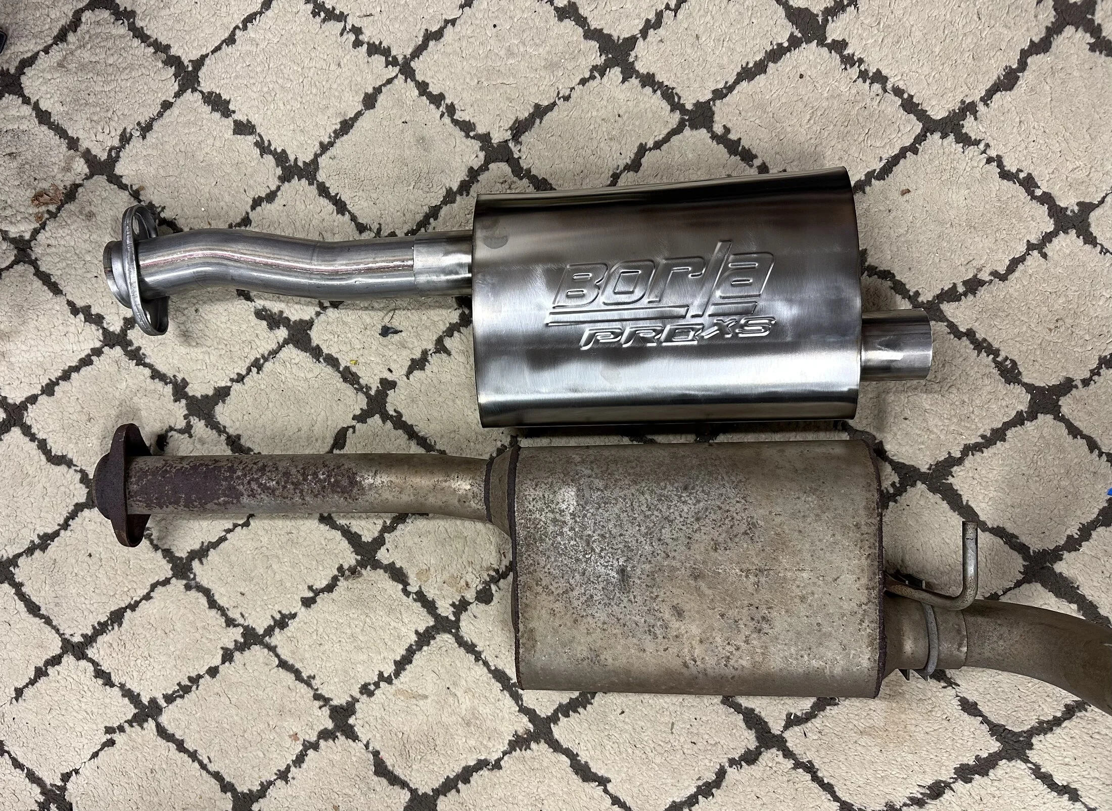

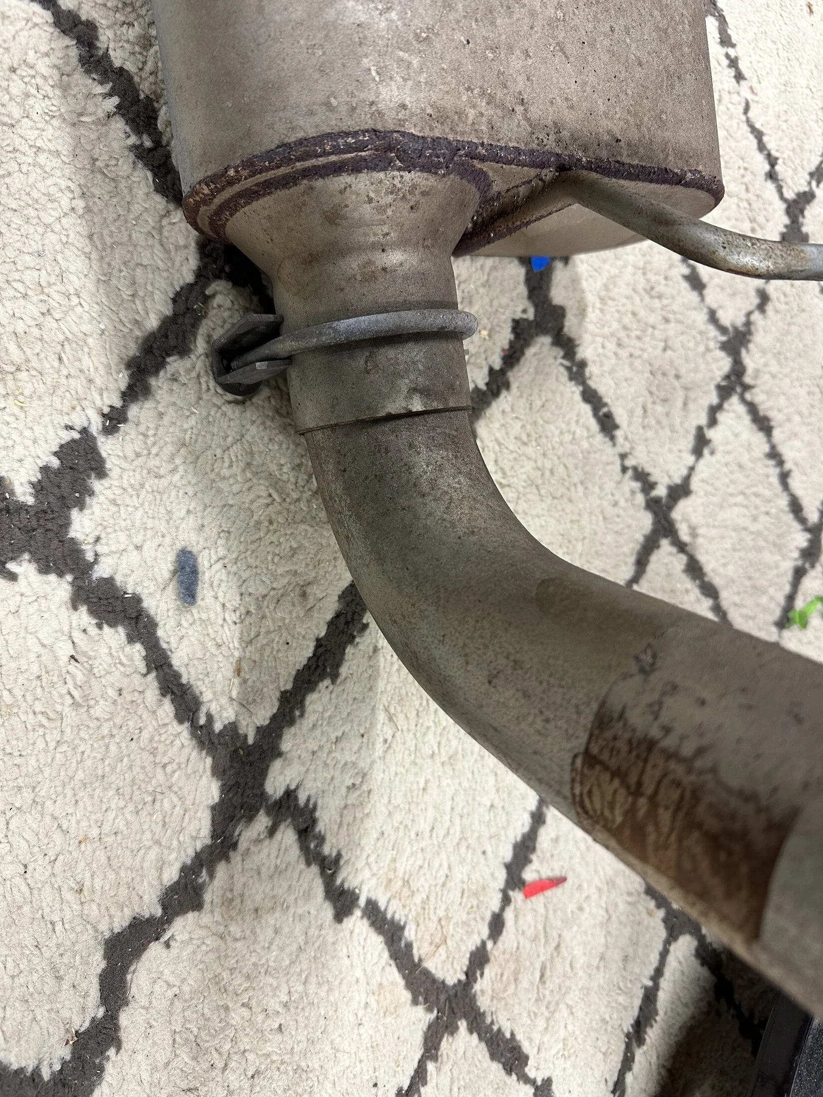

Mock-up of the new mufflers. I gotta figure out the correct angle for the flow tubes. The flowmaster tubes are pretty straight, but these have a kick so not sure if it’s to lower the mufflers or raise them up a bit. I’ll have to wait until I put the exhaust tips on to see what works best.
I also may need to grab a set of SS exhaust hangers to tack onto the mufflers for some additional support.
I have to get some clamps as well.
The actual tips are in fine shape. What should I do here? Buy new SS tips or try and reuse these aluminumized tips? Hmm….

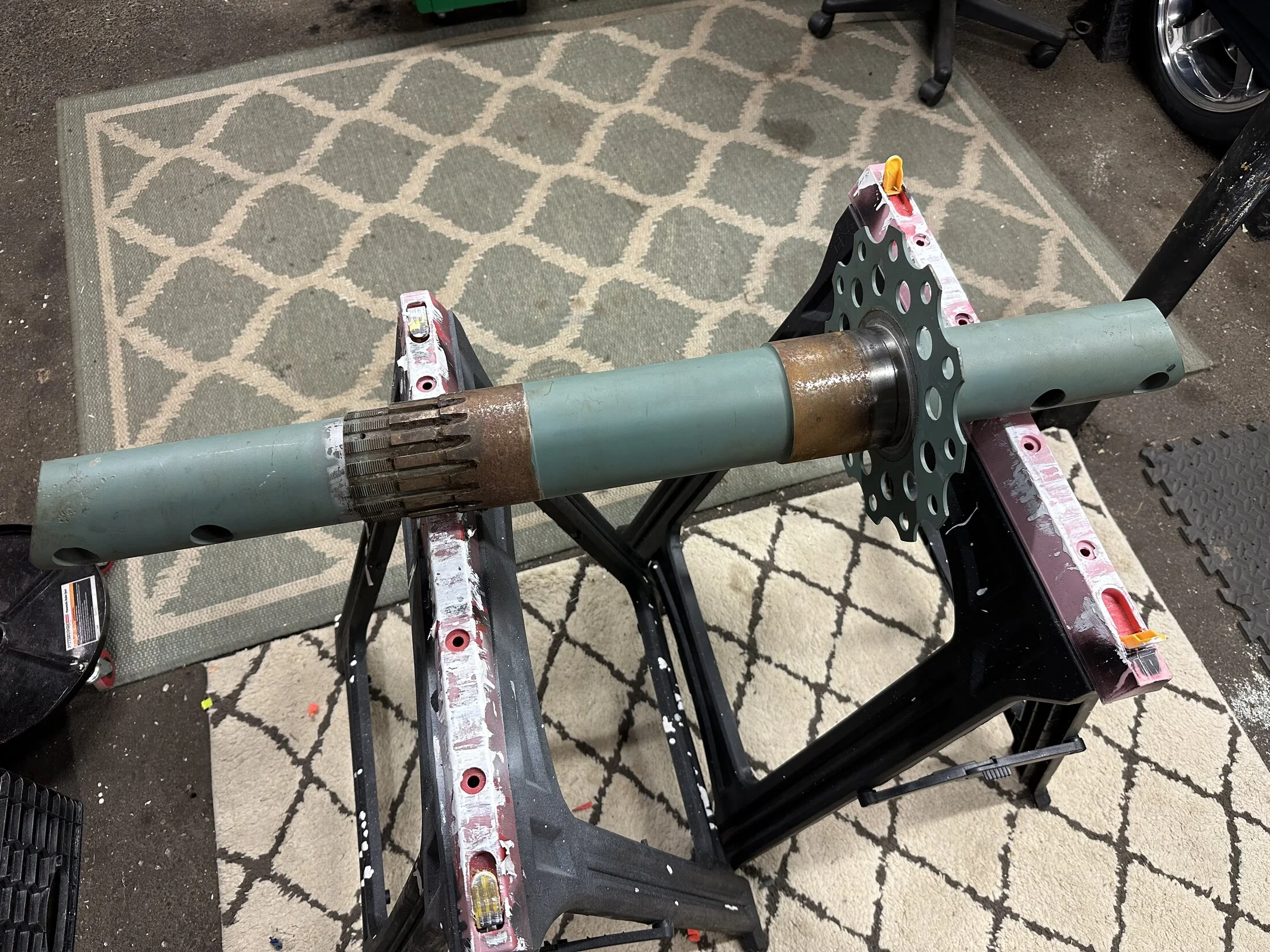

And randomly, a supposed main landing gear axle off a WW2 bomber. Don’t ask how I came to possess it
I haven’t confirmed that it is yet, but the part numbers I’ve pulled off various pieces that were on it do suggest it is from something in that time period due to manufacture stamps and part number formats. Finding info is rather difficult as you can imagine.
I have some spacers and the axle nut as well. All seem period correct.

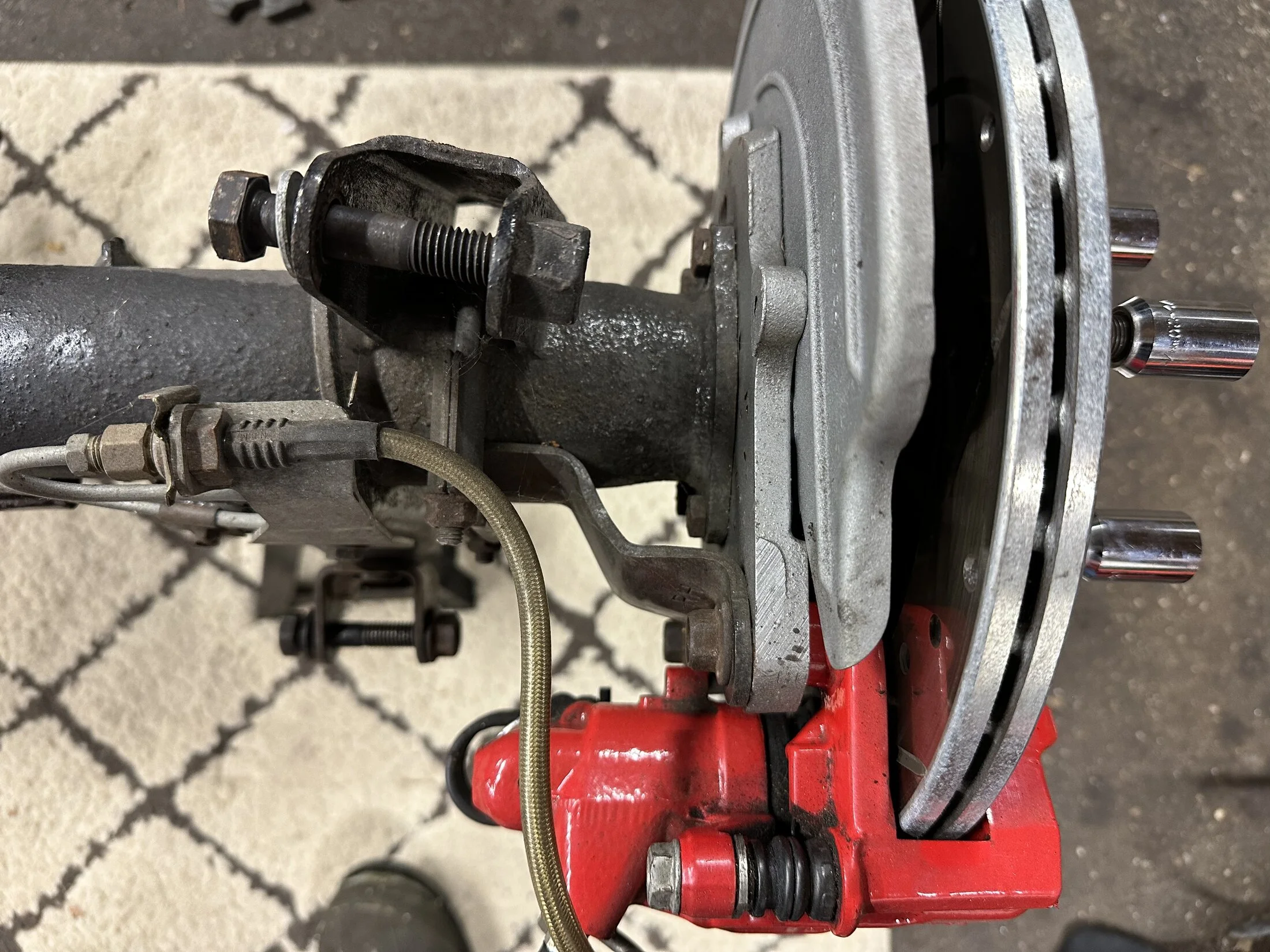

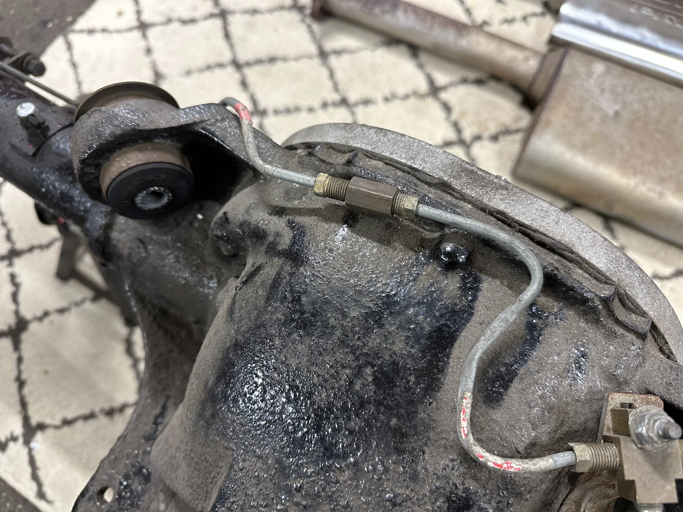

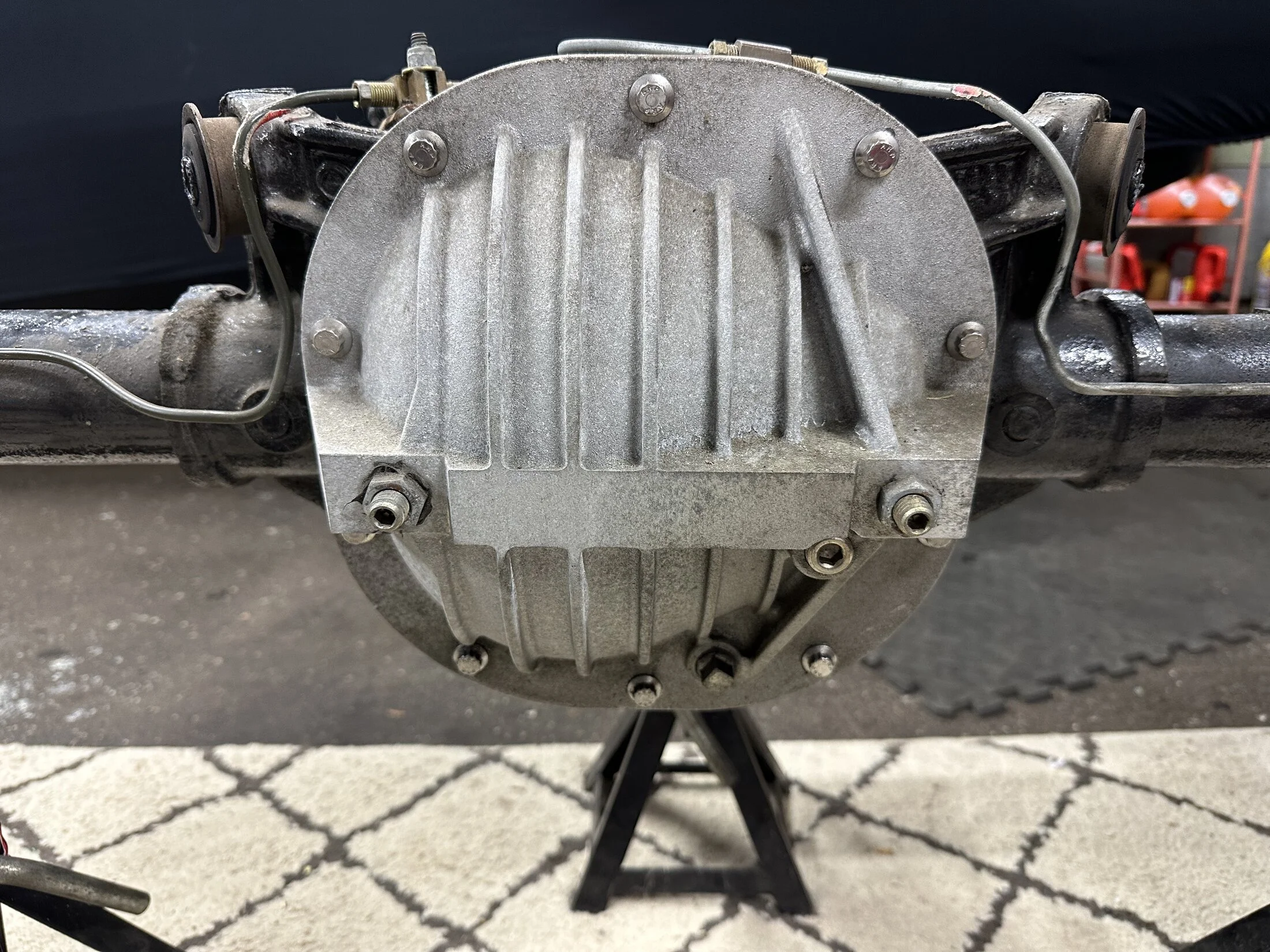

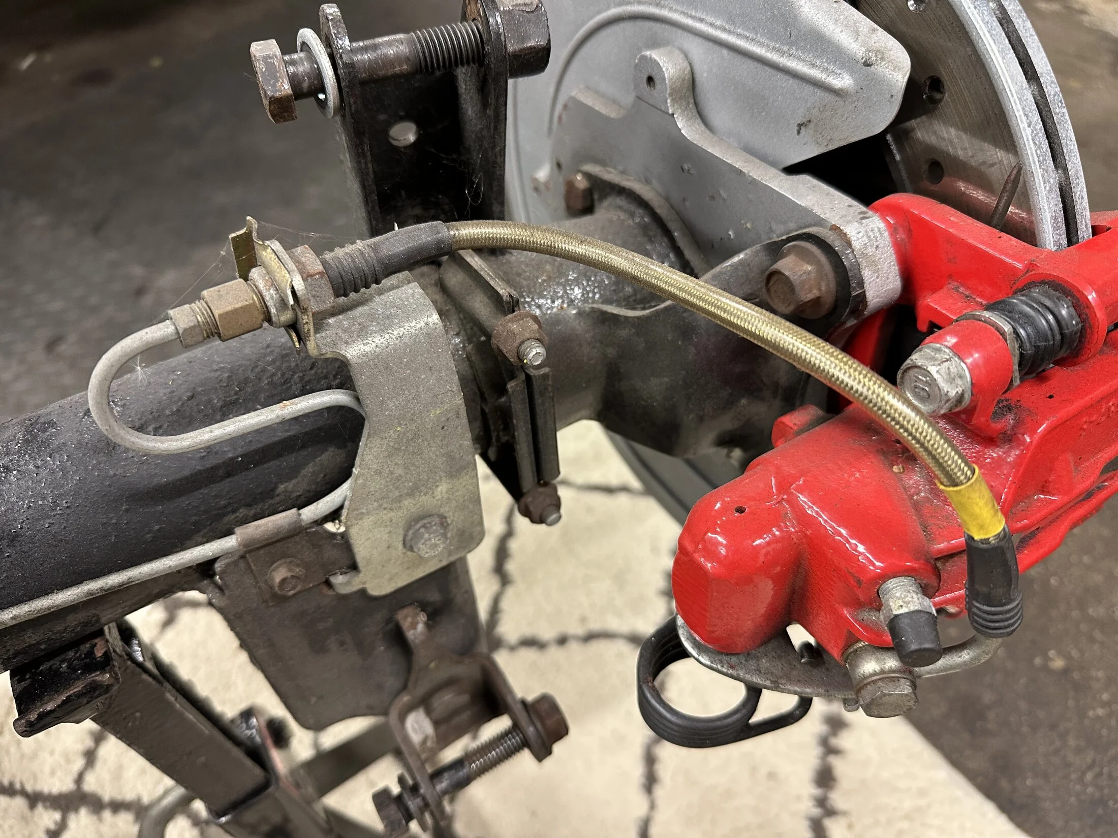

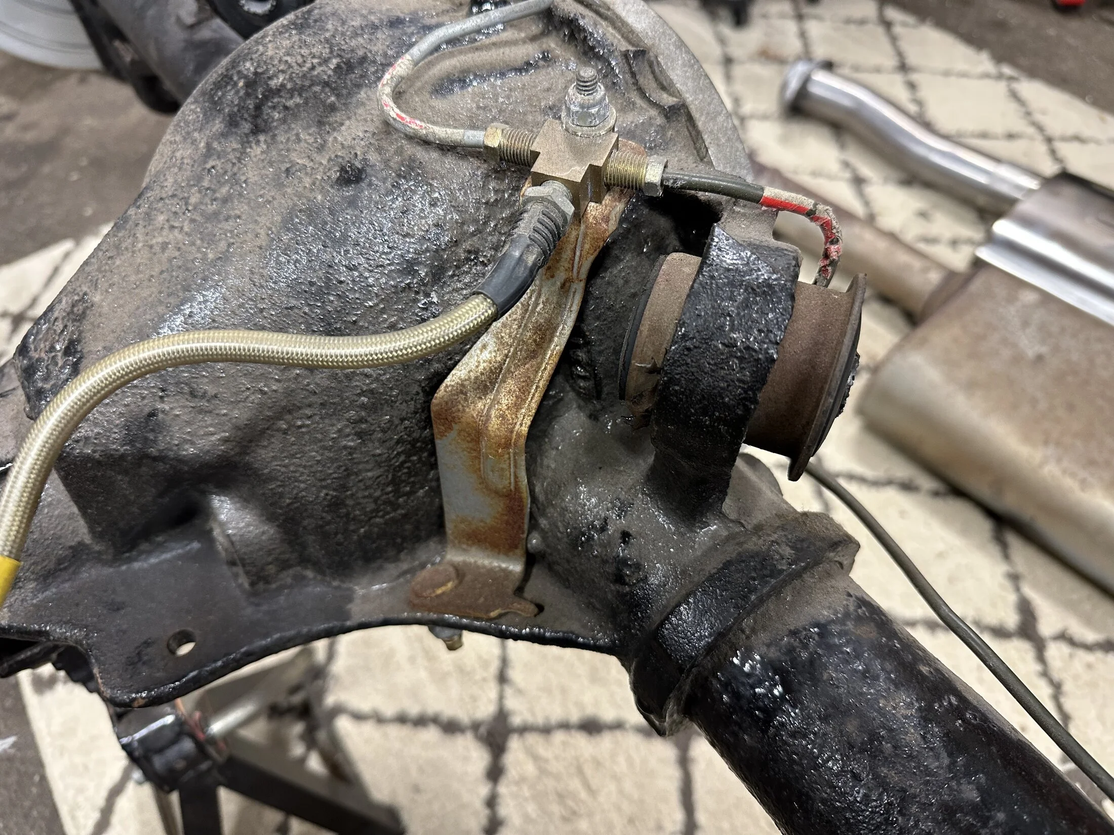

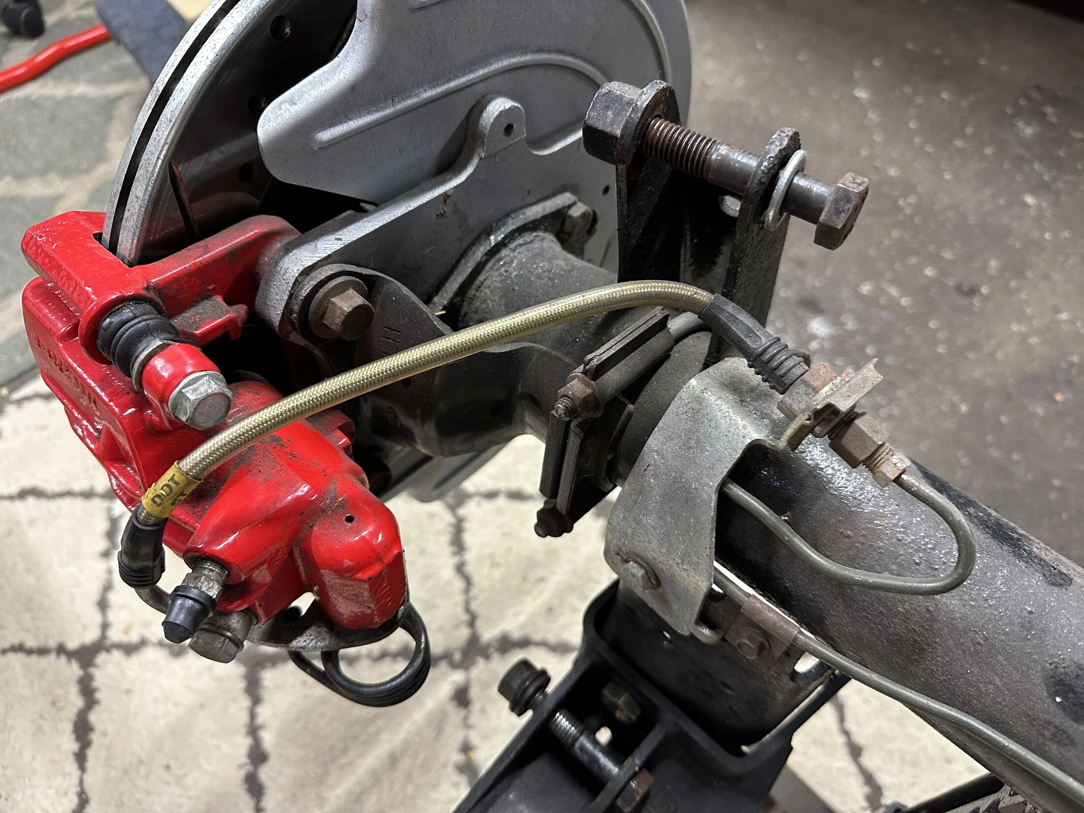

Some pics of the axle. I redid this all back in 2009ish, so not a whole lot of miles but it did sit a lot.
I’ve got the MM braided lines on it, but not thrilled about how I did the lines on the axle. The bushings are still very pliable, so I likely won’t replaced those. The end bearings have low miles, but might as well replace the seals. Some paint and elbow grease will prob be the brunt of the work I do here. I don’t want to go tooooo crazy here. Could use some ARP hardware

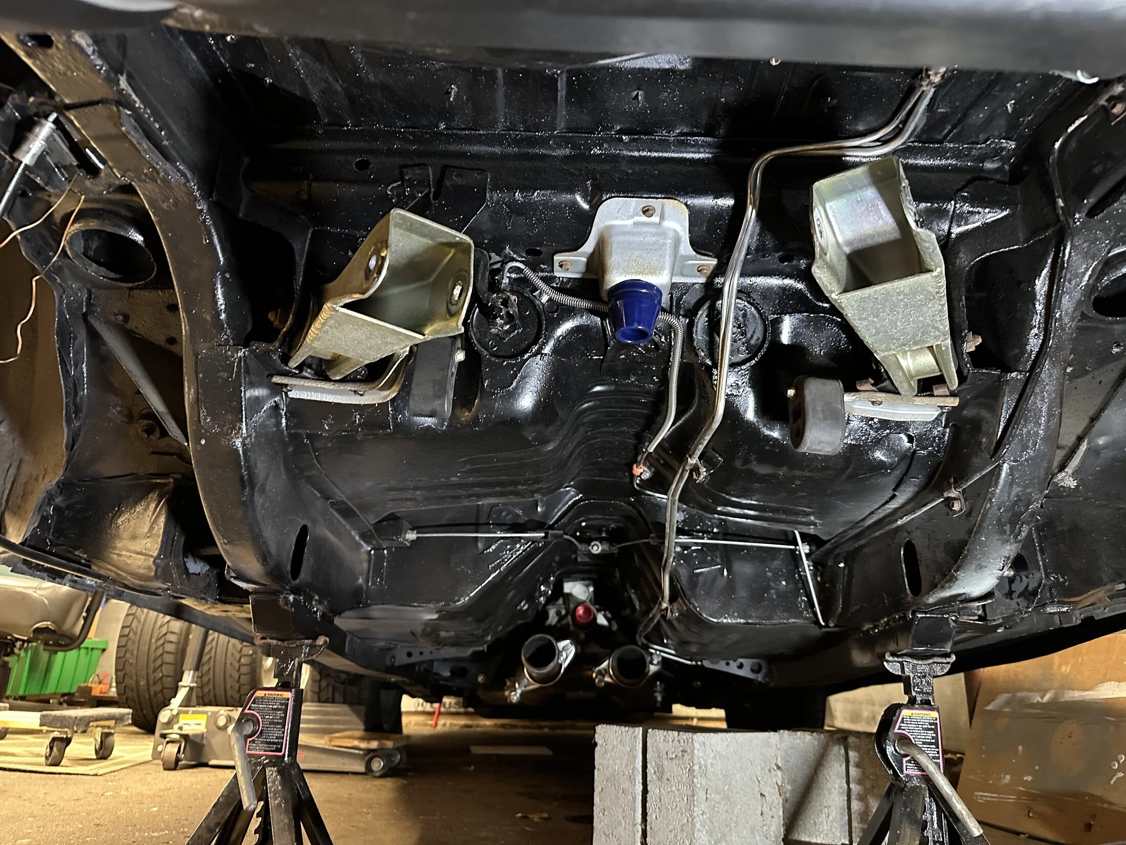

Ended up pulling the other side of the exhaust off. I needed access to pull the LCA off and to drill out the broken seat belt bolt plate.
Some might remember I snapped the head off the seatbelt bolt and couldn’t get this out. So I got my hands on some new plates and am just going to weld the new one in place
So now everything is wide open. I have clear access to those inside welds on the SFCs. My flowmasters were just in too close to get the right angle. Now I just need to prep and do some welding.
I’ll prob clean up some of the brackets under here. And replace the fuel filter.
