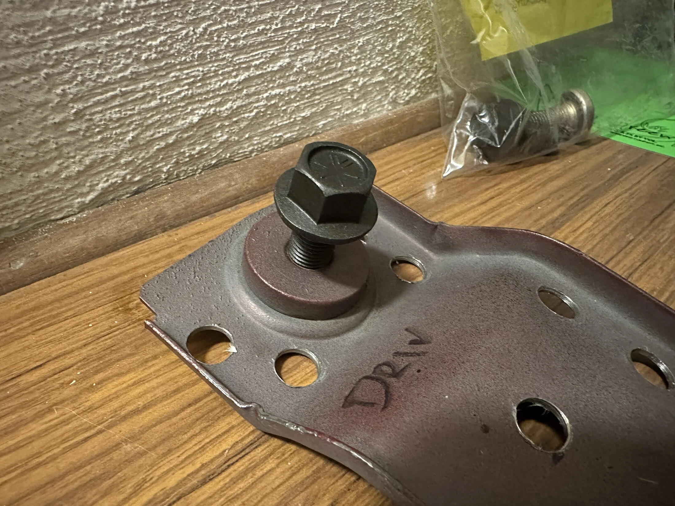

If you can cut the bolt head off do you think you can thread a nut on the portion of the bolt that is sticking out under the car and then weld that on and try to just continue threading the stud out towards the underside of the car?
Tried that on the opposite side and didn’t work. I think I need to get the POR 15 off as well. Gonna get some paint stripper on it and take it off and see if that makes a difference.
If I can get the head off, it’s just 6 spot welds to take that whole plate off. Then I’ll just weld the new one in.
FYI,
If anyone wants to replace these bolts with a proper bolt, it’s a 7/16-20 and 1” seems to work ok for the rear belts. Front belts have a shoulder

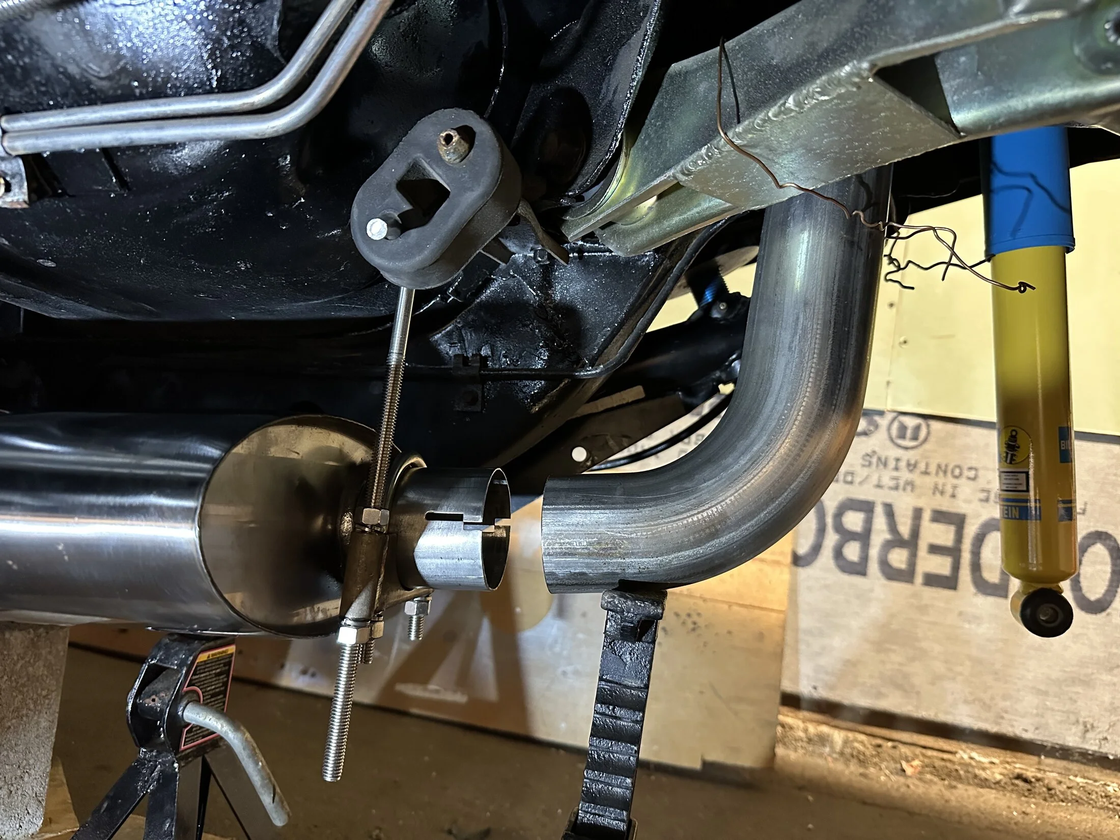

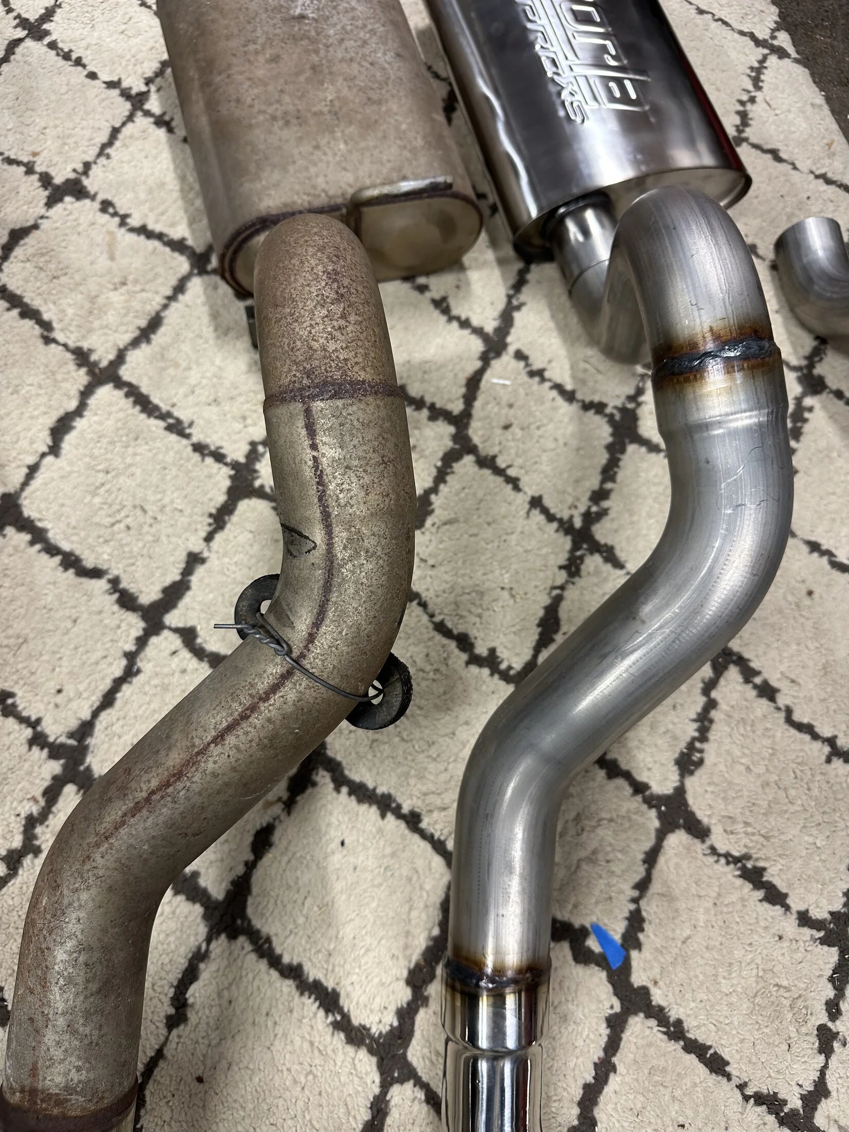

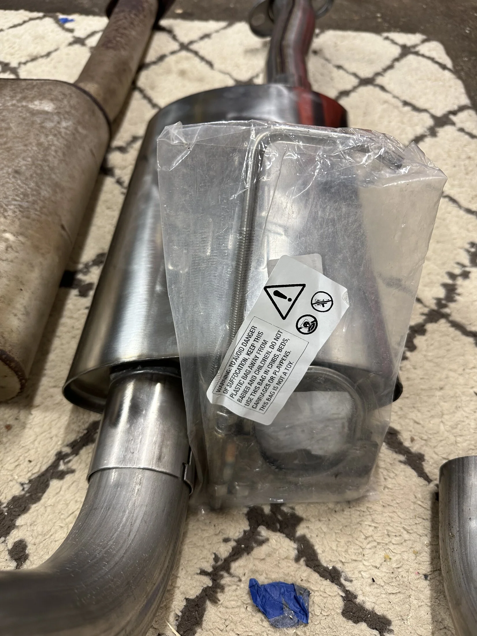

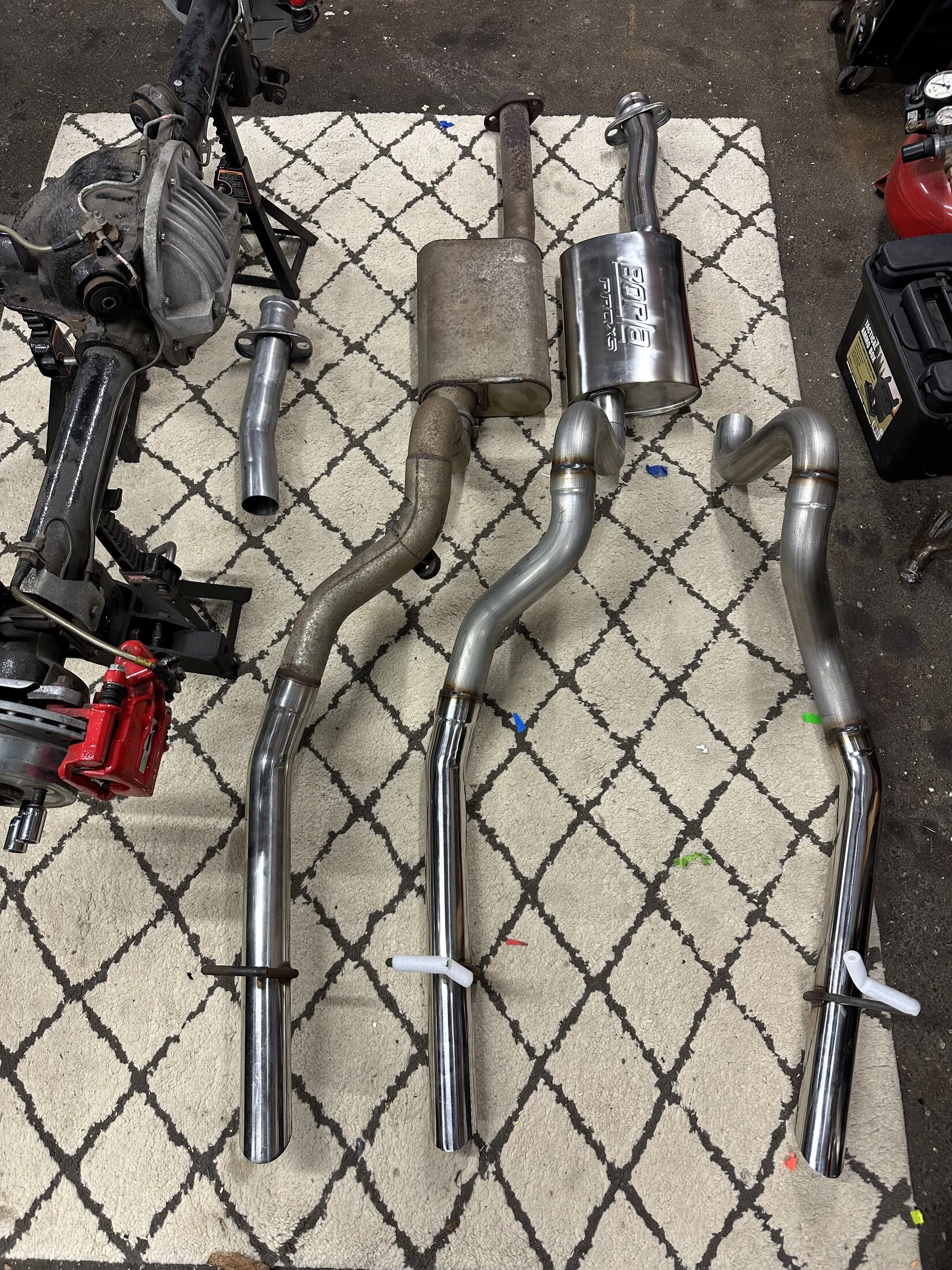

Tailpipes showed up. I think this will work nicely. New flowmaster tails match the old ones, so it should fit well

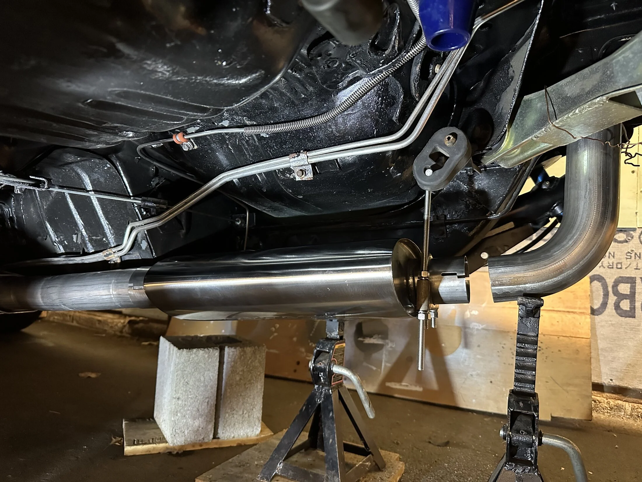

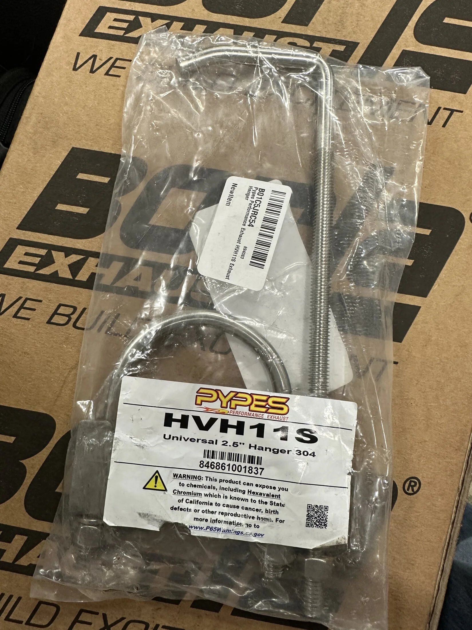

Going to try out this style hanger. Going to clamp it on the muffler at the base just for support. I have a lap style clamp for the main sealing.
Unfortunately wasn’t thrilled about the clamp I got for th flow tubes. Ordered two different clamps to try but they should be here next week.
I still intend to hang this on the car and see how it fits. Helps using the flowmaster setup as a reference.

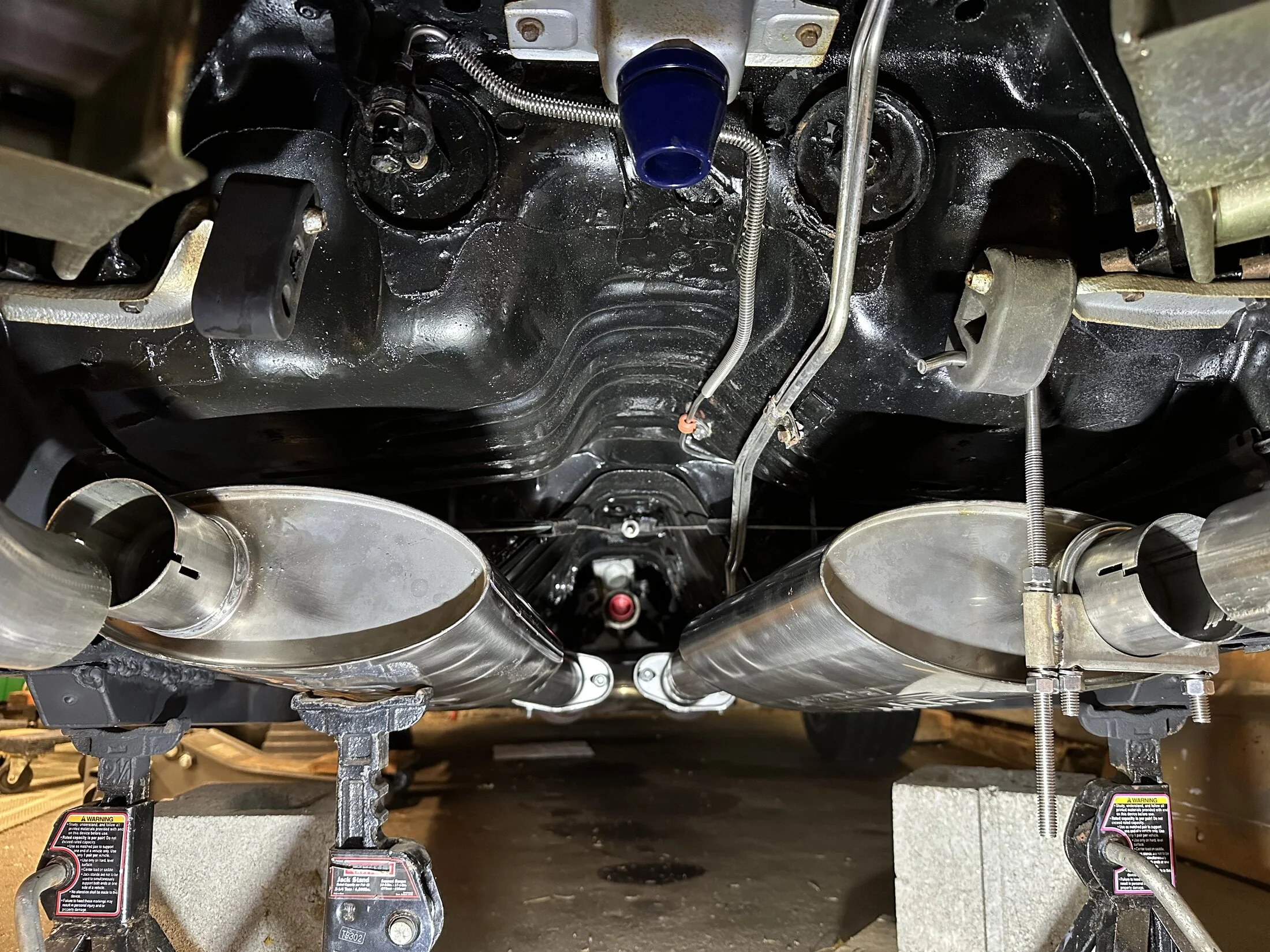

Yeah, universal mufflers means to run into issues like this. Got the pass side mocked up. Unfortunately looks like I’m a tad short.
I estimate a 4” extension peice will get me where I need. Fortunately they make those. So more parts on order, and more clamps.
Would have preferred it alll fit one shot but if this is the only tweak I need to make I’m ok with it. Tempted to weld up an extension on the flow tubes….
Going to mock the drivers side up next.
Same issue with drivers side. I found a few SS 4” extensions so I’ll order those up. Stay tuned.
I also need to make sure I leave enough clearance for the driveshaft. It’s easy doing the exhaust now with no rear or driveshaft, but it also means I can’t tighten everything down until I can do final sanity check for fit.
Found the flowmasters are rusted out inside. Can hear the bits of rust flopping around internally when I rotate it. So those are not going back kn the car regardless. I’ll likely chop the tips off and save those.

Do they make longer flow tubes?
My mufflers sit further back and they are similar size to yours.
The hanger on mine is welded to the muffler (obviously they aren't stainless) and the rubber exhaust hanger on mine hangs close to vertical.
I think the point i'm getting at, do you need more pipe in the back or the front?
If you could do the flow tubes that's a few less clamps.
The only other brand of flow tubes I see is the LMR brand. I can certainly ask them the question as to how long they are compared to the pypes brand.
Edit: looks like they are aluminized steel. Would prefer sticking with SS
I agree the mufflers need to come back so the extension peice I was going to use would likely go on the flow tubes to push those back a bit.
I was also debating just finding a SS exhaust hanger and welding it to the muffler. I have SS wire for the MIG but just trying to avoid using the welder. At least with clamps I can move and adjust a bit before synching it all down once rear and panhard bar go in.
I'd say for sure, weld the hanger if you can.
You have spend so much time making things right and attractive, why stop now...
I'm definitely not loving that bolt on hanger from a visual standpoint.
I think it's going to look a little busy with all these clamps and those hangers and judging by the attention to detail you take with the car, i doubt you are going to like it.
When I recently did my rear, and reinstalled the exhaust, it became pretty evident that there is little to no play allowed, front to back, on those tailpipes, or the rear will make contact as the suspension travels up and down. Something to keep in mind as you position things.
Yeah, I definitely realize this. I cannot move the tailpipes front to rear at all. They are sort of fixed in one spot due to how they tuck up near the frame rails.
I have to move the mufflers back into the tailpipes, or extend.
After thinking about it a bit, I just might buy a peice of 2.5” SS exhaust tubing and weld on the extensions myself. I’ll still use the four exhaust clamps on the muffler itself, but seeing as the muffler needs to sit in the right spot, I think I might need to break out the welder.
I’ll likely weld on some hangers as well rather than use those janky hangers. It’s getting too busy under there with hangers and extensions and such.
Gonna think about this a bit, but you are right. I have the time and space to work so let’s do this right.
