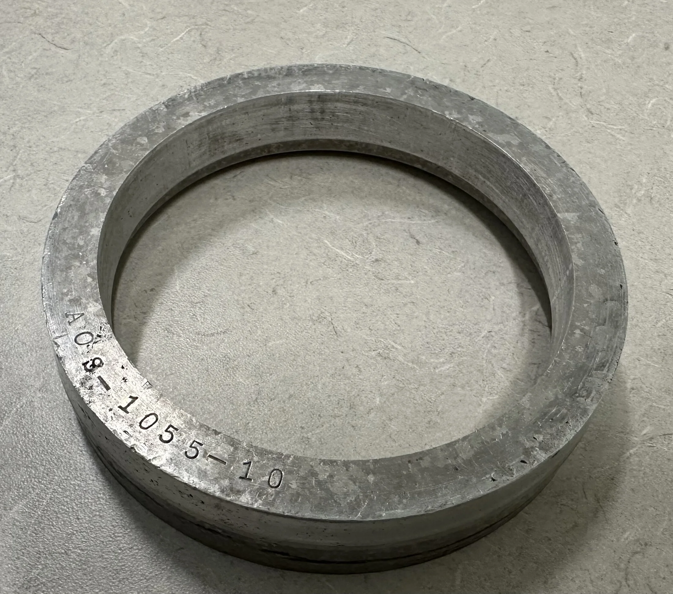

Garage art. I haven’t conclusively identified it. I have the axle, a spacer and the axle nut.
I did identify the spacer. It’s made by A.O. smith (the water heater company) and the part number corresponds to a B29 main landing gear spacer. But, this isn’t a B29 axle. I think it’s another Boeing aircraft from the same time period.
I have part numbers and stampings I’m cross referencing on Warbird FB groups.

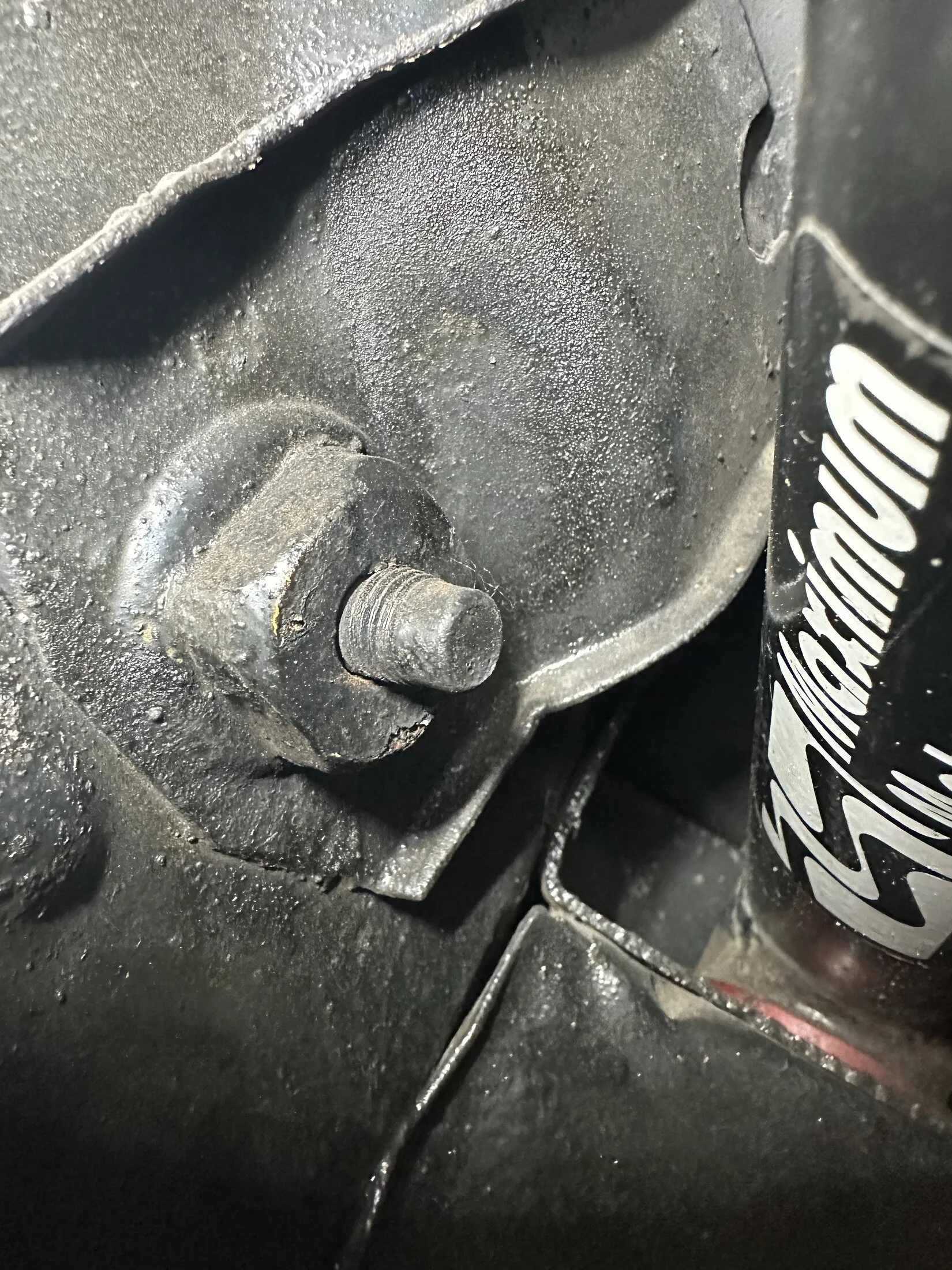

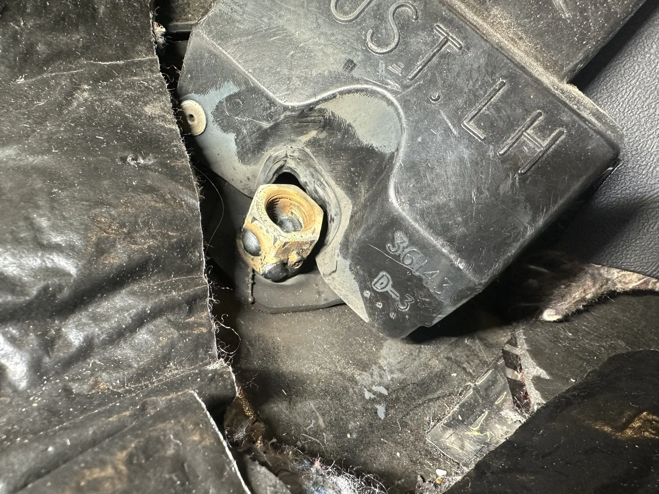

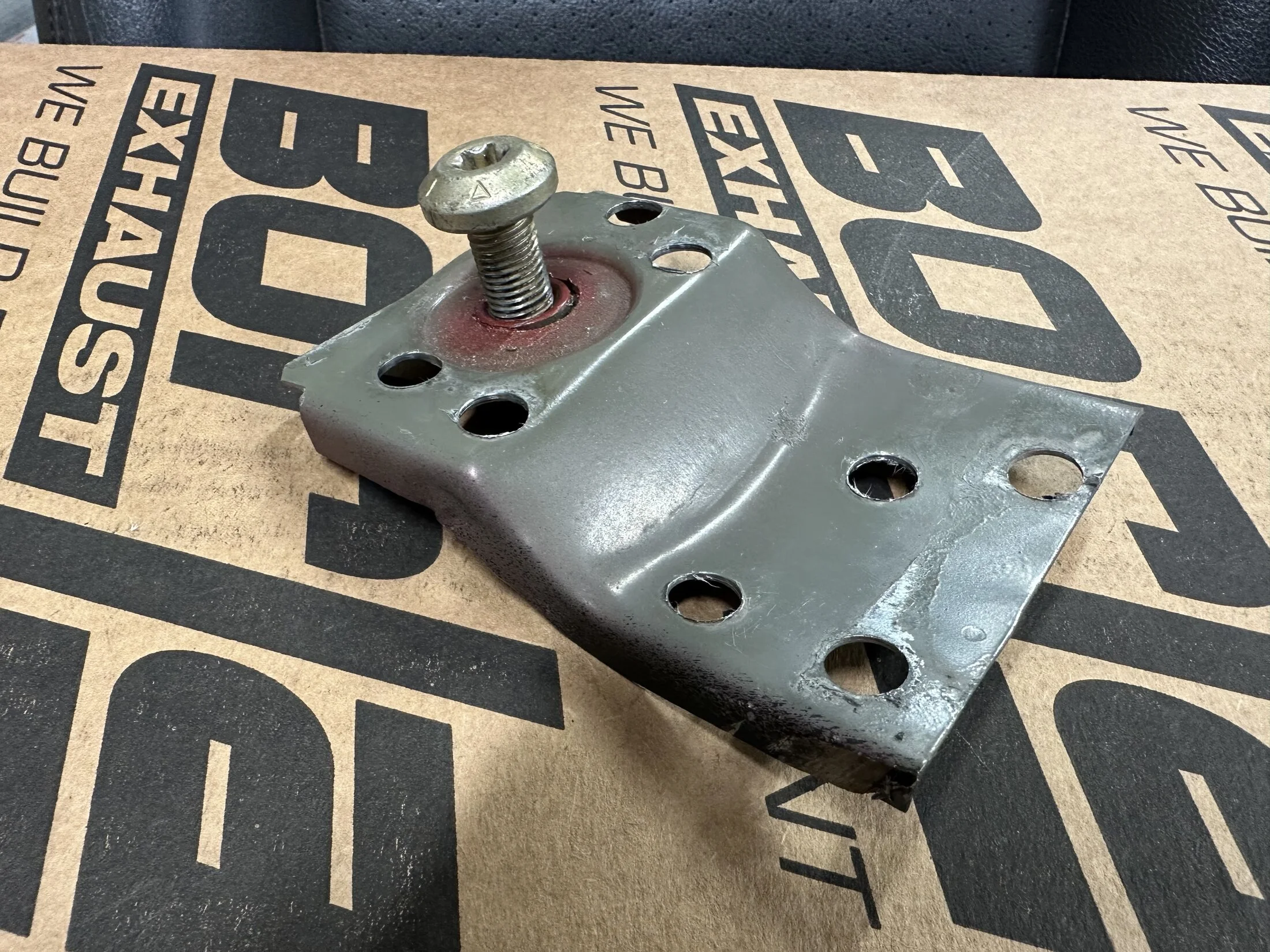

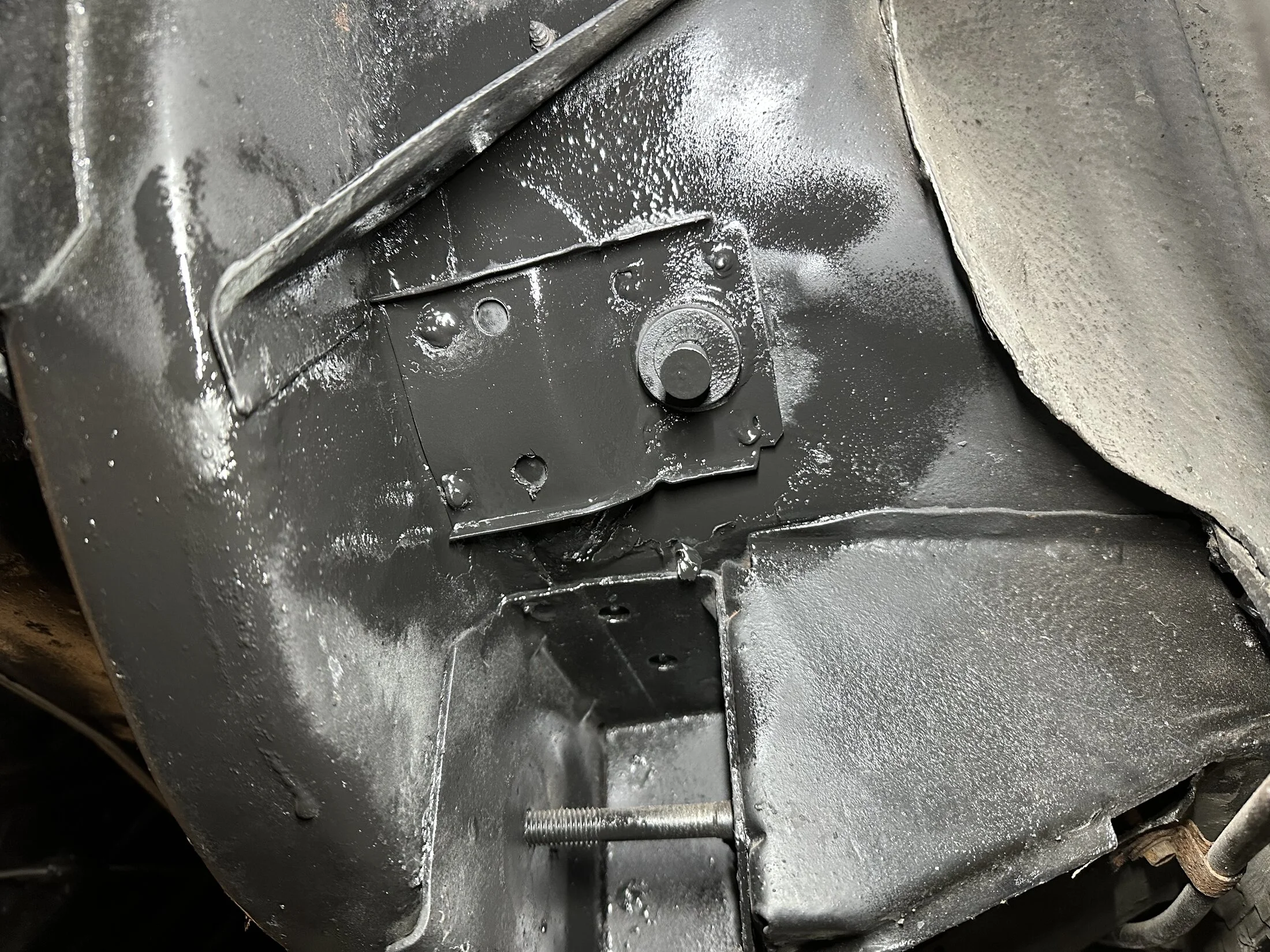

Ok SFCs are rewelded. They were NOT cracked. It was just some play with the light. When I got under there with better lighting, I saw they were still firmly attached but my weld looked terrible due to the fact the mufflers were close and I didn’t have the ideal angle.
So with the mufflers out of the way, got out the grinder and cleaned them up a bit and then layed down some better welds and painted.
Also, got the seat belt nut plate welded up as well.
(Paint still wet)

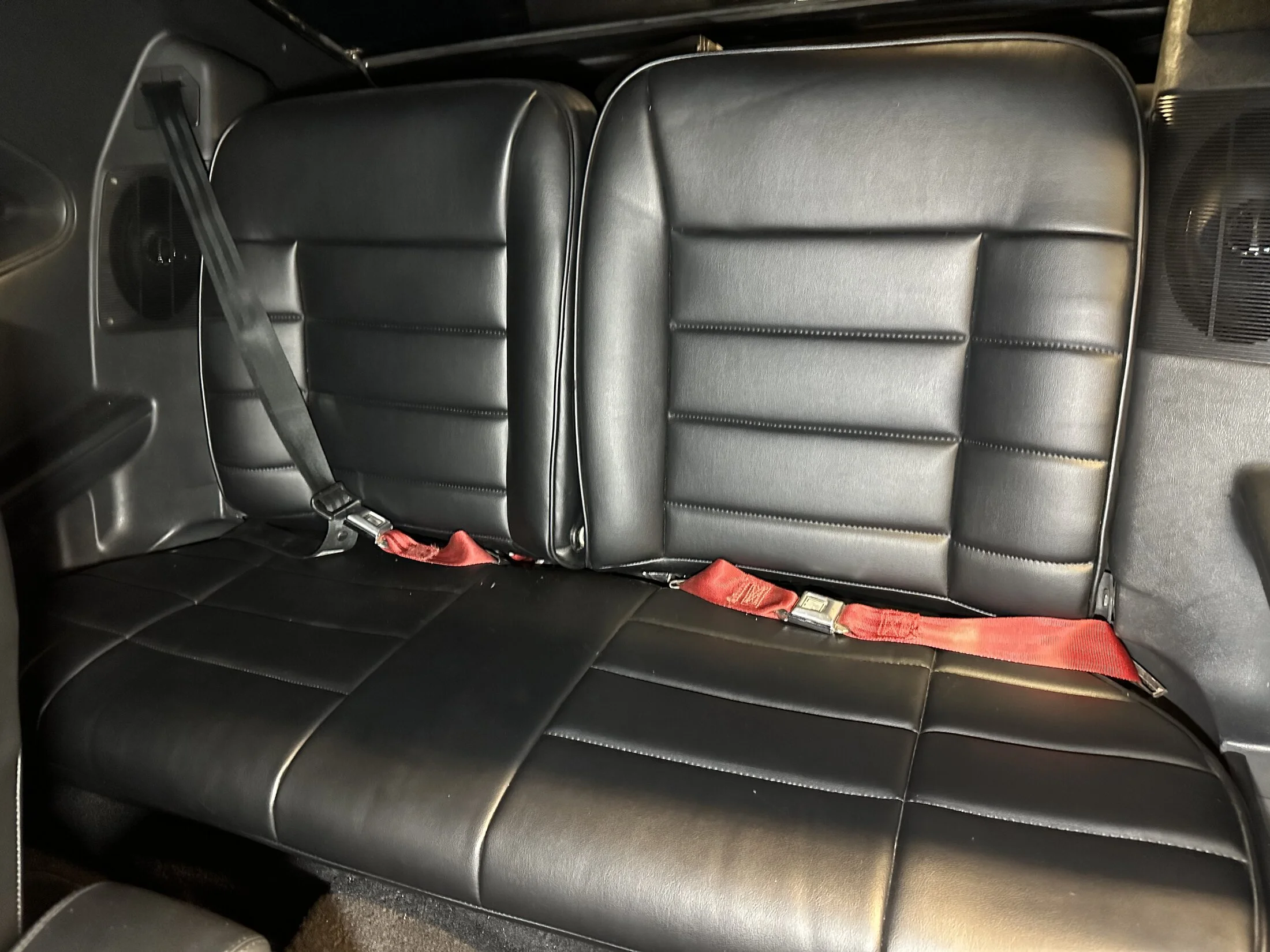

So now I officially have one functional 3-point belt in the back. I still need black center buckles, but finding 79-84 buckles is hard. I might just dye these.
Now to do the other side. I’m going to try one more time to get the bolt out. My hope is that the head just snaps off. Then I can drill out the spot welds and just swap the plate with this one. I’m going to try to torch the bolt from the bottom to get it hot and try removing it from the top. When the interior was out, I did weld a nut to the top of the bolt. I didn’t test it just yet. I wanted to use some heat to see if I can just get it to snap. These suckers are impossible to drill.

Unfortunately I don’t have a cutting torch. Just MAP gas to heat it up.
I don’t want to strip the interior out to grind the head off….but I might have to.

If you heat the base where the bolt is screwed through, then let it cool a couple of times, good chance it will come out.
I torched the bolt out when i was younger and way less educated (and less patient) on getting stuck bolts out.
I'd probably use a good set of vice grips too considering how many t50's i've broken.

Tried that. Broke a lot of T50 bits trying to get it out. With some heat and a breaker bar, i was just snapping the bit. Probably broke 5-6 of them. Then i started heated the hell out of it and it probably softened the bolt because at that point the T50 was stripped out. I even welded a nut on there and then heated up the bottom and snapped the head off the other side.
Too be honest, i'd be fine with the head snapping off. Then i can just drill out the spot welds and weld in the new plate. But this bolt is in there. These two bolts are the only bolts that have ever defeated my methods to date. Cant even drill them because they are hard!
A lot of work for a seatbelt nobody will likely ever use.

FYI here’s where we stand.
Previously when the interior was mostly out, I Welded a nut on best I could. As you can see I started melting the plastic seatbelt cover. These bolts are tough to weld to. It just didn’t seem to want to penetrate much.
I figure I got one shot to get it out (or snap the head) with the nut. In hindsight I should have put more weld, but I was worried about the interior.
Here’s the backside. That’s PoR-15 on the threads, so I think that might have something to do with it. I’m going to attempt to remove it somehow, before proceeding to try to heat it up and remove.
After I snapped the head on the pass side, I did attempt welding a nut to the bolt. Since I wasn’t as at risk of fire on the bottom, I cranked the heat up and it was still tough to weld to the bolt.
