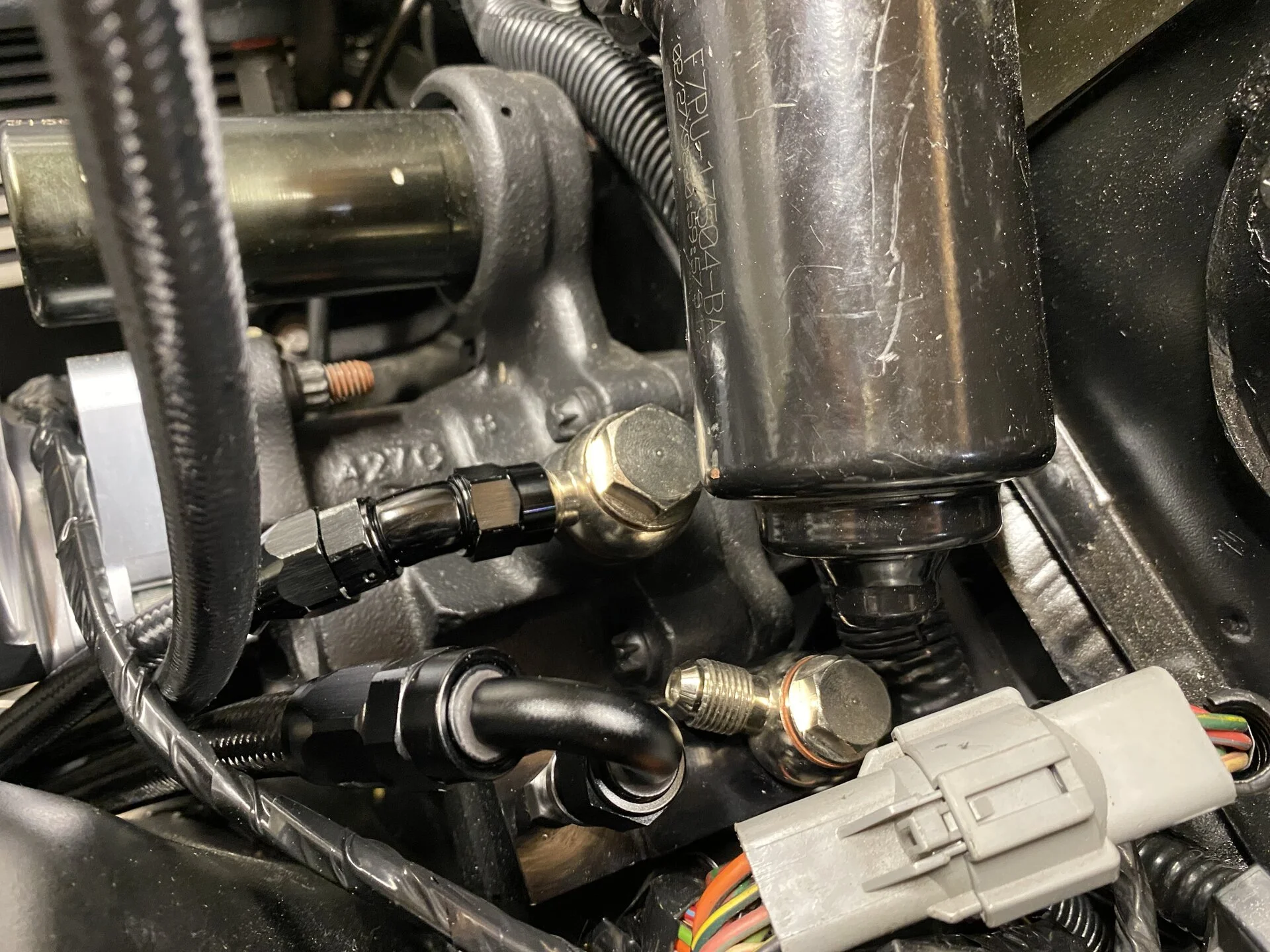

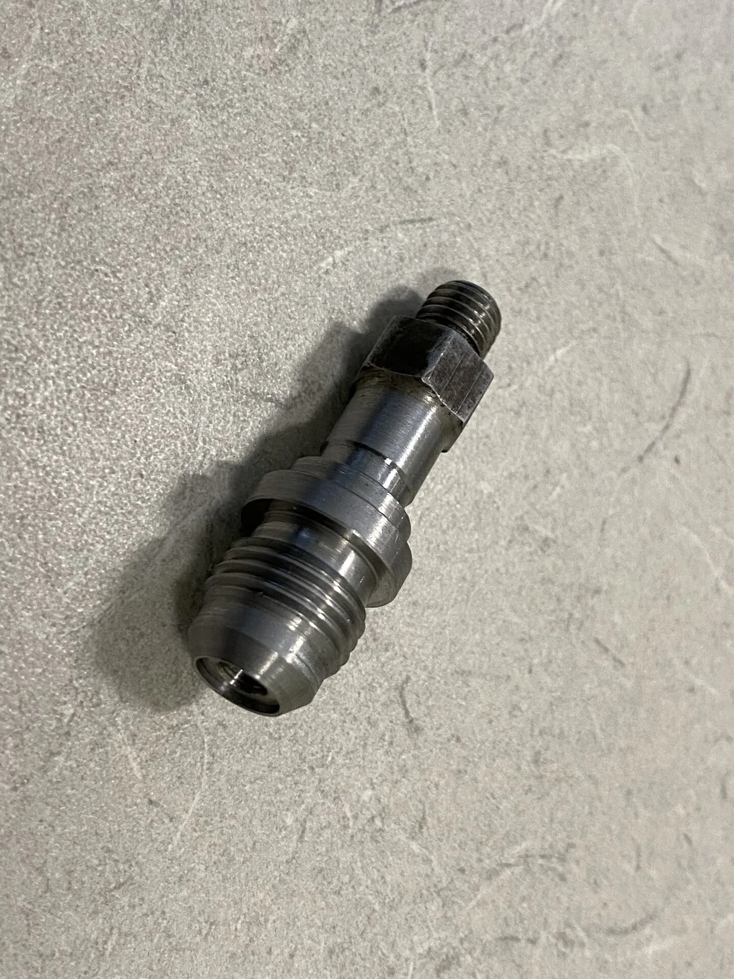

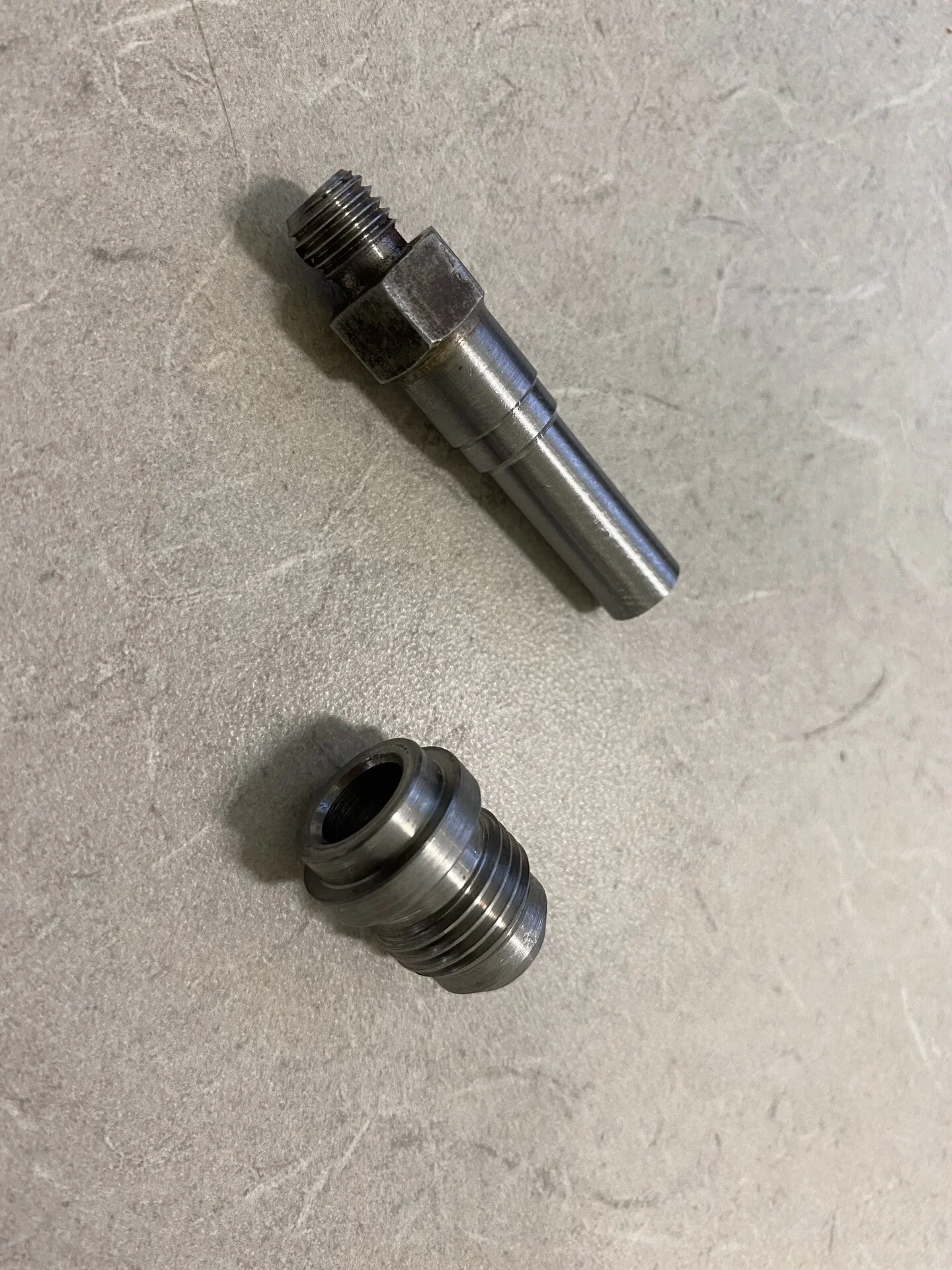

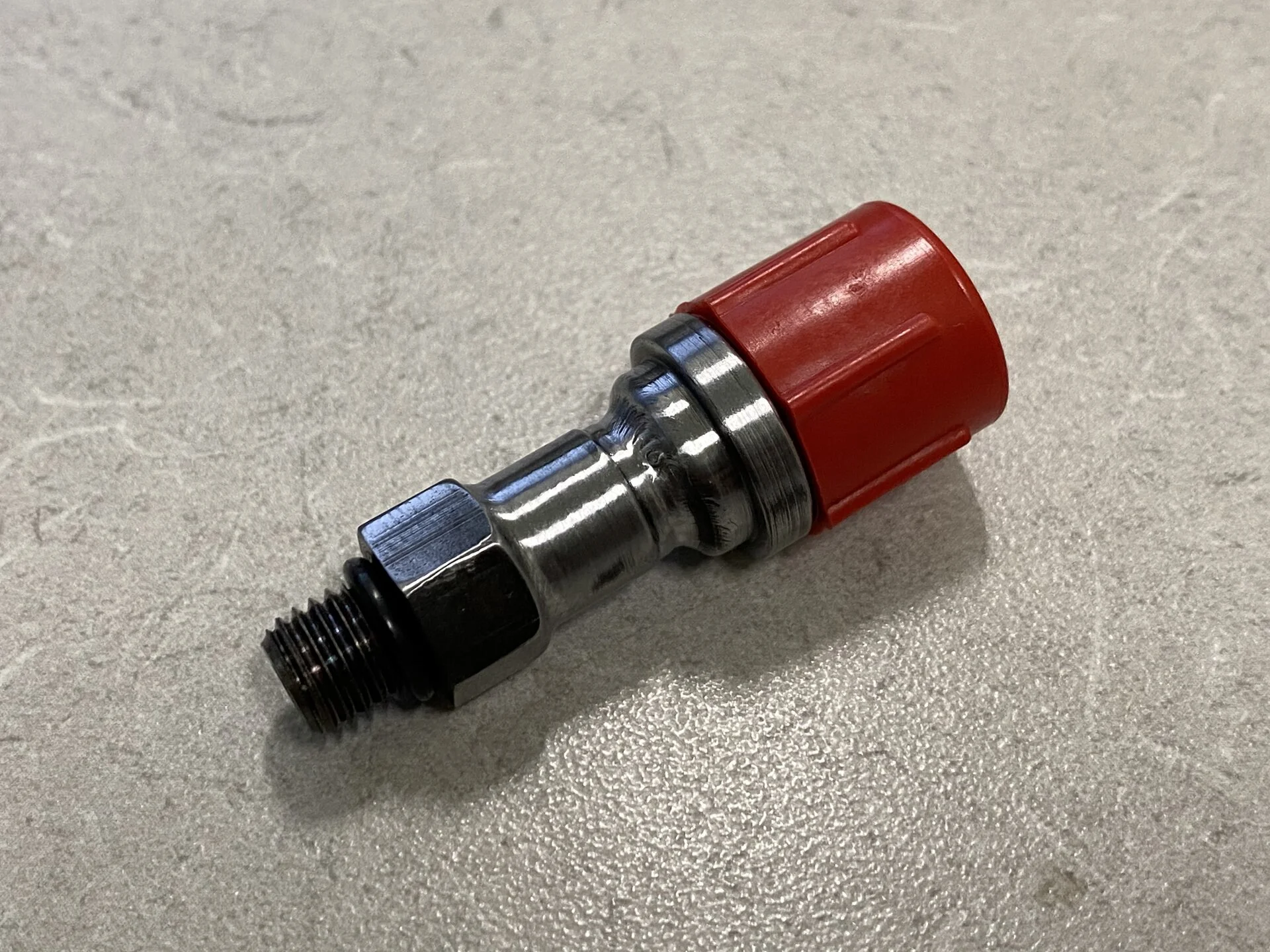

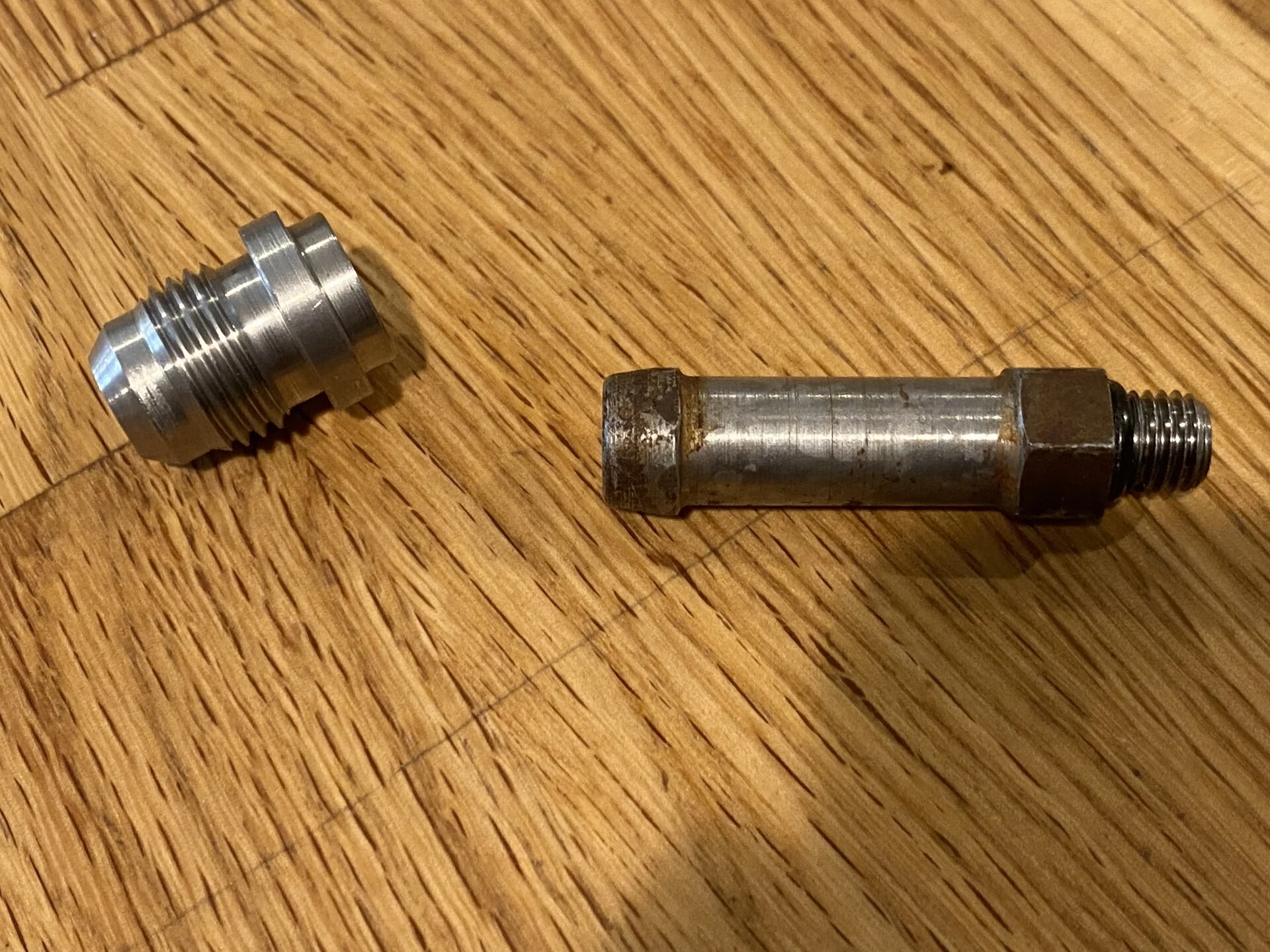

Here’s my solution for the left hand threaded low pressure port on the hydroboost.
Going to turn down the fitting and slide on this 6AN bung and weld.

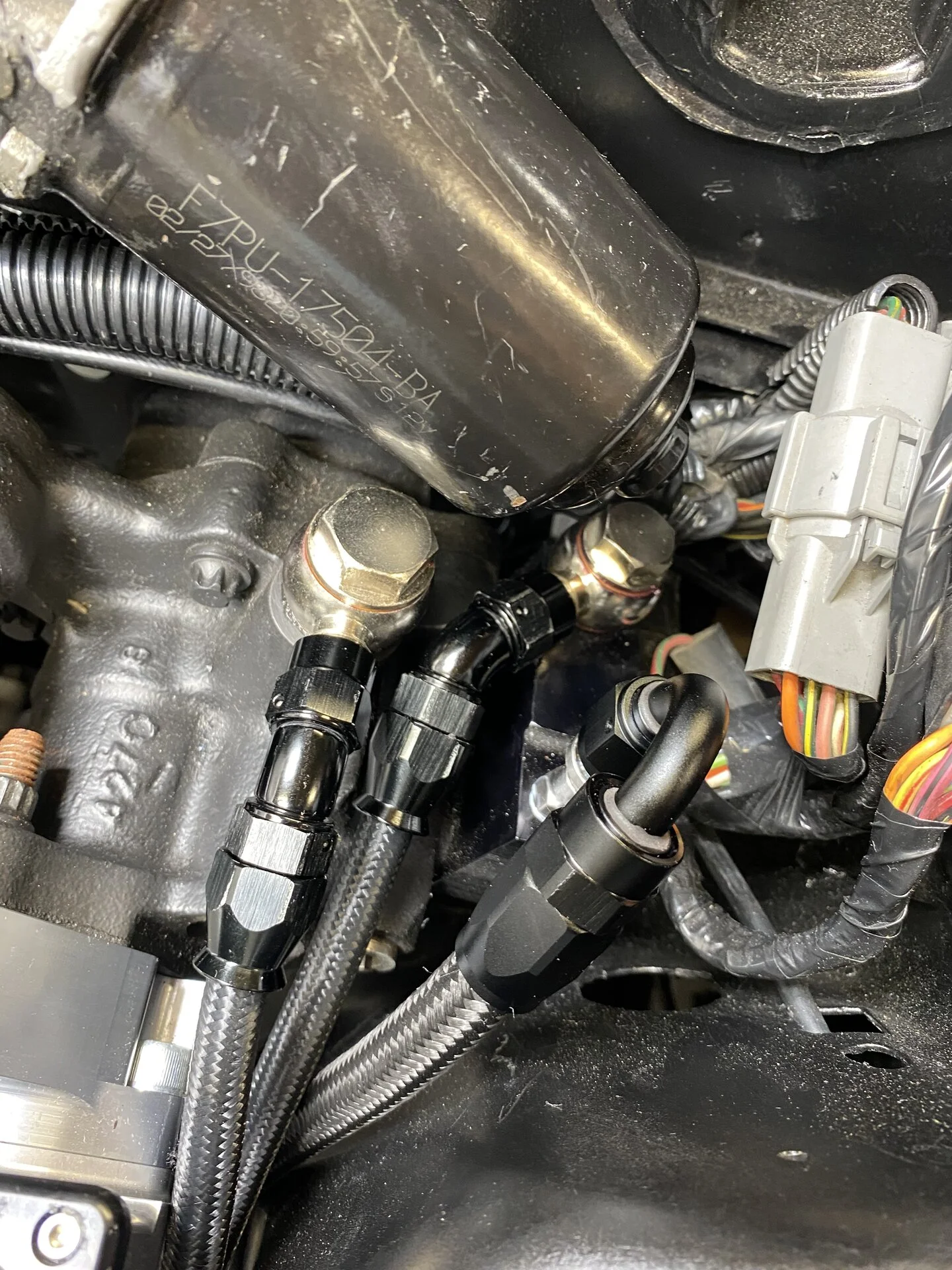

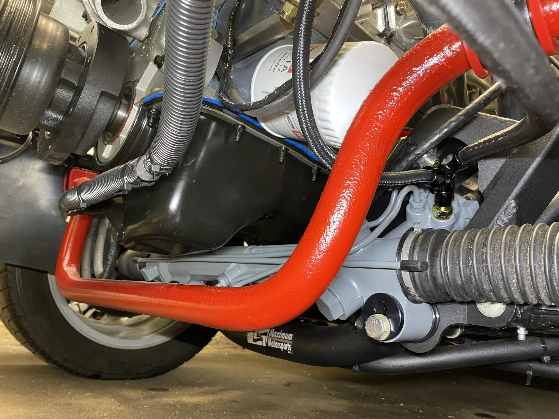

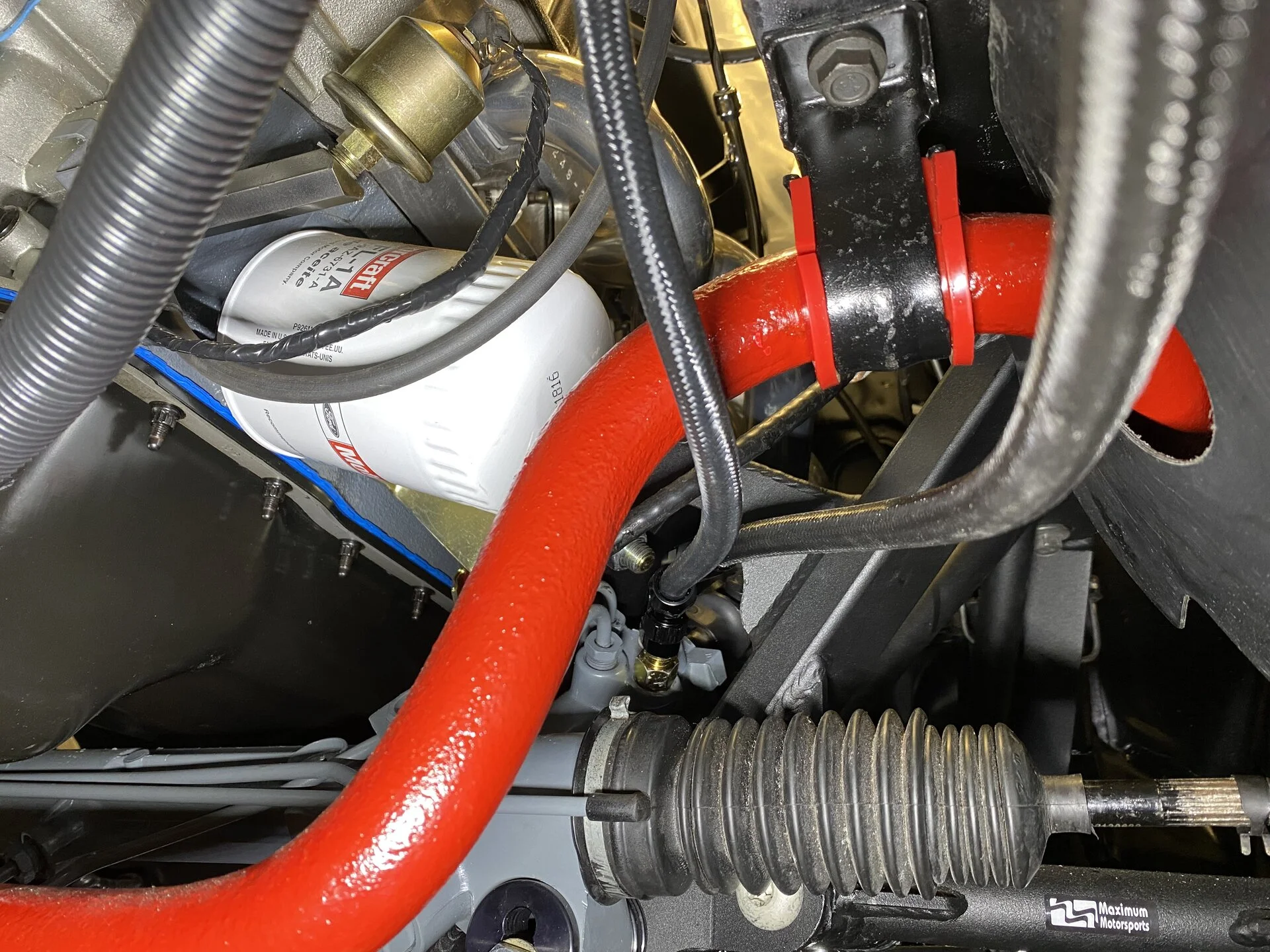

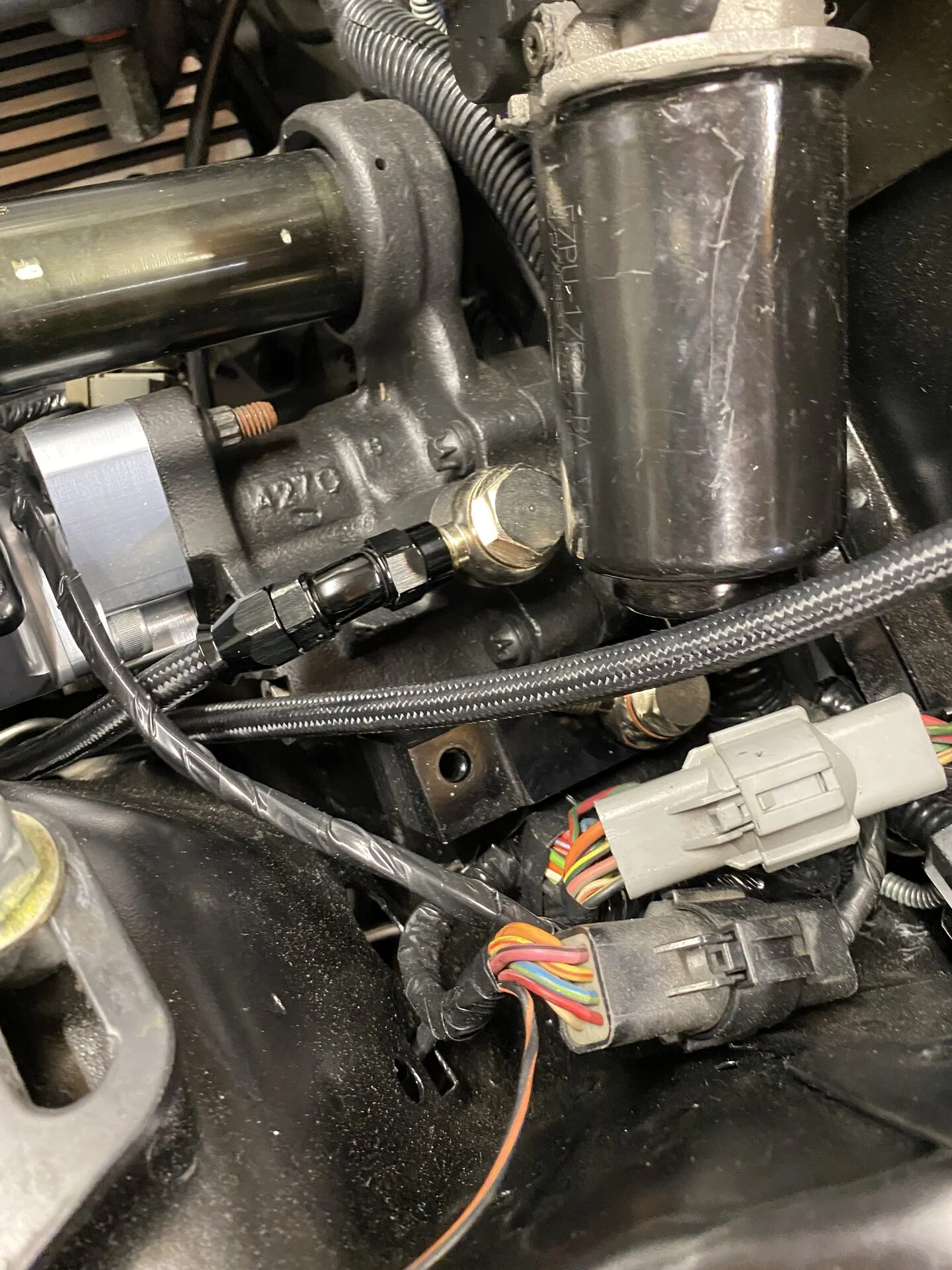

Working on the power steering hoses today. It’s a bit slow when you test fit lines and then order what you need to proceed. Still waiting on some misc fittings/parts
two high pressure lines routed
One line connected, waiting on the other fitting to show up.
Low pressure side next.

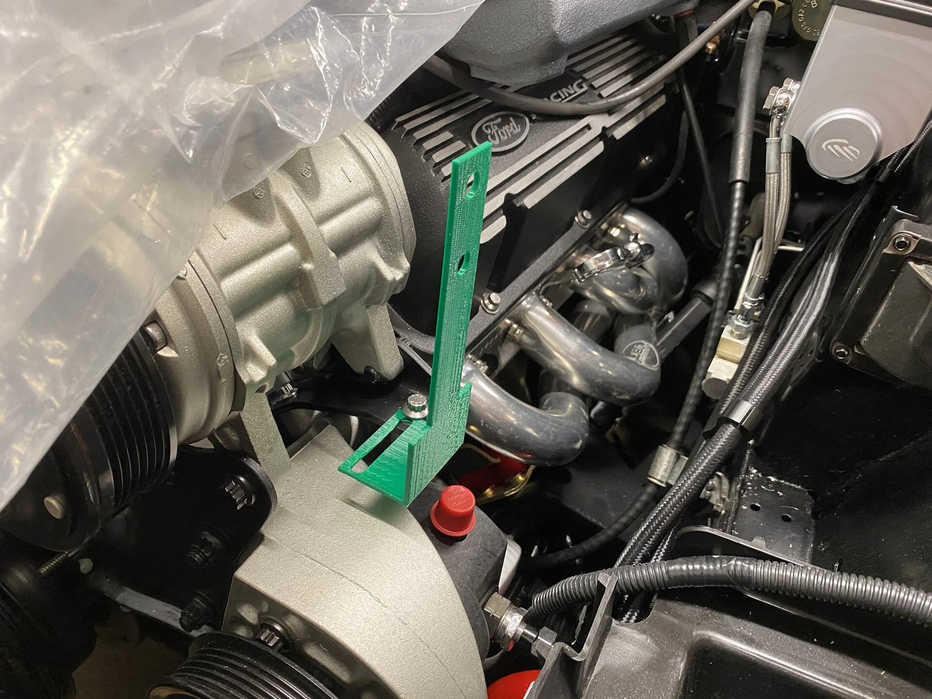

Next up is to figure out how to mount this near the ac compressor.

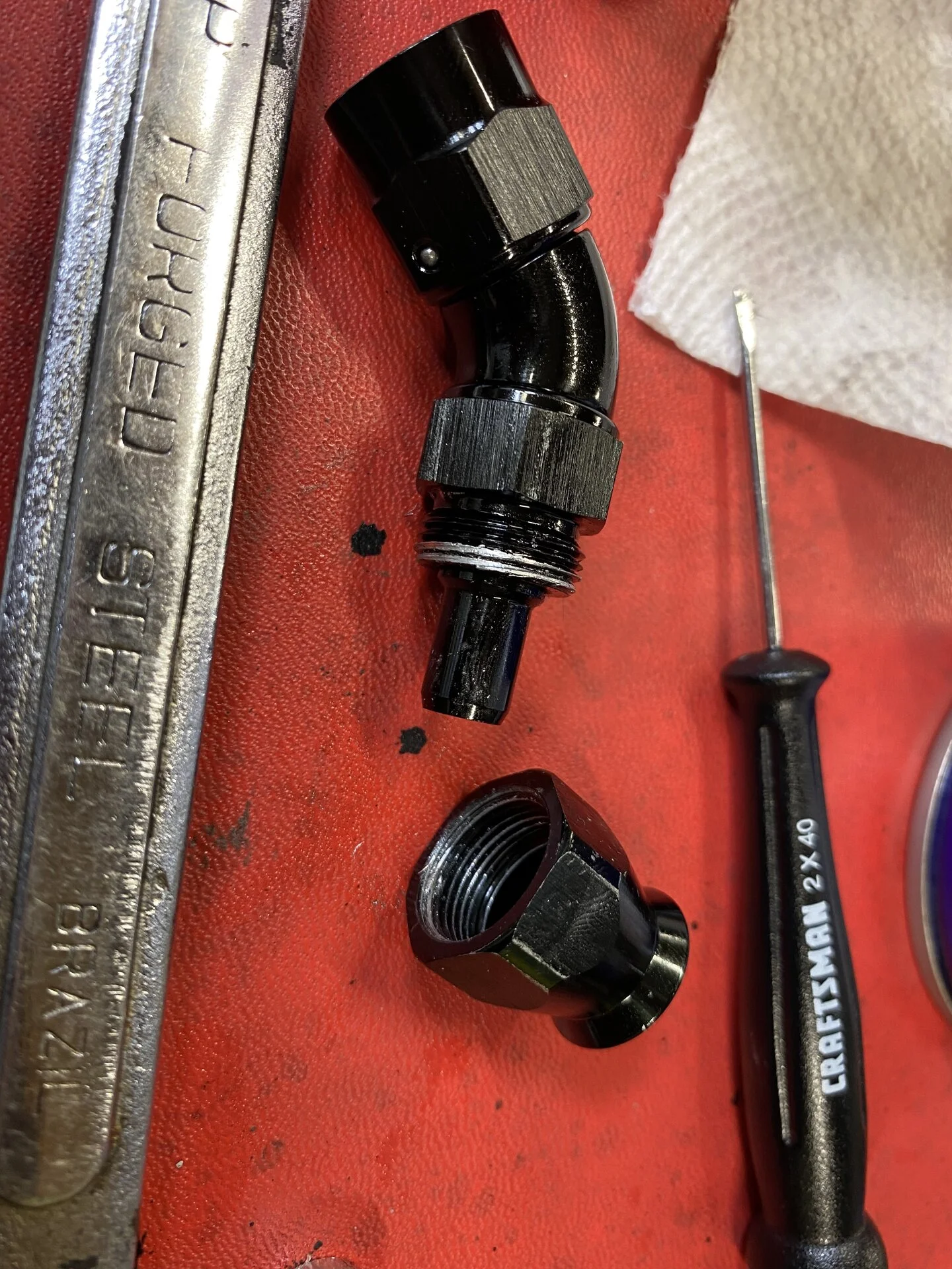

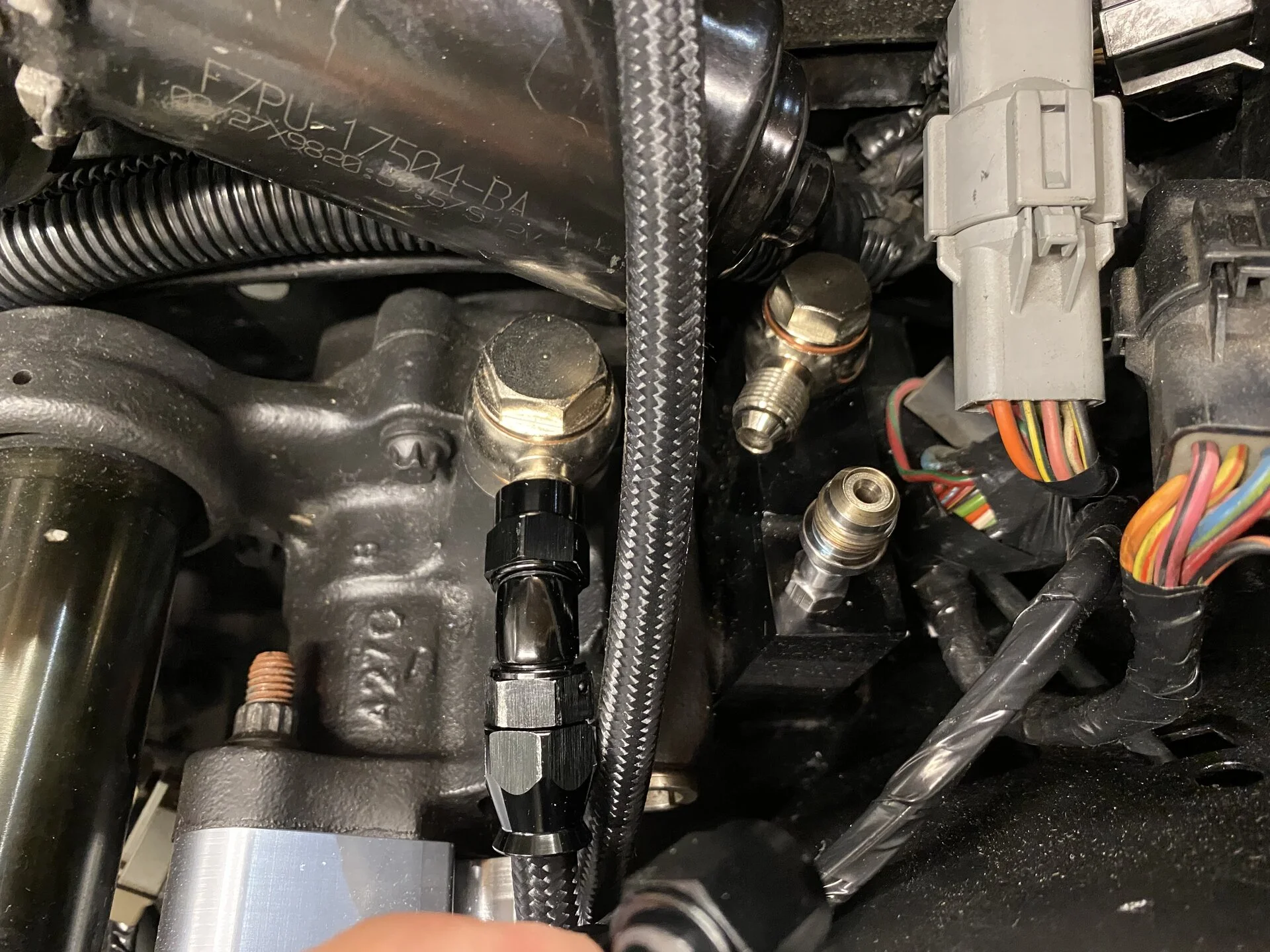

And after waiting two weeks for the last fitting I need for the high pressure side, I FUBAR it up. Argh.
just ordered another and back ordered to OCTOBER!
I’m using the vibrant performance hoses and fittings. I’m going to try another brand ptfe fitting and see if it works on this hose.
Well, determined to not be fooled by this, I spent a good hour cleaning up that thread and redoing the connection as best I could. Gave it one last try and the thread caught and started easily by hand. Sent it home, leak tested it and it seems to be good.
connections at the rack are done.
now to do the low pressure side.
I dunno if I mentioned this, but in hindsight I would not do hydroboost again unless absolutely necessary.

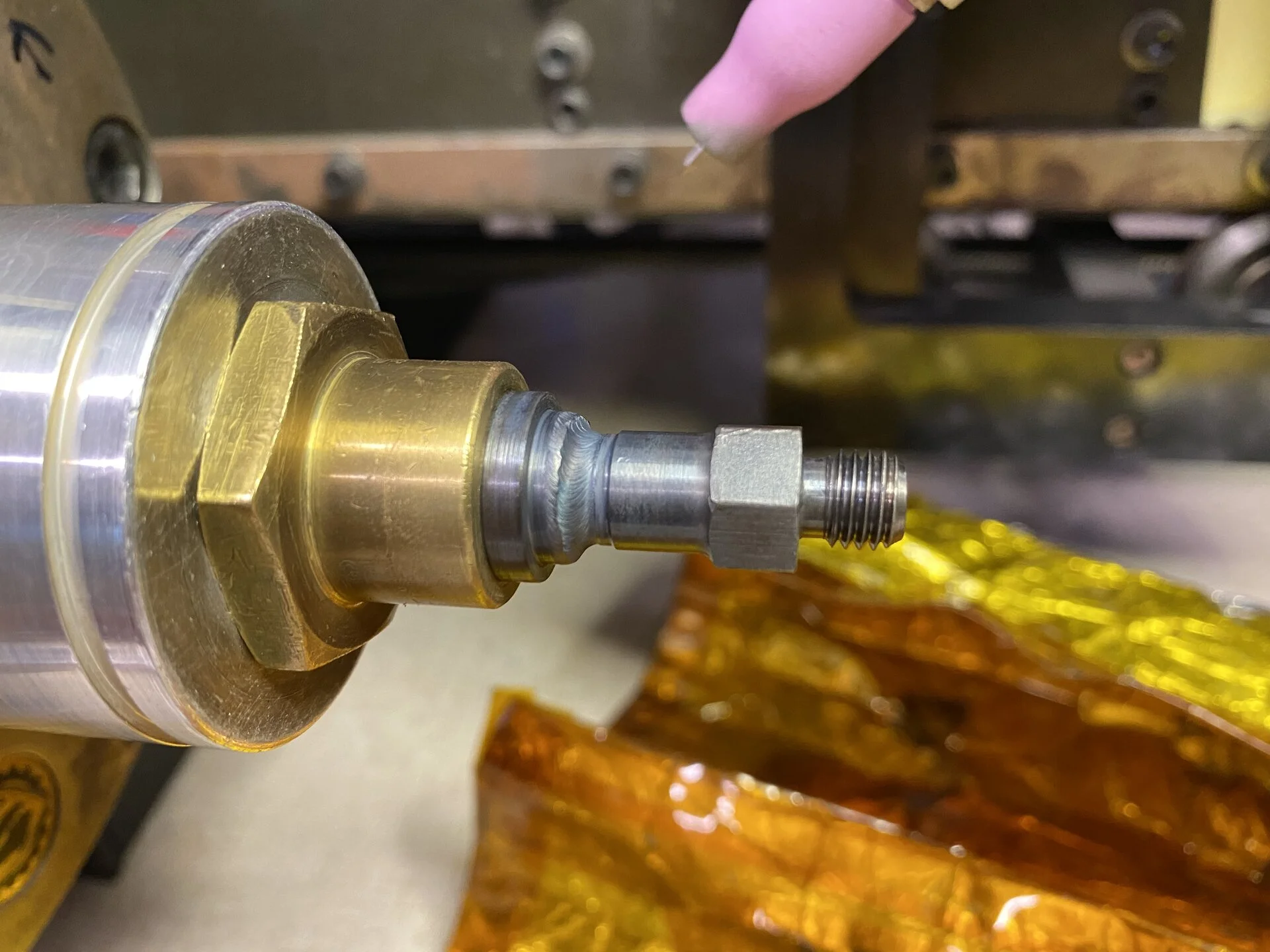

Chucked it up on the Lathe TIG welder during lunch break. It’s welded and solid

Ive got an idea.
this bolt here on the AC compressor is in a good spot. Modeled and 3D printed a bracket to test out. Some tweaks to make.

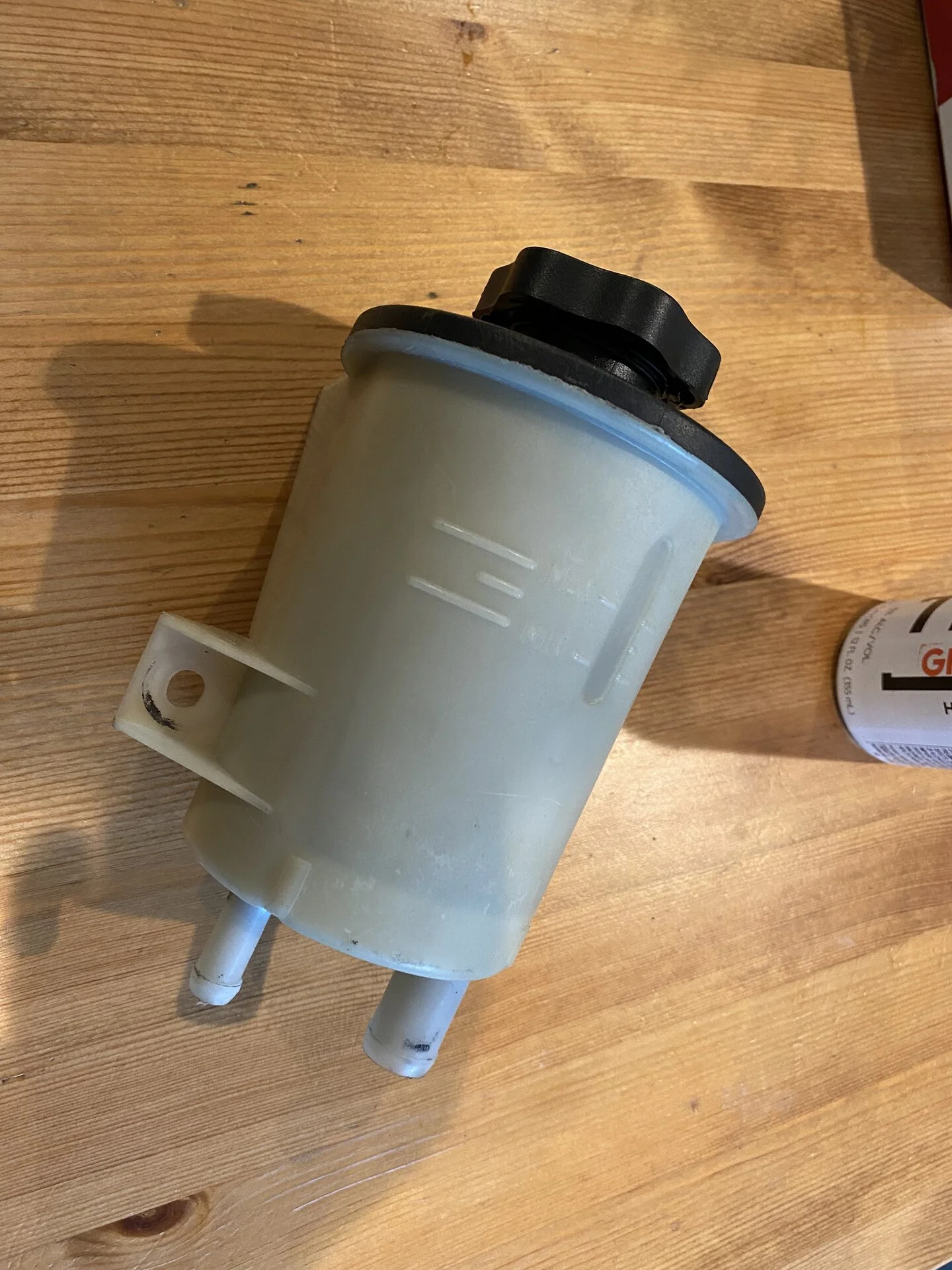

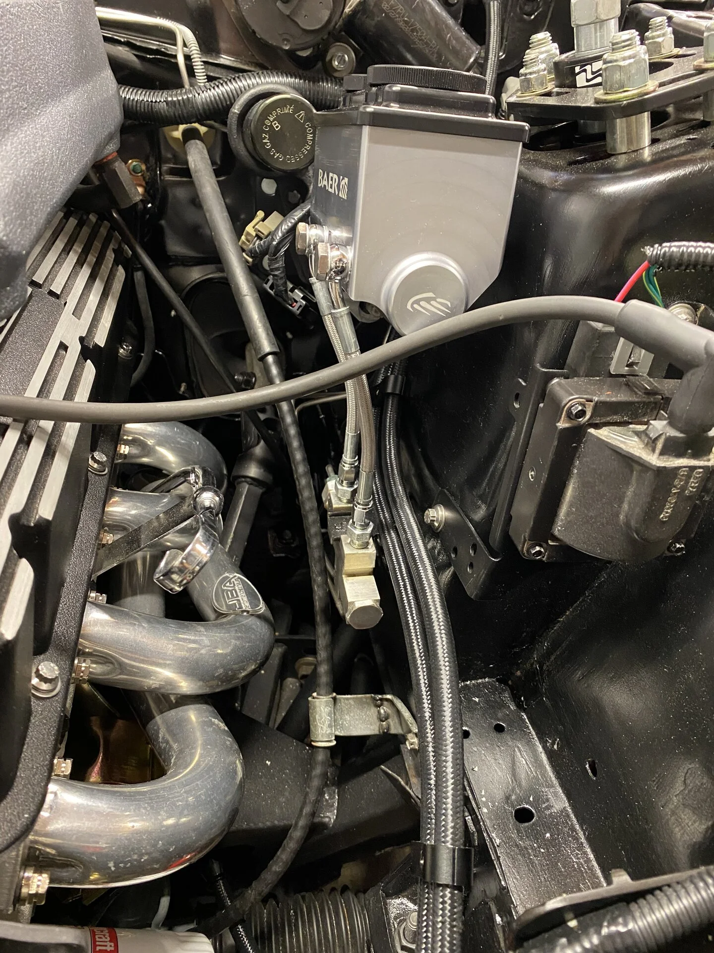

I did purchase a premade power steering reservoir. Details on that when it arrives. Unfortunately it’s suffering COVID delays like everything else.
I decided to not use the factory power steering bottle as it was ugly and didnt really fit with my engine. This company also makes a matching coolant overflow bottle so o may pick one up as well. It looks nice.
I have fittings in hand but can’t plumb until I know where the bottle is.
hurry up and wait
Reactions: TuFun and RaggedGT

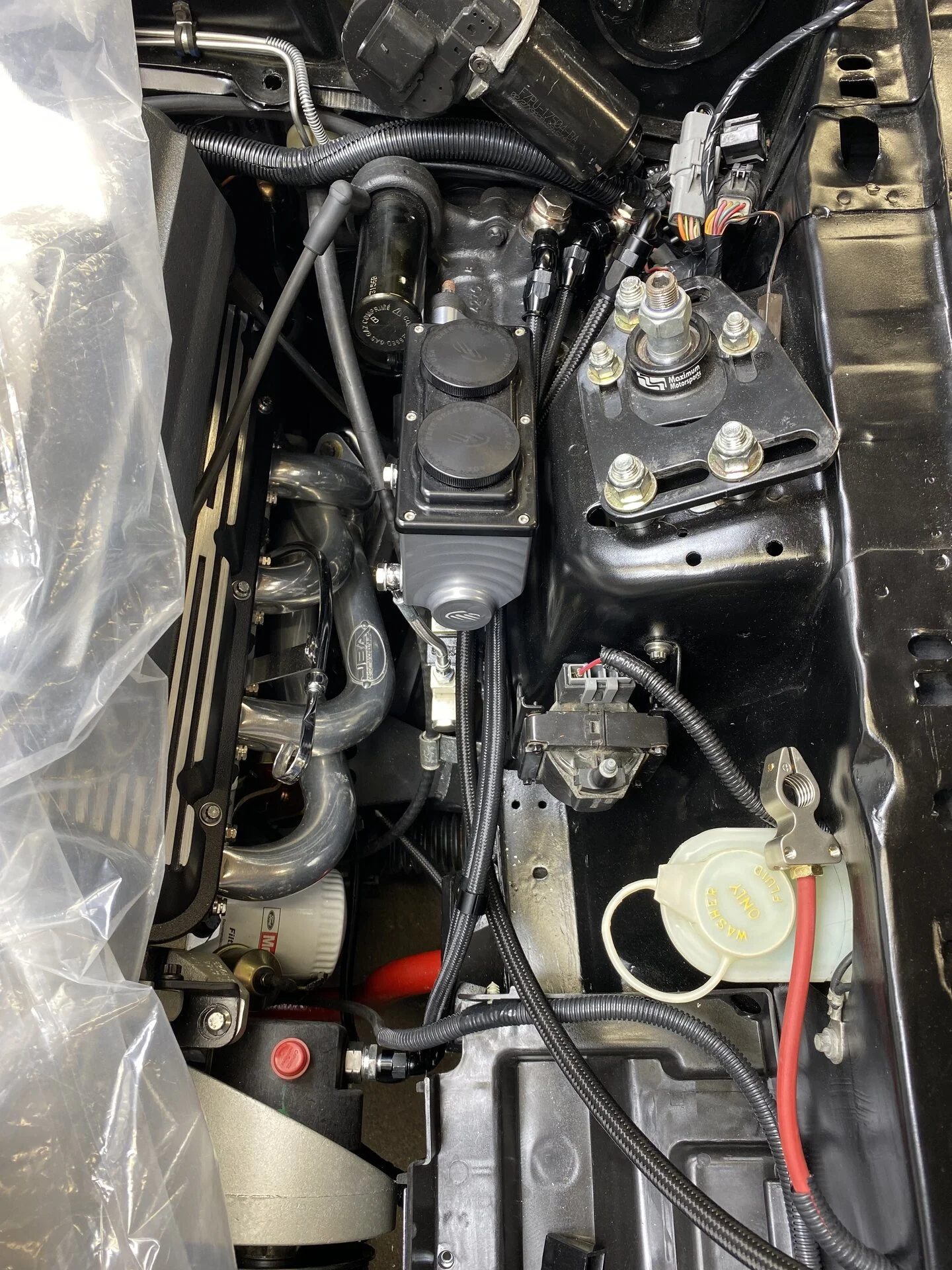

New power steering reservoir setup should be here tue. Should be able to wrap this up shortly.
