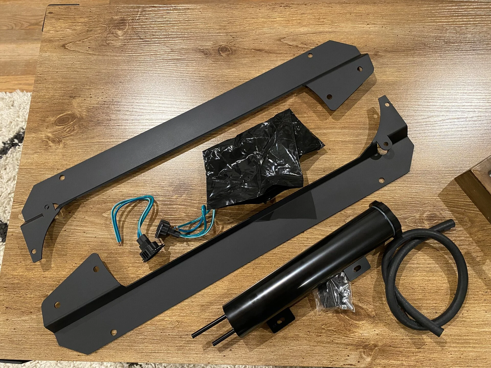

Contour fan kit came in.
Brackets are nicely made. Will mount the fan up pretty cleanly.
Not using the bottle. Going with a different bottle. Likely flip it on eBay. Wish LMR sold the kit without the bottle.

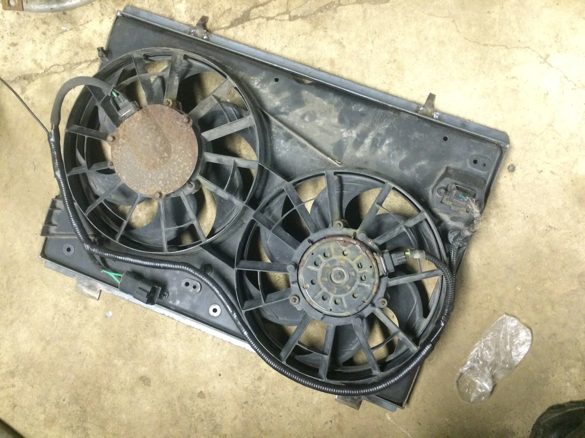

Aside from the T fitting and sensor at the bottom, this is essentially how the Contour is wired from the factory. On the factory Contour the low and high relays are triggered by the PCM.

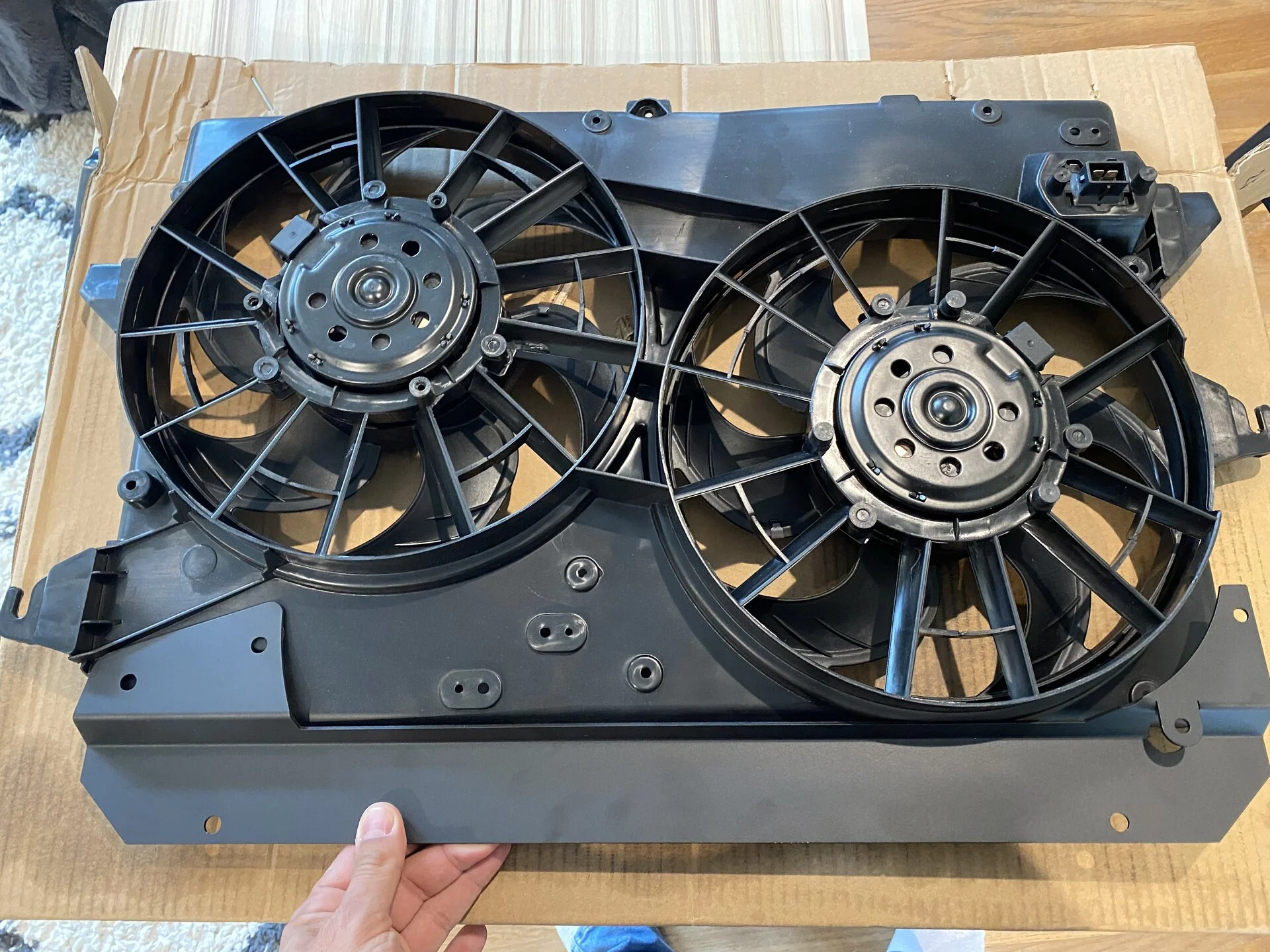

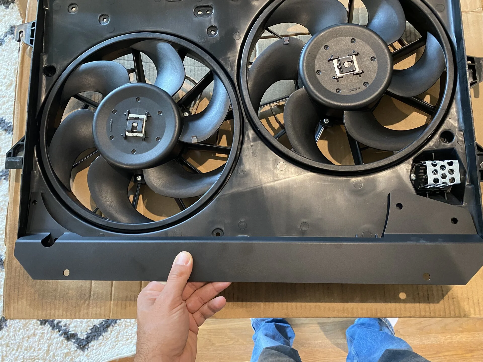

Contour fan showed up. Have to trim some of the plastic off forst, but the bottom bracket appears to be intended to bolt from the inside of the fan, and the top on the outside. Or maybe both on the inside? I’ll have to watch the video again

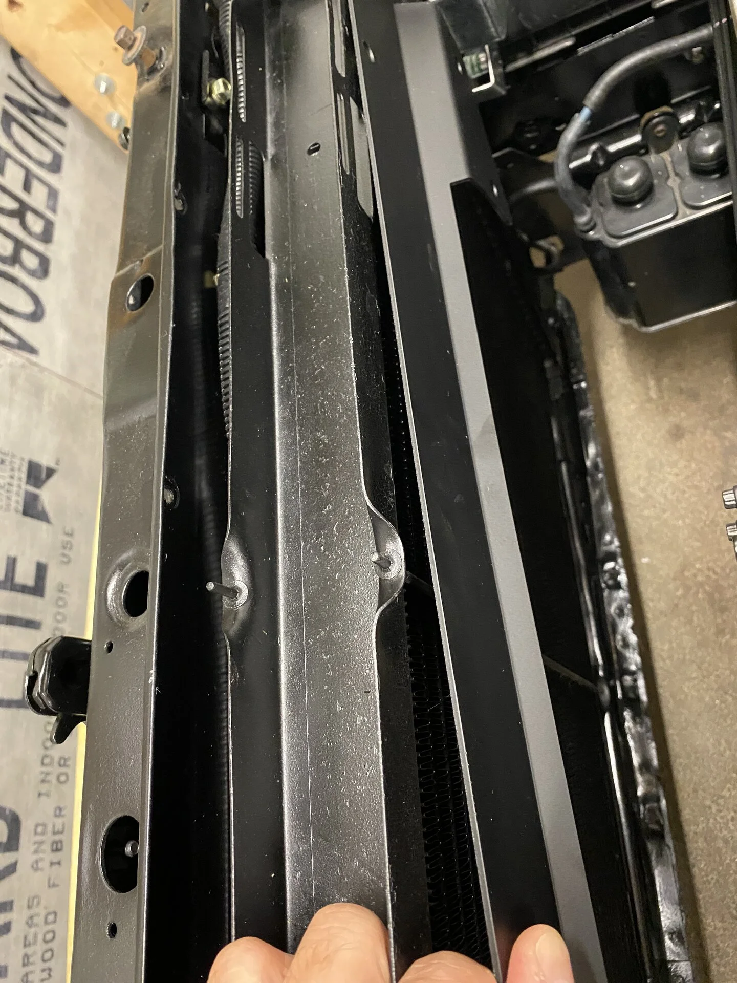

Of course nothing is easy. My radiator has a support bar on the outside of the core. I either need to remove it, or modify the bracket to fit around it

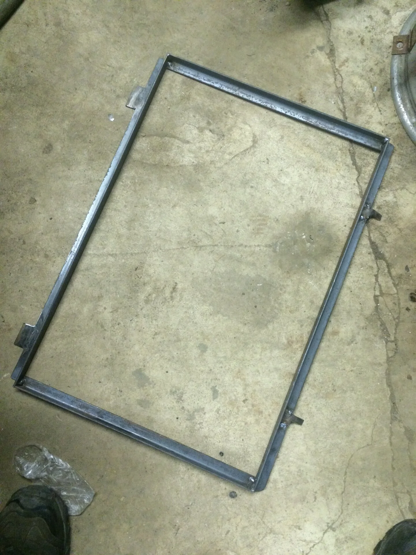

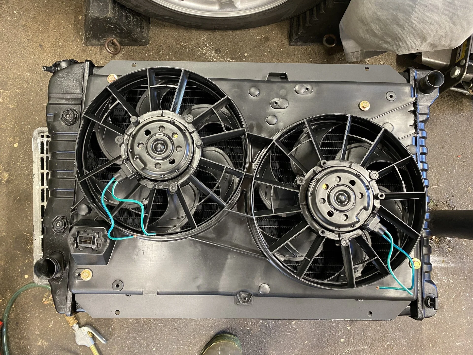

I know you have the install kit from LMR, but have you considered a simple box frame. Here is what I did...
The flat of the angle made for a great surface to put some adhesive foam tape as a contact surface to the rad.
You could take the frame idea above and cut out the section that would interfere with your support rod. On mine, the frame rivets to the Contour shroud. You could do the same with the two frame sections and rivet to fan shroud.

It’s not the shroud I’d need to notch. I’ve have to notch the brackets.

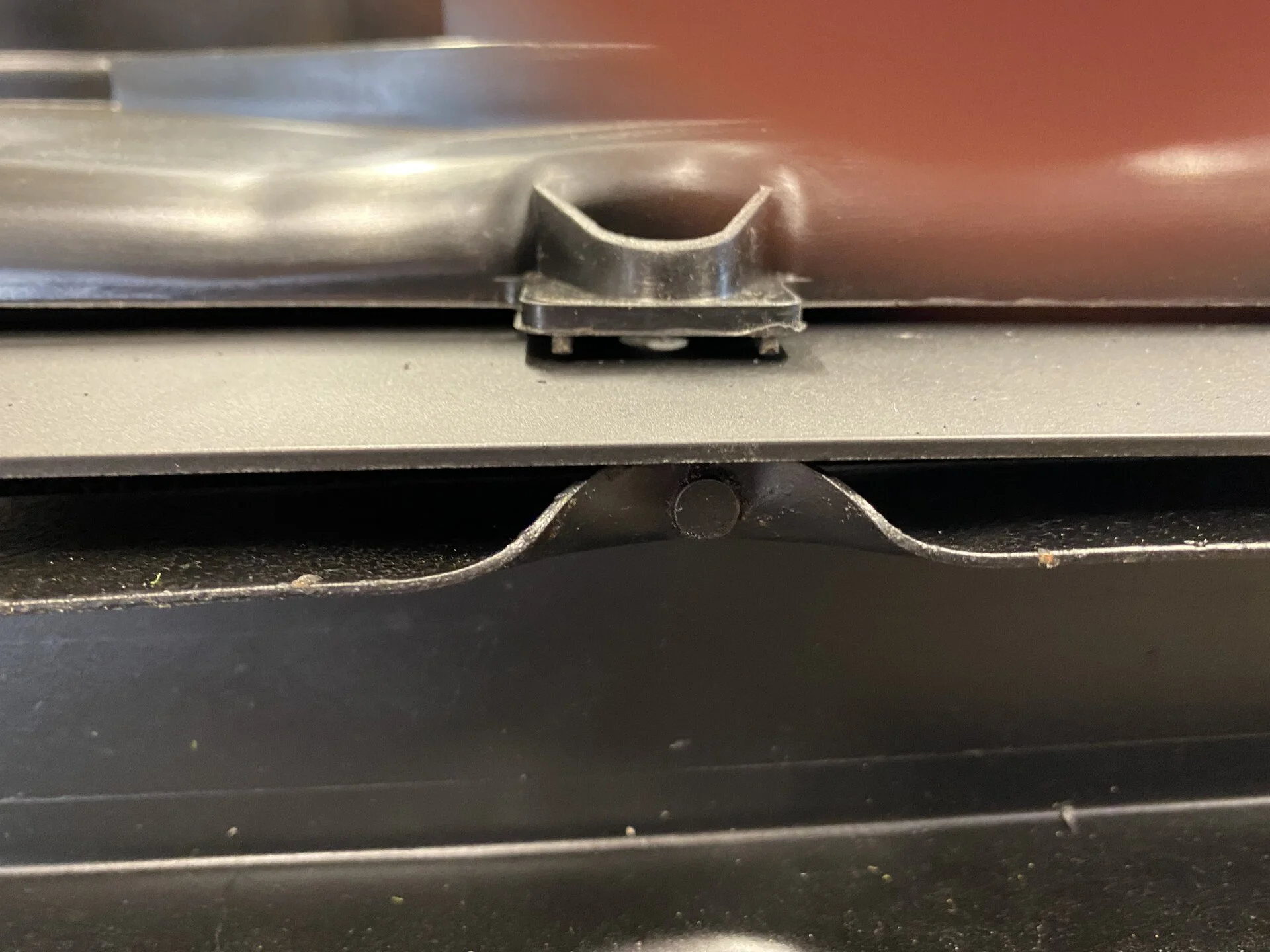

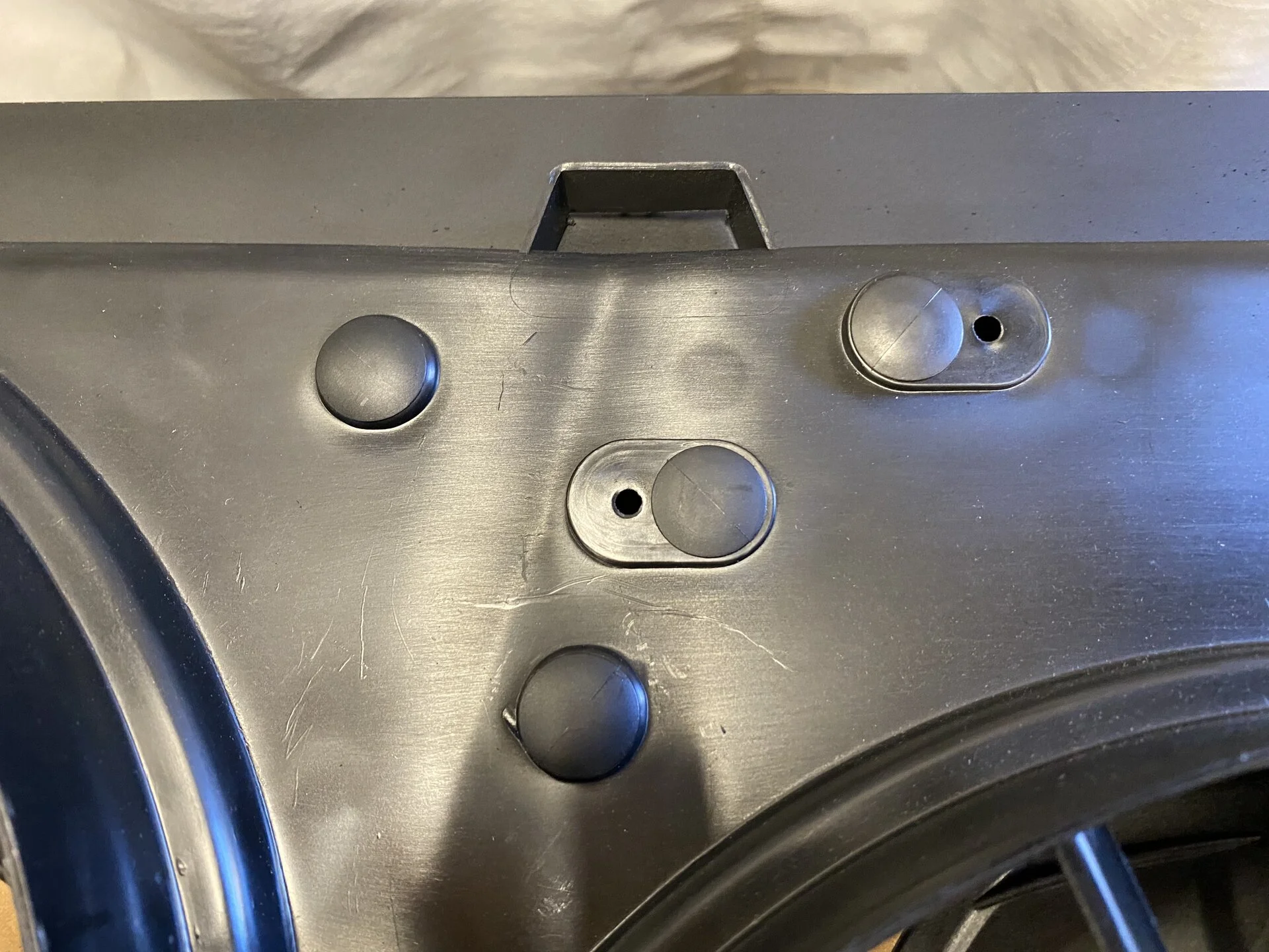

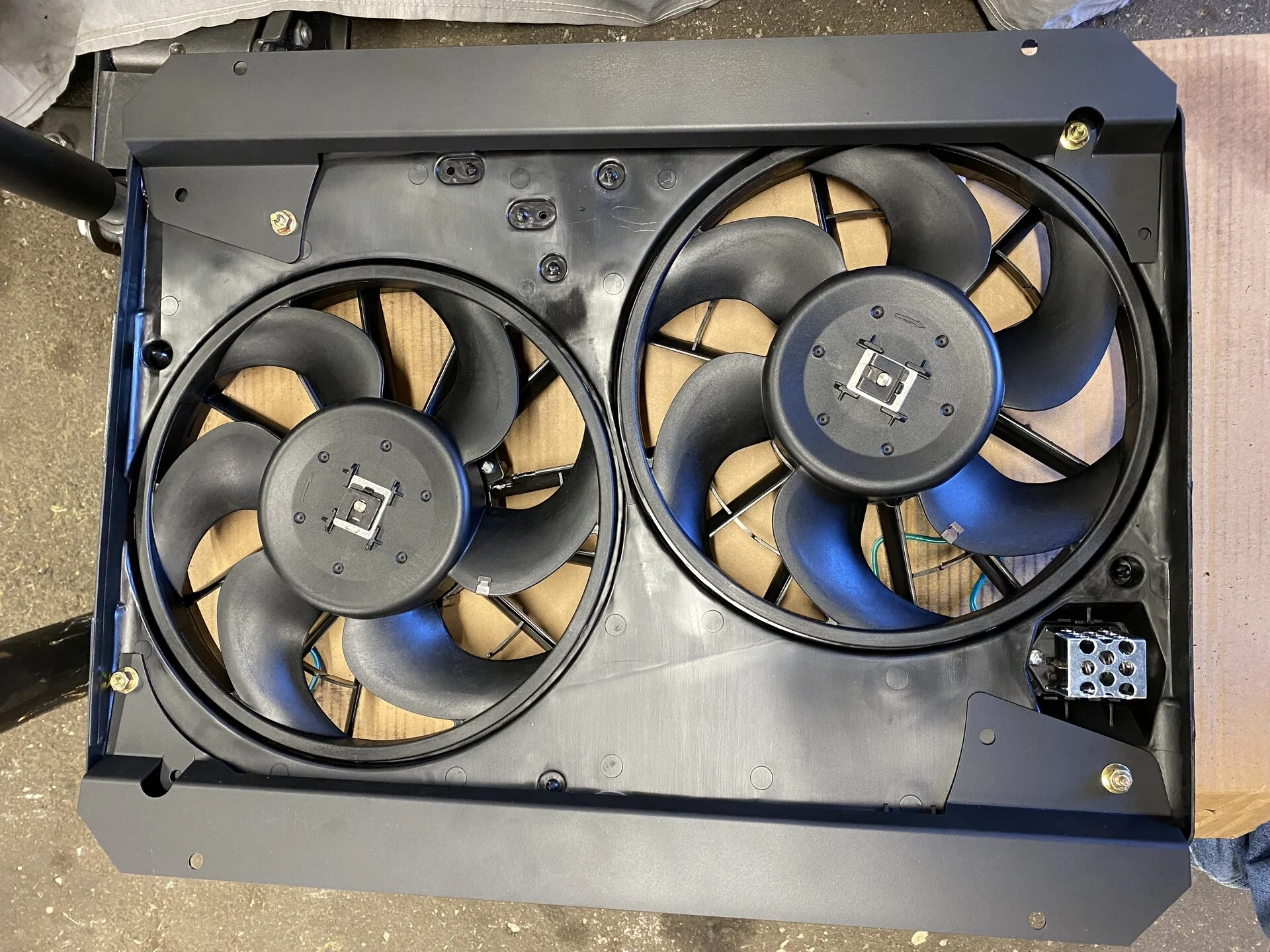

Ok. Mounted up the brackets. Pretty straightforward
Few pushpins for the misc open holes

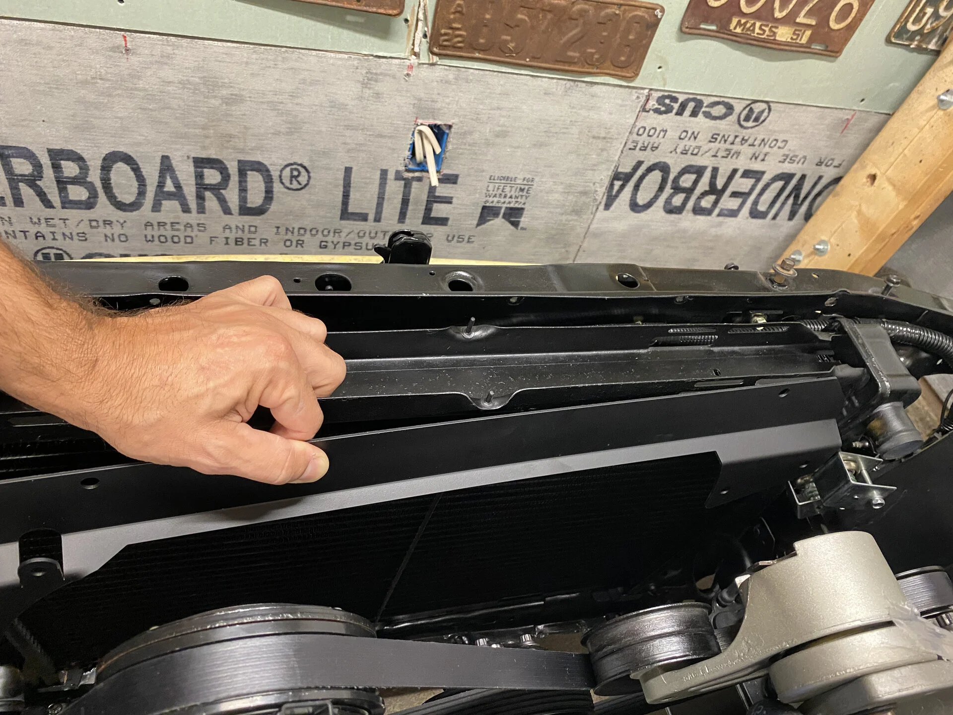

I’m likely going to remove this support rod and straighten out the radiator here. I don’t think it will affect anything negatively

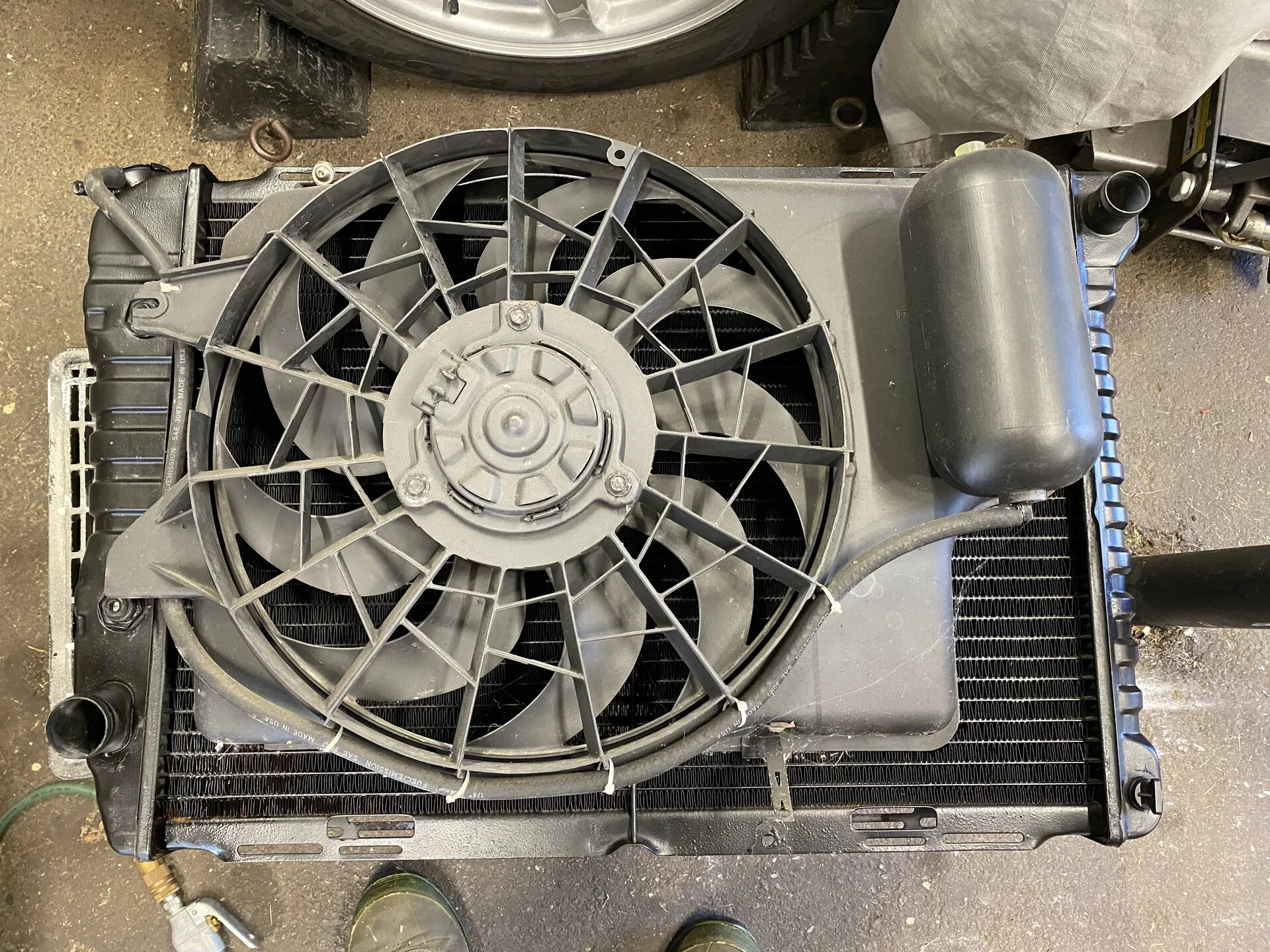

Overall, covers the entire radiator much more complete. My SN 95 fan left open areas. I’m not too worried about a reduction in cfm. The added area shrouded plus the fact that my car cools itself very well with this big 3-core brass radio means it will likely not be an issue. I don’t really drive when it’s blisteringly hot anyway. Not fun IMHO even with ac. I like windows down, and sunroof off.

That does look like a pretty clean installation! I like when it looks factory. Very nice!
