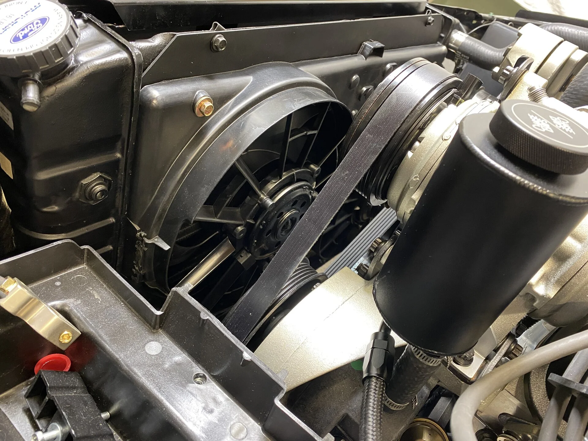

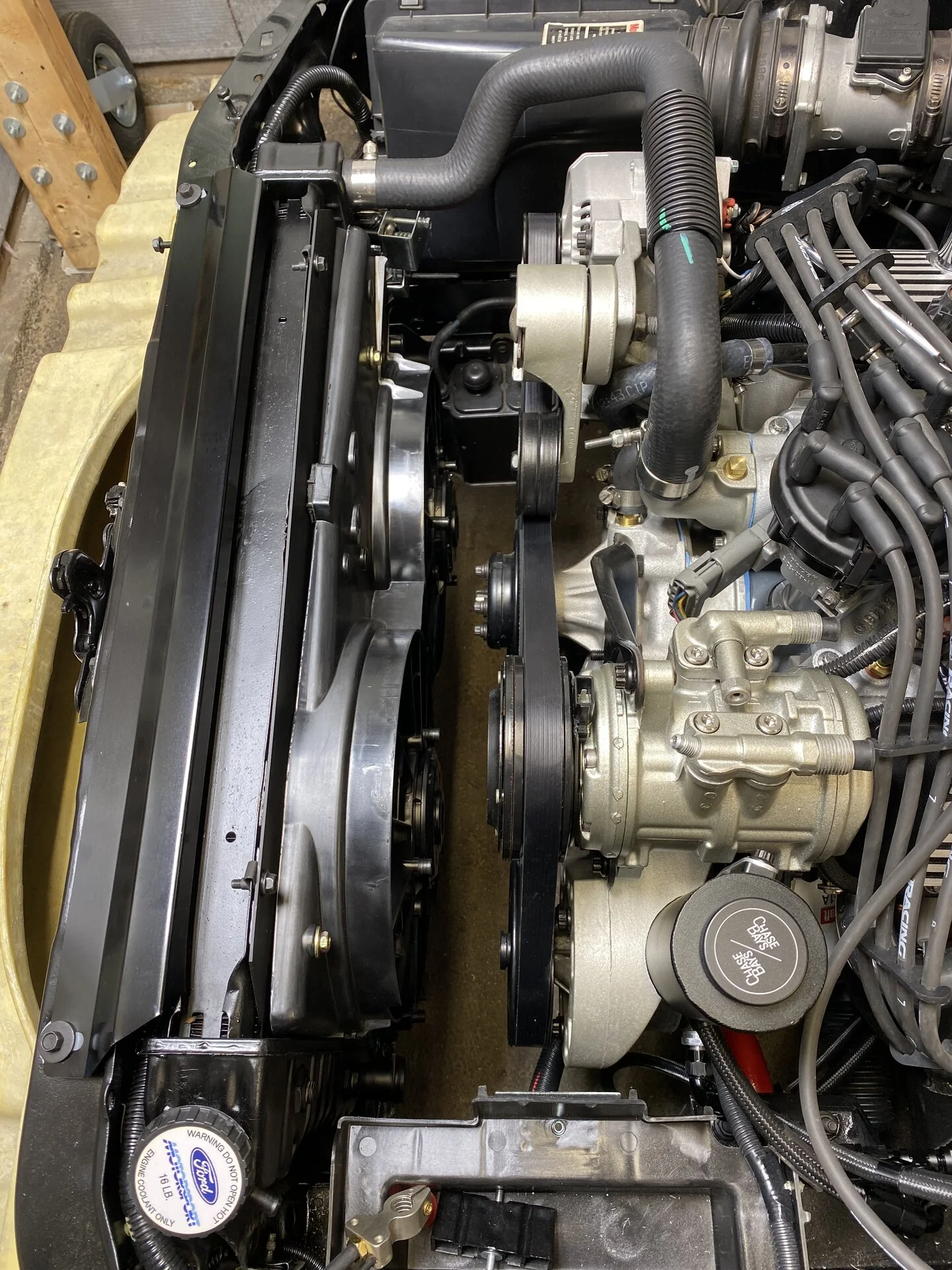

Ok. Got around to removing the support bar on the radiator and straightening out the main rib. I had a plan to reinforce it if necessary, but it wasn’t needed. There was no flex. Radiator mounted up perfectly.

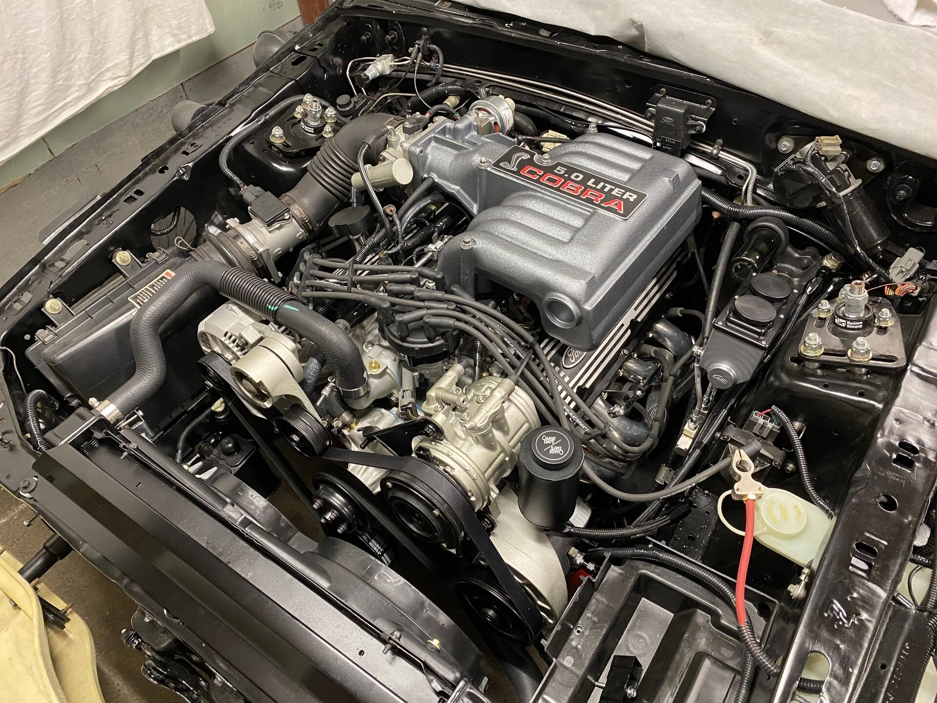

Dropped in the car and all the coolant hoses installed. Still need to wire it up, but I’m very happy with this setup.
My Chase Bays coolant bottle is in the mail. I think I have a good spot to mount it. Time to grab some coolant from local parts store.
Edit: also, used the LMR radiator hold-down vs the stock clamps. I like it. I think the hood prop will interfere with it but I’m pretty sure I’m going with hood struts instead

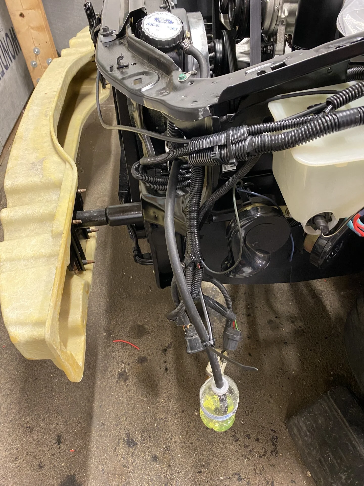

Ok. Buttoned up some loose ends. Checking wiring, set the dist to tdc#1 and started filling with coolant. My overflow bottle isn’t here yet but I can just use a water bottle for now. Fans aren’t wired but I don’t plan on running it that long.

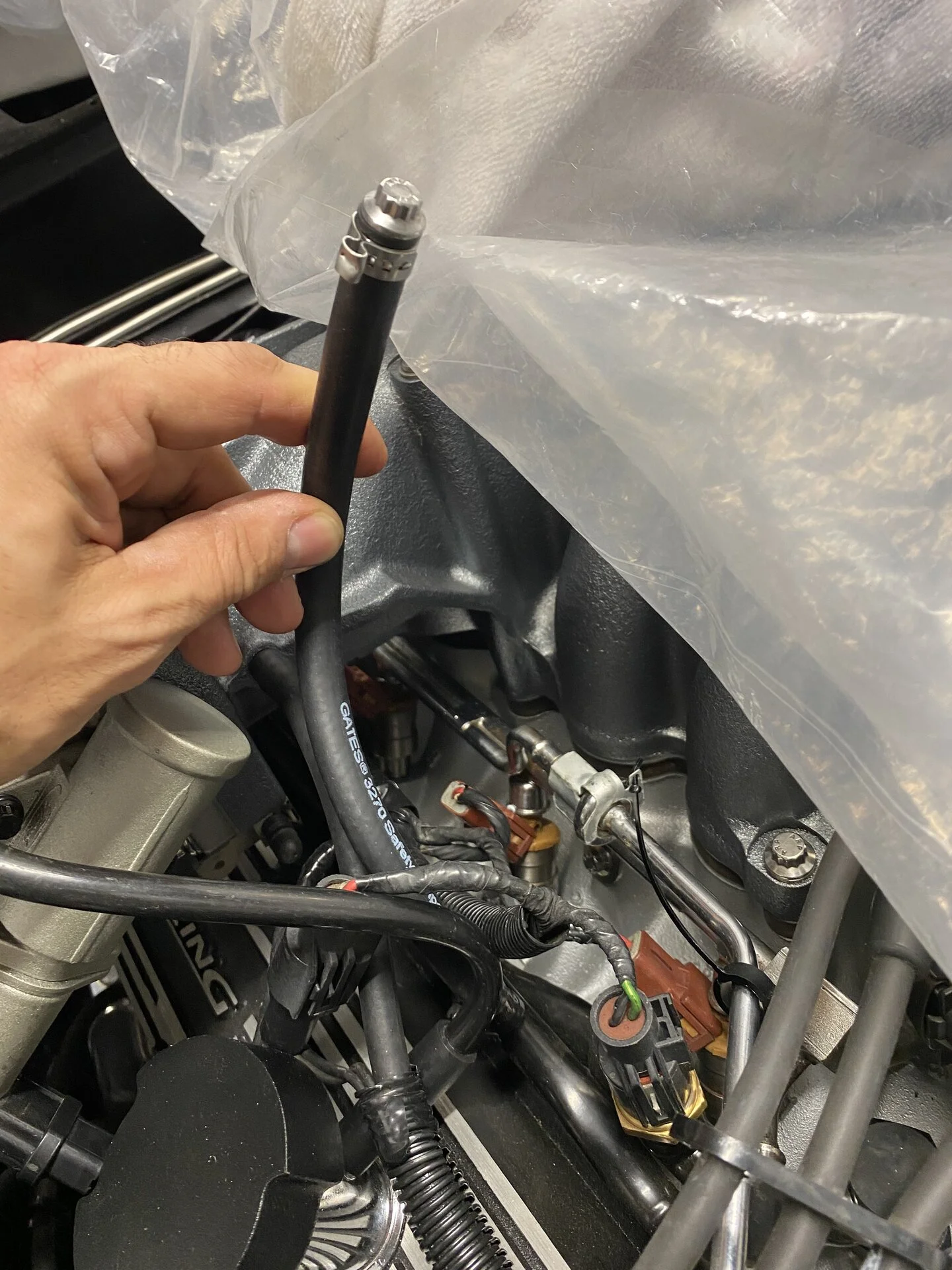

This line was mostly meant to be temporary. However it’s full of air and also the highest point on the engine. If I use a vacuum pump here (with liquid separator in line of course) and fill the overflow with coolant, I should be able to suck the air out while drawing coolant in from the overflow. Might not fill it up all the way, but should displace enoigh air to start to get some coolant moving?

How about just pull that bolt out, prop it up higher than the rad and keep filling the rad until all your air is out of the system.
Better yet, replace with a clear hose (temporarily) so you can see that the coolant has burped at least to that point. Then plug the hose and go through a engine running cycle.
Tried a version of that. Didn’t work. It’s like there’s an air pocket which won’t move.

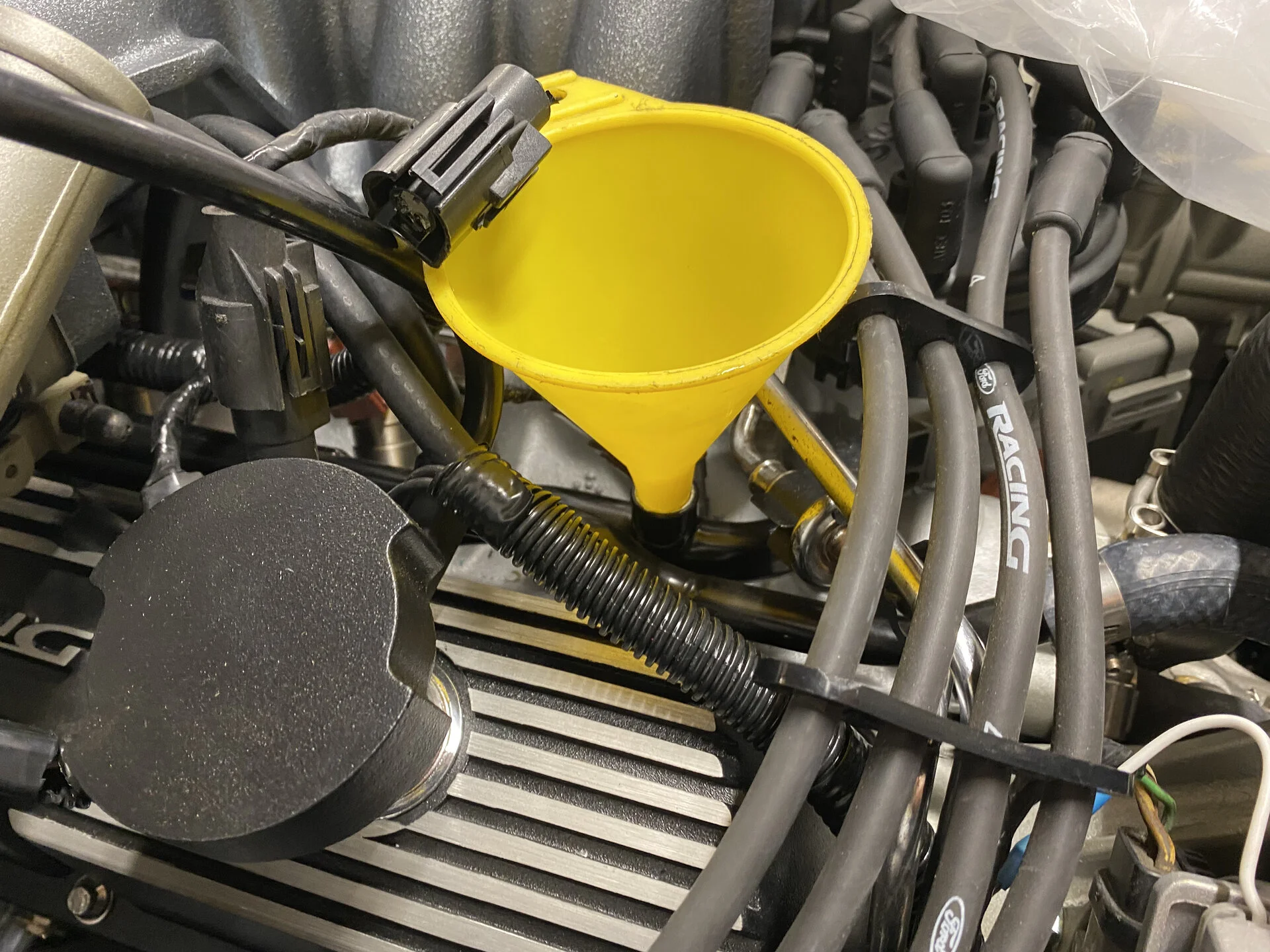

Was able to get another 1/4+ gallon in this way. This pipe was empty. A little squeezing of hoses burped some more air into radiator.

LMR offers a heater tube that doesn't have that coolant port for the egr if you didn't want to deal with blazing it over but it also looks like you maybe keeping it since your actually using it in the pictures :)
