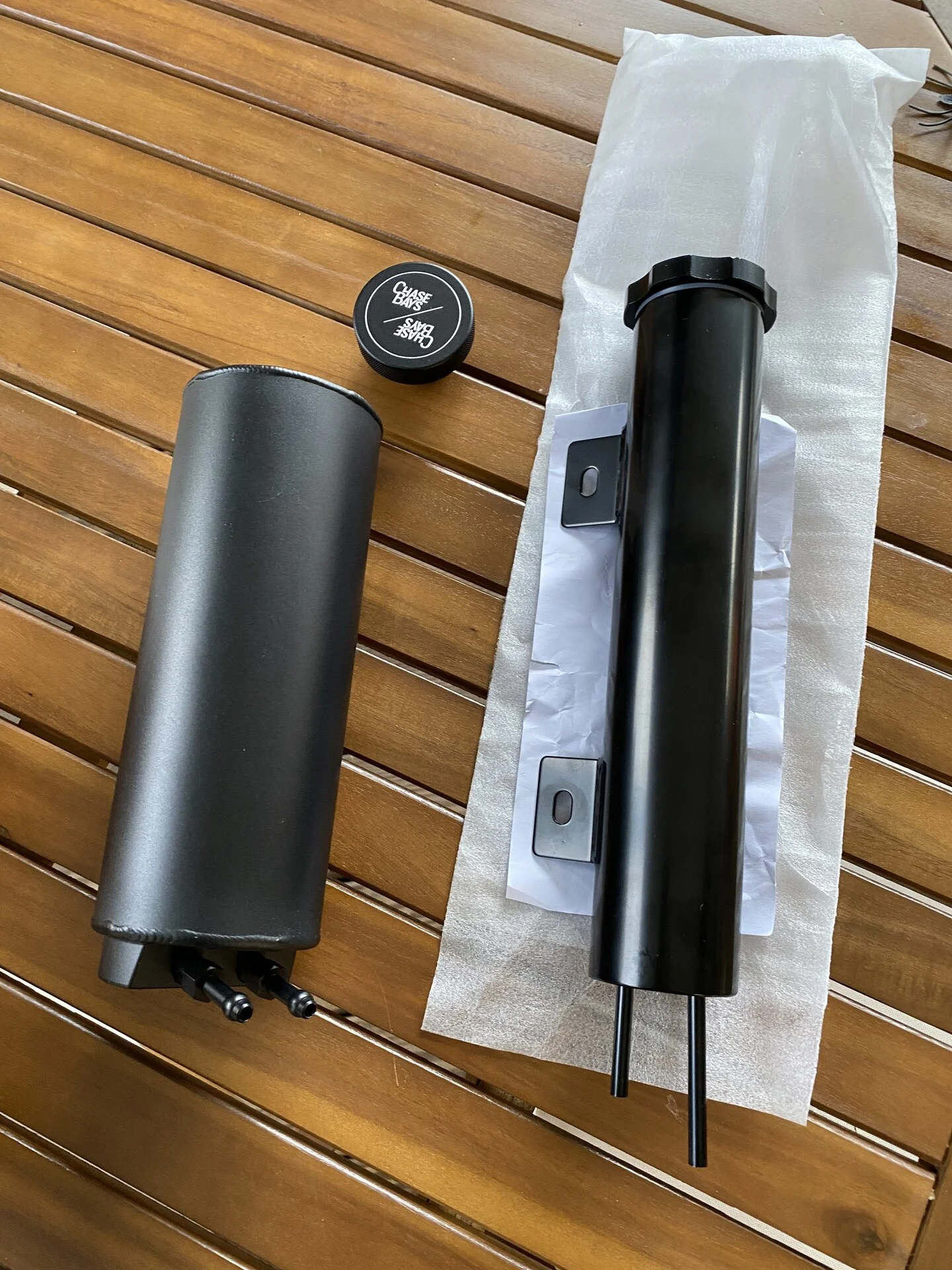

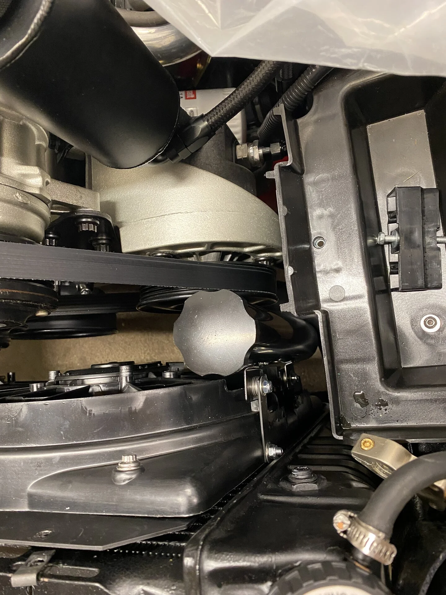

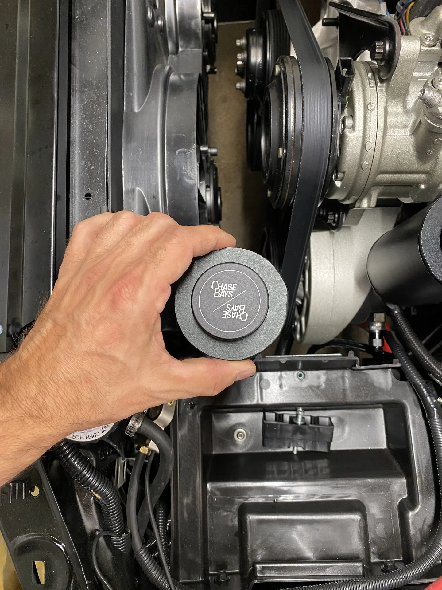

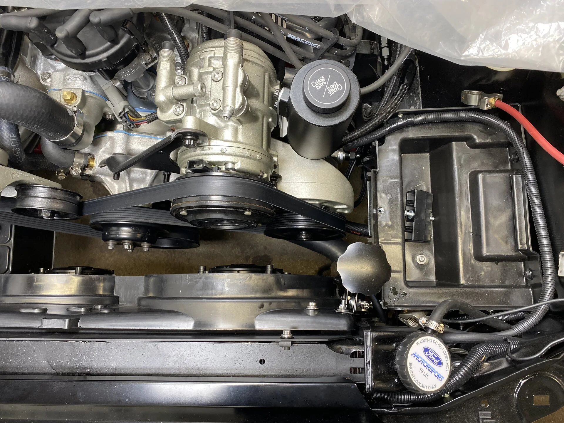

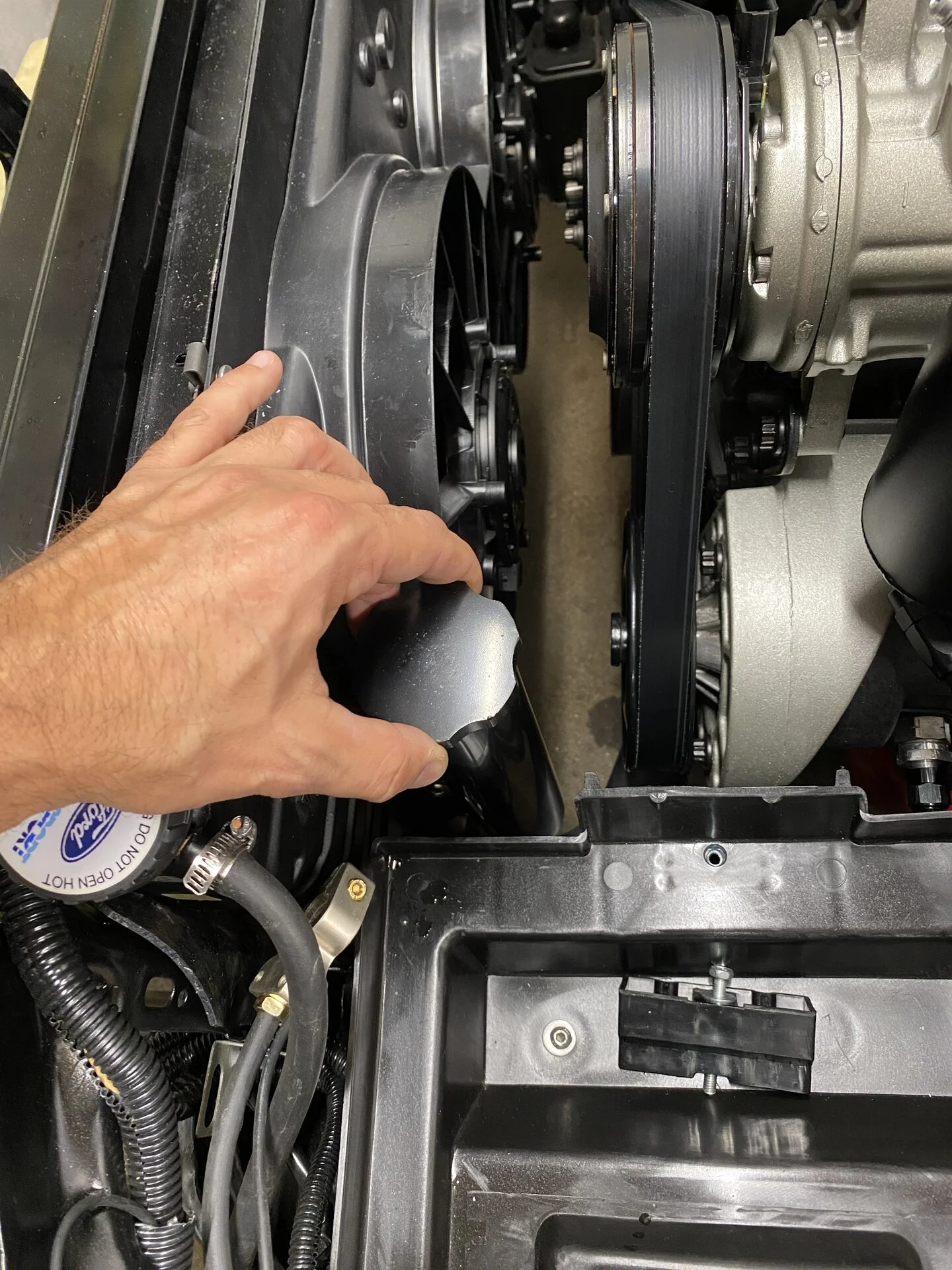

Coolant bottle showed up. I like the quality better than the generic SVE/Amazon bottle, but
The SVE bottle tucks in nicely and comes with the hardware to mount it.
This bottle is too fat to fit on either side. I might be SOL. Gonna think about it, but this isn’t something I’m too set in my ways on. If the SVE bottle works fine, I’ll run it
Can you mount it in front of the radiator and still get to the cap someplace?

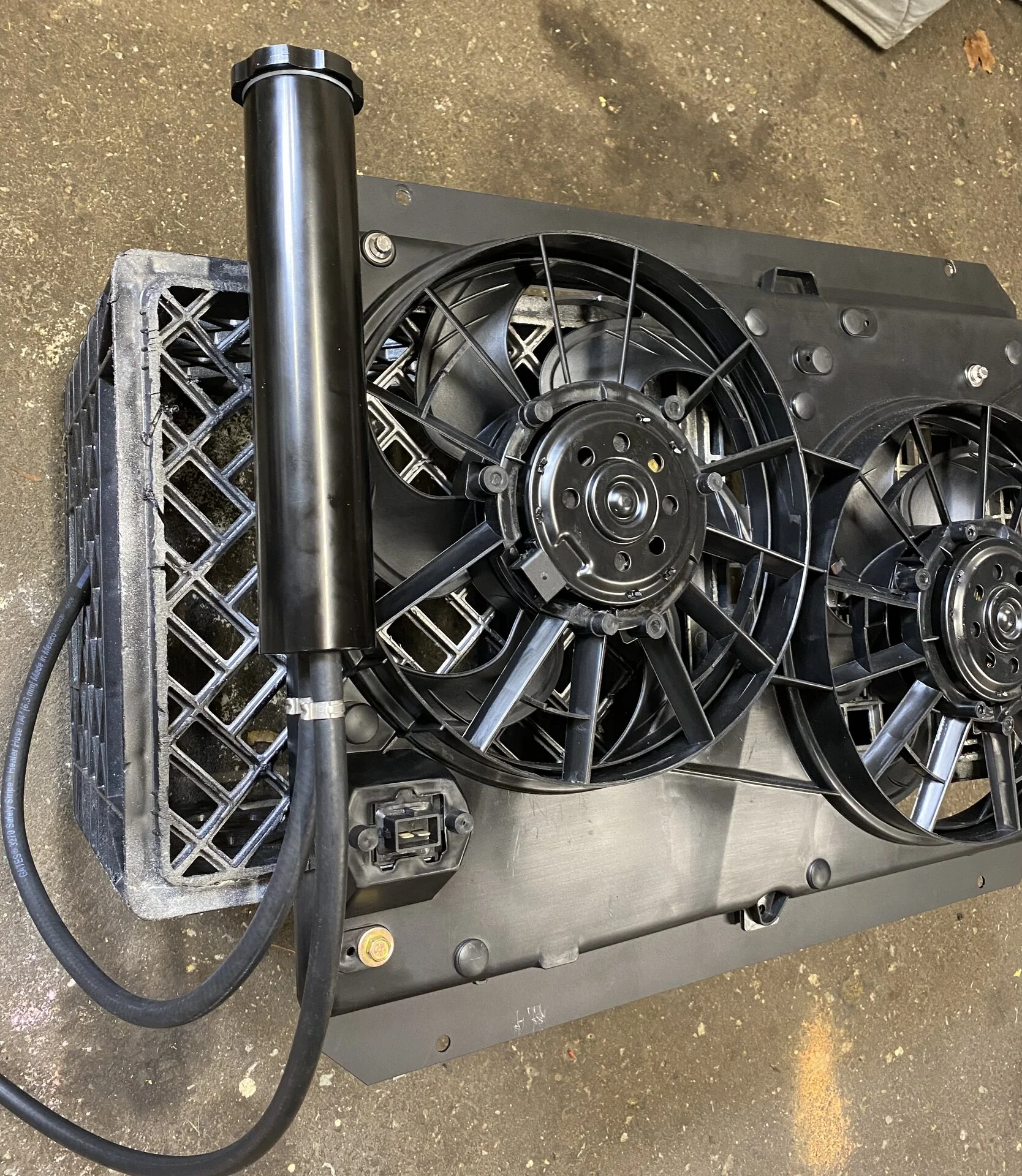

I tried. It really doesn’t fit anywhere. It’s just too fat. I’ve boxed it up to return for a refund. Nice unit, but just can’t seem to fit it.

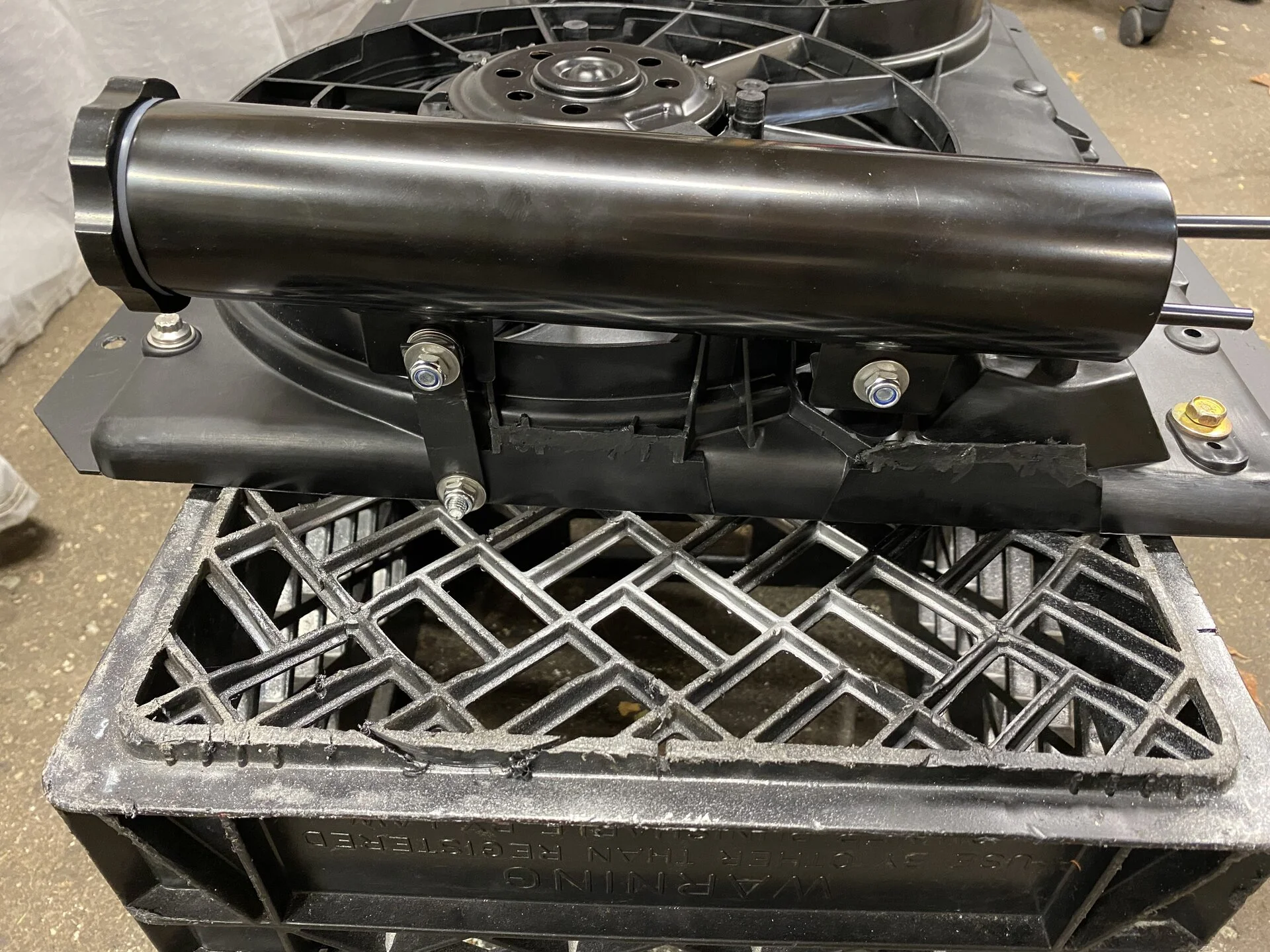

Meanwhile, not a fan of LMRs as written directions. It mounts the bottle crooked so I needed a stack of washers to even this out. Even still, it’s too far from the fan shroud and almost hits the power steering pump.
Soooo…I need to make some brackets to do this the way I want to do it. Maybe some ARP hardware too. :shrug:

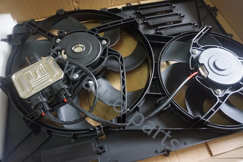

Going to use a Volvo S80 controller. It’s a dual fan controller and on the Volvo it’s installed with a 60amp fuse. Should be plenty for the contour fans.
Here’s the Volvo fan. As you can see similar to the contour fan.
So really you just need 3 wires. Fused power, ground and your signal wire.
I have a little signal generator I can use for now. I just want to run a fan for now while I do my final assembly, so manual control is fine.
Eventually I can program it in the MS3X
Reactions: General karthief

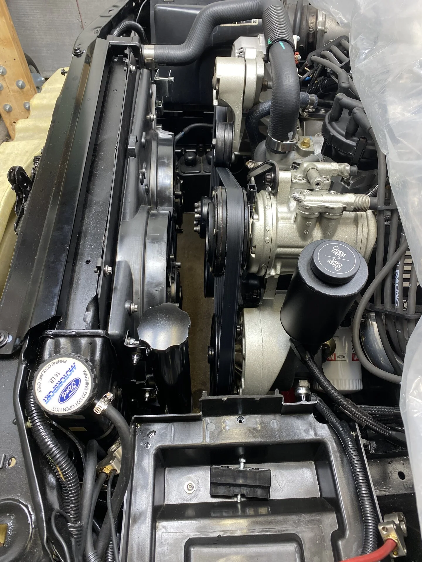

Well, managed to jump start the coolant flow. Jacked the front up, ran the engine and massaged the top and bottom hoses and got that air bubble to move. Given that it was a cozy 36 degrees this AM, I could idle it for a while without a fan. But my next step will be fan wiring.
Once I get the ability to idle indefinitely without risk of overheating, my list of things to do is:
Set timing
Run codes, make sure everything is set up well
Continue to top off fluids (coolant/PS)
She loads up a bit at idle, and runs rich. Clears up with a few revs. After a few mins it begins to lope. Too early to really dig into that but the goal was to always run an aftermarket ECU. I didn’t really think the A9L would run this setup perfectly.
Once the engine is all set, installing the remaining AC lines, pull vac and charge. I am very much looking forward to that.
All things considering it runs pretty damn good.

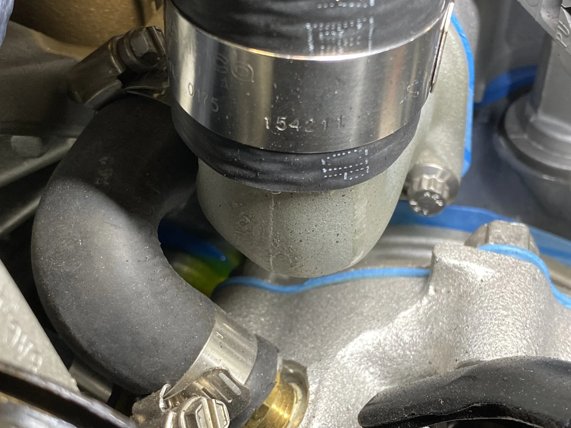

Also, first issue reared it’s head. Leaking t-stat housing. Popped up after a couple heat cycles. Can clearly see it leaking from the gasket.
