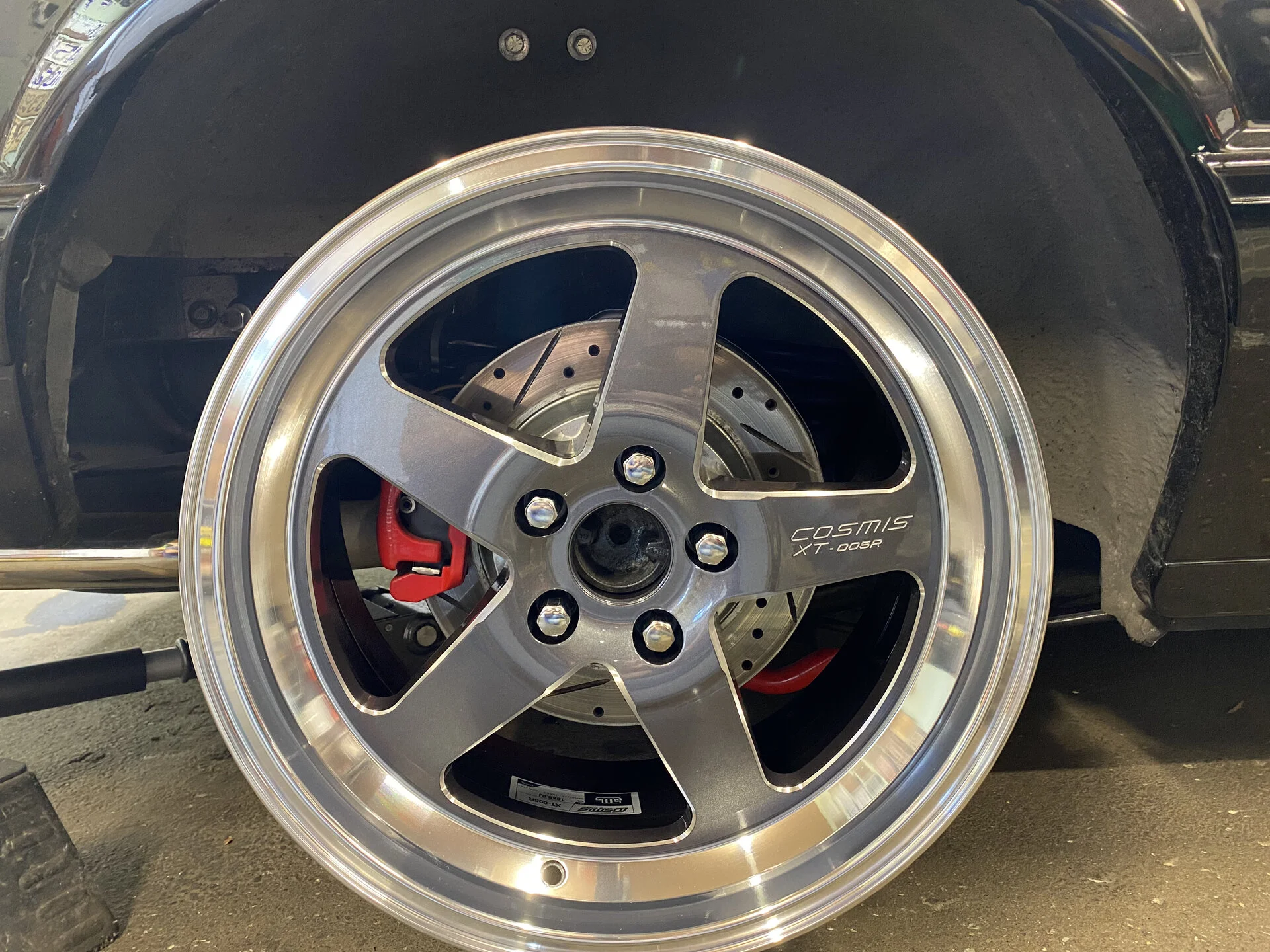

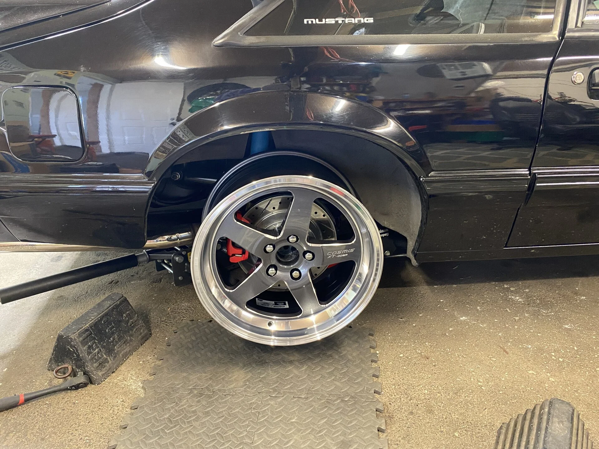

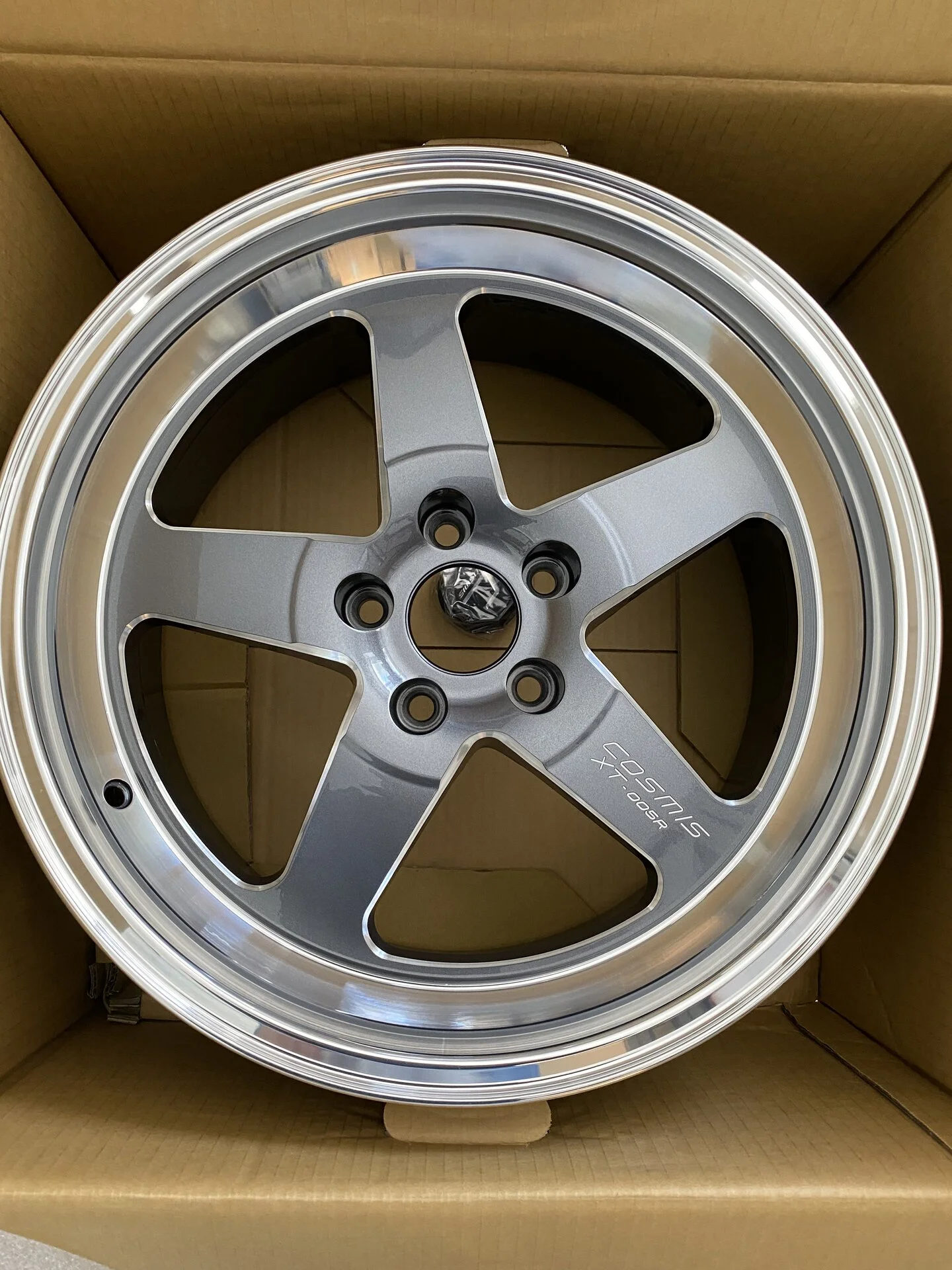

Decided to test fit this rim to see how it would do with the SN95 axles. I do not like the look of the 18x10 version (not a fan of too much barrel) so I’m sticking to 18x9 all around.
Practically Even with fender lip, so I need to go back to fox axles.

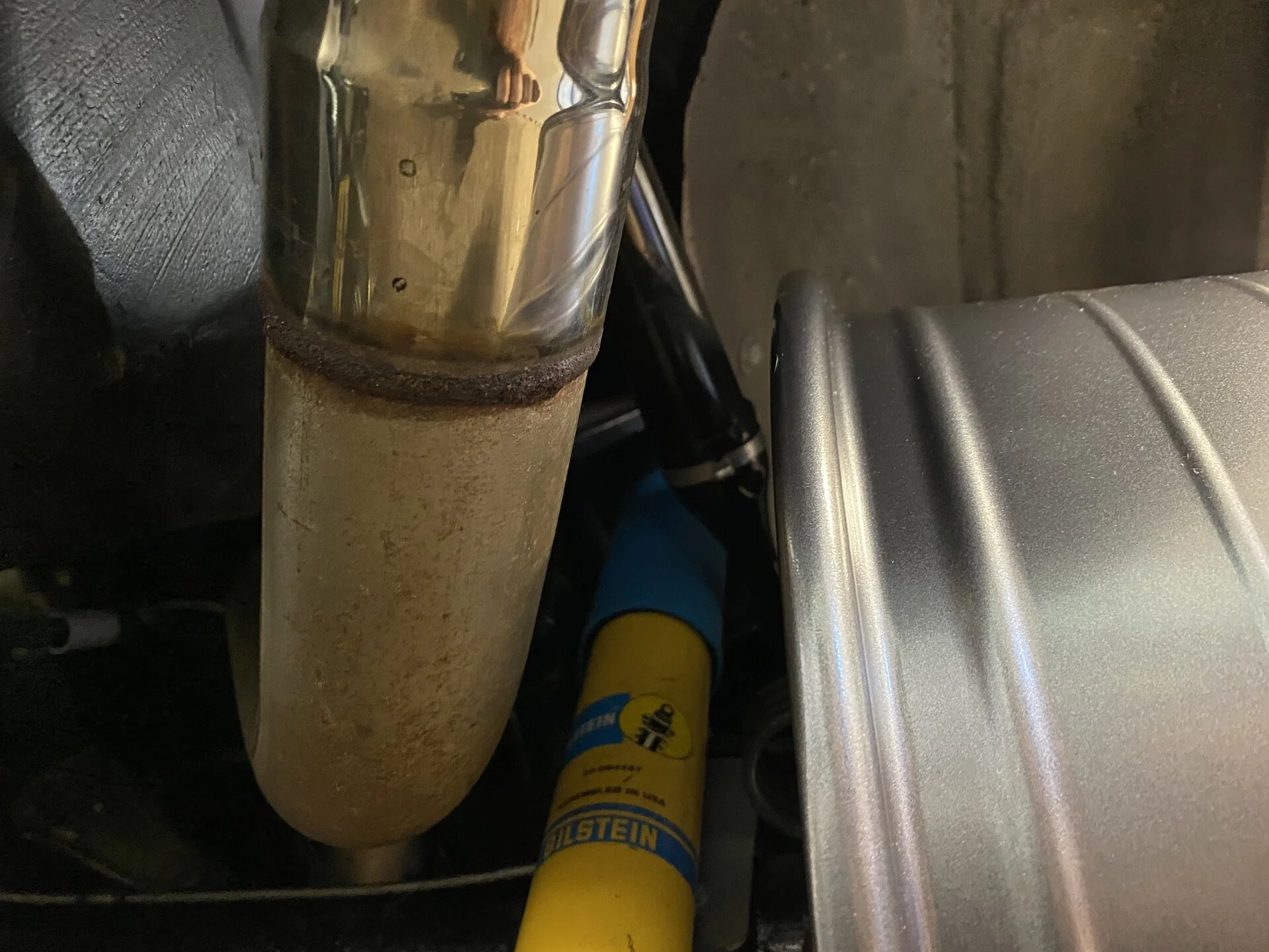

My concern is with the tire now hitting the tailpipes. It will be close
Nice work Mike. Why the axle swap? It seems most people (Atleast the ones I know) strive for that type of fitment.
Ps I love the wheels

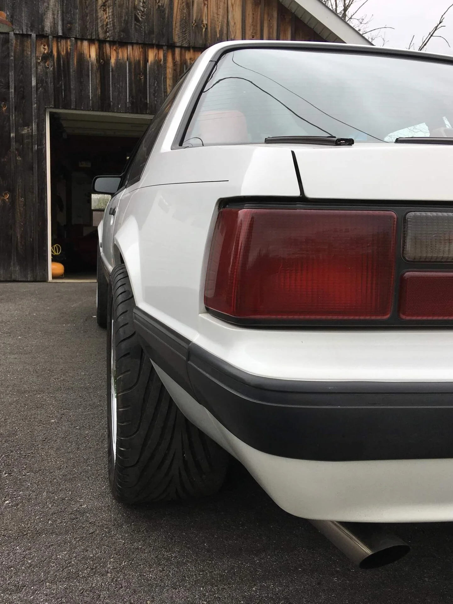

I think with a 285 tire, it’s going to stick out past the fender lip. I have the car a tad high right now and wanted to lower it down a bit more
285 width is 11.2 inches. So add about 1” to each side for tire width and it’s close.

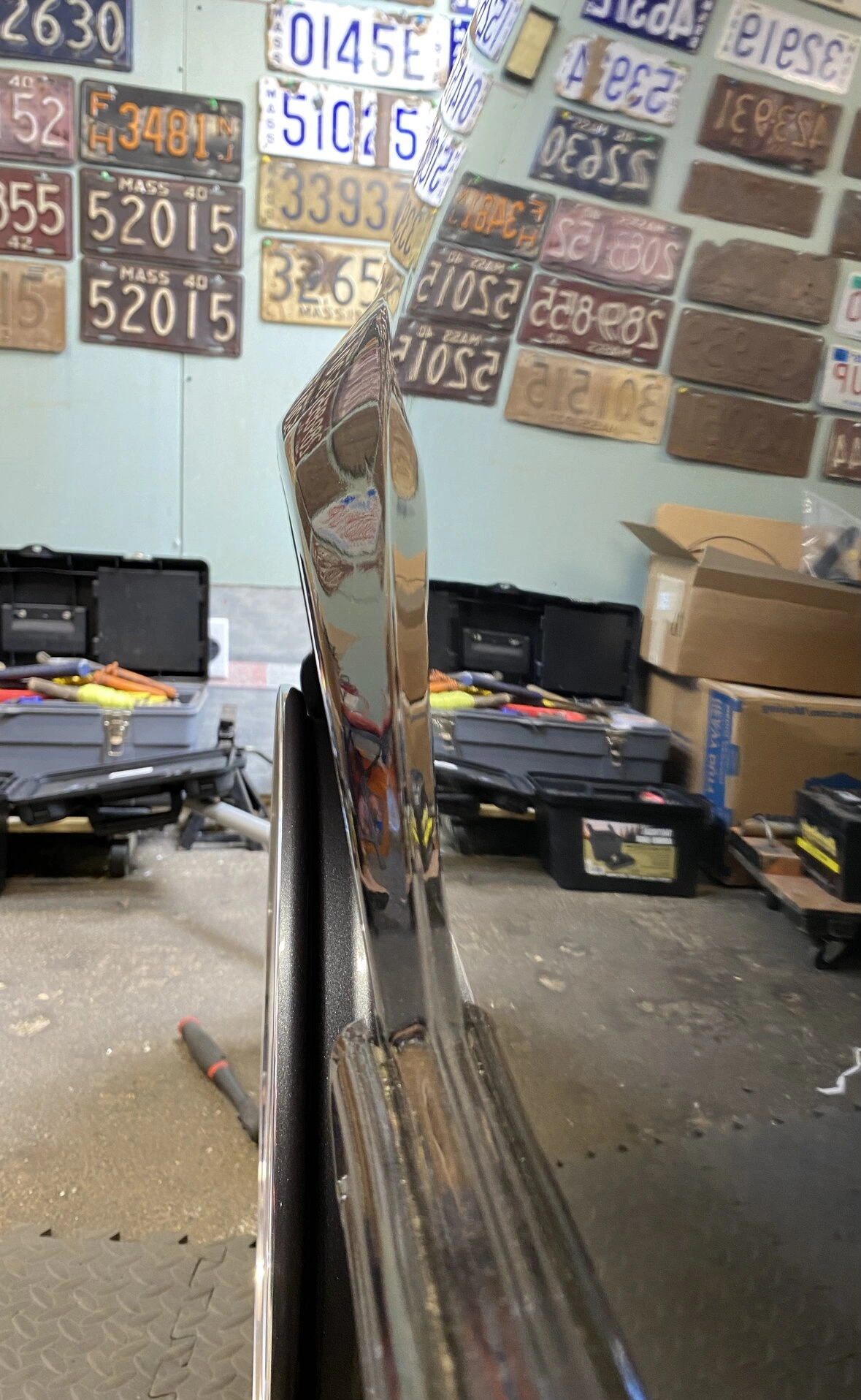

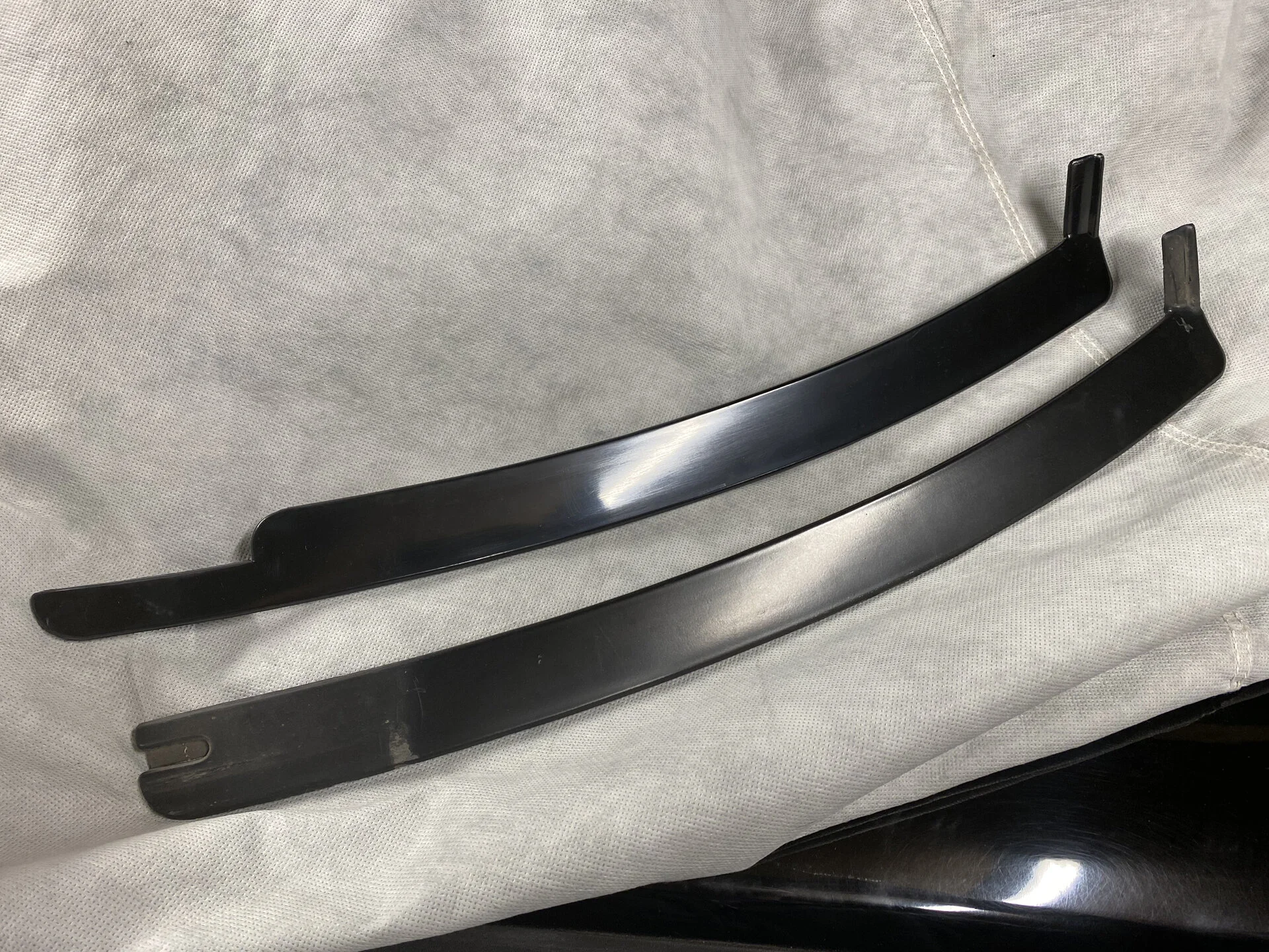

Had to replace some busted windshield trim. Got the DCMR trim from LMR. It’s a lot shinier, but my trim was 30+ years old and probably sunfaded and painted at some point.
No it’s not broken. It’s shaped different in that area. My trim had an E7 part number, the new stuff is made from an E9 mold. Looks like one of those subtle changes that nobody cares enough to know about.

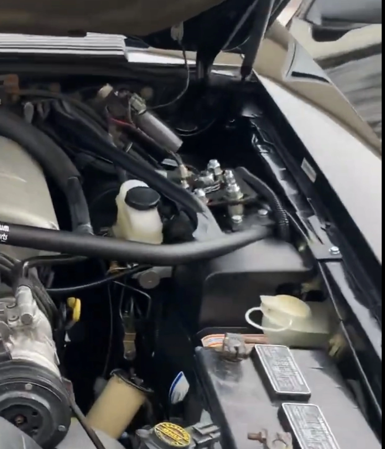

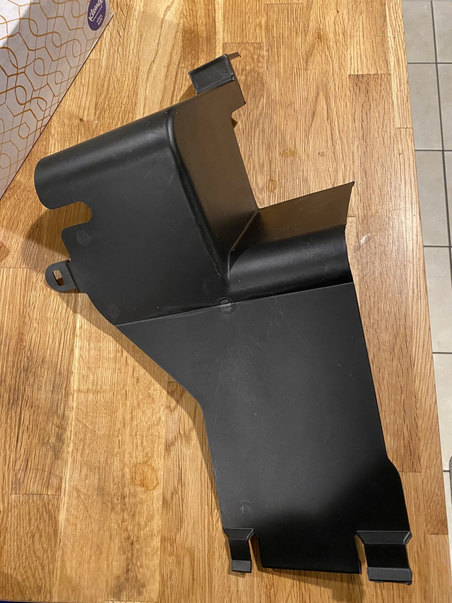

cant find what I am looking for, I need the part number for that fan control module your using. I only have a single fan to run, my current setup works ok but occasionally will melt the fuses.
21493-B210B
21493-C370B
There are a few other part numbers but they were all superceeded by the above. I've been snagging these off Ebay for $20 or so with wiring.
21493-B210B
21493-C370B
Thank you, are these the same unit? I removed the first h to break the link.
ttps://www.ebay.com/itm/272184026928?_trkparms=amclksrc%3DITM%26aid%3D1110006%26algo%3DHOMESPLICE.SIM%26ao%3D1%26asc%3D237147%26meid%3D569d0e3a10b64f1b9ba4a09a861ad402%26pid%3D101196%26rk%3D1%26rkt%3D11%26sd%3D265547219668%26itm%3D272184026928%26pmt%3D1%26noa%3D0%26pg%3D2047675%26algv%3DSimplAMLv5PairwiseWebWithBBEV2bAndUBSourceDemotionWithUltimatelyBoughtOfCoviewV1%26brand%3DAftermarket+Products&_trksid=p2047675.c101196.m2219&amdata=cksum%3A272184026928569d0e3a10b64f1b9ba4a09a861ad402%7Cenc%3AAQAGAAACUNF0TKM0dyfcQgCHUzDTTqHMQ4%252BNok4Mq%252FNkHfRWeUpH4R0dI45dtkkF4tg1SxIuPPKN0QRGZ8sXnusZypBNi38V87Sn%252BUcu2Jq9KYTCz8JH4tOw5ABPvBwJzZZP2dK9u69r5o8tHqb9OfVjyH33kHAeabC9Cq1siDQ%252FE1ftHdU2Q6tzywsAMFT1GhzWHX2ezHYN%252BVyBRy0MlDUmZCozSpUlhdYhKmE0q%252BQIGd5f7NwPSDq6Sdvtlj6z8rTIrRPH2uR%252BhU8CrBiwLjVfQeJN485IPHjjvgizeLlZ8F3ctiHKmpQKTpD%252BTGe6zaX9aLqH4snVv8b1vhvUubO6pH3NSHYlP0G6woeFNUkW86dOq0mxxfGX36BtDPfz5tgAR8kKzQ%252BkJ53AO4wkOMrsdQxZwoVLue0euw2FO7K2CvDJfeRY4TxxeCWWs6lH20fNTkEqmU%252FnVSZA55cFhb0NsJCXh1D1cK4o6uF5pC4BQZNROXGSkcmIIAFH7RNPFzXGSfG4wqLNXNEa9YpoOAma%252BoArj4hbYVT25QgG9UWO4%252Fd9DQbU5ad4ukeul2dcMj3Jz2ah2pV3CYBBho1XTEj%252BR8icCoLKoGJeX6eaEy8TWJZwDWLsV0os2MtrI5VBT9MHkrGPvD6a8yZ%252BBvUMgjz5xL3%252F4%252BgEel6yn1PcQED4PCcDleTepa9SJtikzkurCKYqPnbxhChoDs%252BlsFXu%252Bi4yjbkUxnQKJ%252B%252BQmw%252FT5K4Co6Y6ffBVl5K6vp99E6bx2WtkY280f8GBWmab7SHO5iG%252FWroVTyQ%253D%7Campid%3APL_CLK%7Cclp%3A2047675
Yup. That’s the unit. I haven’t heard much good about the aftermarket ones in terms of longevity. Amazon and eBay reviews have been terrible. I really suggest getting an oem unit and one of the later modules.
This is one of the better modules
And this one comes with two of the plugs and is the updated module
Those damn plugs are a brunt of the cost.
I’d see if you can get that $30 module for $20-25 and then just buy the plugs separate or go check out a boneyard for some mid2000s Mazda’s/Mitsubishi’

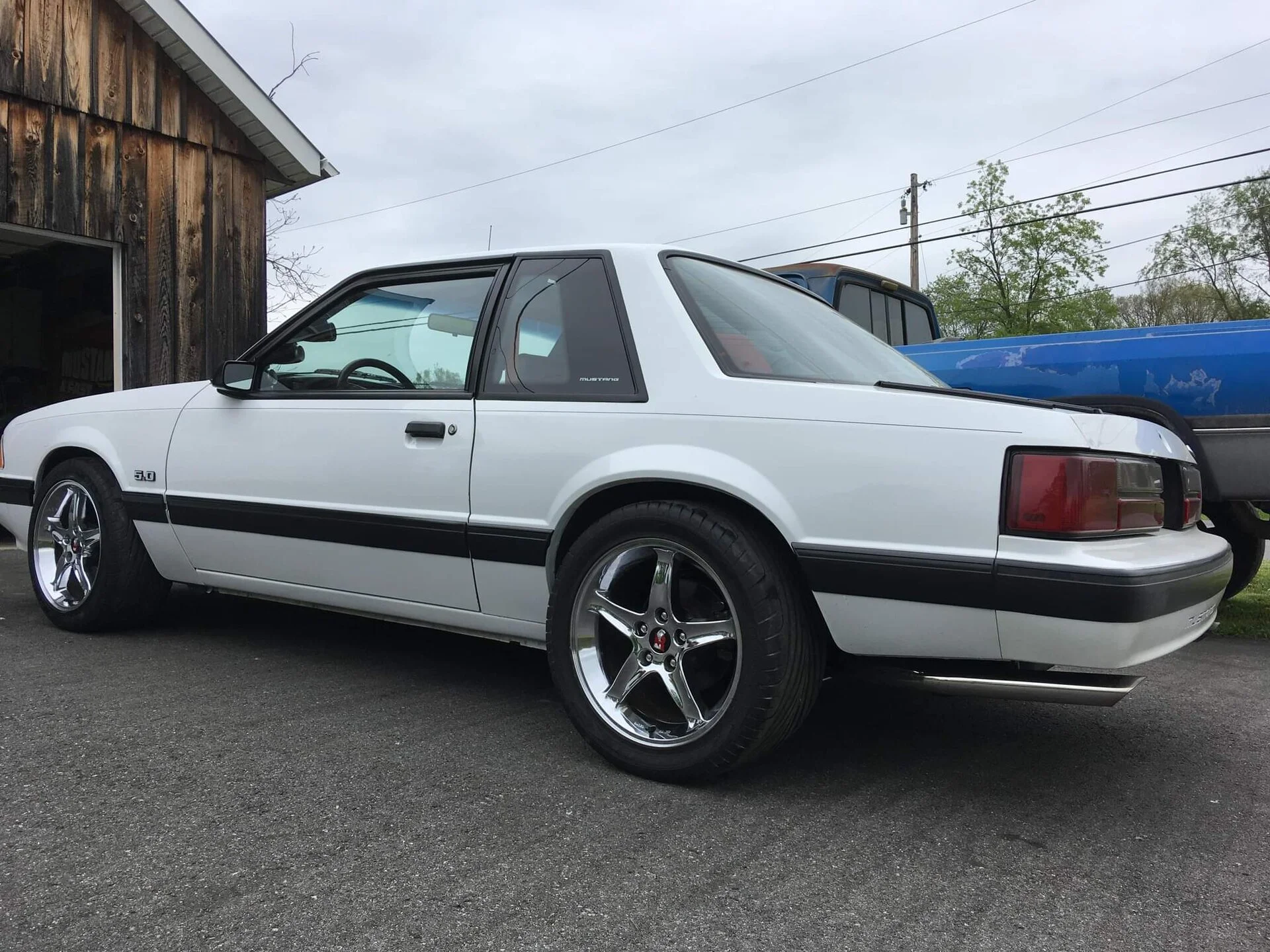

I would consider swapping in the fox axles because your not going to be happy with how far out the wheels sit.

I think you are right. They are in my cart on LMR. Just need to pull the trigger.
Considering I haven't bought the rest of the wheels yet....i have time.
Not sure if this was for all XT005 wheels but a friend ordered up two rear wheels from Cosmis to verify fitment a few months ago. This week he called them up to order the matching fronts to complete the set since fitment was good and he really liked the wheels. They said they are no longer making them. Now he did order the bronze color ones so hopefully it was just those that they stopped making. Eitherway I'd probably give them a call sooner than later to verify
  • Wow
Reactions: Mustang5L5
Sent them an email and this was the result.
We are temporarily discontinuing the XT-005R and redesigning it. What we have on the website is all we have left of the current version. Once we release it again it will be a flow formed wheel that will be stronger and lighter. The estimated time for completion is sometime between July through December of 2022. It should look very similar to the current style. We plan to bring in better offsets to fit more vehicles. Please let us know if we can assist with anything else.
I have two rims now. I guess I wait and see if the new offsets will fit better.

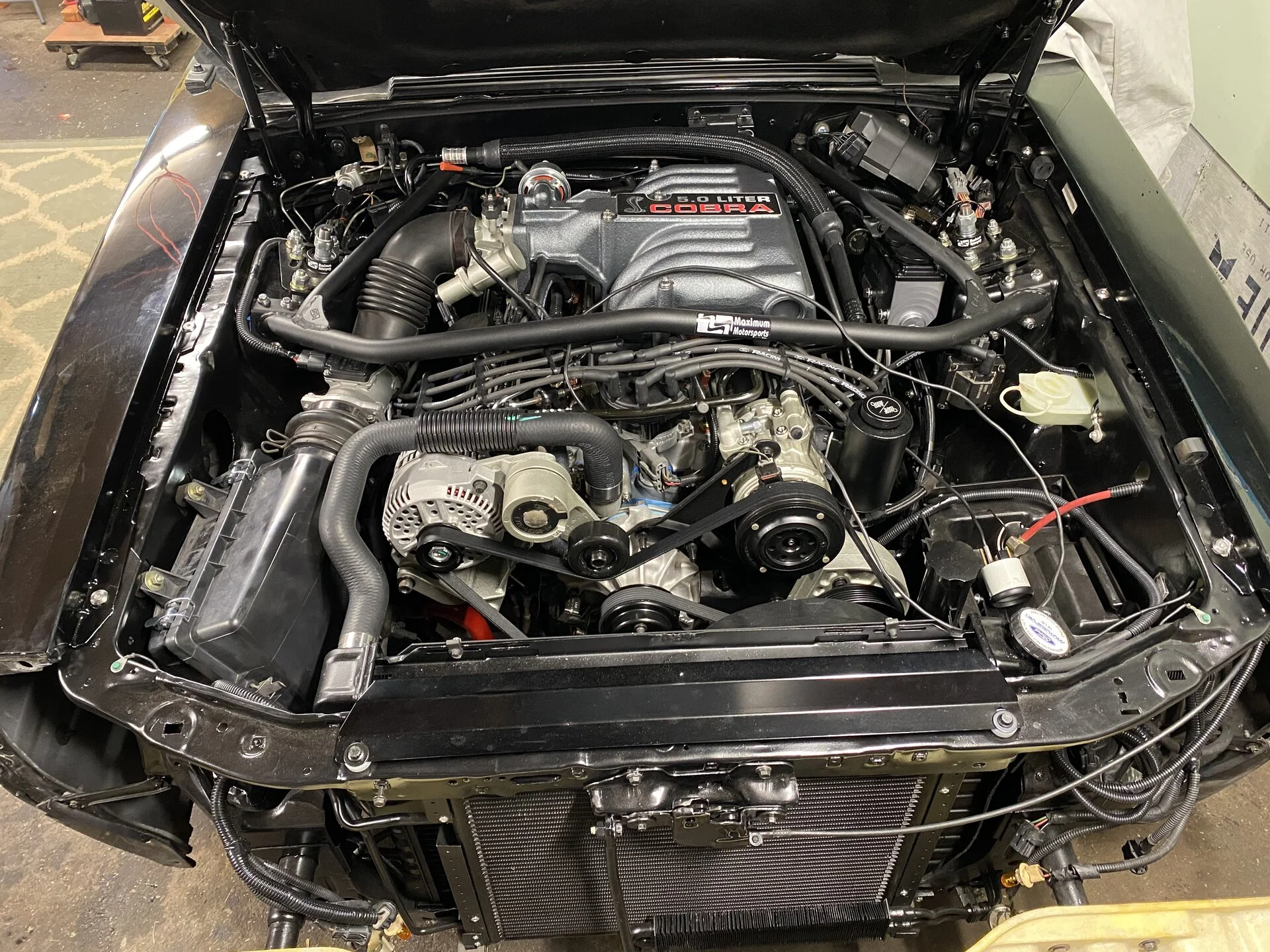

Threw the other fender on. This one lines up really easy. Unfortunately the hood needs to shift pass side about 3/16” or so.
The MRT struts make hood alignment tricky. They push the hood up and out slightly at the hinge. So when you adjust the hood, you need to go lower and towards the cowl. Then put the struts on and see how off you are and tweak.

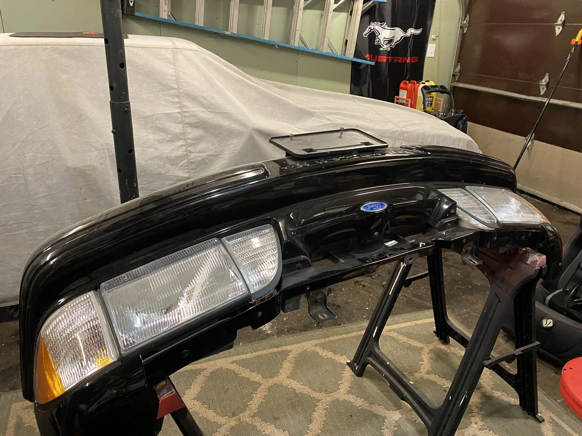

Meanwhile getting the front bumper ready. Everything needs a wash and a buff big time.
First time this things been out of my attic in 2.5 years
Repairing the front bumper. Some of the studs pulled out when I removed it. Epoxying new studs back in.

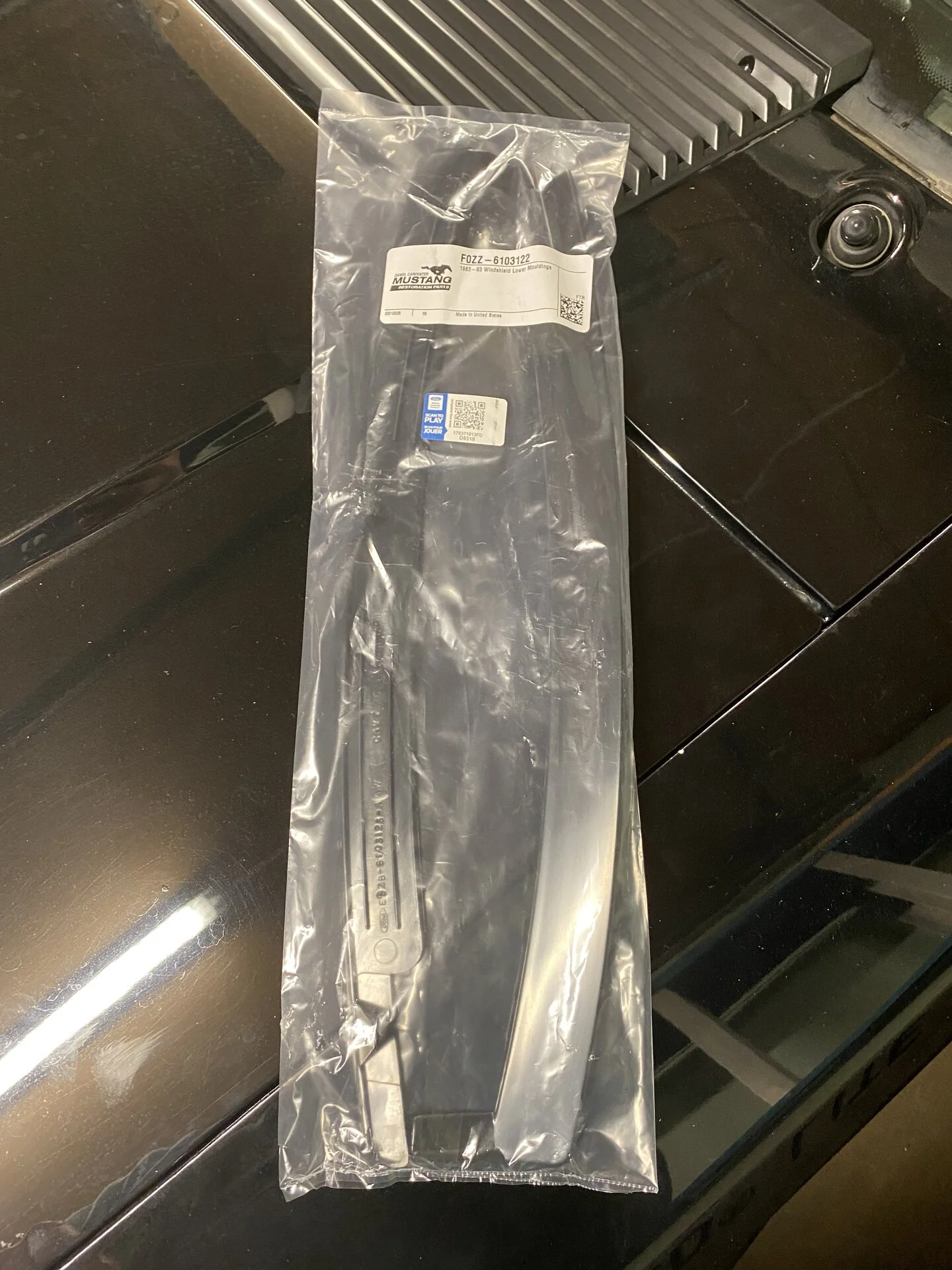

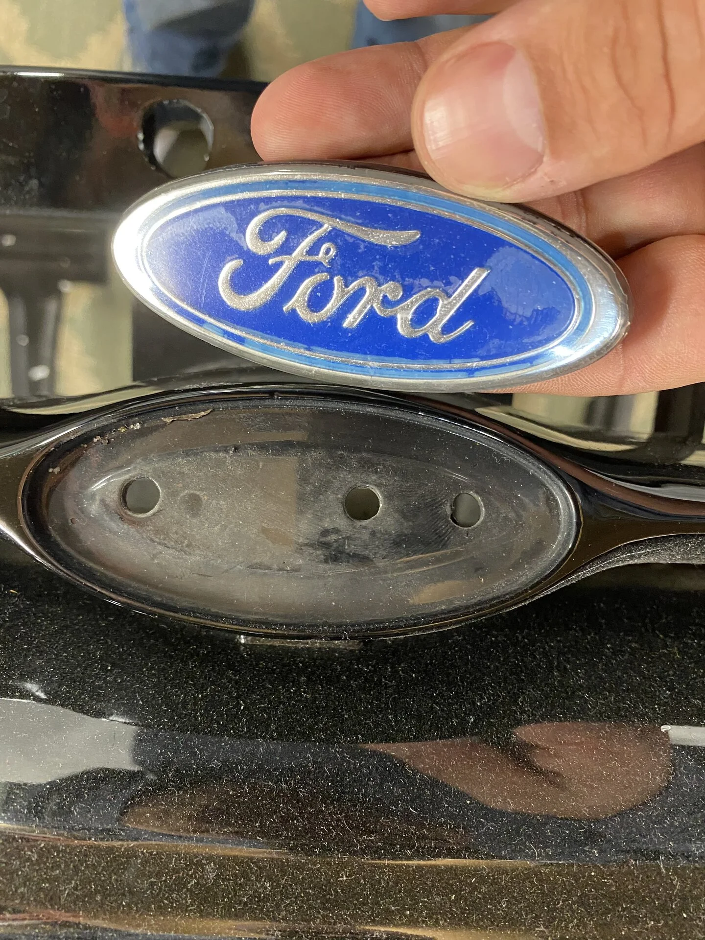

Pulled off the original Ford emblem as now is the time to replace it. This one is starting to fade. Found a NOS unit…
However, really can’t decide if I want to install this. Need to think it over.
