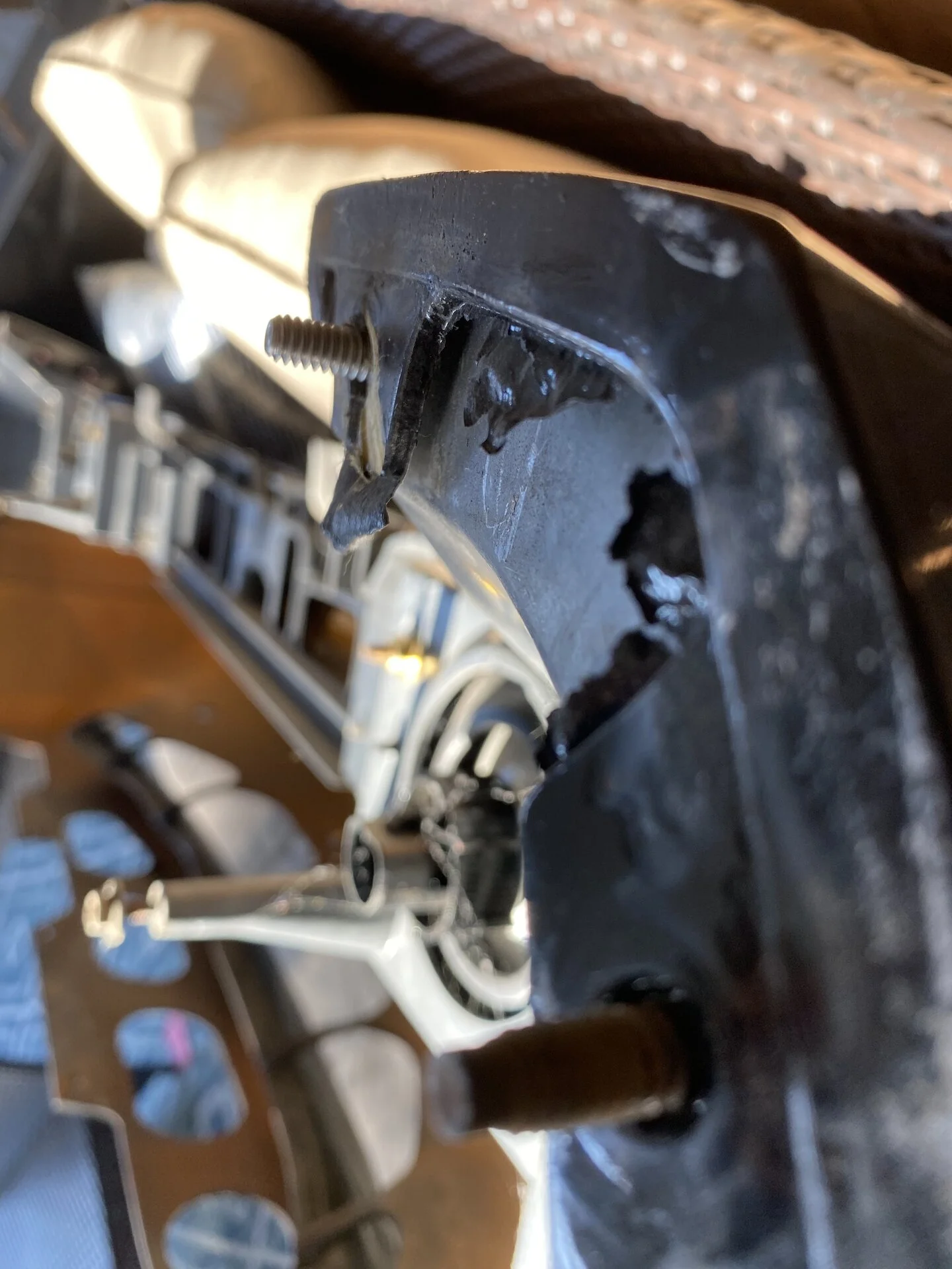

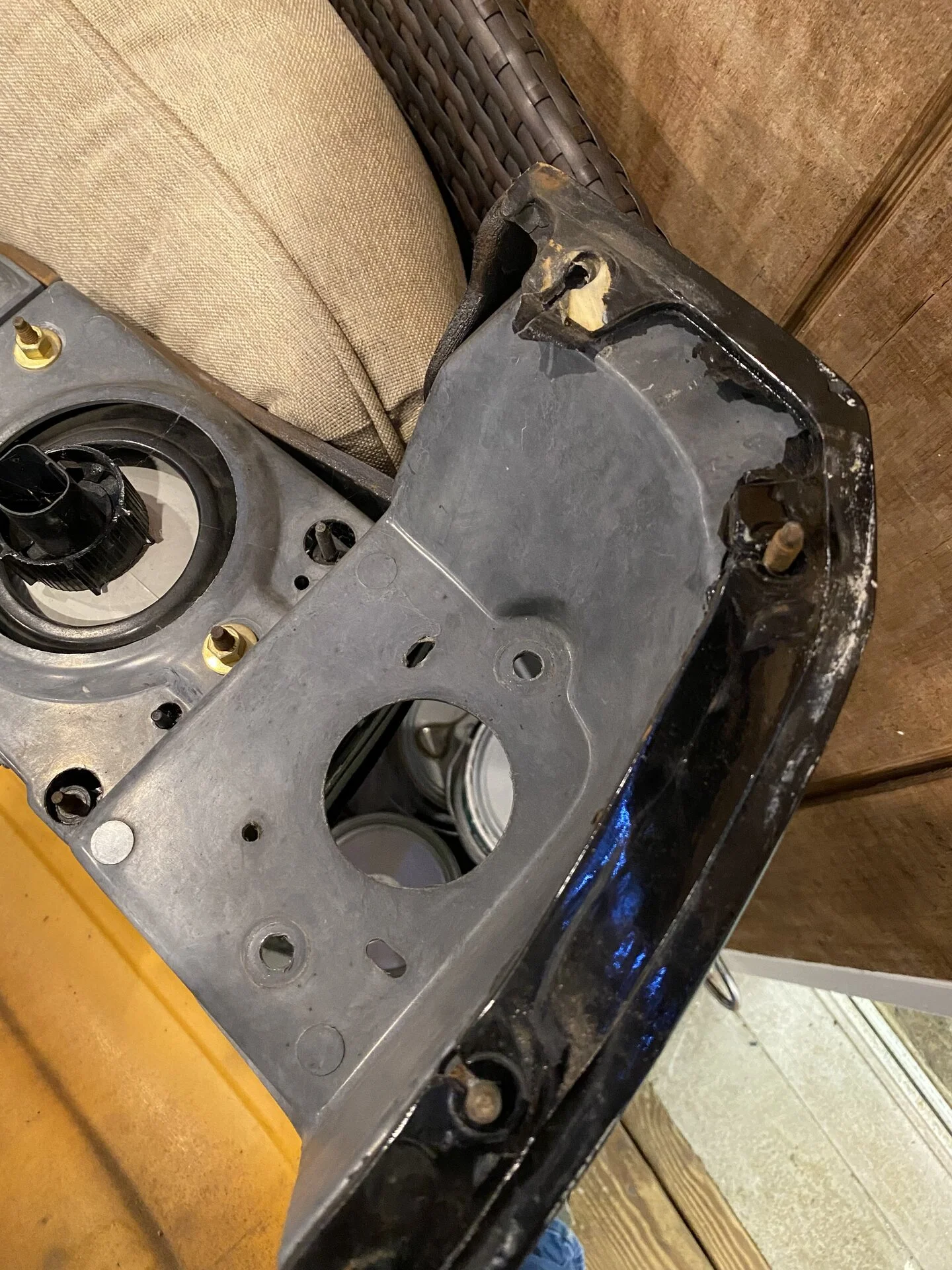

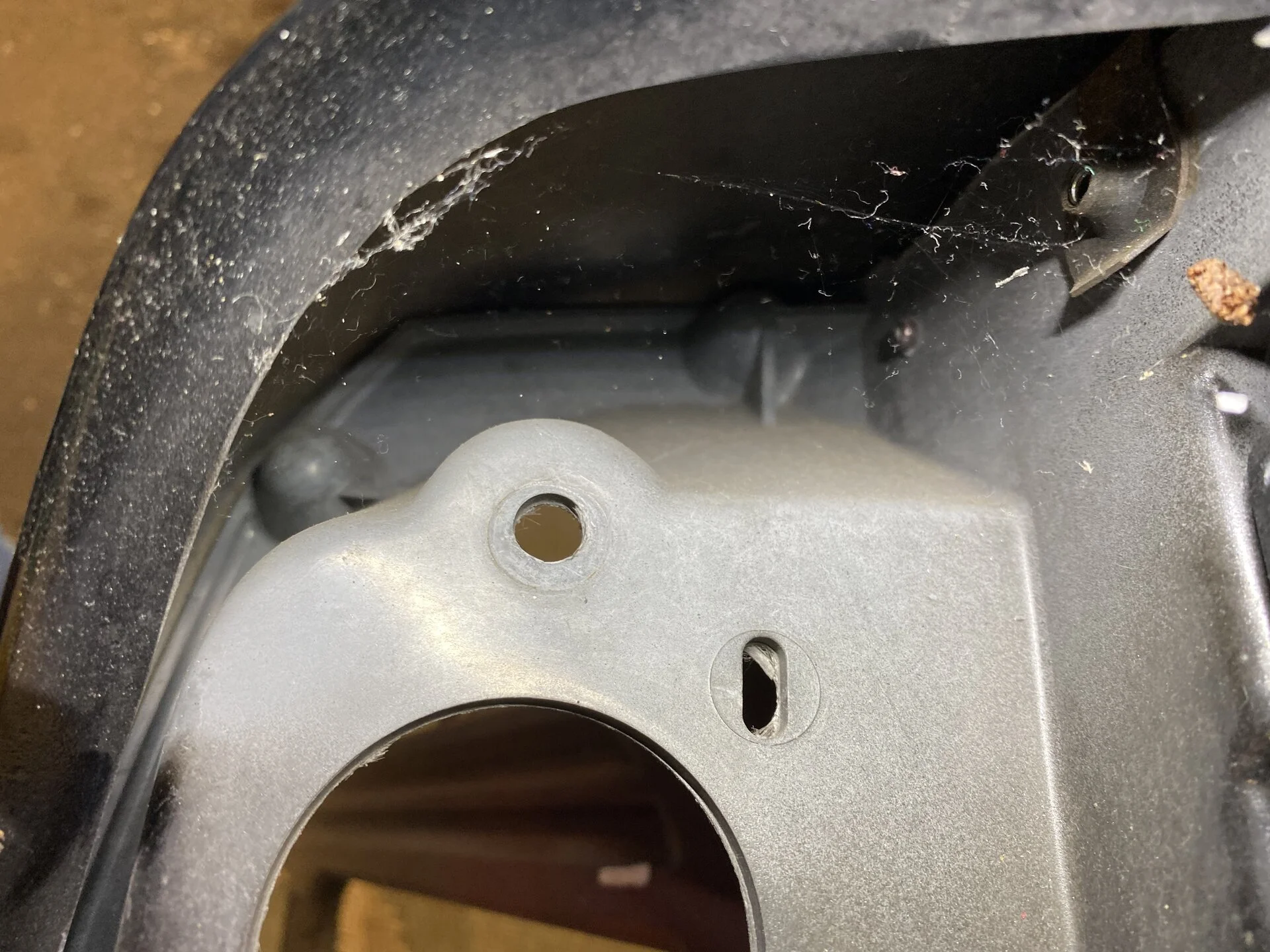

Messing with the front bumper. I have one stud to repair.
That top pass side stud came out of the header and needed to be cut. I have an idea on what to replace it with. Seems like there is access to the front
From the front, I think I can drill it through and run a stud through and put a nut on one side and nut on the other. Should do the trick

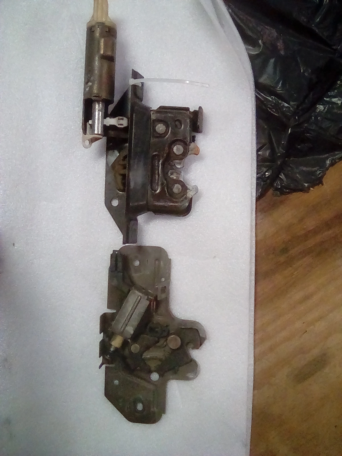

I have a latch mechanism from a vert, don't know what to look for?

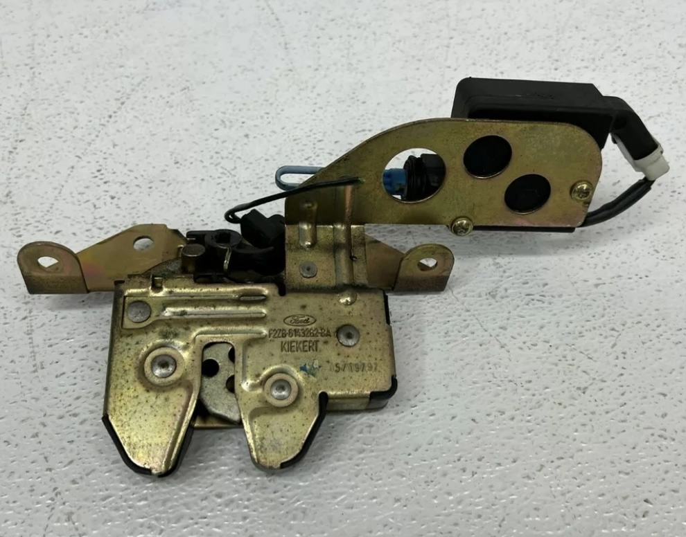

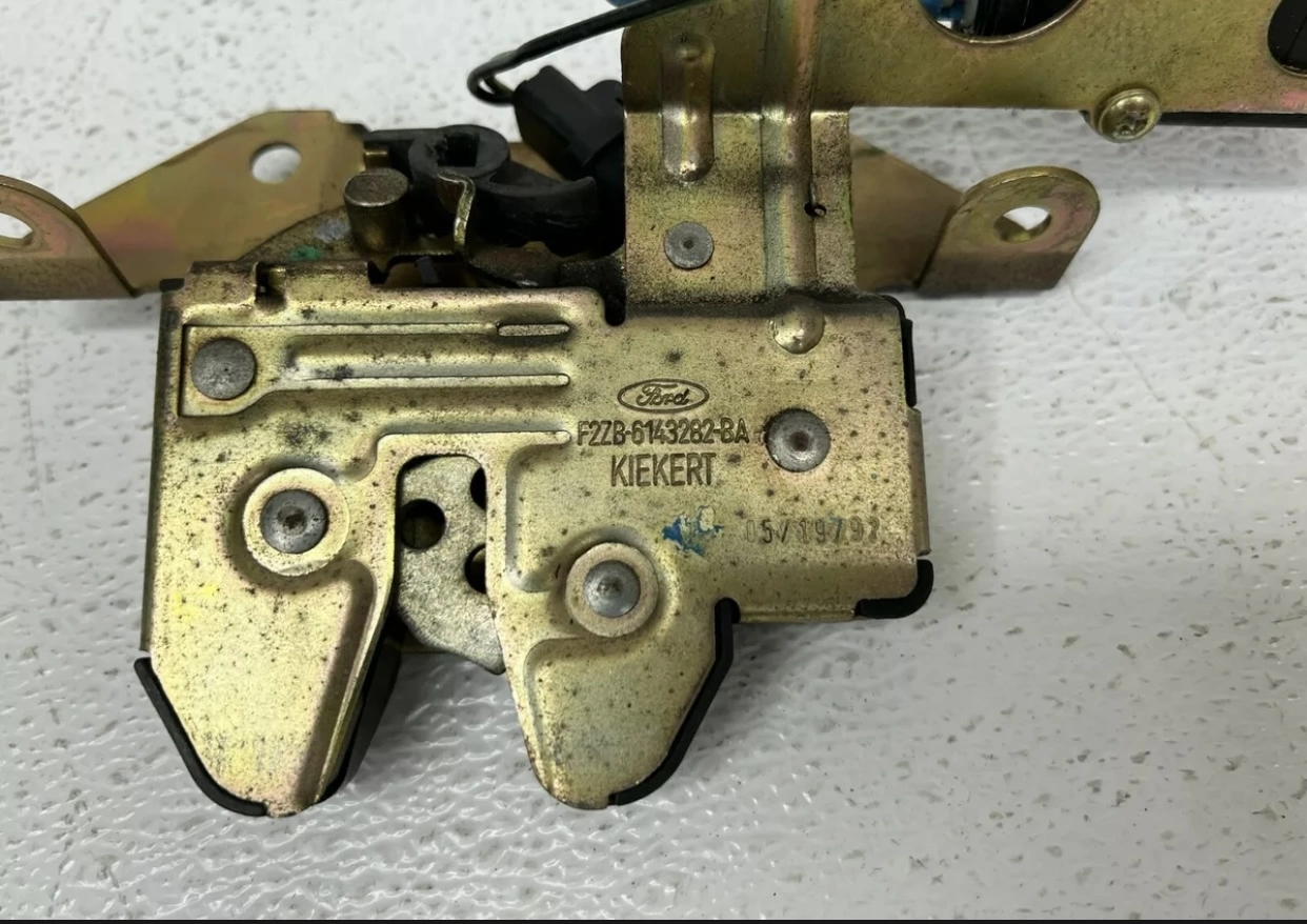

Here’s the magical part and part number. Late 91 to 93 hatch got this
I’m assuming it’s different on coupe/vert, but I don’t know this 100%

Top is a hatch, the bottom one is a convertible, no part numbers,
the vert latch says Lechtern (?) And has a patient pending or number can't tell, its under the plug. I'll keep looking, I know I have another one.
good info to know.

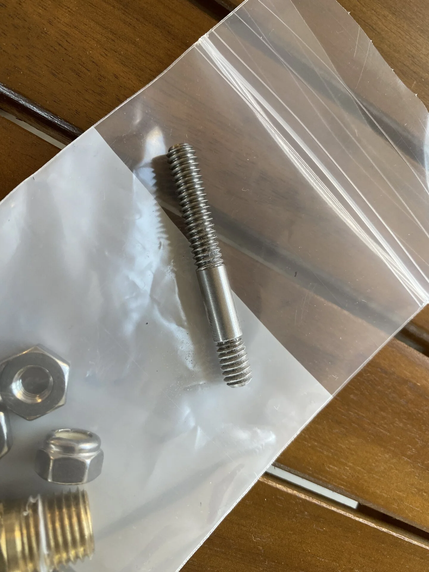

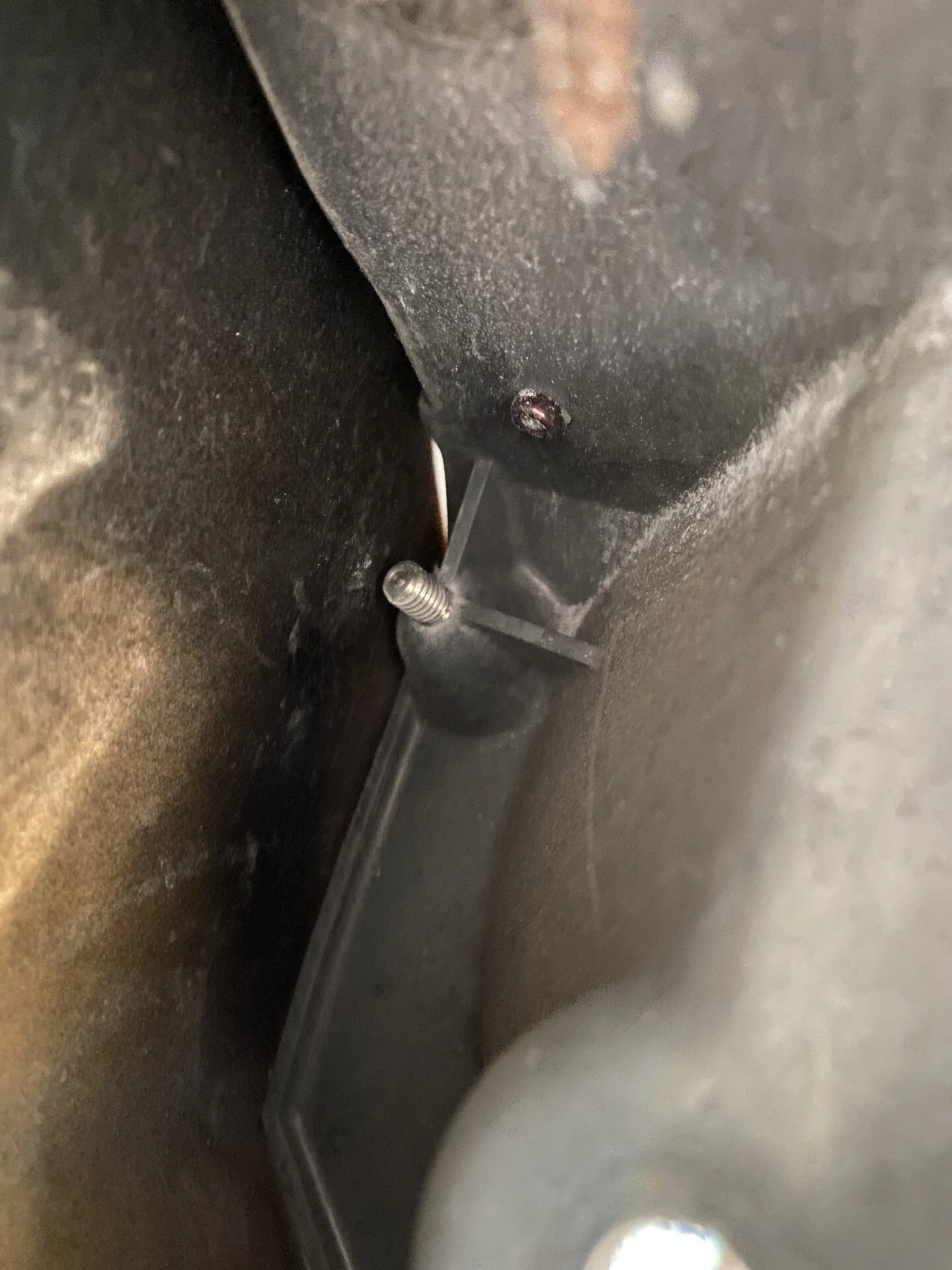

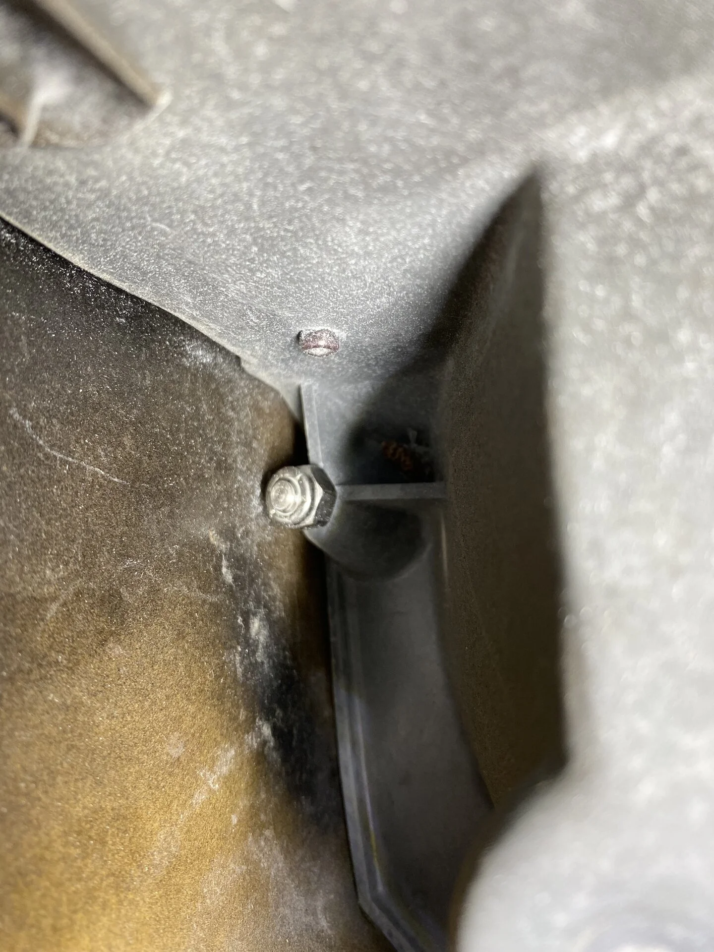

Fixed the busted out header stud. Pretty easy to do.
2” long double ended stud. 1/4-20. Stainless.
Drilled out the busted area with 1/4”
Bit. This sticks in nicely
Double nutted the other side, and bottomed out a nylon locking 1/4” nut
And finished product. Downside is you need to leave the parking light out because you will need to hold the nut from the other side. All 6 can be done this way, if needed. I only had to fix one.

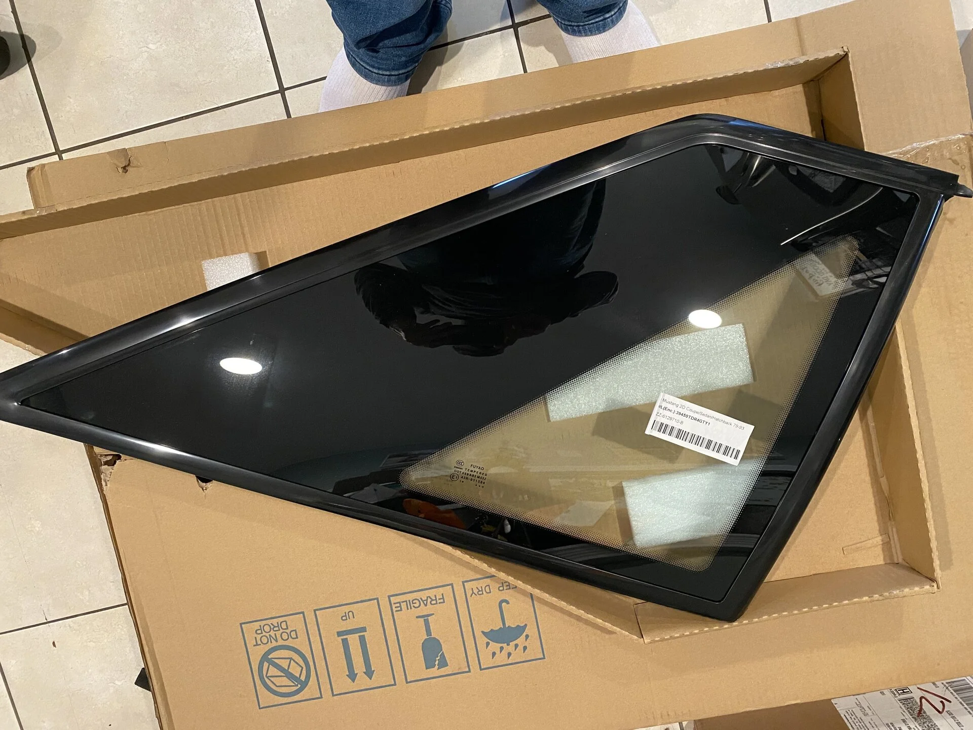

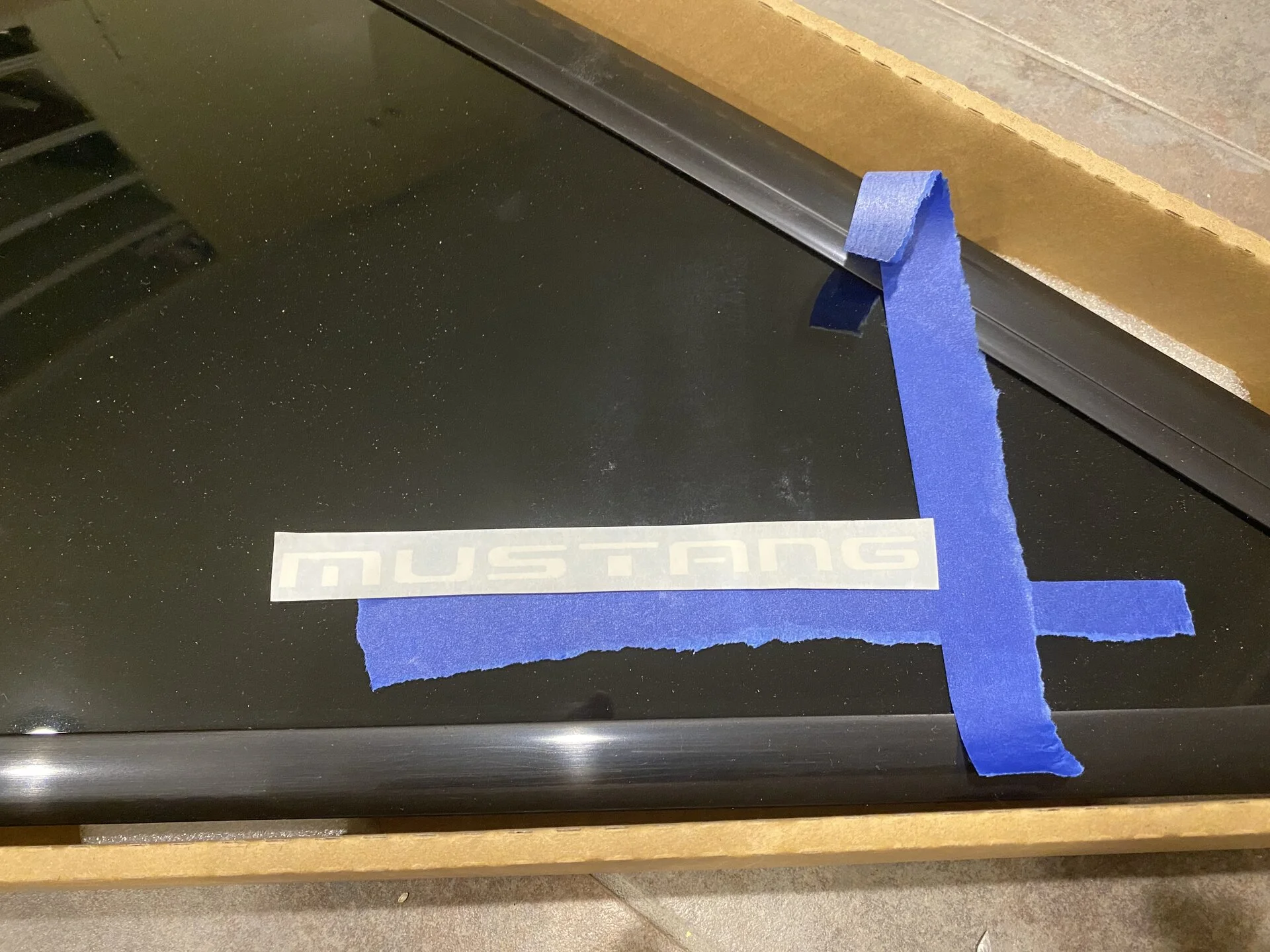

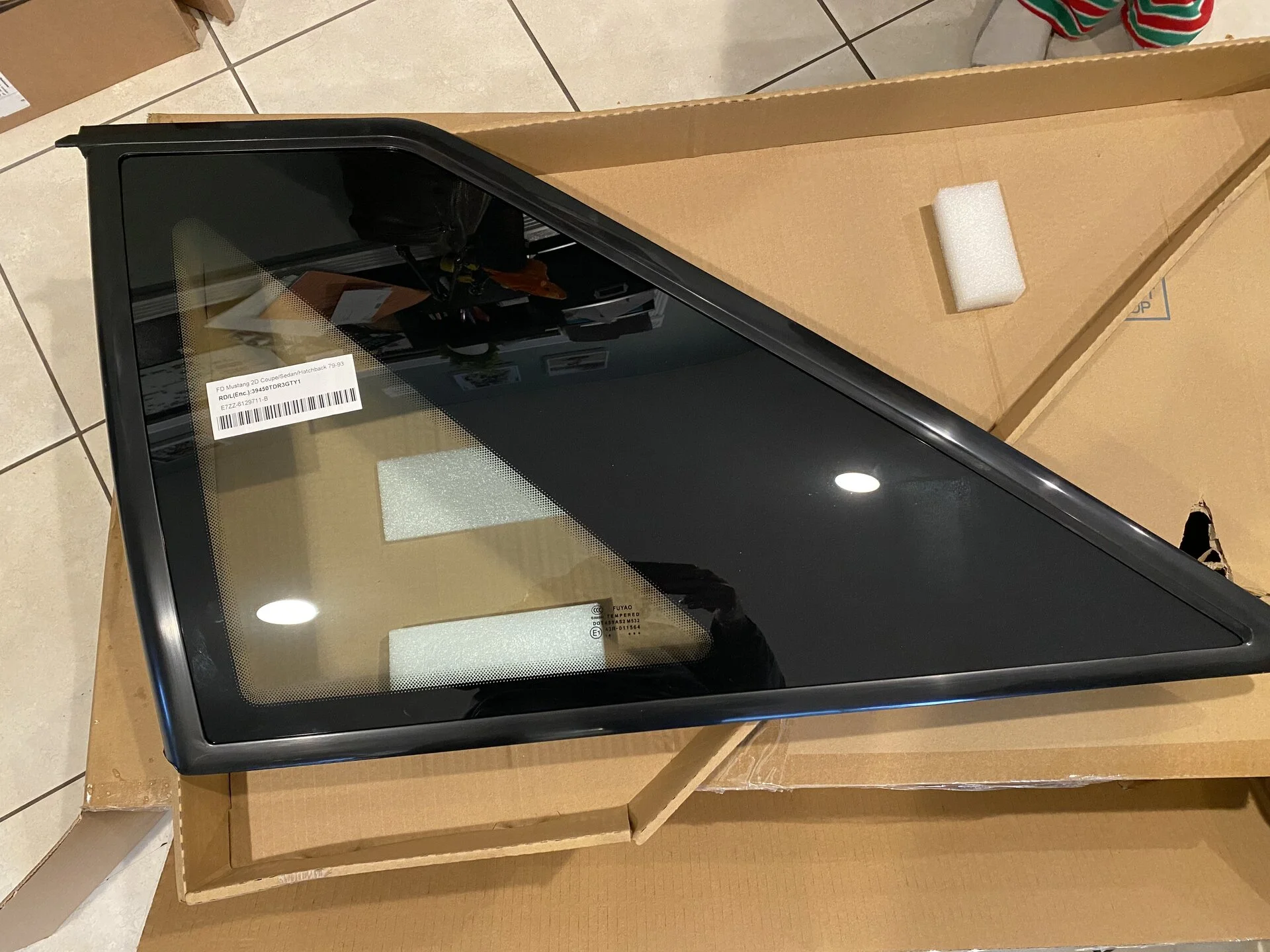

Got sick of looking at my dried out quarter windows.
I bought the scott drake repops sans the logo. I’ll be installing the decal.
Overall impression….they are nice. Hopefully they fit tight

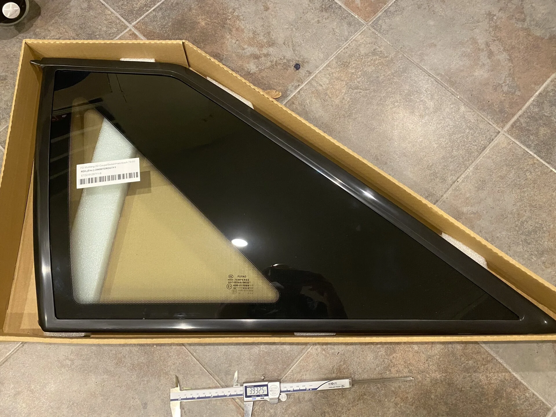

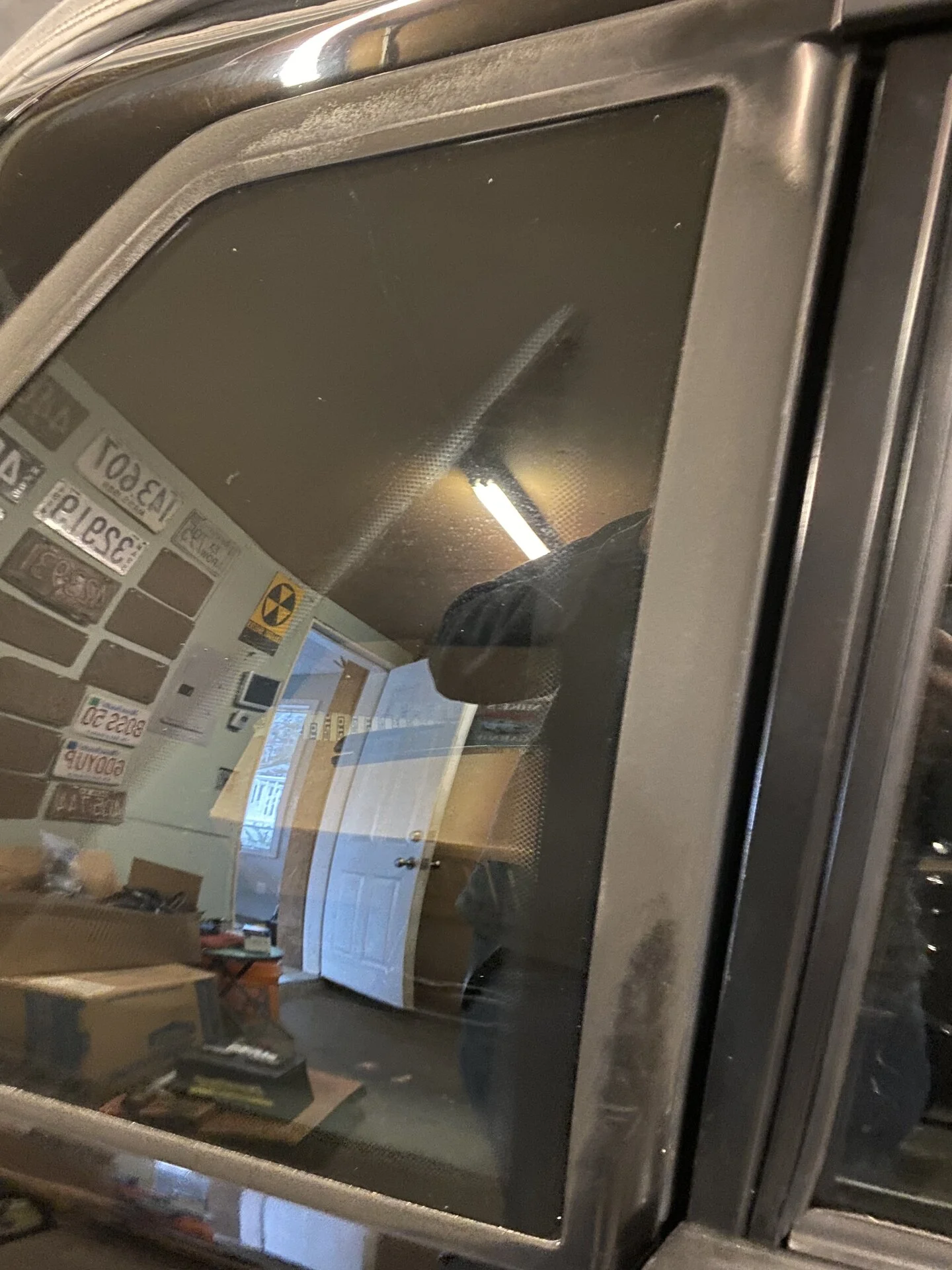

Original window for conparison
Oh yah....That's going to be like new.

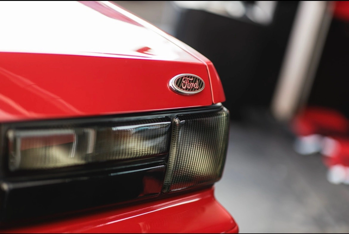

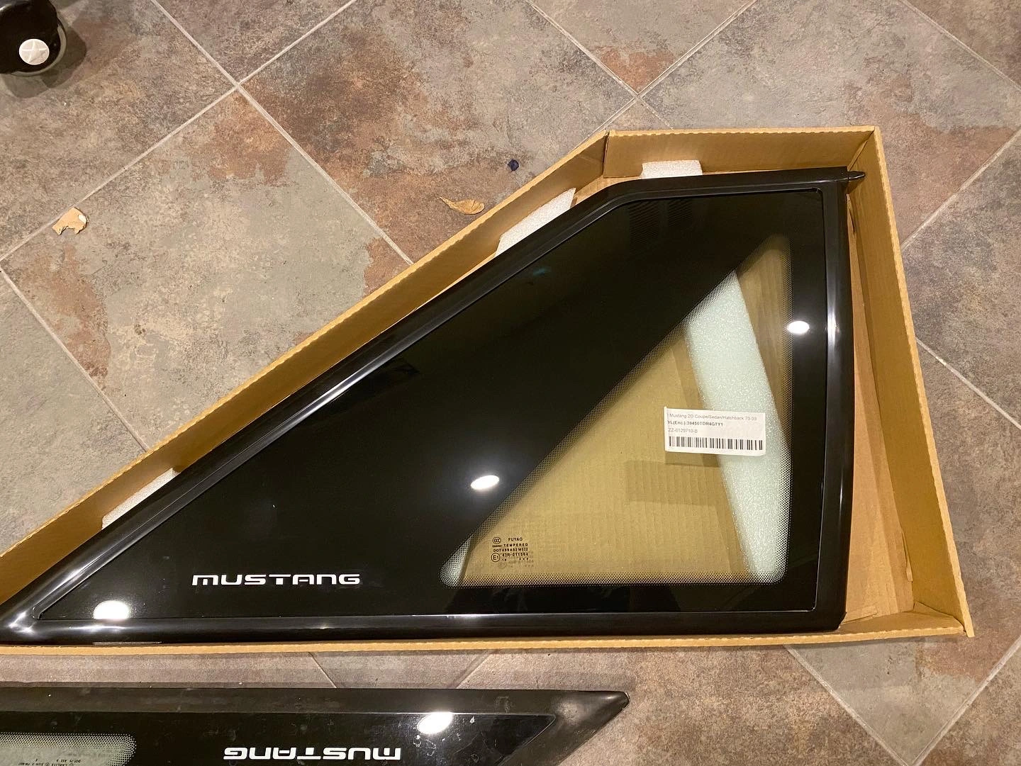

Couldn’t wait. Had to toss the decals on. From a couple feet away, you can’t tell at all.

You have a nice rear end there Dave.

Looks factory.
Look really good! Where did you get the decals from?
