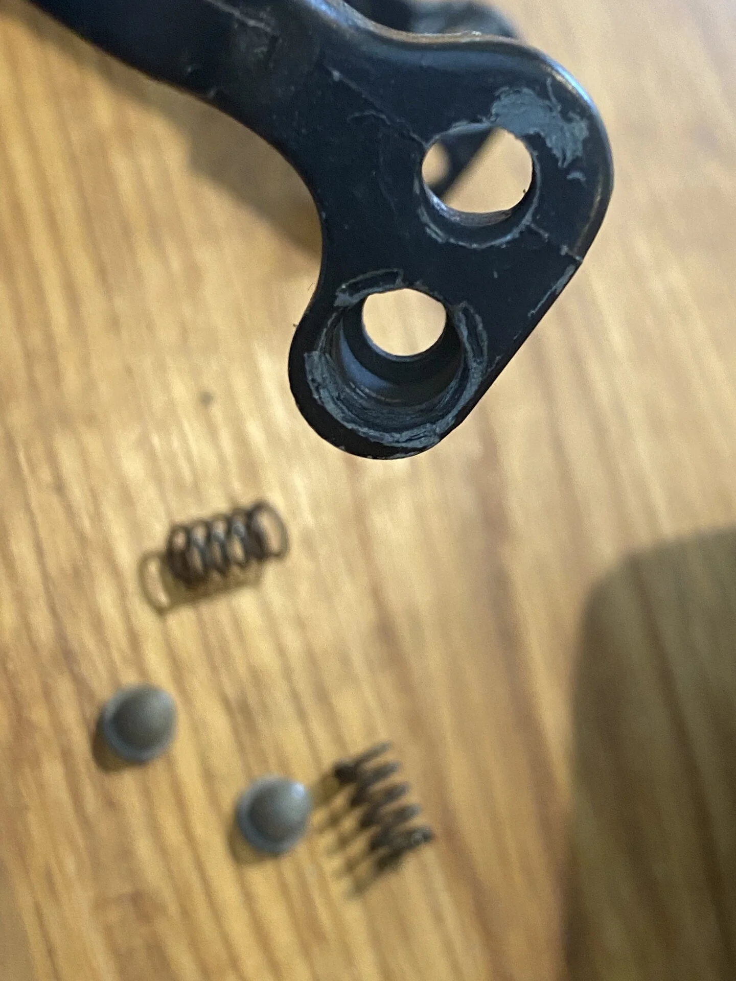

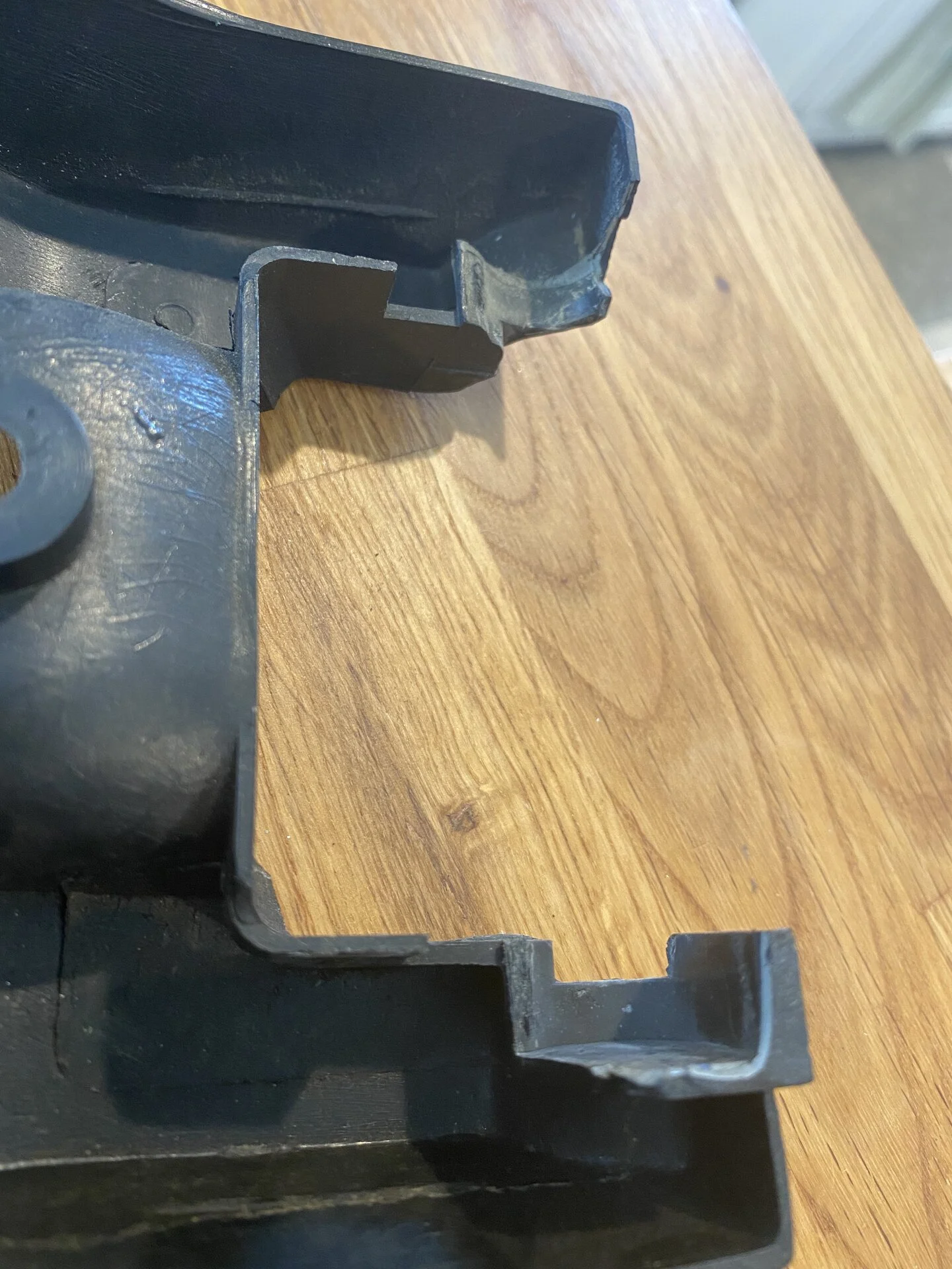

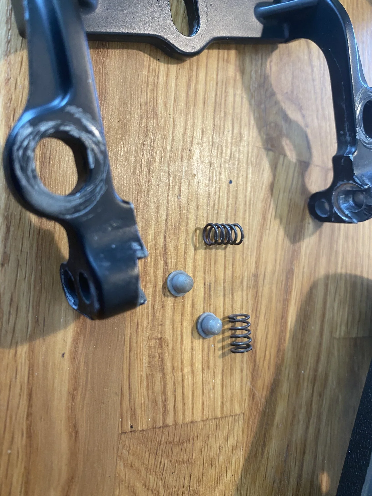

Decided to take a closer look at my sunroof. This has been one my my favorite features Of the car and has been constantly used almost every time I drove the car.
Found the latch to be…..worn.
Trim bezel busted
The detents are falling out. Apparently the retainer is long gone. I actually lost one of the detents years ago. I found it under the carpet in the backseat amazingly just last week.
Hopped on eBay and scored a nice oem latch and bezel for $30. That problem solved.
The latch handle itself is rather tight and binding. Fortunately I have a spare

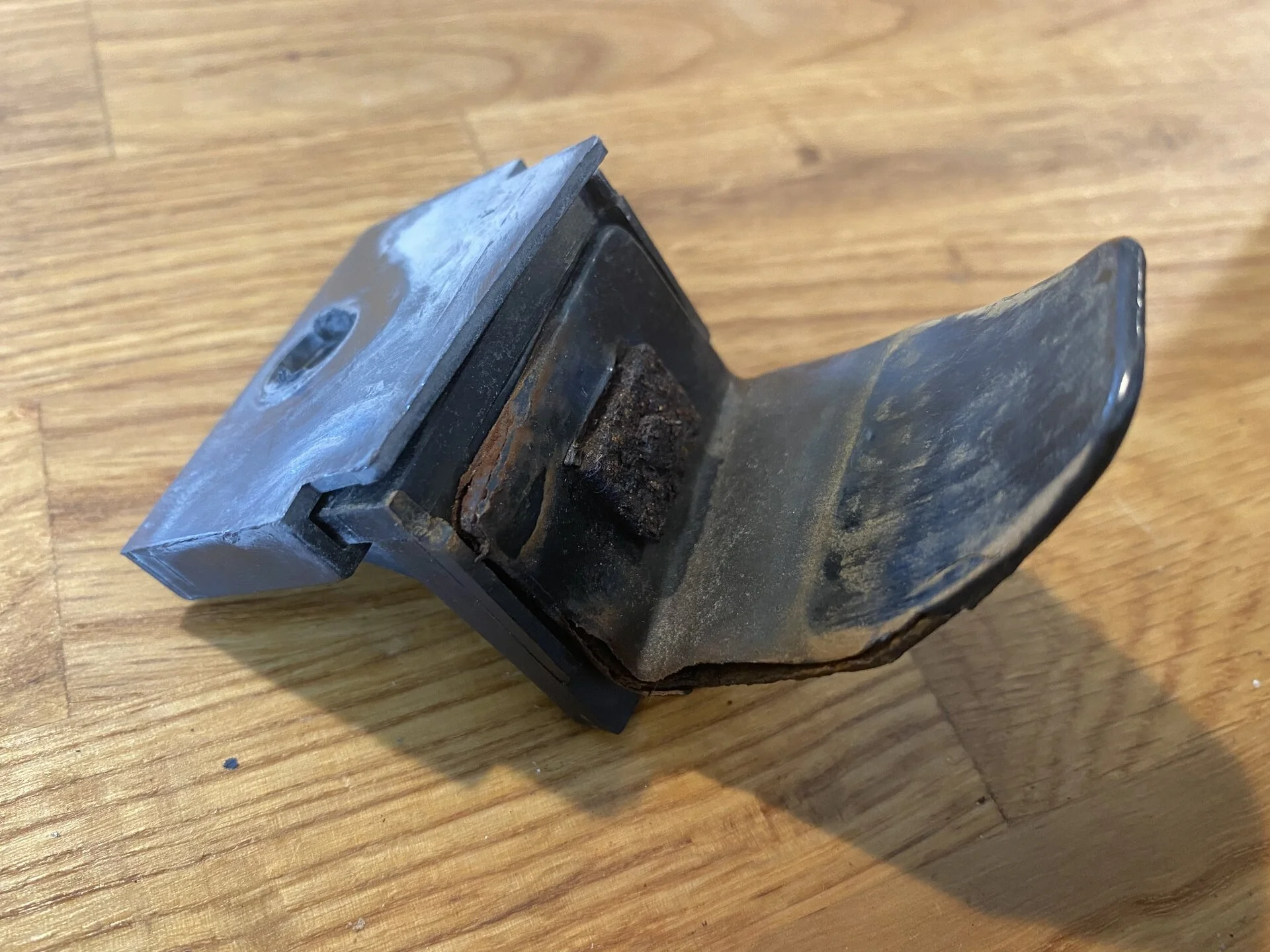

Wanted to replace the two pivots as the coating on mine is coming off. Unfortunately these things are just seized and not moving.
I managed to get one side off. As you can see that bolt is corroded. Those plastic brackets are unobtainuum, so not sure how aggressive I want to get here.
I might just have to freshen this up in place rather than strip them down, or buy the repops. Hmm

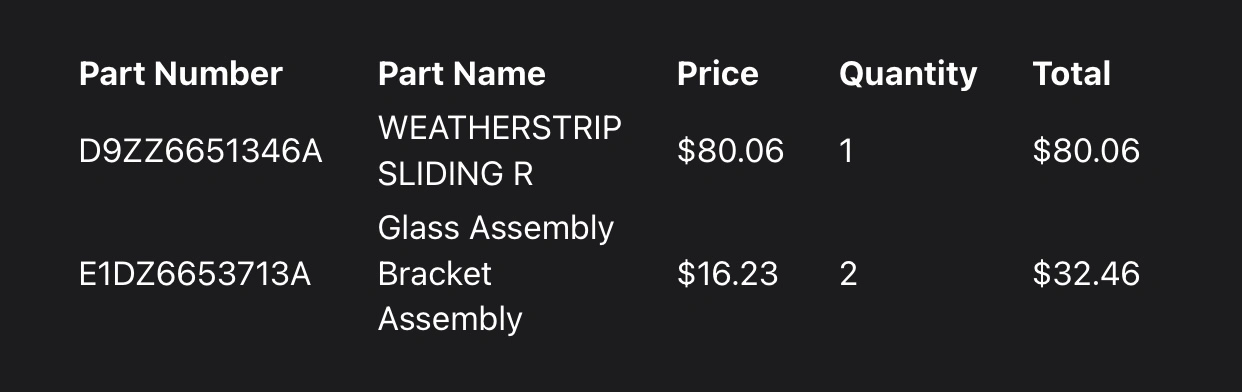

I did end up ordering two of those brackets and the oem roof seal. (The $80 one)
I’ll wait a bit on ordering the seal around the glass. I do agree the repop ones are very thin.

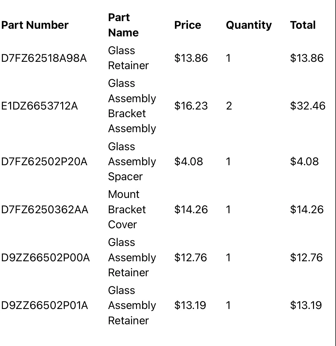

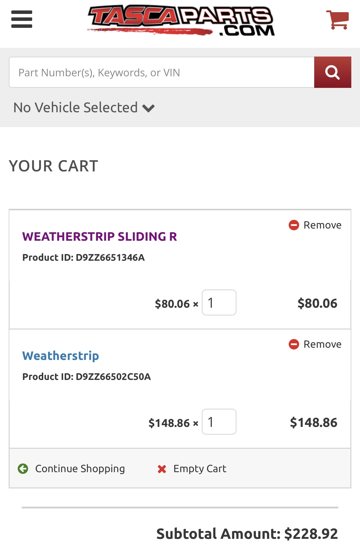

Ok. I may have gone a bit overboard…
Aparrentky Tasca ford listed ALL the sunroof hardware available. Most of it was decently priced so I bought it all.
I did not buy the glass mounted weatherstrip yet. I want to see what shows up forst.
I mistakenly ordered two of the right “Pivot” assemblies without realizing they were side specific. So I ordered 2 lefts thinking I can pair them up and offload them later. Easier to sell as a pair.
Let’s see what actually shows up. I wouldn’t be surprised if they email me back telling me this is all discontinued. Let’s see.

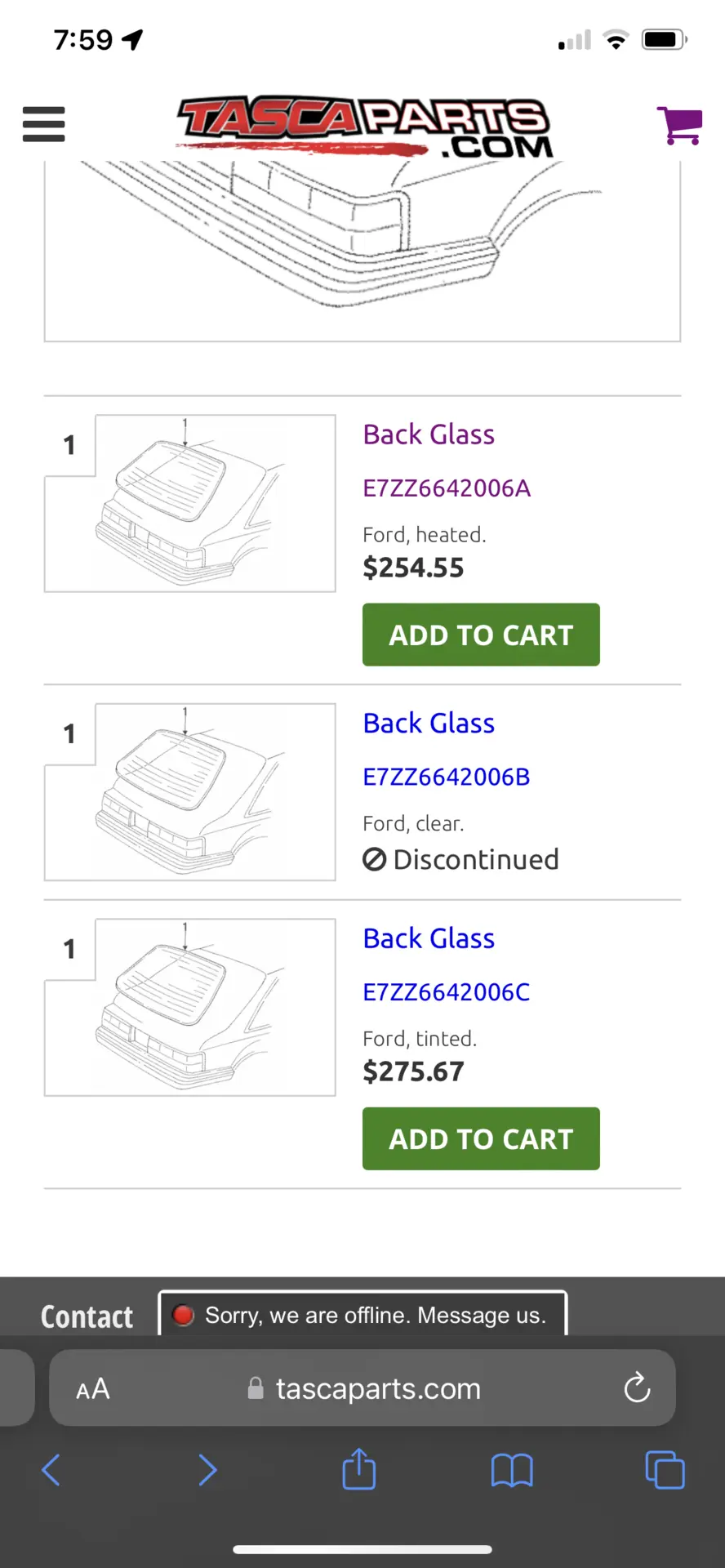

There’s no way this is still available.? I see NOS glass on eBay for $1k+
I need to wait. My rear gas defrost lines are all jacked up and I want new glass. Hmm….

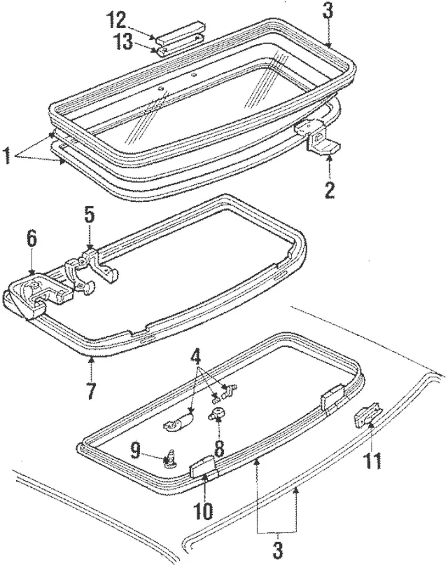

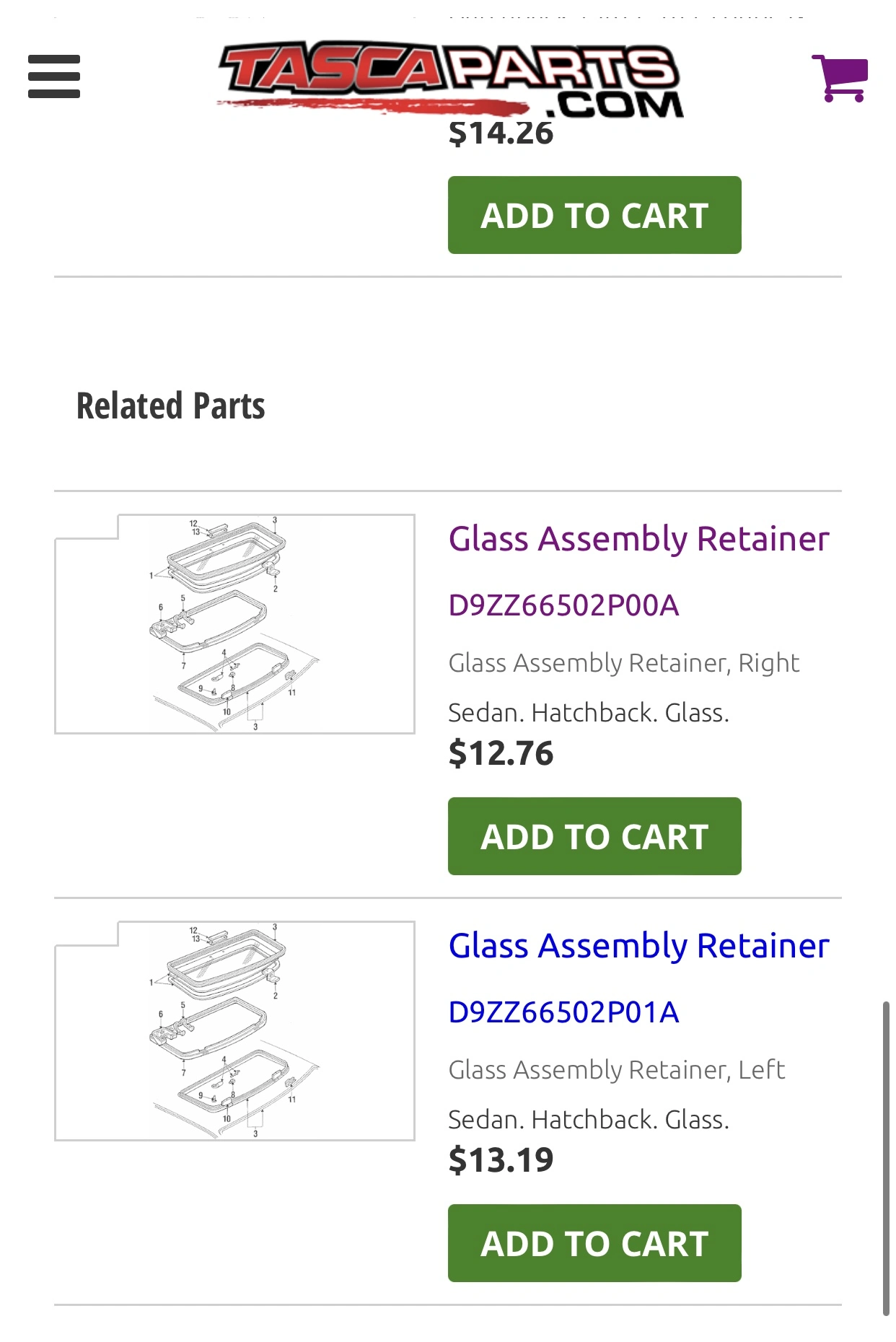

What about the yellow pieces that screw to the roof?
is that the glass retainer assembly?
Mustang5L5
Mod Dude
Feb 18, 2001
43,293
17,997
224
Massachusetts
Apr 9, 2022
#1,492
  • Apr 9, 2022
  • #1,492

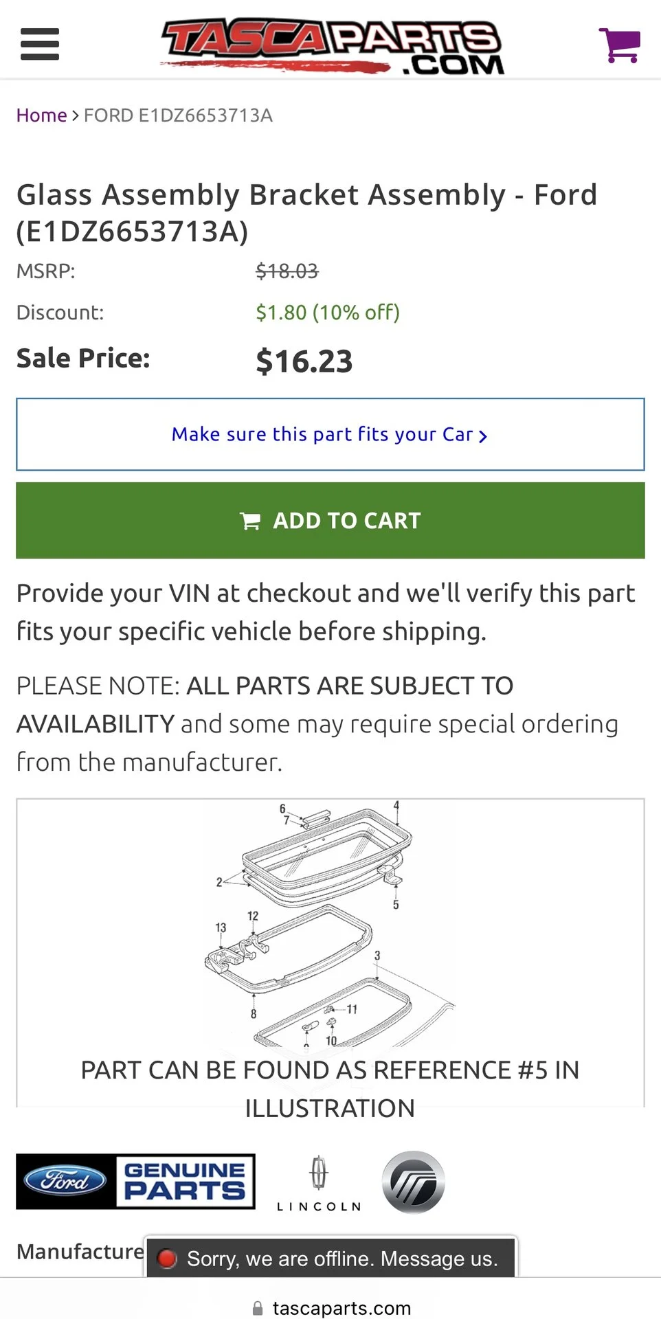

That’s these. I ordered one each
#11 in the pic and the other side
I ordered:
#2 (and opposite side x2)
#12, 13, 6, 11 (and opposite side) and the body seal (not shown)
I got #5 used on eBay. They had it but wanted $80 for it.

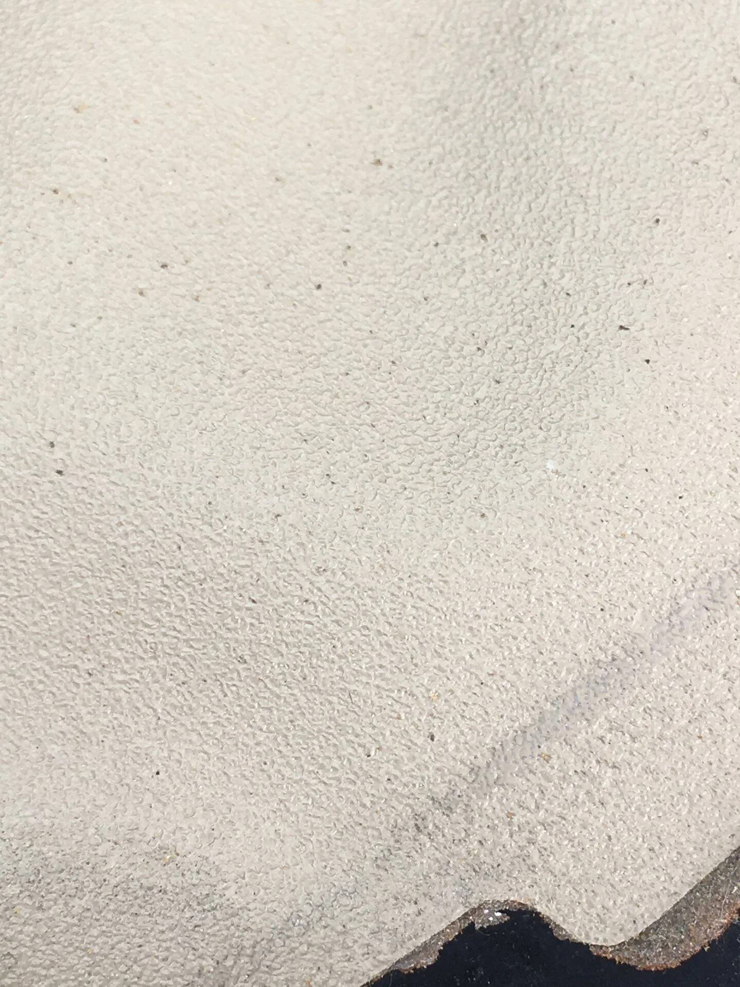

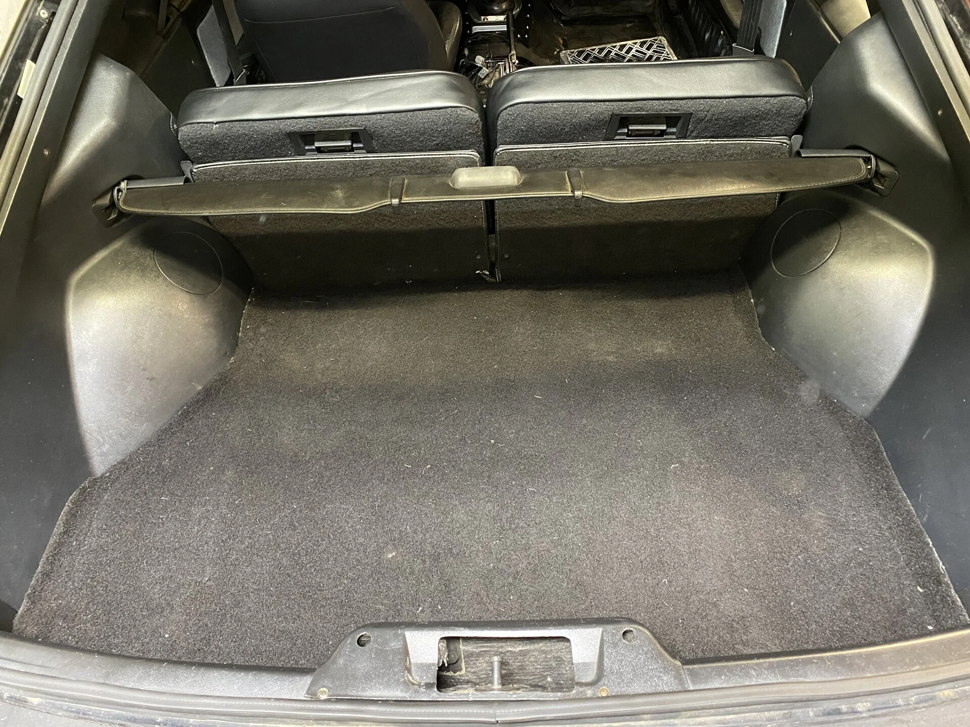

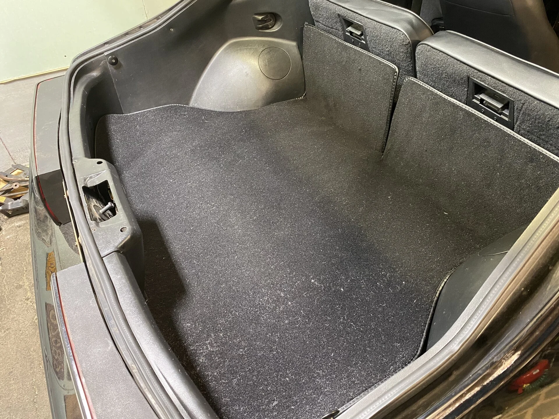

Got my hatch carpet.
This is the mass back Essex style material. LMR doesn’t offer this variety.
OE carpet on the top
Mustang5L5
Mod Dude
Feb 18, 2001
43,293
17,997
224
Massachusetts
Apr 10, 2022
#1,495
  • Apr 10, 2022
  • #1,495

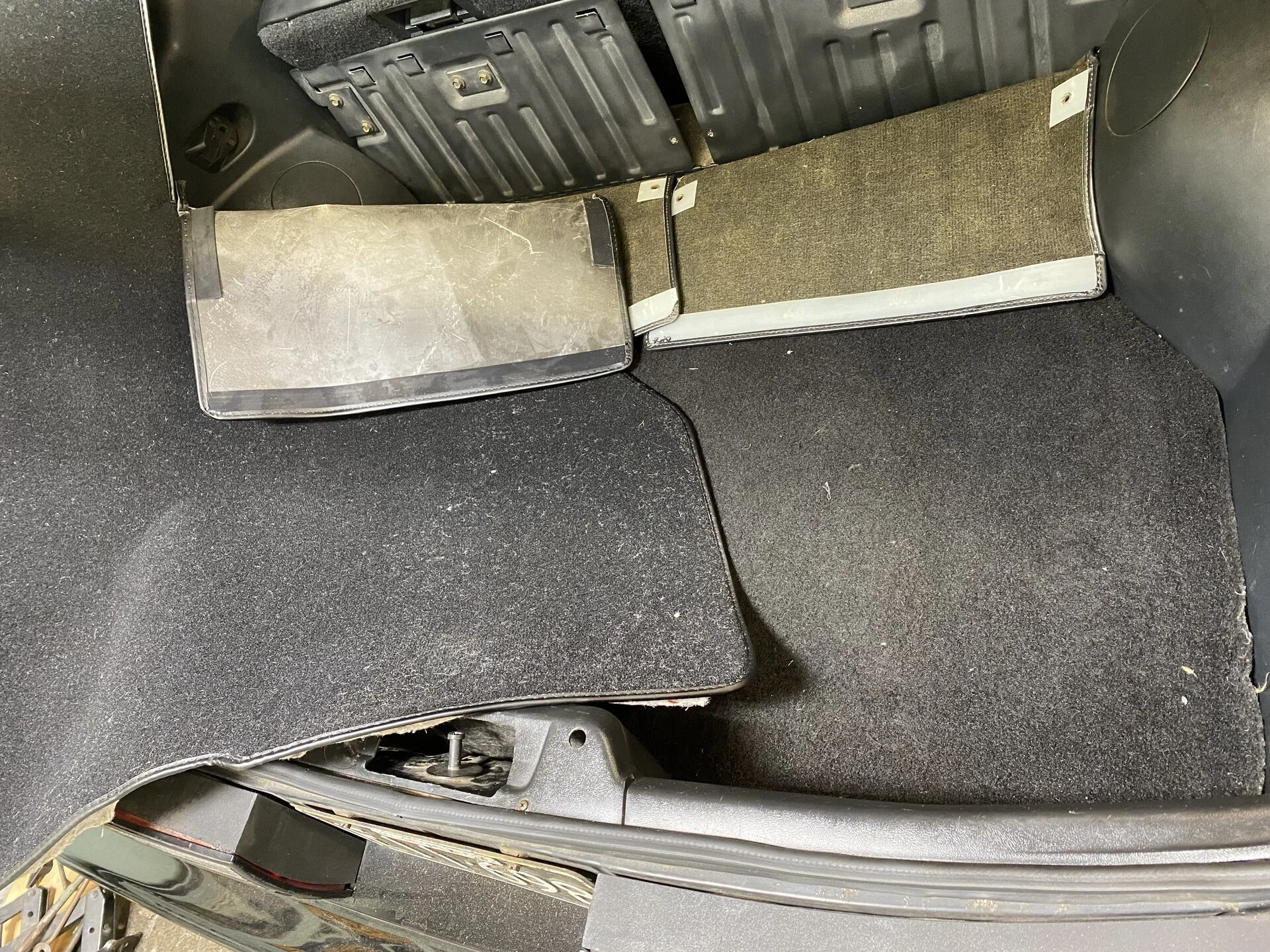

OE carpet on the right. The new carpet is darker
This carpet is heavier due to additional padding.
However it fits like crap. Lots of extra material around the edges. The worst is where the seatbavks fold down. The extra material bunches up in the quarter plastics and generally doesn’t fit well.
I’ll keep working it a bit, but I think this needs to go back. I’m not happy at all with how this fits.

Hard to capture how oversized it is, but I feel like 2” needs to be chopped off from the edges. It bunches up a lot where the seats fold. You can see in the drivers side rear it’s essentially riding up the rear panel area.
I threw it back in the box. Not happy enough with it for $150
OEM carpet back in. I’ll take my $150 and invest in a Bissell carpet cleaner for this and the main carpet. Definitely won’t be replacing that one now.
