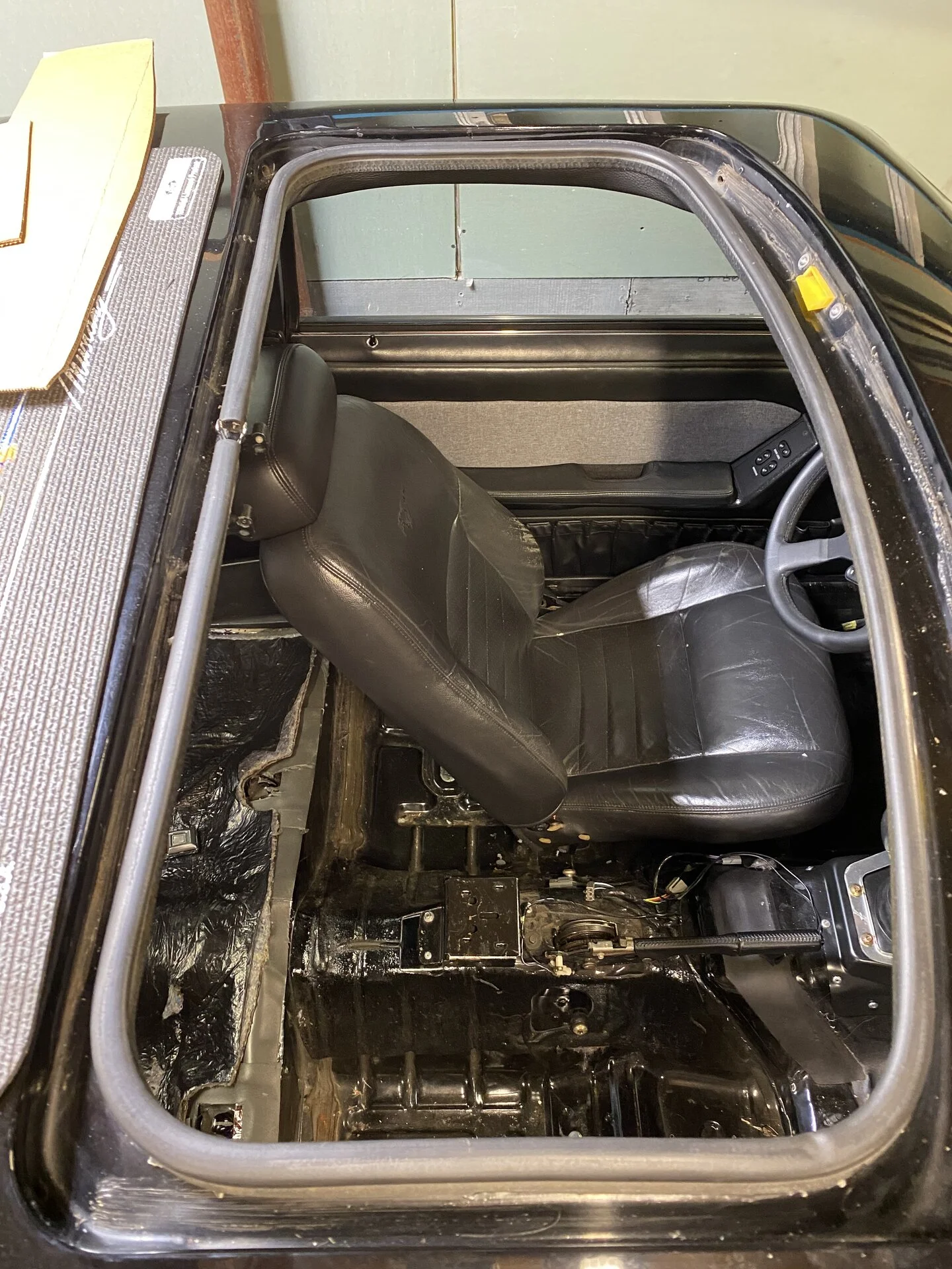

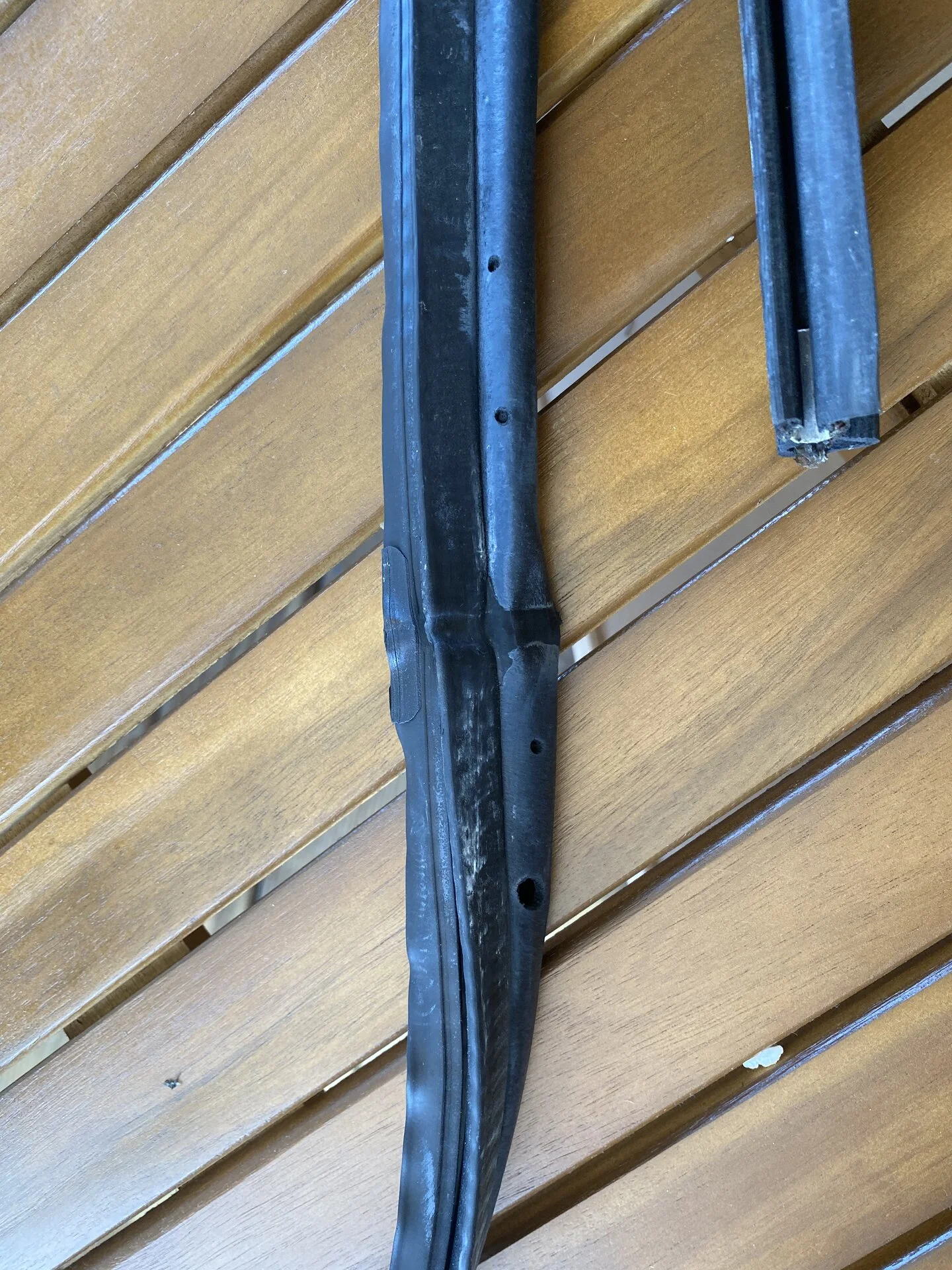

Sunroof body seal arrived. I thought it would be a Daniel carpenter part, but turns out it’s from “Fairchild industries” which is your standard parts store seal. We will give it a shot
Got some funky stuff going on where it’s vulcanized together

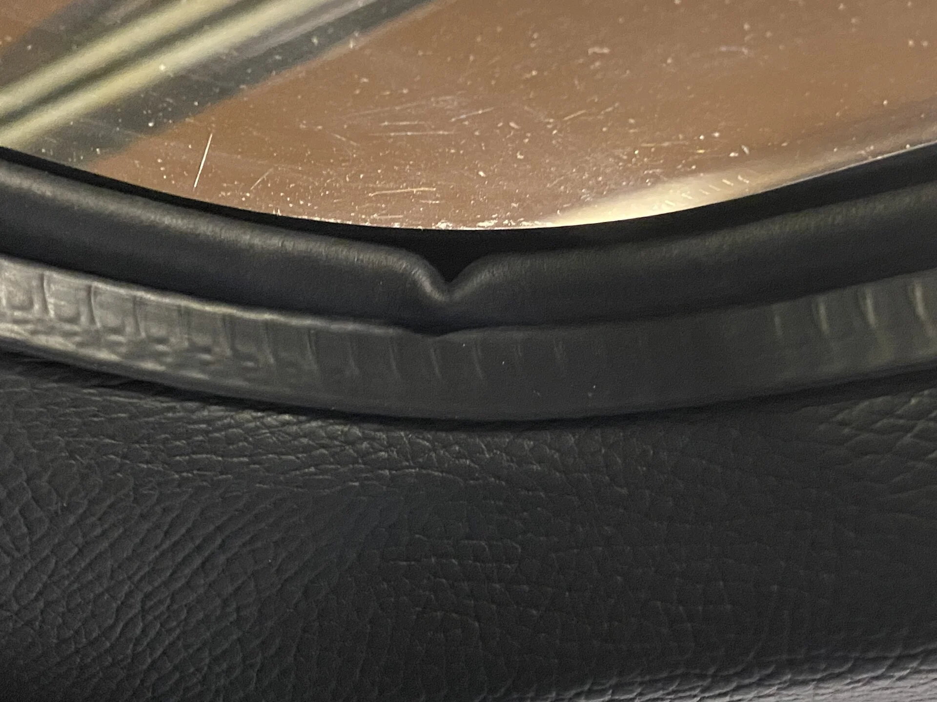

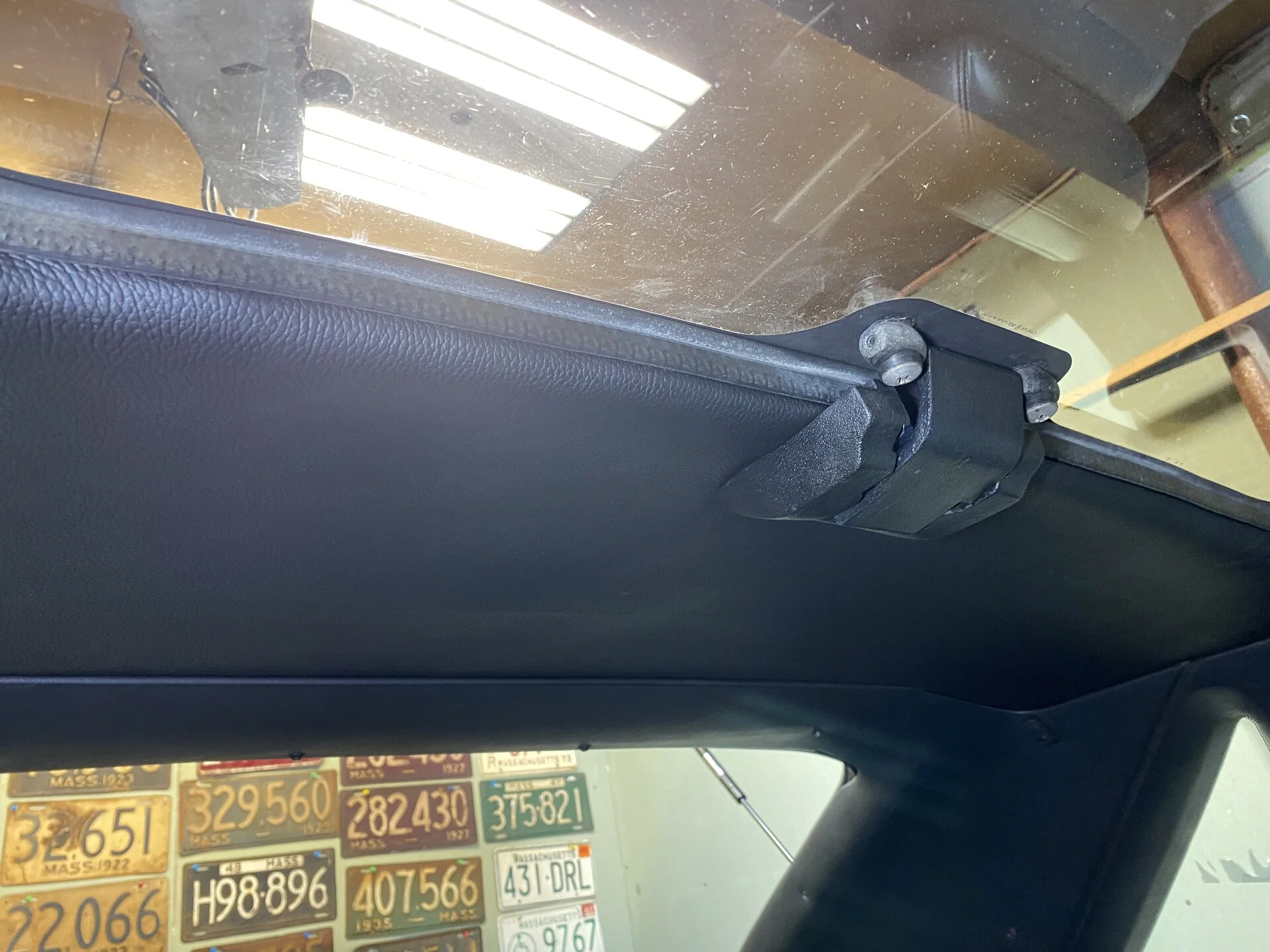

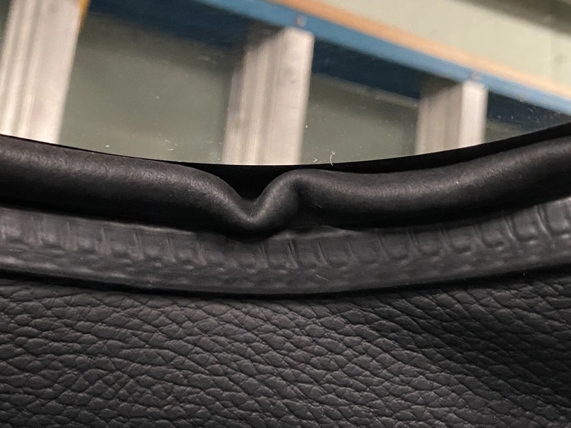

Done with the old seal. Was just easier to use the one already in the correct shape vs wrestling with the new one while glueing down the headliner to the body pinch weld
I’ll give it 24 hours to dry and then swap it to the other seal.
Overall, didn’t come out too bad. Some wrinkling in the front corners but I can live with that

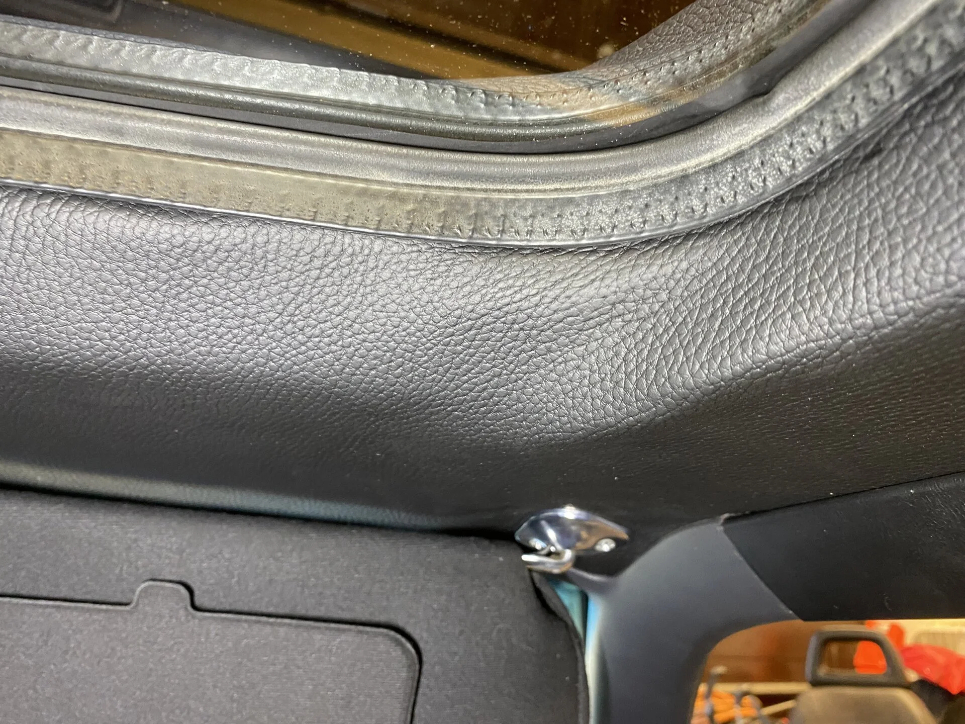

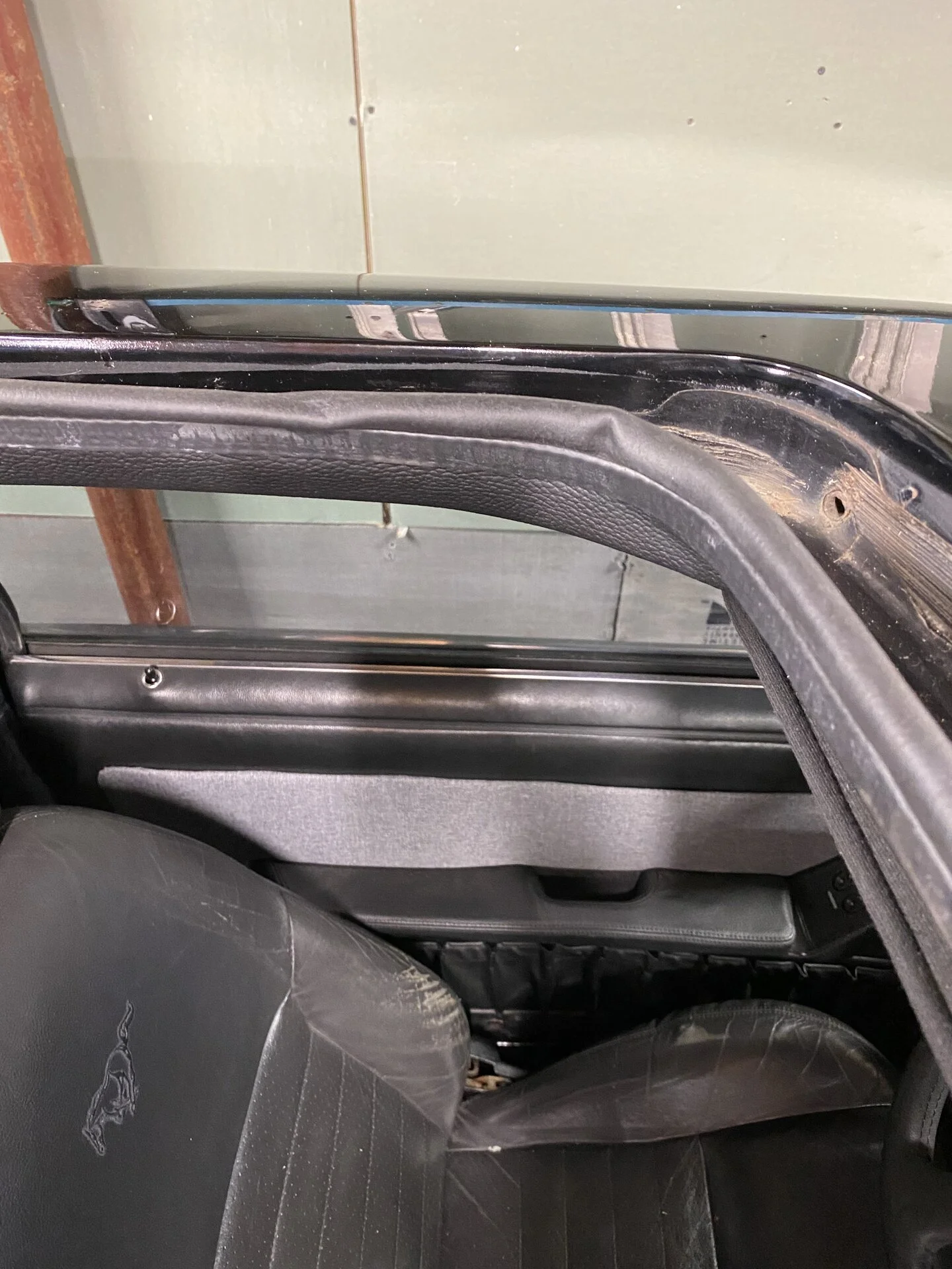

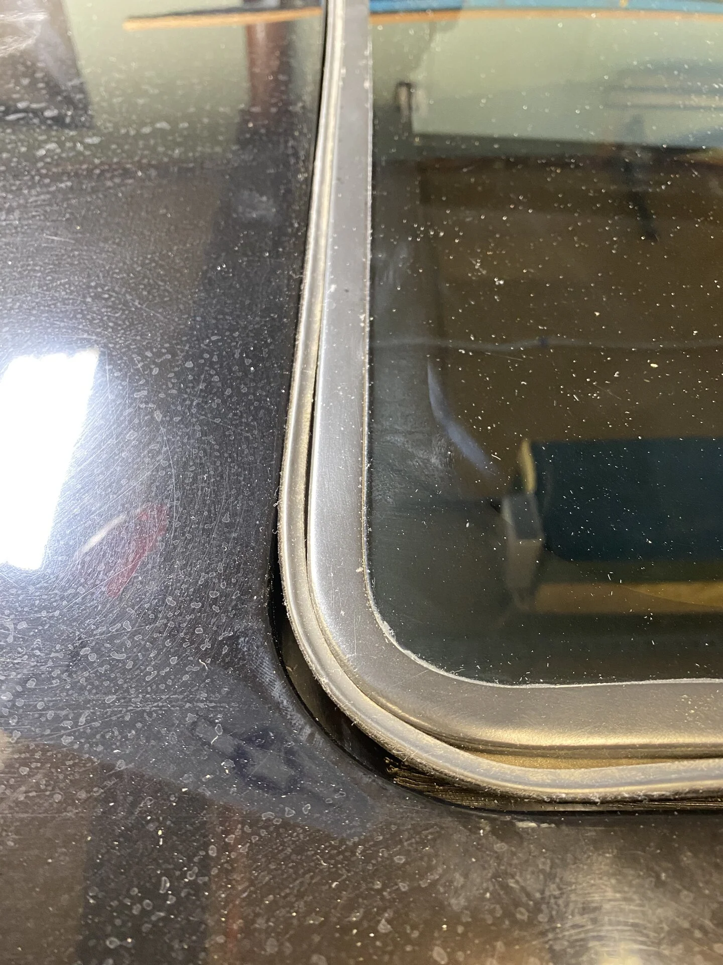

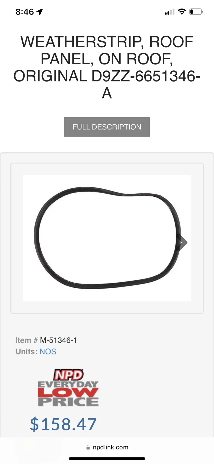

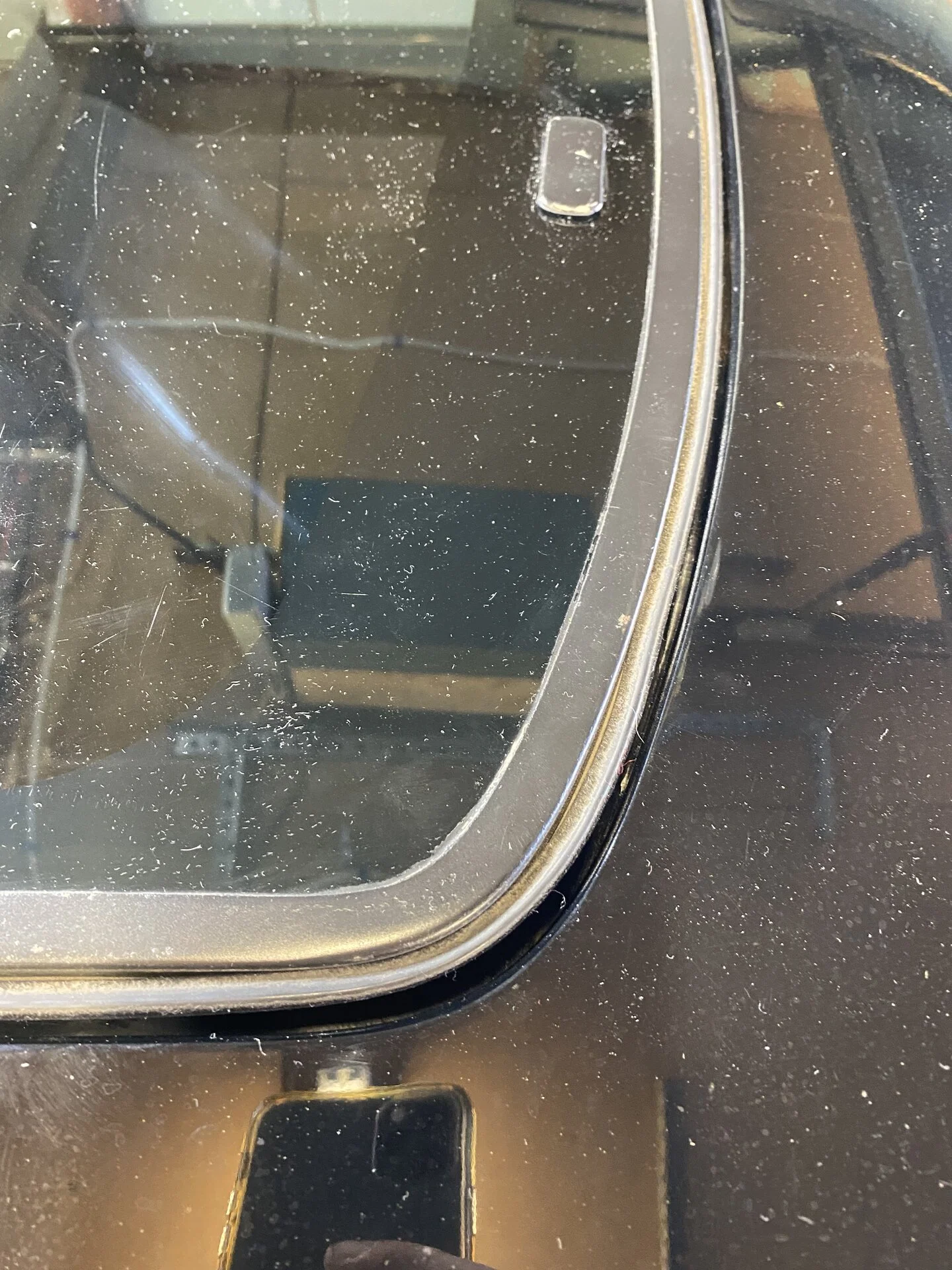

Ok couldn’t wait. Tested pulling up the seal and found the headliner was bonded to the pinch weld.
Pulled out the old seal and installed the new one
Ehhhhh….
Two front corners are the problem. Gonna see if it loosens up a tad over time and conforms better. In the meantime I’m keeping the seal I just took off. Maybe the cut to lenght ones are better?
Or do I pony up and do right…
Reactions: General karthief

  • Apr 15, 2022
  • #1,550
Ehhhhh….
That’s the every day low price!!! WTF!

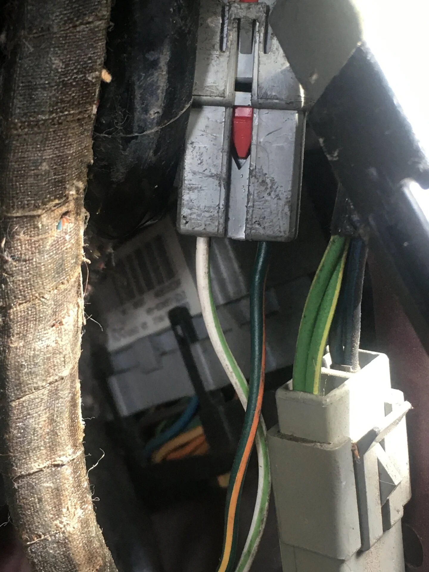

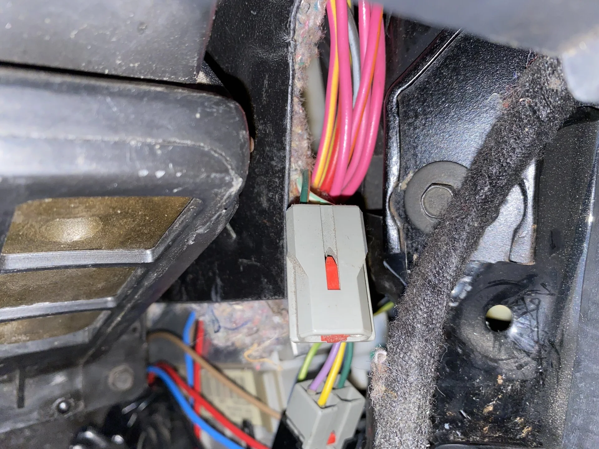

So my car was originally a non-premium stereo car with speakers in dash and rear only. Along the way I added the door soeakers with speaker wire.
I tore all that junk out. Using OEM wiring now. I don’t use the radio, so I just want a functional oem radio install.
As expected, my OE door speaker wire was present, but taped up. I removed it, purchased an adapter to hook up to my alpine door speakers and that’s all set nowS
I found the other end of the door speaker harness just inside each door jamb.
However, there is no female plug to the dash harness. I went through all my pics of my dash harness reloom and there is none. I looked on eBay at an 87-89 dash harness….and found it.
I’m assuming there IS a difference in dash harnesses. The premium radio cars seem to have a little extra wiring for the door speakers.
Makes absolutely no sense as my car had the wiring for cruise control, and the 4cyl fan controller, but apparently not 4 little wires for door speakers.
Can someone who’s car is an original premium radio car look to see where this plugs in?

Here you go. Looks like it comes from the amp behind the console? White with lt green and dark green with orange.
Reactions: Mustang5L5

Awesome thanks. Confirms my suspicions. The dash harnesses are different.
Looks like I’ll need to get some demaio connectors for this plug and tap into the dash speakers.

That's exactly what mine did, at first. Most of it relaxed into shape after sometime. Still a spot or two that didn't fully reshape but I can live it(it doesn't leak)

Maybe a hair dryer or heat gun (on low setting.... be careful!) would "help" it relax. Get it a little more pliable and then it might take a better shape when pressed into position by the sunroof.

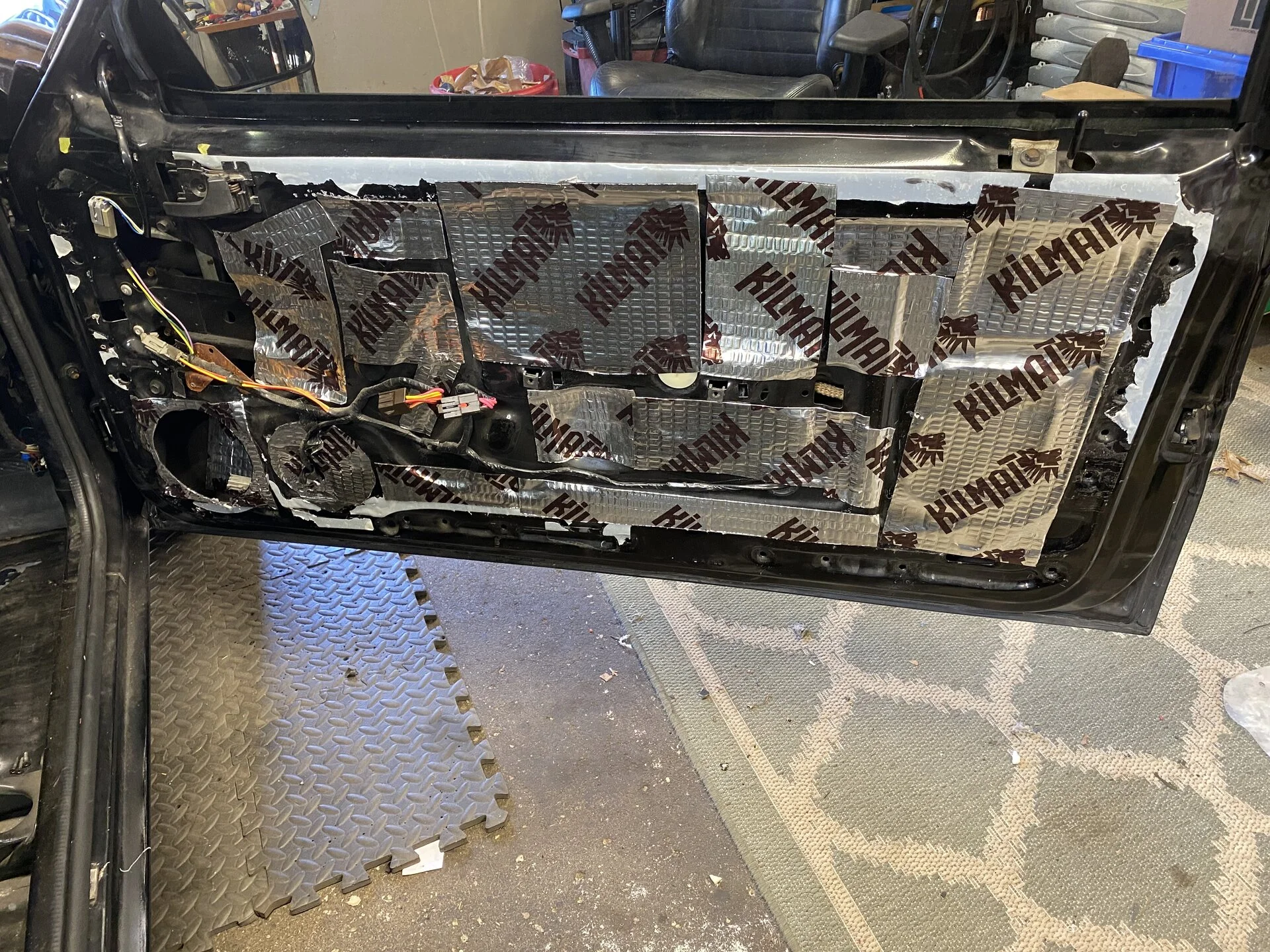

Well, crawled after bed after 2 days from the flu and managed to finish Kilmating the door. Door panel back on.
Gonna pop some meds and crawl into bed again shortly. But that stage is done.
Next up, SFCs. Debating on if I just try the jackstands to lift the car, or build wheel cribs. A 2x4 is what? $8 each right now?
Thought I took some pics of inside the door after applying the sound deadener but I guess I forgot.
