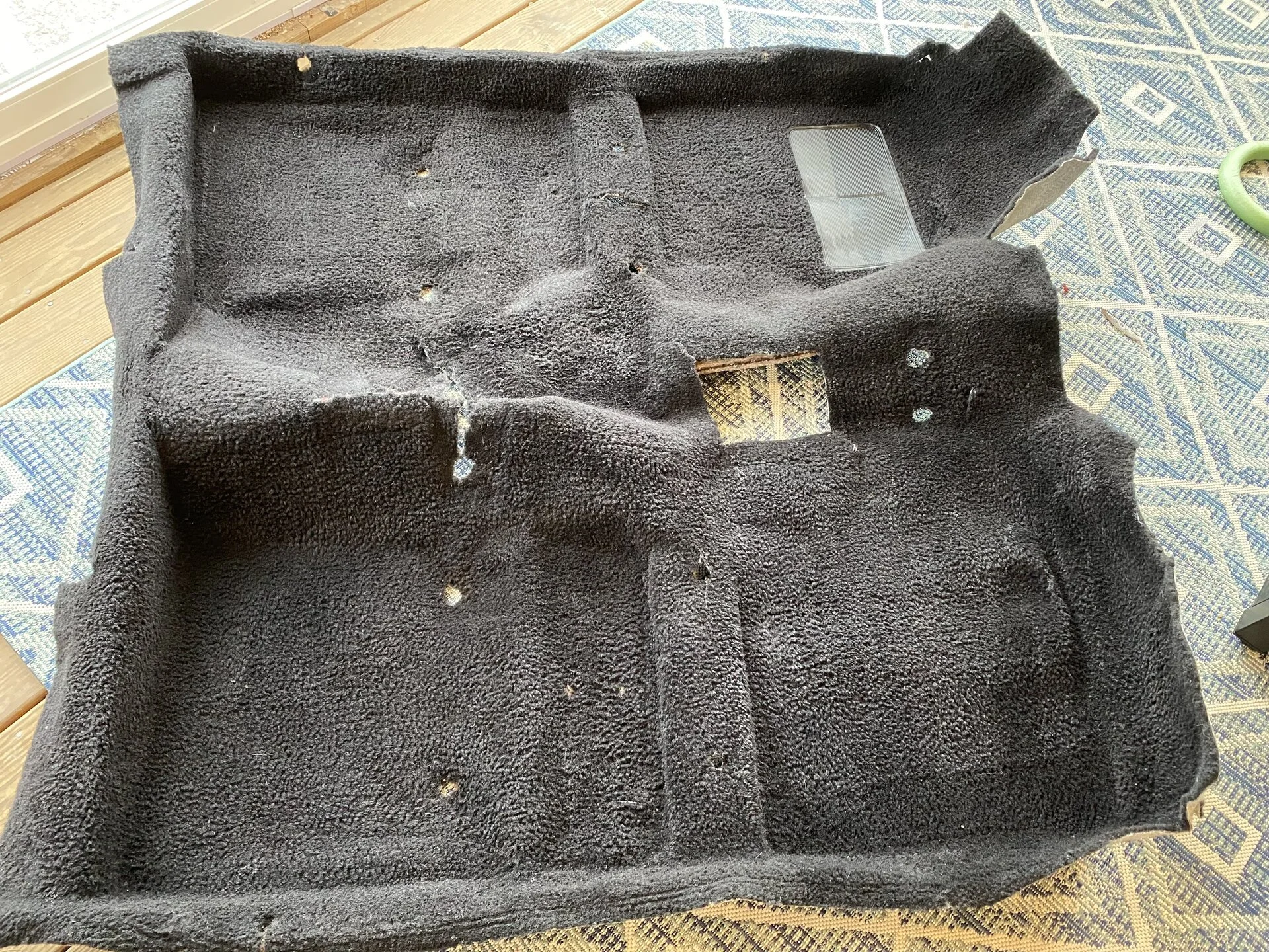

Bought a Bissell spot cleaner. Went to town. Carpet is fluffy and fresh again.
Dumped 3 buckets of this goop

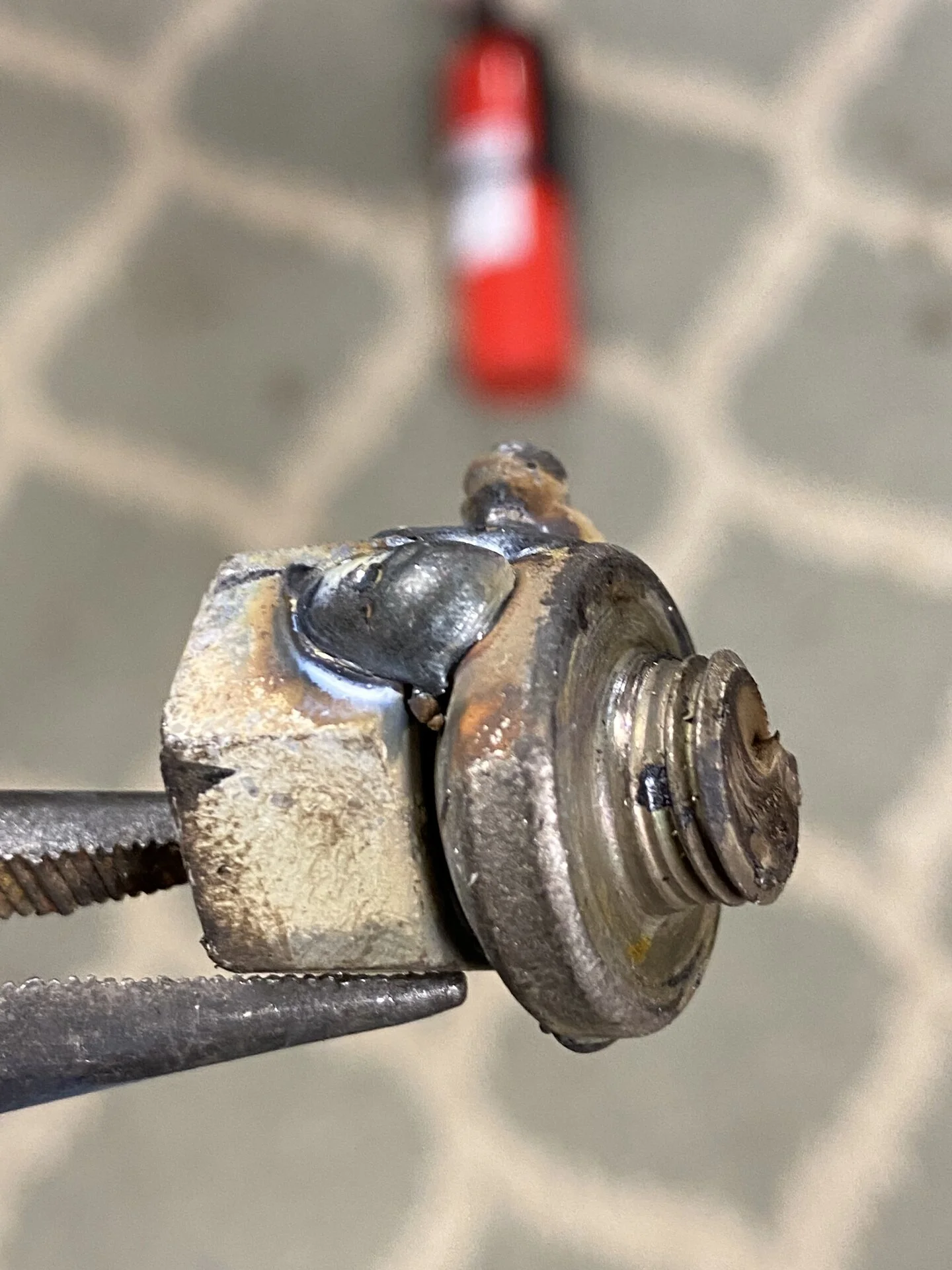

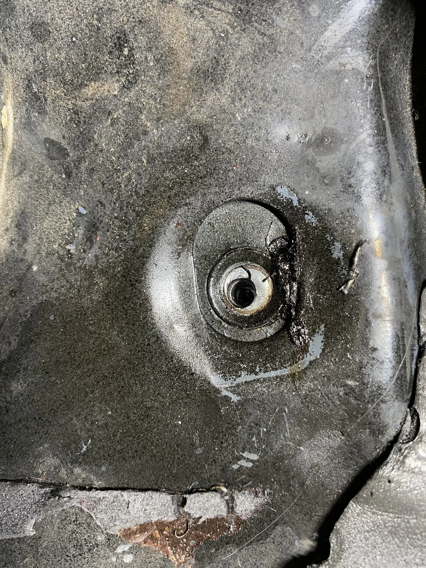

Attempted to change those rear seat belts finally.
Welded a nut to the seat belt bolt.
It held. But the bolt didn’t
Now I get the fun task of drilling this out

I would put some heat on that puppy before you try and extract it.
Oh I did. Maybe a little too much heat.

Is it rusted or cross threaded? Can you weld a nut to the bolt from the bottom/underside of the car?

Rusted. I can try welding a nut from the bottom. Need to pick up one in the proper pitch so I can thread it on a few threads and then weld. That’s a good idea.
This bolt is in there. I use heat and an impact and breaker bar and broken a few t50 bits. And then when I rounded out the torx I welded a nut onto it. I used a 30” breaker bar on it and it didn’t moved, eventually snapping.
That sucker is in there.

I had one that was stubborn, I was able to grab it with vice grips from the bottom

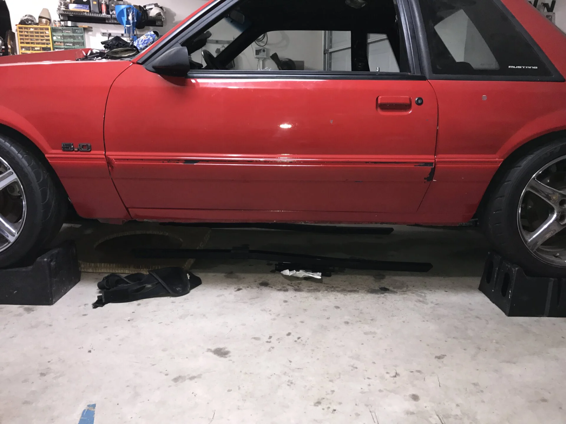

Worked on prepping the SFC install this AM. Got most of the metal cleaned up and prepped.
Only issue I ran into was the bend angle of the SFC is a bit more extreme than I need for my car. I’ll have to drag one into work and use the press there to lessen the bend slightly.
I should buy a press….but just something to get in the way.
Once I get this bend angle adjusted, ready to weld.

Also, I’ve had good luck using a 50/50 mixture of acetone and atf as rust penetrating fluid on stubborn bolts.

Kroil is your friend.

I really can’t complain. Rest of car came apart fine. These two bolts are being a PITA or some reason. There isn’t even visible corrosion.

i had the same problem with the front and rear seat belt bolts.....they were tight....they way i got them out was to loosen the bolt until it stopped and then gave it a strong 1/4 turn and then retighten the bolt back...i did that back and forth like 100x with wd40...it takes awhile
