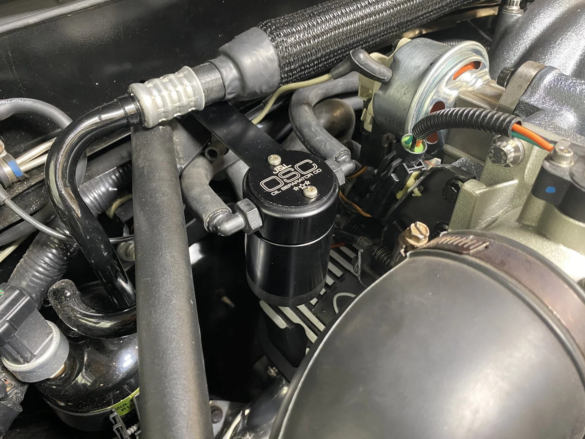

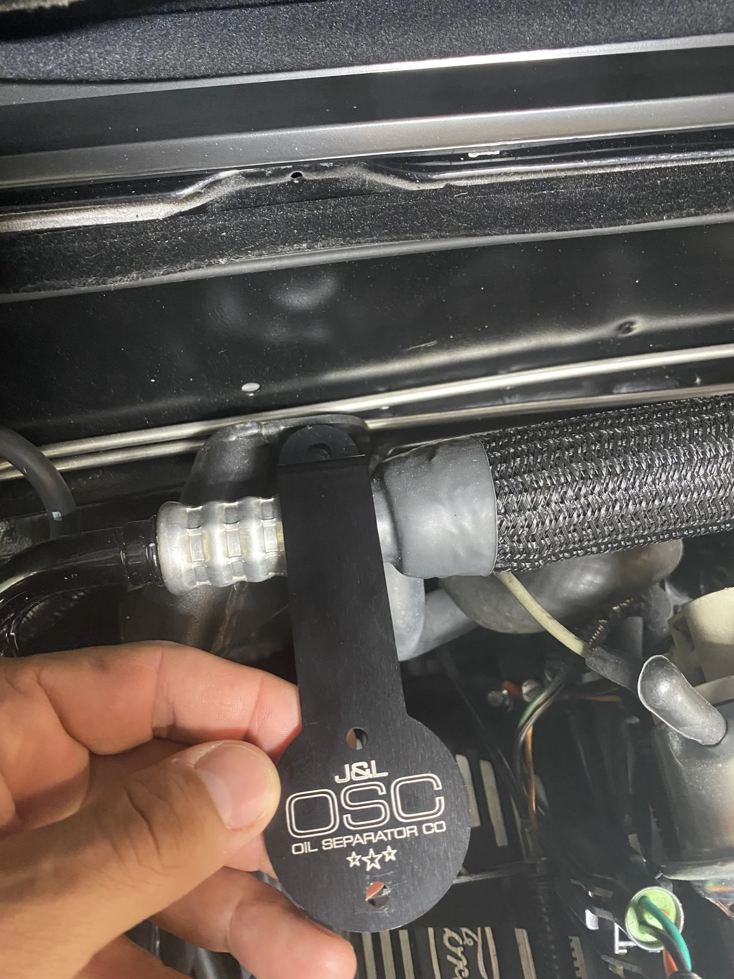

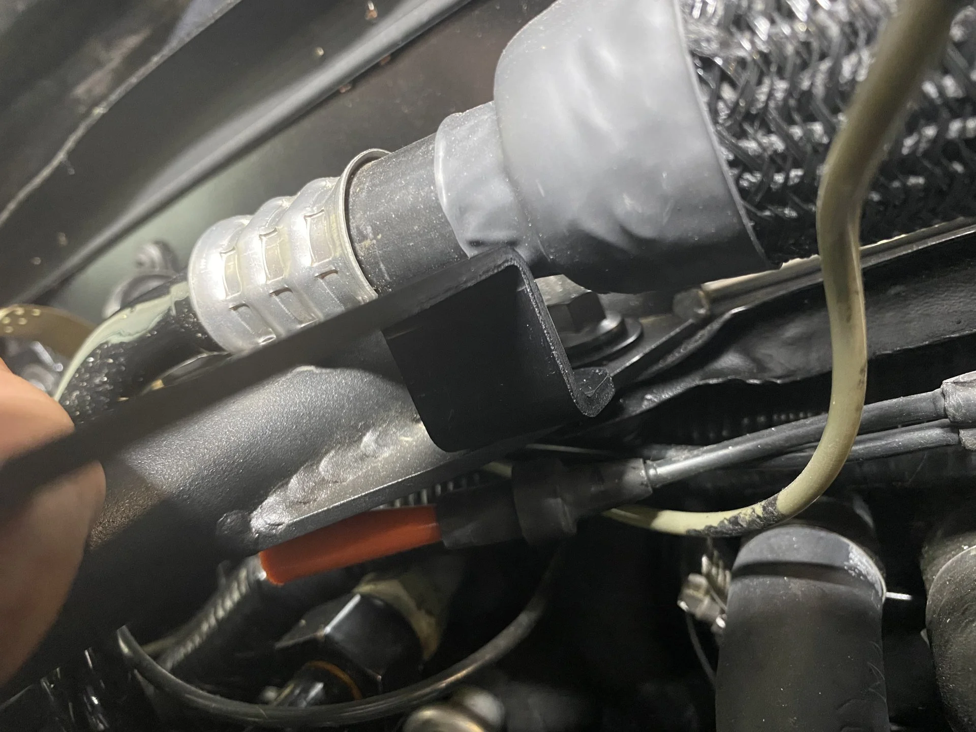

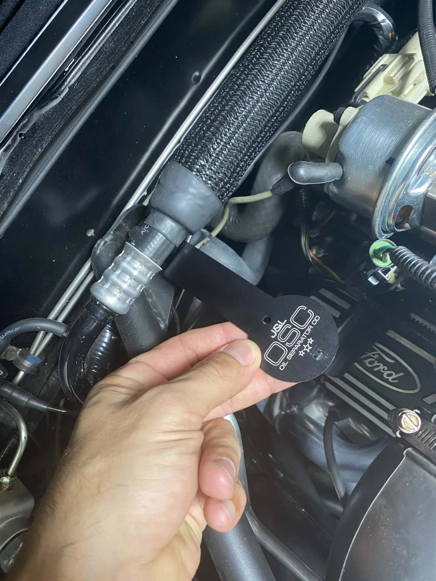

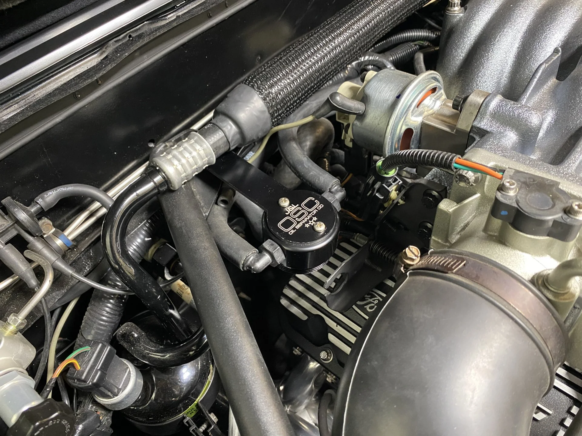

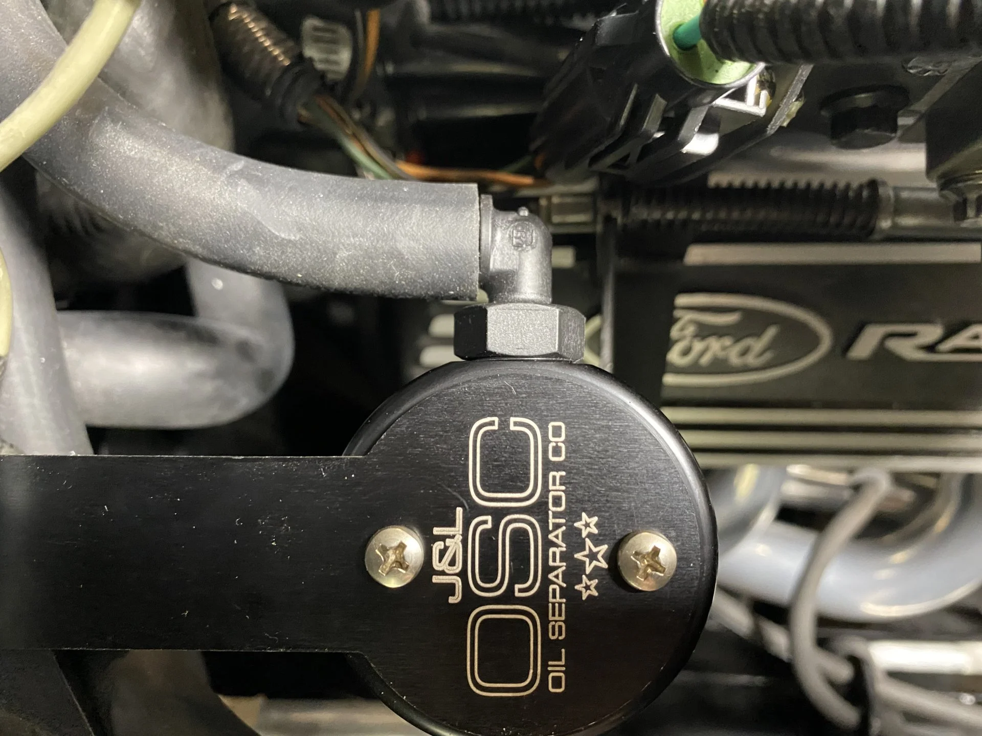

Do not break the AC for a bracket... logo or not.The bracket is annodized aluminum. I don’t have the means to weld aluminum without buying equipment, which doesn’t make sense.
I could design up and laser cut a new bracket and powdercoat it, but I actually like the logo on the bracket.
I need to unclamp the axcumulator and see if I can cheat the ac hose up the 1/4” it needs. I doubt it will go due to the evap holding it fast.
Too risky to put a tool on the ac line and bend it. Could rupture the line if I break it.
I’ll sleep on this. Not in a rush.

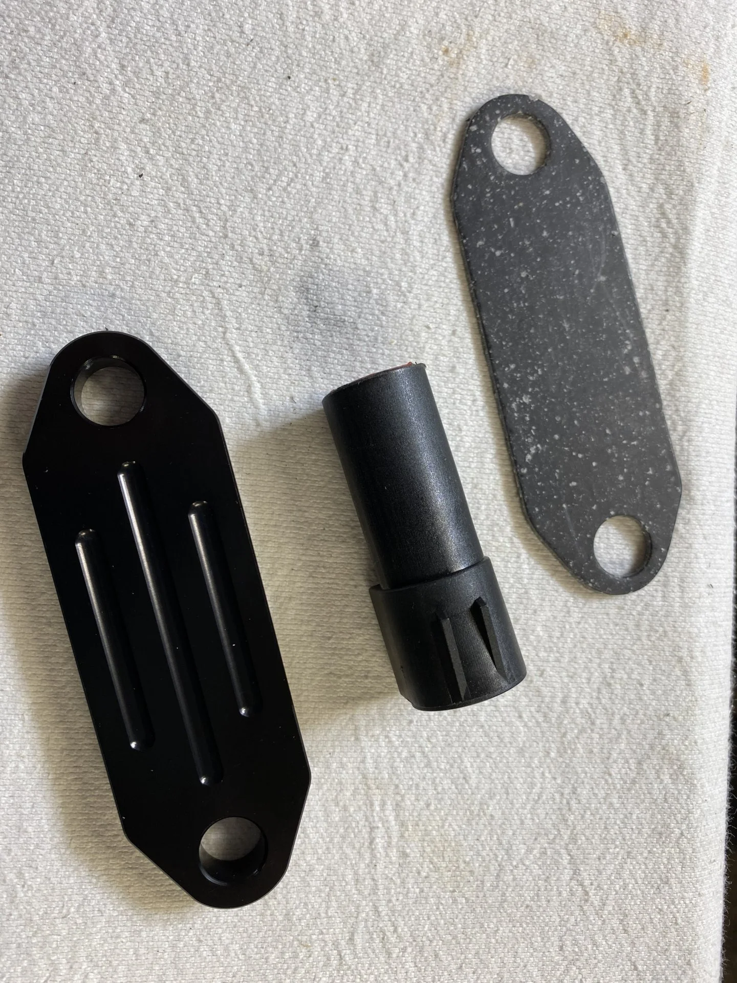

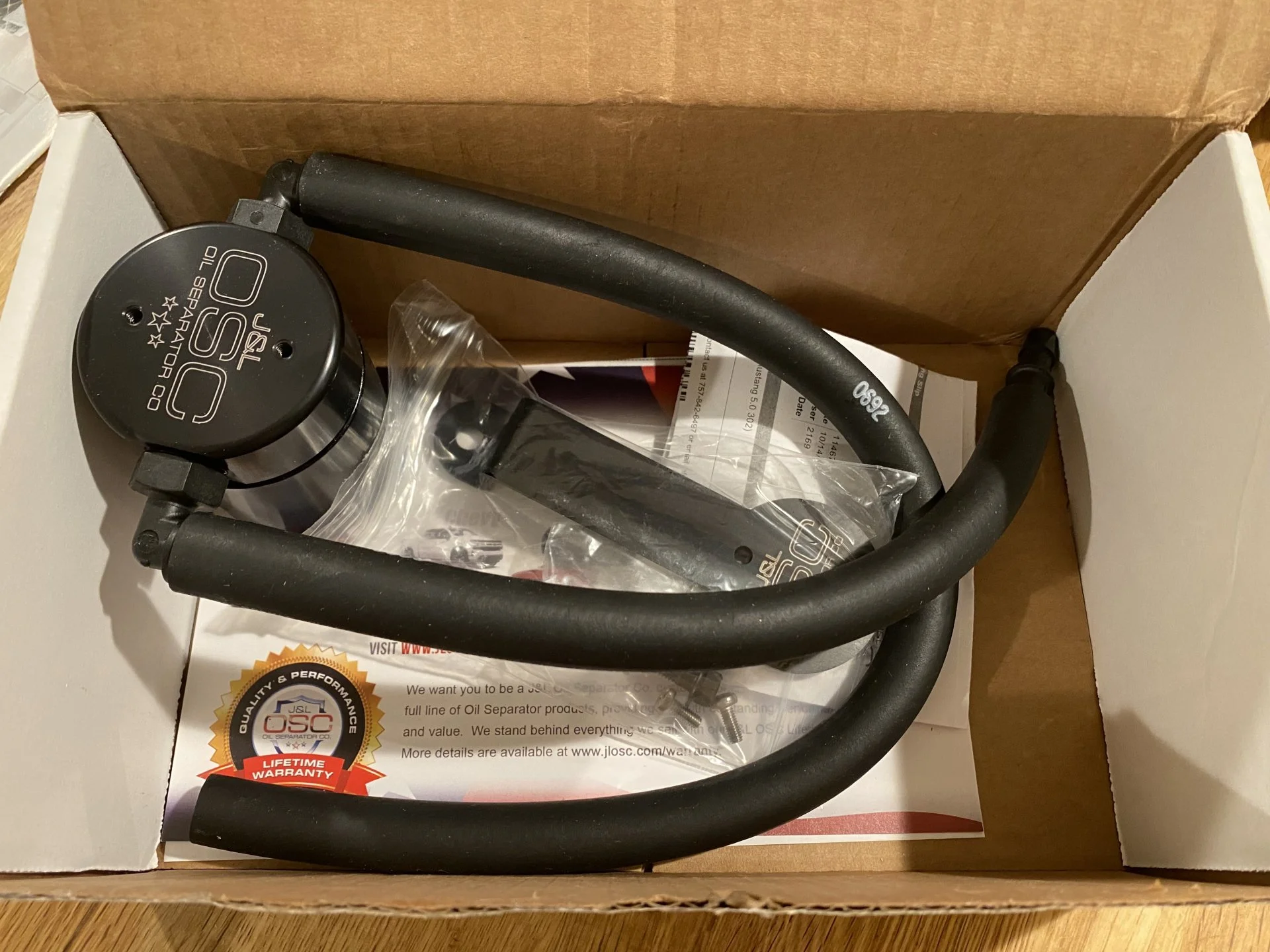

What's the " separater" part look like? Most of the kits I've seen are no better designed then the $12 China crap on fleabay

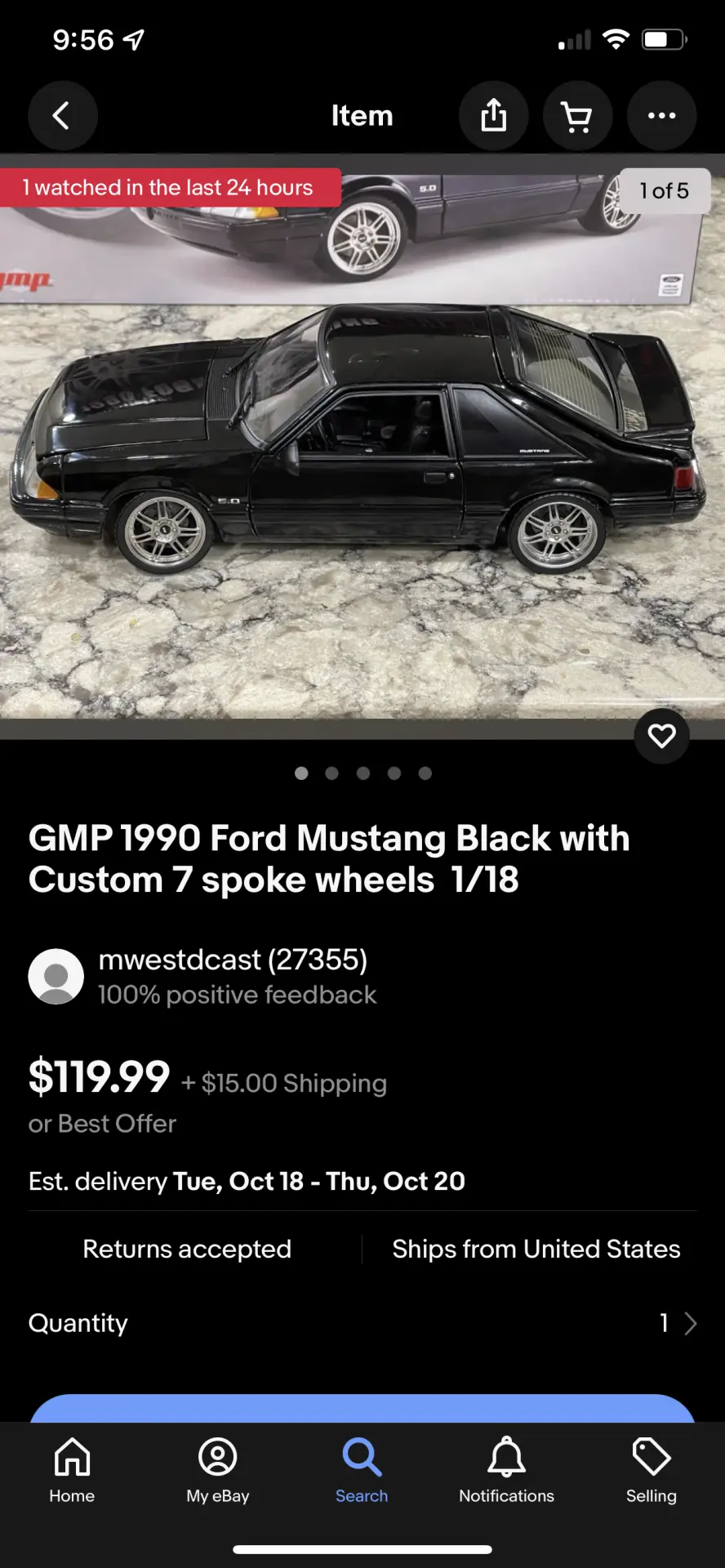

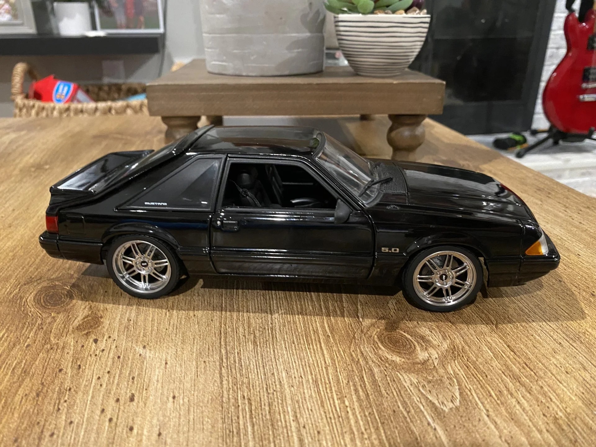

Ok. Time to make a duplicate of my car. I don’t think I’ll find 1:18 size 01 cobra wheels, but I found some wheels that kinda look like the cosmis wheels I want to run.
