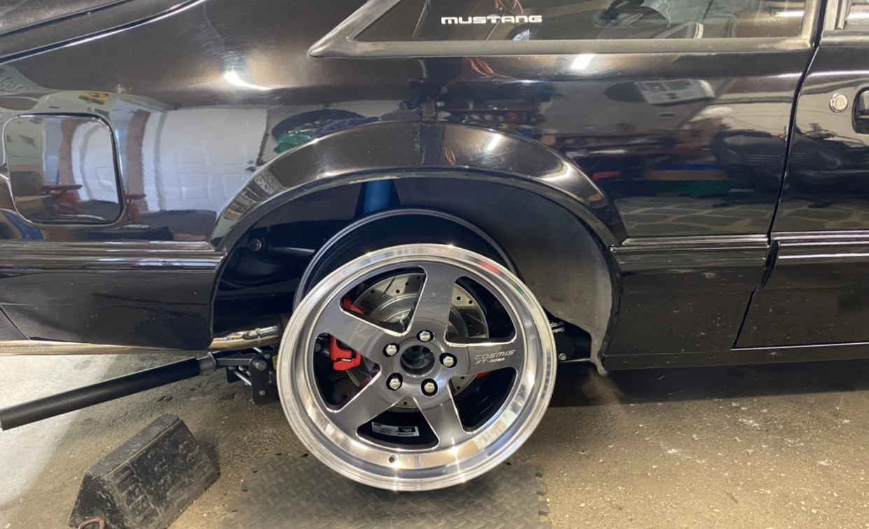

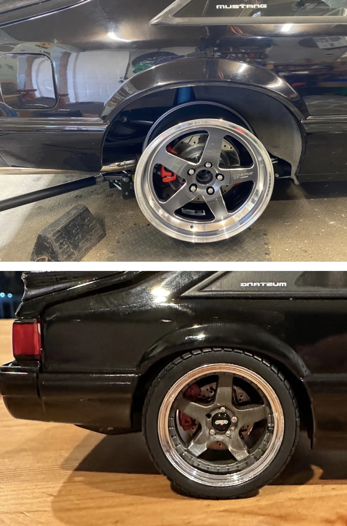

And rear setup is complete. Waiting for some plastic rod for the front so next update will be the finished car. Yes, the wheel is missing a lug nut. No idea where it went

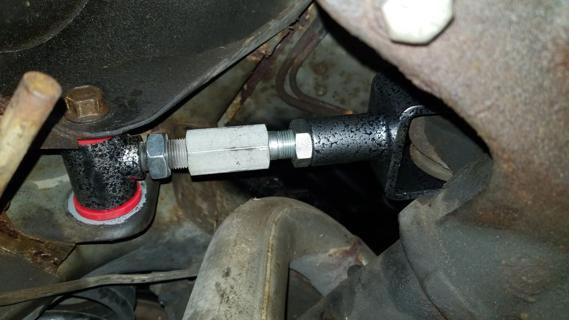

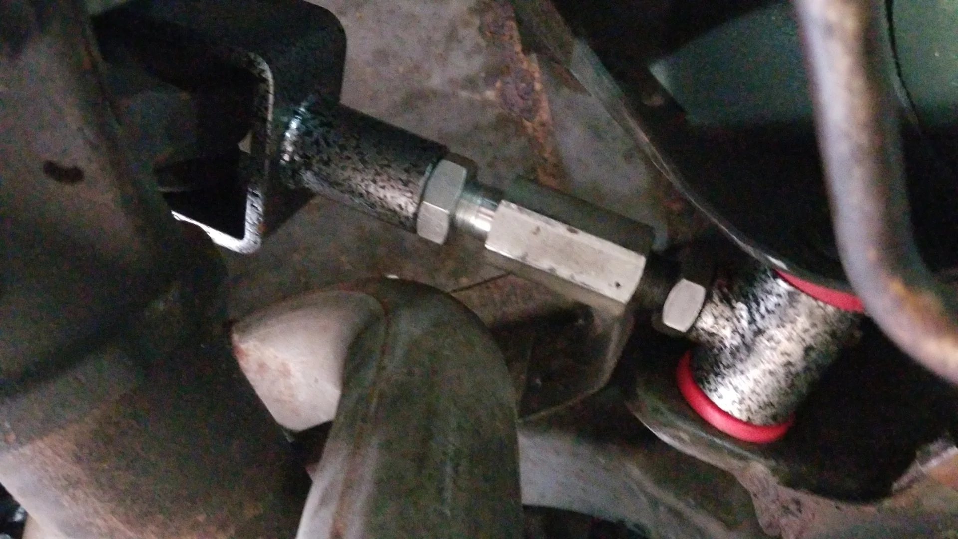

One thing I noticed is just how close these pipes came to the upper control arms. They only cleared because the Team-Z UCAs use adjustable rods. The stamped steel type would have required more cutting/welding to get clearance. These pics are not the new pipes but they give you an idea.

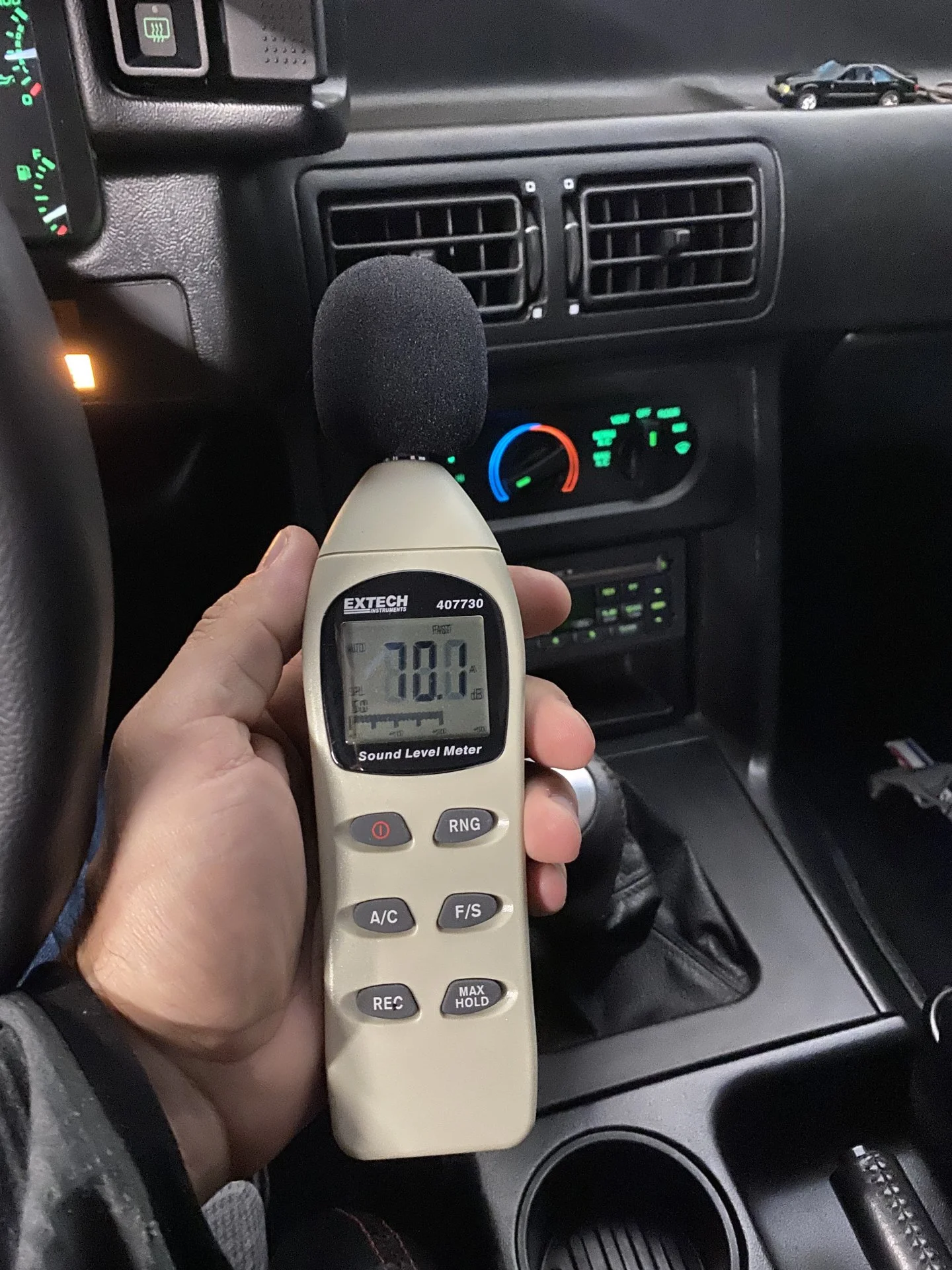

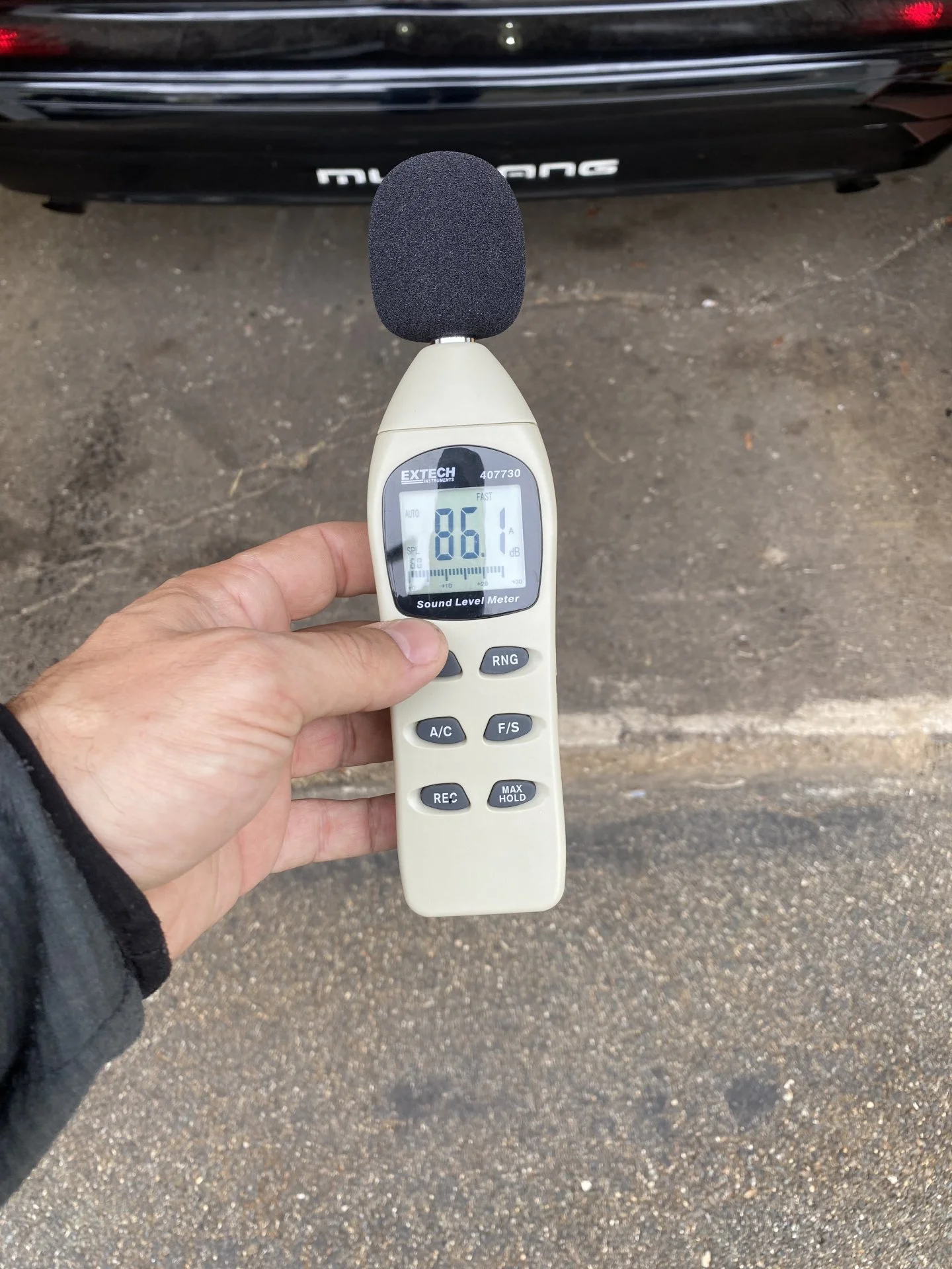

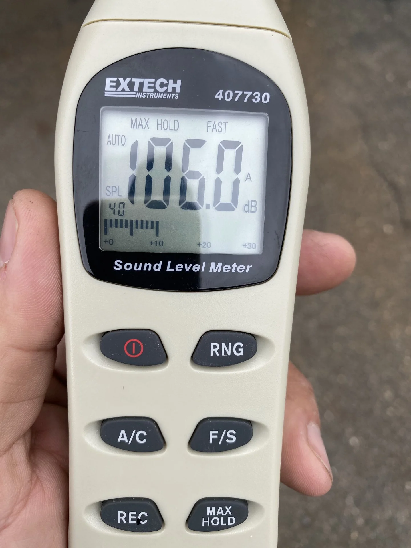

Just remembered I did take some DB readings a while back with a different meter. I’ll redo these with the new meter before I swap to the Borlas
86 DB at idle outside
106db with a good 4000-5000rpm Rev
70db inside the car at idle.
The kilmat and sound deadener stuff really made a difference in the interior and knocking down the sound. I was impressed.
