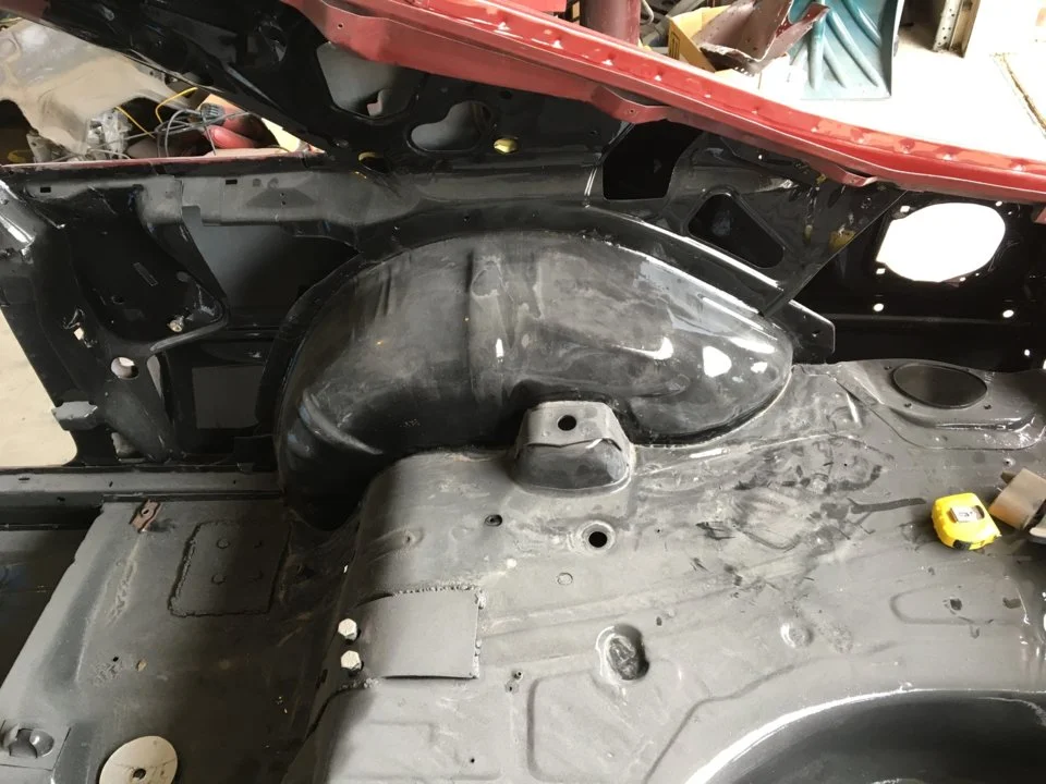

Davedacarpainter said:
You know @madmike1157 , I'm thinking my tubbing will be pretty easy compared to yours or @awilli93coupe 's mini tubbing.
Man, y'all had some tight spaces to work in!
Obviously, a hatch offers perfect world access to the areas that'll have to be cut, sectioned, and welded back in. The orange and black 86 drag car also had a minitub but it was huge. I think I added 4-5" in the middle to allow for a 295 drag radial under the quarter. No point in showing that one however, the car had traditional inboard mounted coil overs with no regard as to how it was gonna handle.

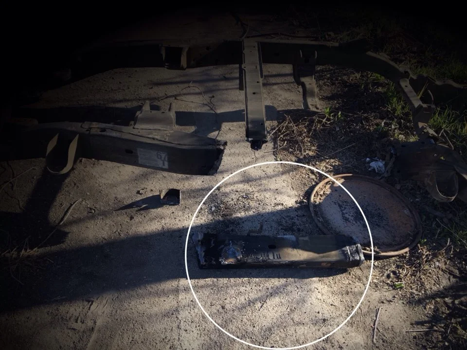

So, that is the early unmodified version of my boxed in frame with a notch for the coilovers with it's donor:
It was out in the back lot so I dragged the cut off torch to it and VOILA! That is some thick metal. It's from a 2013 Tahoe that had it's frame replaced.
That saved me at least $75 in new metal. Just need to cut it up into usable plates now.

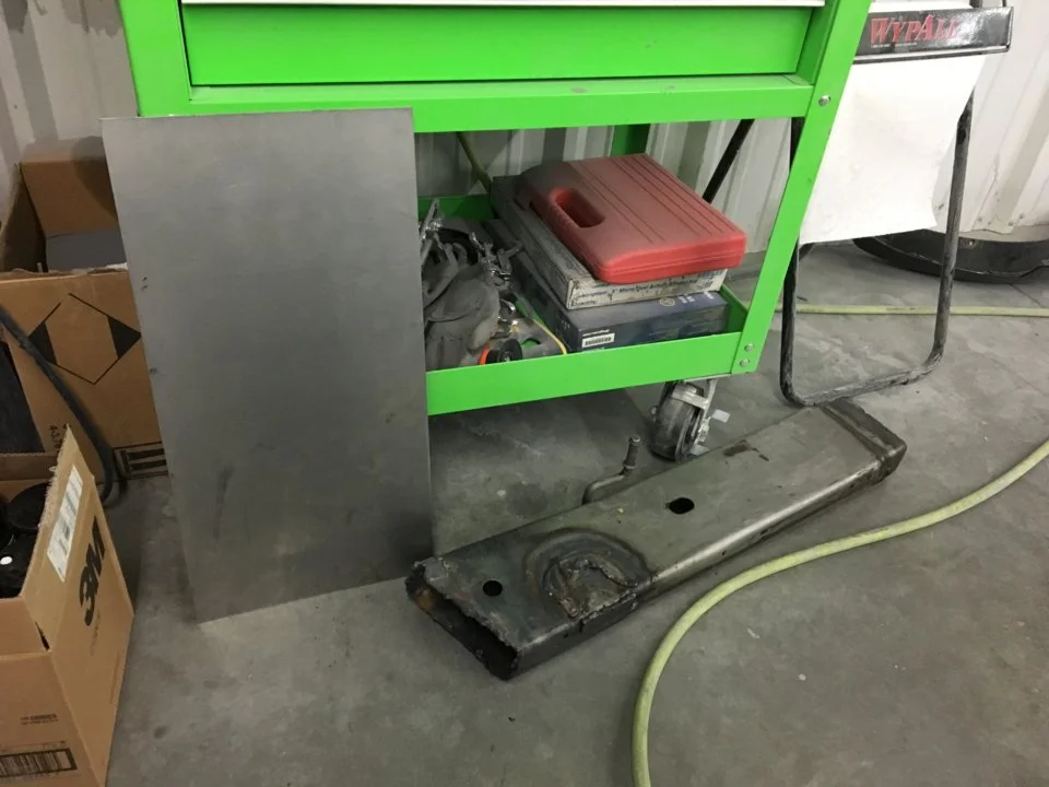

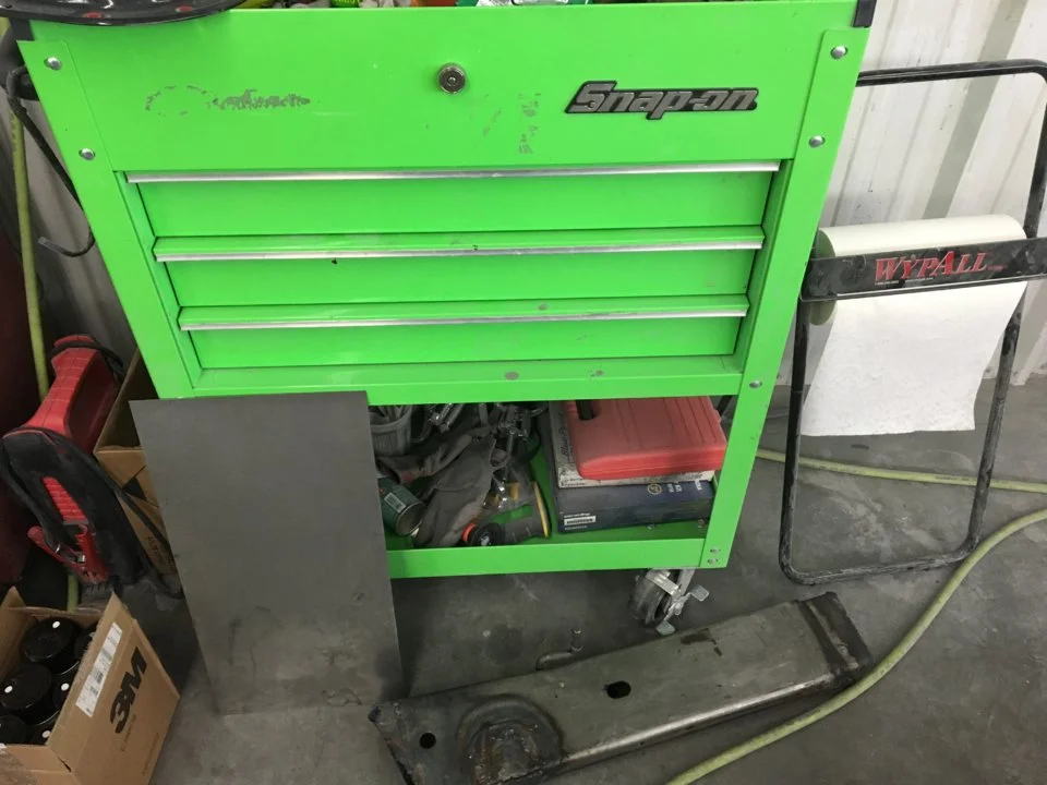

ok, I cleaned up the mini-tub kit:
Now I need to do some measuring and cutting into bite size pieces.

Now that's a green table.
I'll betcha it says snap-on on it somewhere.

Here's a neat note about cutting up that frame section, our service department has a plasma cutter!
That will beat the living crap out of a cut off wheel!
I guess I'll make some templates of what I'll need tonight and then outline them on that section. I'll show pictures of how it turns out.
