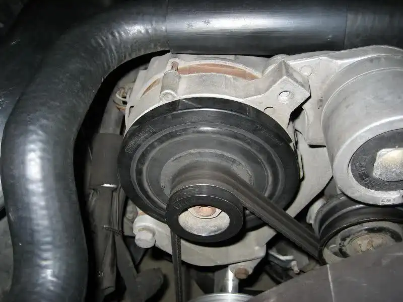

Strange looking alternator
Is this not a Mustang engine or something?
Those are the correct Mustang parts. They used the E6 lower intake until 1989 or so. The upper intake was changed so if you took the 5.0 HO plaque off, you should see an E7 part number.
That alternator is the original 1987 65Amp alt. The automatic cars got a 75Amp. In 1988, all the cars got the 75amp.
