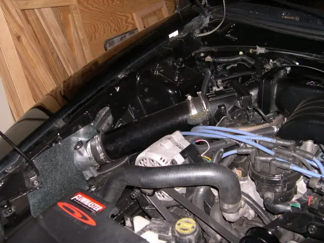

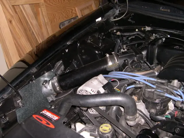

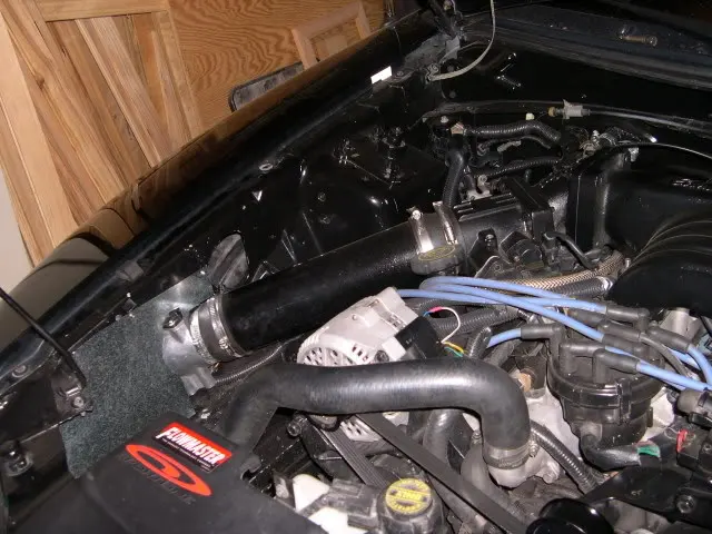

We've done some testing and the straight shot short pipes are making more power. To put the filter in the fender your going to have at least a bend or two.
But its all ok, nitrous will cool that air charge down :).
I beg to differ....

DARK-5.0 said:
I beg to differ....
Great motor btw.
Jeremy
Ok I see you have a stock meter, or stock style meter. I have a Pro-M 80mm...so for that meter to fit into the fender the meter has to be pointed down. So first off there will be a bend right after the meter. And probably another one in some form coming out of the fender.
