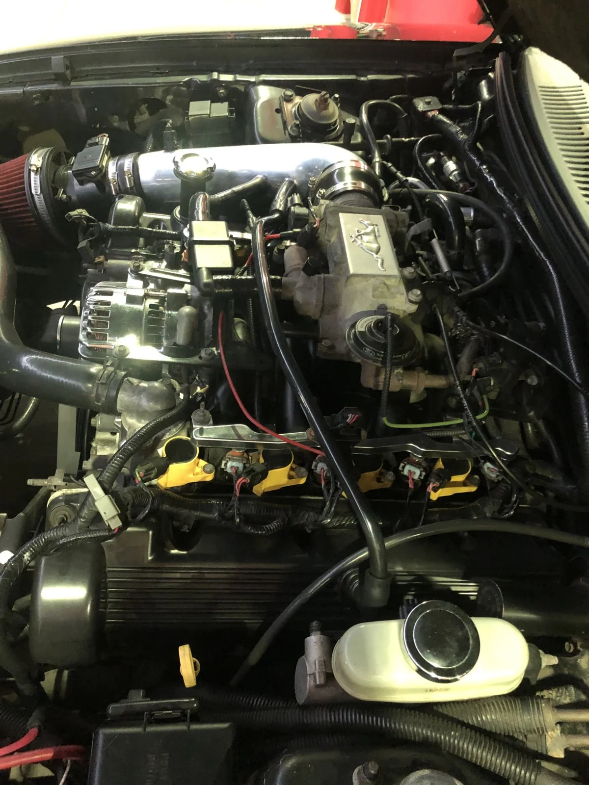

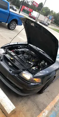

If you have an engine pic, it could easily be picked out if there’s any mods not mentioned by the previous owner that require a Tune, injector colors, etc..
Best pic I have right now. I can get a better one in a couple hours

Hi, EV-1 19lb injectors for GT’s 01’, 02’-03’ went 21lb, MAF calibration delegates size. Don’t have Longtubeheaders- right? I took the I make & am zooming in closer. Is there a Pony on the top of your Throttle body? That’s OE.
I’ll brb, looking at zoomed pic..
Hi, only thing I see different cause is the CAI, the placement of the MAF and IAT are different than stock. It will probably have no effect, and again- you will be revert back to the previous Tune, for whatever reason.
You won’t lose your OE tune with an X3, nothing is deleted without at minimum 2 “are you certain you wish to delete this?” warnings.
Your 2001 Mustang GT’s stock injectors should be Yellow in color, 19 lbs. Even if larger, it’s the MAF that needs to be calibrated for the injectors, not the CPU.
I cant see if you have Headers, Long Tube headers require a tune due to 02 sensor location. Shortys are run without a tune, are better with a tune, but will run fine without.
Accel Coils have no affect, and the vacuum system routing looks stock. If it has no internal mod’s, L.Tube headers, it should have no problems running the stock tune. Bringing me to another question...

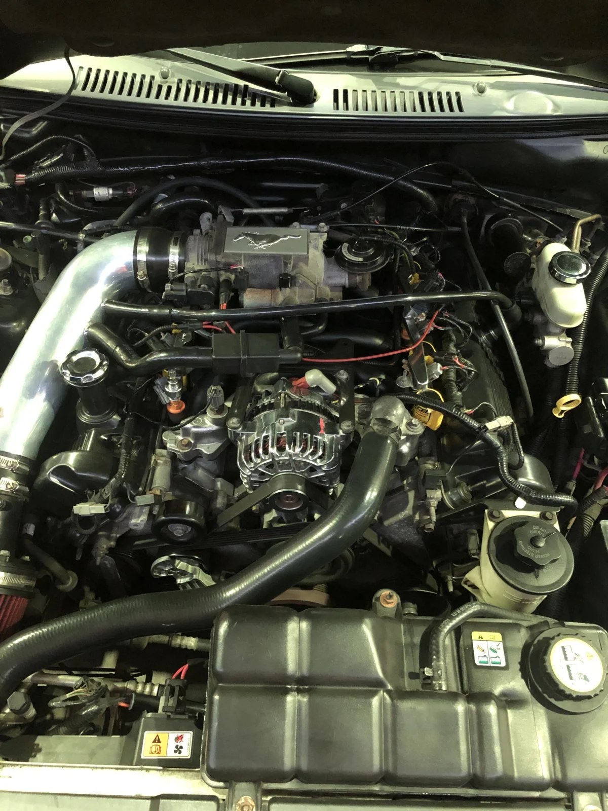

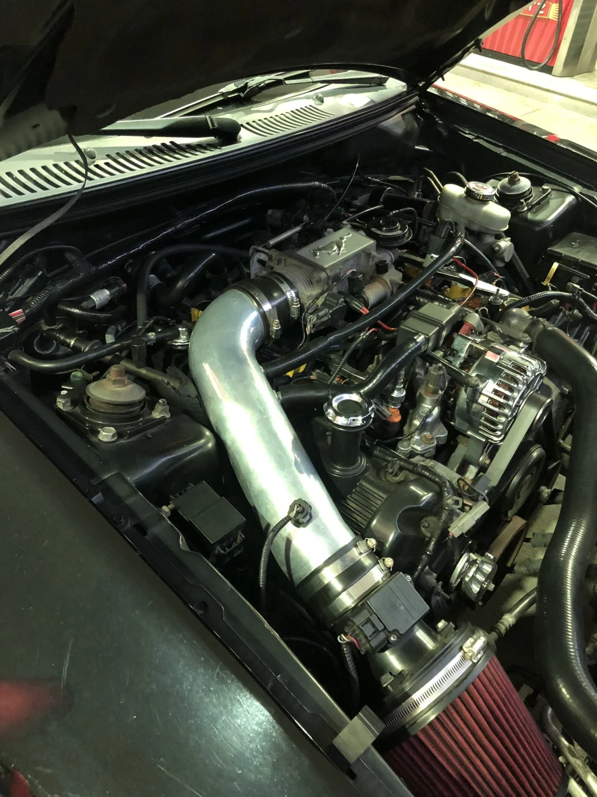

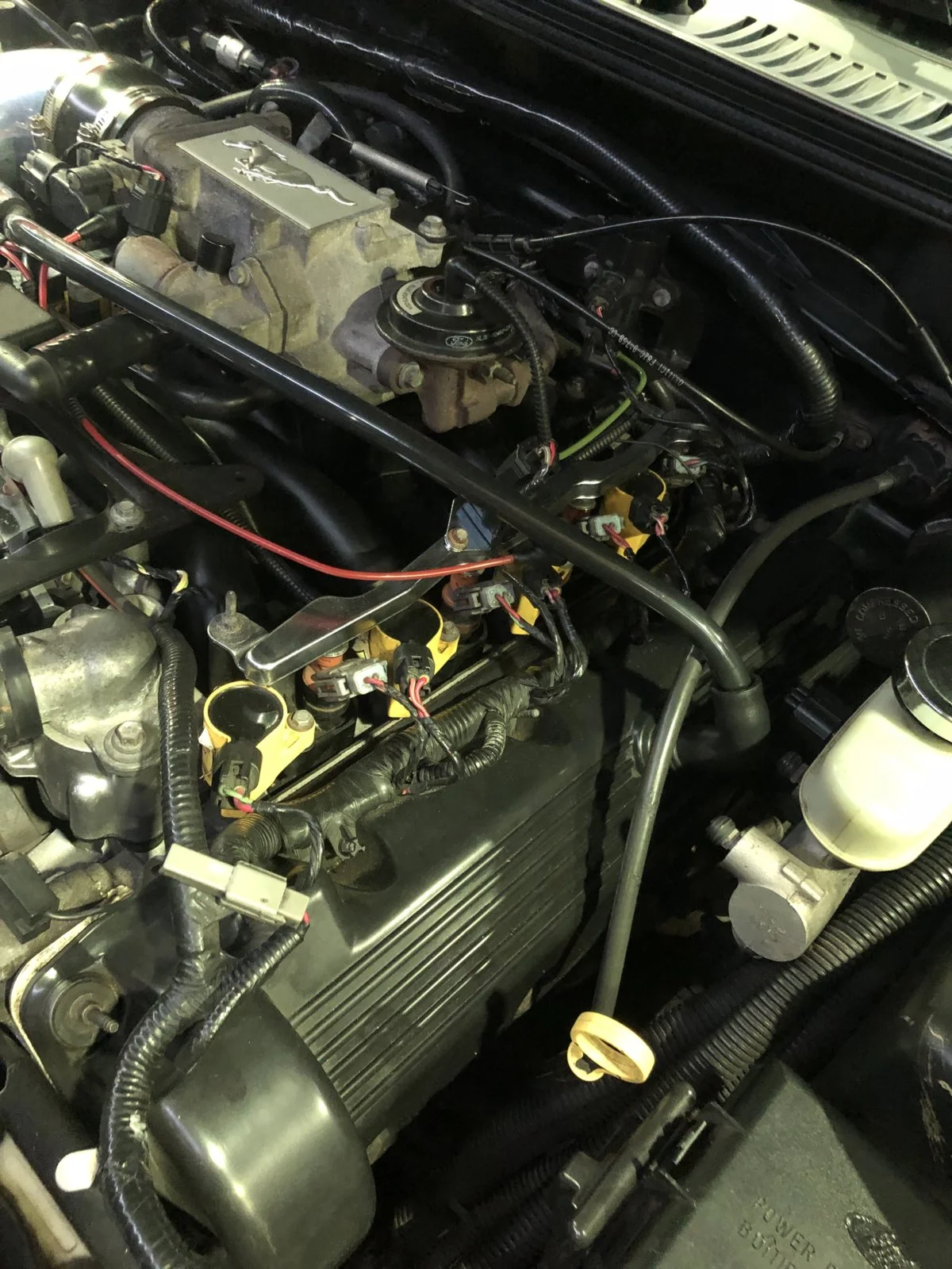

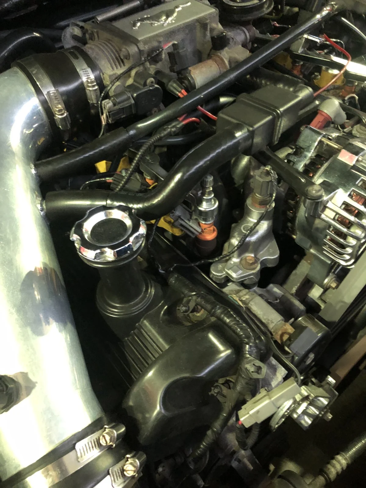

Thank you for all the help! I will add some more pictures of the engine in case that will help... I’m not sure about the headers/long tube headers but the previous owner didn’t mention anything so I doubt my car has them.
I’d like some help with figuring out why the code is being thrown. I recently changed the fuel filter because I thought that might fix the issue and that helped the car run better but the code was still coming back.
I’ll check for vacuum leaks tomorrow and I’m also changing the spark plugs tomorrow just as a precaution

Hi, Great Pic’s! It’s helpful to have a fuel pressure gauge on the fuel rail (pic below), use a 1/4”NPT Y filling to install both the valve & gauge, gauges are typically 1/8” NPT, use a 90 degree fitting for the gauge in the 1/4” NPT Y, so the gauge will sit, horizontally.
Motor does appear stock, aside from the CAI & Coils, can’t quite see- but seems like stock exhaust manifolds, assuming OE Cat’s are still in place. Issues like this can range from the fuel pump, a line split inside the tank at the pump, wiring to the pump, connectors under the tank, inertia switch wiring loose, fuel pressure regulator, worst- CCRM, but car primes when key turns, correct? Fans kick on when car’s warm, correct?
Pull the line off the Fuel pressure regulator, see if you taste, or detect very strong odor of fuel, line from regulator in mouth with small suction applied.(Pic showing regulator below). Get a list together later today, 2:45 here, up at 4:30AM. Niters!
