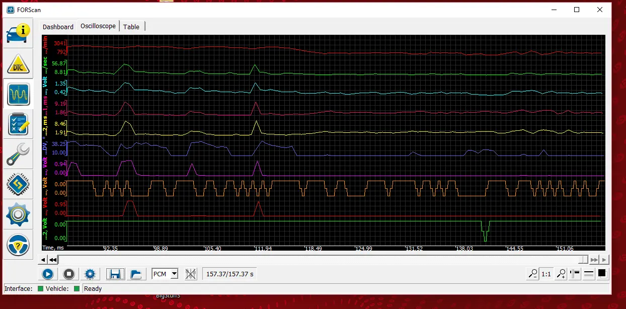

You can see from the datalog the 4 oxygen sensors below. Oxygen sensor 1,3 and 4 were bad. Oxygen sensor 2 had the correct heart beats(orange in color on graph), which they all should have that heartbeat. I was chasing my tail trying to correct issues when I should have data logged to find the source. Very valuable information to be learned using the elm adapter. Download forscan software and with a little bit of patience you can learn a whole lot about your car and the issues your having. 20 dollar cure to instead of throwing parts at it and guessing.
Reactions: 08GT500
