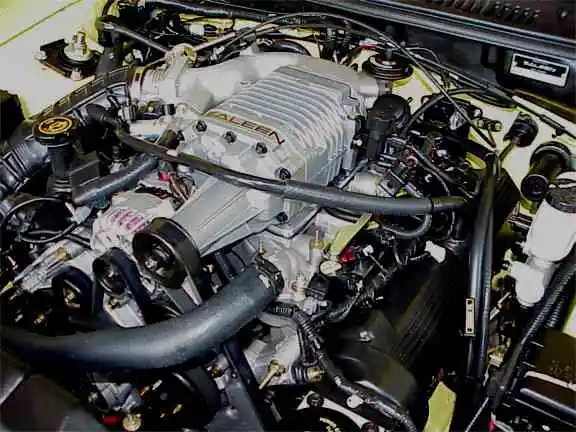

Heres some pics of my Series II during the install:
You might also have a Series I, if it says Saleen across the top like in this picture:
