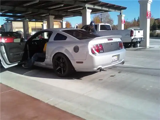

Don't do it! I bought a pair of 17x9 Saleen wheels for my 07 GT, but they were for the 94-04, which use a very different offset. Stuck out too far...
NO, THERE ARE 2 DIFF OFFSETS FOR THOSE WHEELS, THE ONES THAT FIT 99-04 (THE TOP PIC, STICKING OUT A LIL) AND THE 05+UP OFFSET. I WAS LOOKING AT THEM TOO, BUT THE 1ST PICTURE OF THEM STICKING OUT SEEMS TO ME TO BE A SET OF 99-04 WHEELS ON AN S197... SO I WAS CURIOUS IF THE FRONTS STICK OUT THE SAME AMOUNT, OR, IF I BUY 2 S197 OFFSETS FOR THE FRONT, AND 2 99-04 OFFSETS FOR THE BACK WOULD IT WORK, JUST WITH THE REARS STICKING OUT A LIL

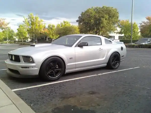

Yeah, I actually bought my car with stock premium 19's and took them off for staggered 18's 9's in the front, 10's in the back... it all depends on what you really wanna do with your car, if you look at almost any S197 that is pulling 1g or more, aka a partial track car, they arent typically using 19" or 20" wheels, they are using a smaller 18 or 17" wheel, with a super aggressive tire, real handling comes with the suspension setup, dialing it in and your choice of tire!! Do you want the wheels more for looks, or do you drag race the car alot, or like the g's for trackday/auto cross??
