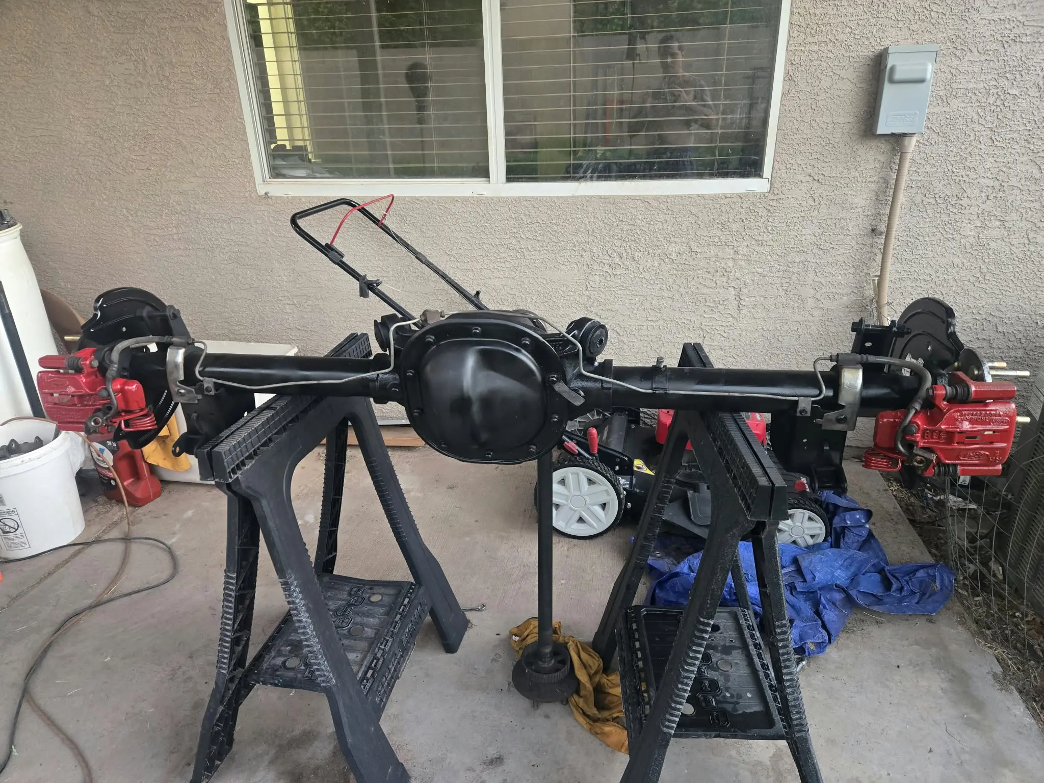

About finished getting the 94-98 rear end ready for the swap. I cleaned, primered and painted it, installed fox length axles. Just waiting on the sn95 rotors and new pads.
I have the factory sn95 stock hardlines on the rear end, I just need to clarify what fitting/adapter etc I need to connect the Fox brake supply line to the T fitting on the rear end.
Some info I find says 3/8"-24 Inverted Flare Female to 7/16"-24 Inverted Flare Male adapter fitting, while others say its 3/8 -24 on both ends. My fox is an 86 v6 car.

You will need to install this piece which you may already have but it’s hard to tell:
Mustang 8.8" Rear End Center Upper Rear Brake Hose (86-95)
Have a cracked or leaking center brake hose on the rear of your 1986-95 Mustang? Replace it with this high quality, direct fit replacement!
lmr.com
Then you need this piece:
https://lmr.com/item/LRS-2073BRKT/mustang-v8-rear-upper-brake-hose-bracket-86-93
Watch the video on how this installs. It’s at the bottom of the LMR page.
Then you will need to reroute the rear brake line from running all the way down the passenger side to half way down and then transition to in the driveshaft tunnel to connect to the piece in the link directly above.

I can't see in your pic of the rear end, did you change or adapt the caliper axle bracket or is it stock SN. If still stock and not relocated the stock SN rotors will not work with the Fox axles. Post a pic of the axle end area and we should be able to confirm or better advise if something needs to change.

Thank you , you had posted that before for me. I thought it was just a bracket to hold line in place. Now I see that its a fitting to adapt .
Yes I did the cut and move brackets to opposite inside of flange method. Already confirmed they fit with the old rotors.
