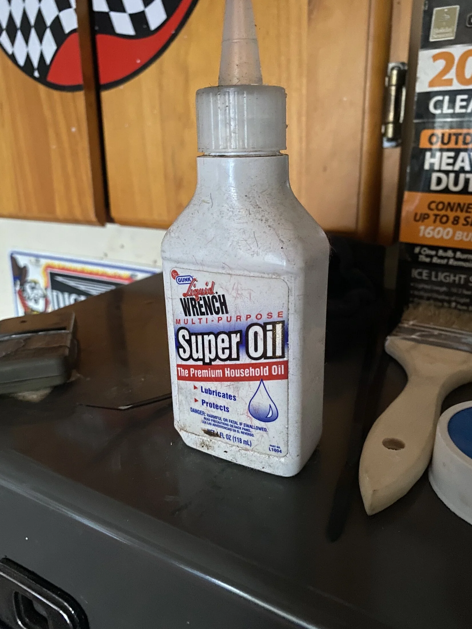

You got me thinking about the oil, and this is what I used.

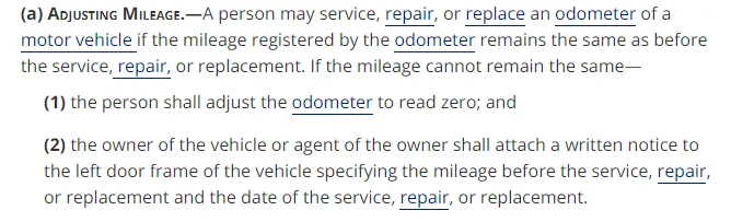

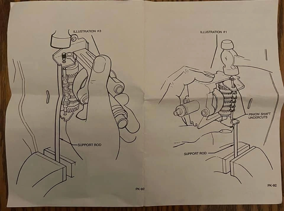

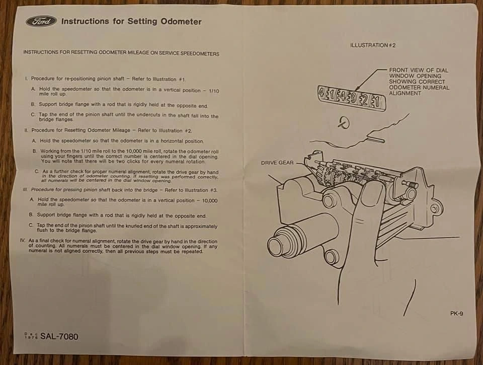

Read US Code 32703 and 32704. It lays out pretty clearly what you can and cannot do when it comes to odometer "adjustment", specifically 32704. The Ford Motorsport speedometers came with directions on how to correct the odometer.
Here’s the Ford instructions. They are not that good.

That's exactly what the law states.
If you are unable to set the odometer to match the original mileage, you zero it and declare it with a label
But i'm not a lawyer. You folks can do whatever you need to do.
