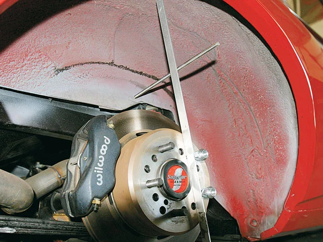

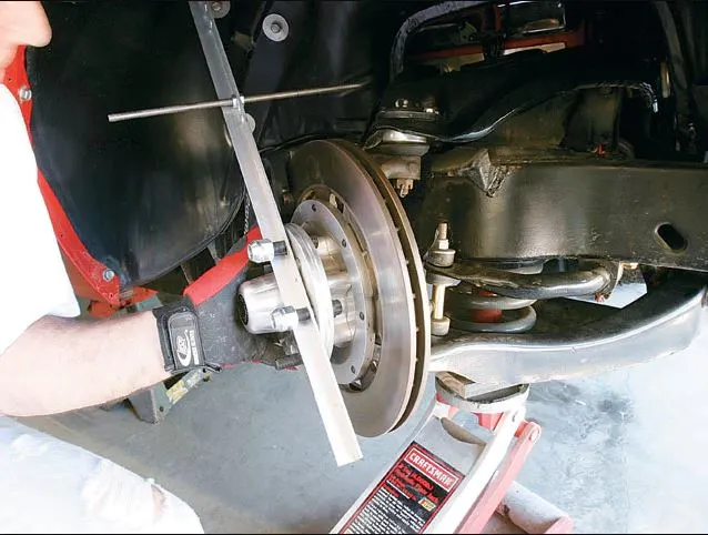

I am having trouble measuring the distance from the inner fenderwell to the wheel mounting surface as well as to the outer fender and could use a little help with wheel offset. Would I have clearance issues with a set of 16x8 with a 20mm offset wheels on an 88 LX? I need to buy axles for this project since I am going 5 lug and am currently on a turbocoupe rear axle so I am considering 98 Mustang axles to keep the track width which is 3/4" further out per side.
Do this. All you need is a piece of angle cut to length, a piece of all-thread, and a couple nuts.
