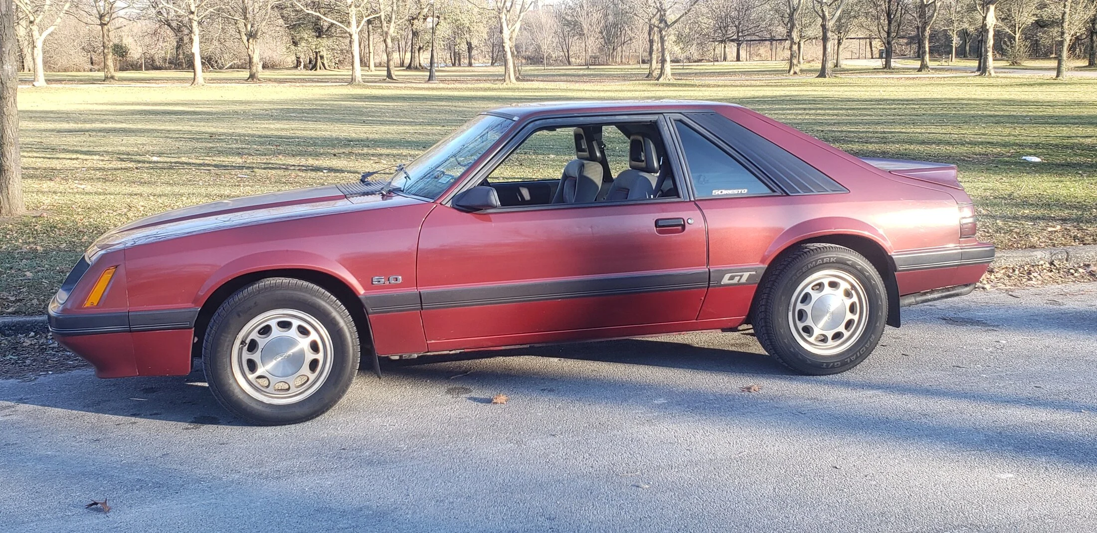

Hello all ...I have 86 GT for over a year that is mostly stock rust free and unmolested ( unmodified) looking to to go the restomod route with it .also looking to connect with those who have made improvements with a stock 86 engine (E6)
